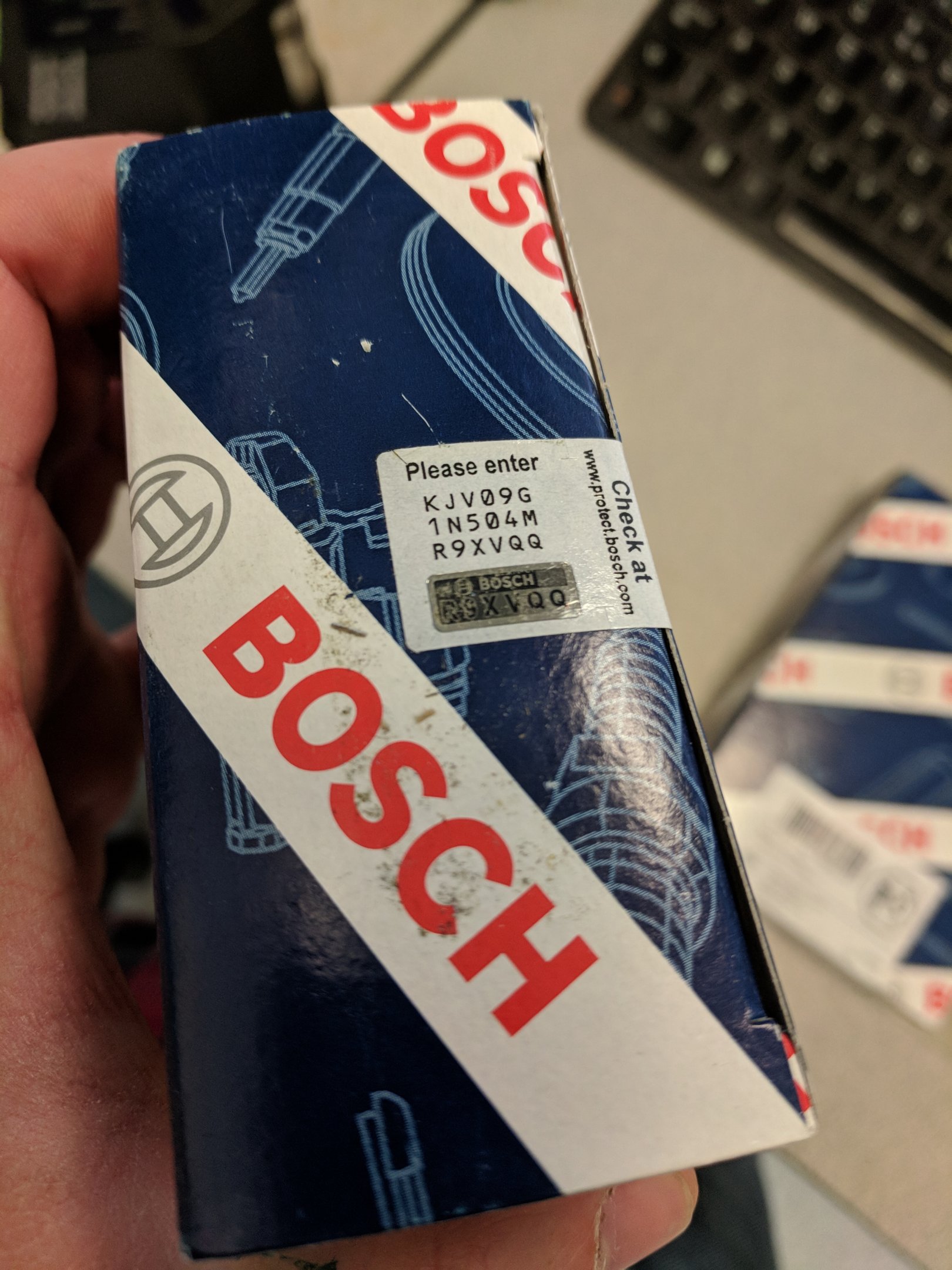

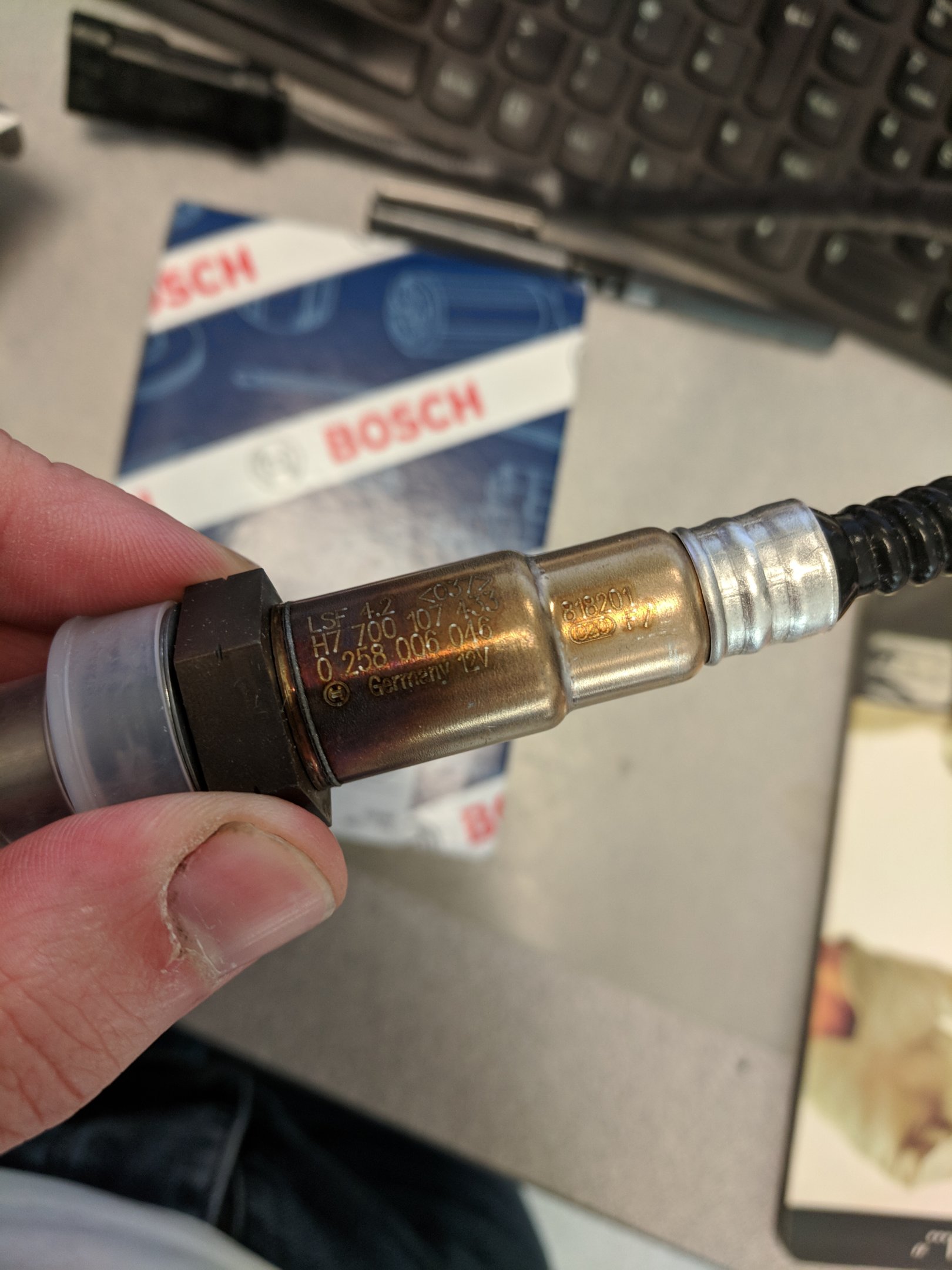

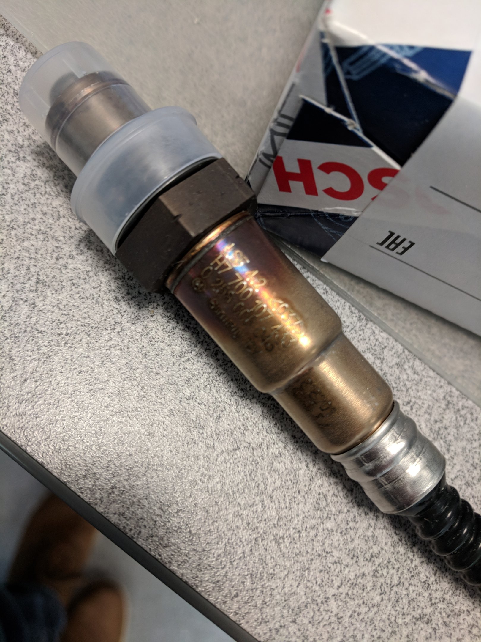

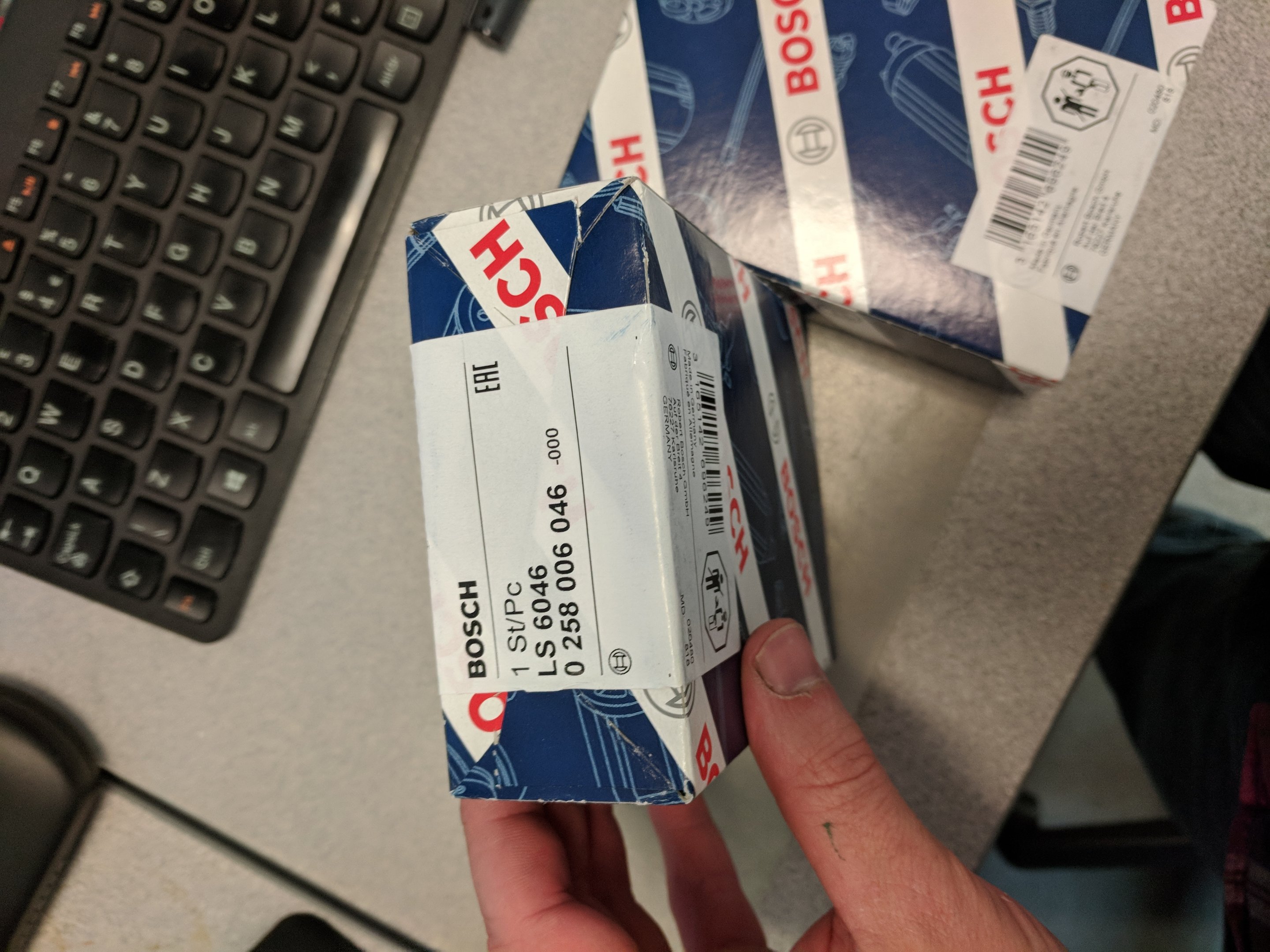

No worries - given the low price I was suspicious too, thought they may have been Chinese knock off's etc however after they arrived I was pretty satisfied they were genuine.
