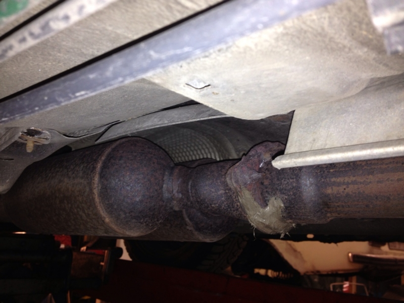

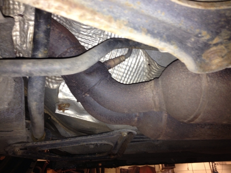

need som help... the sensor on the first pic is the sensor for the air/fuel right?
but where is the other one?
and another thing... whats the number on the right sensor?... swedish parts dealers have no idea what goes on what clio...:mad:
MicKPM
ClioSport Trader
  Clio16v/Zoe Z.E.50
Most likely answer is you have a ph1 and so no post-CAT sensor. Second most likely answer, its been removed from the loom/hidden somewhere and a single sensor/bodged system fitted.
My money is on option 1
  Ckio Sport, 9-5 Aero
Ok.. So the ph1 just have one lamda sensor then..
just one question then.. wich one is the right one for the ph1?.. or could I go with a "universal" with 2 wires?
