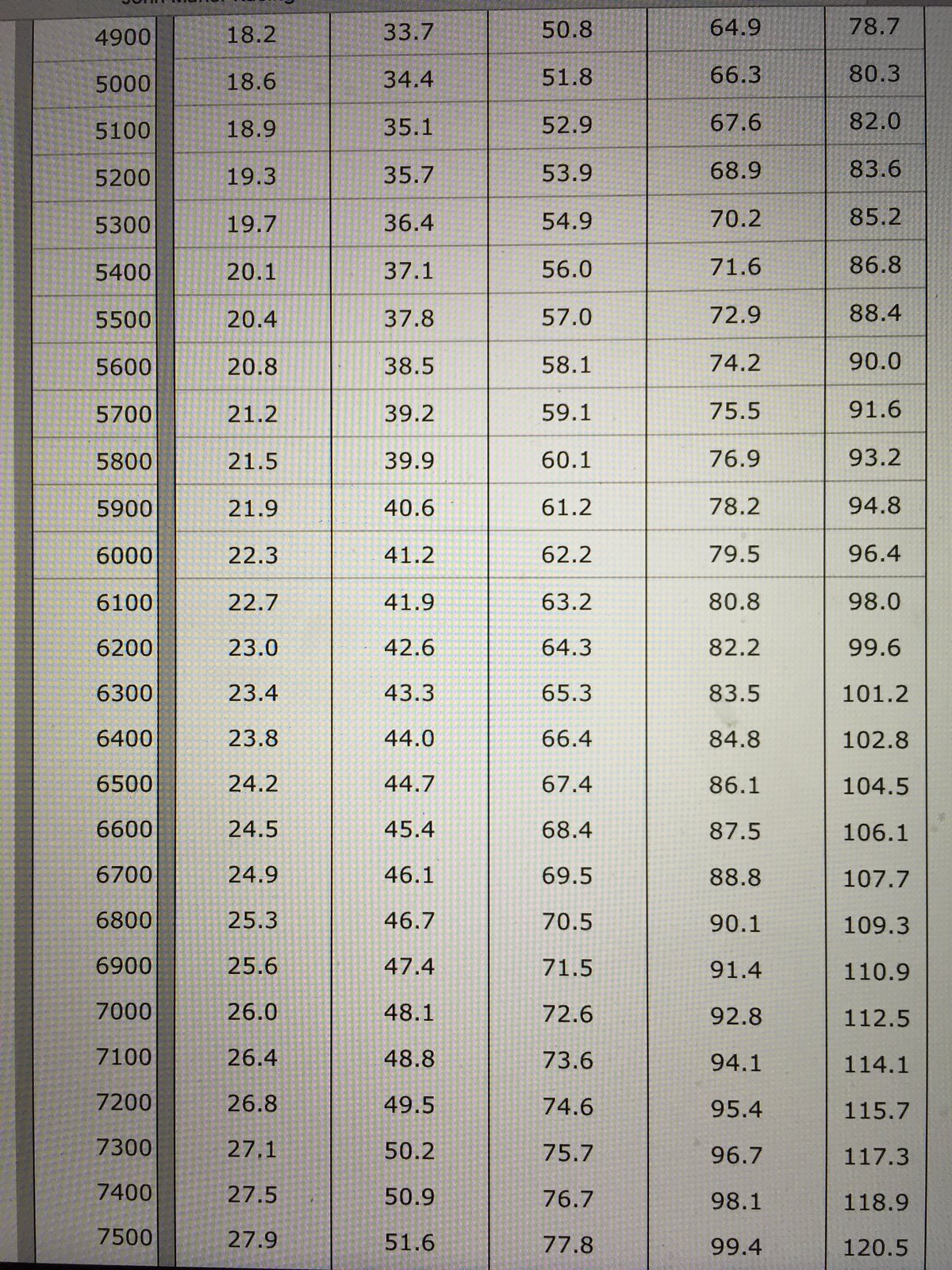

if you build a car right , you would up the final drive to lower top speed and therefore make acceleration quicker , however you nearly always (or i have on track cars) have a long first gear fitted , as first on track most of the time is never ever used.
I use second as first, shown here
similar to using a long first however not quite the same .
what you really need to do is play with a ratio calculator and look at power and max revs and sit down and work it all out .
the trouble with a clio is your most likely restricted in what ratios are available .
bashracing
like this, so as you change up the revs drop half way between peak torque and peak hp
