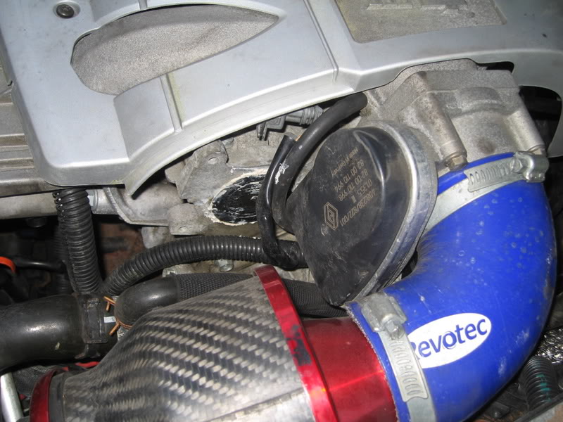

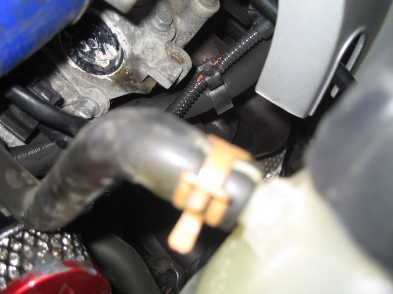

Sorry all, ive been working on my clio tonight. Ive noticed this, does anyone know what it is?
Looks like something attaches here? There is this paste stuff and god knows what it is???? The second photo to the left shows like bolt holes?
Thanks,
Chris
The holes are a mount to hold the silencer of a standard airbox aren't they? (the ones at the front)
Oh well, as long as its not ANOTHER thing for me to sort.
I bought the car cheap to do up and ive picked up a few more things than i budgeted for!. I was just getting paranoid. Its just been in for a major service so i would have thought they would have picked up something
if anything was a miss. Obviously not.

is that an ekotec valve in the edge of one of the pics?
Think so... What the hell do they do?
I bought the car really cheap off someone, it has been chipped, Viper Induction, that valve, magnex exhaust.
If you can advise i would be grateful!
Note the foil inside, its a breather. That isn't a hillpower bend its just an elbow so theres nowhere for the ICSV pipe to connect to so I assume he put the breather filter on there to stop crap getting sucked into the engine.
