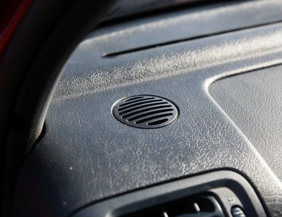

The door pulls (and to be honest almost all the soft-touch plastics like the clock surround, hazard panel, ac panel etc) are getting pretty bad...despite almost never getting hammered by UV, I guess it's just an age thing!
The door pulls are so bad that my fingerprints show on them.

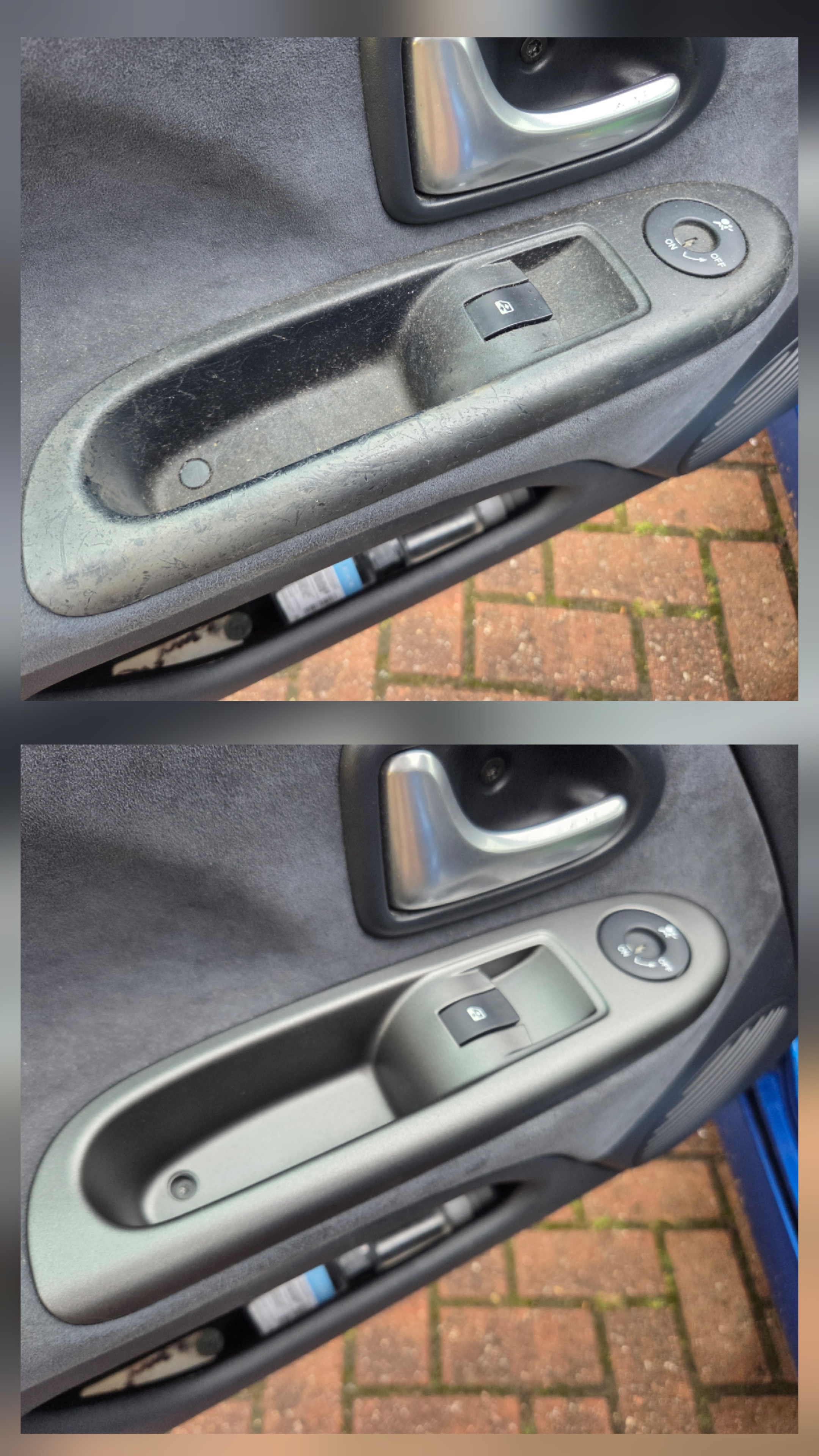

I soaked mine in dettol for a couple of days. All the sticky rubber coating just disintegrates, then it's just a case of cleaning off all the remainder, then sanding down and spraying with plastic primer.
I sprayed mine with some dark grey metallic spray ( I don't have the code number to hand, I can post that later if you're interested) from Halfords and finished them off with some matt lacquer from Halfords.
They look better than the originals and still look like they did when I fitted them in November.
They look better than the originals and still look like they did when I fitted them in November. View attachment 1785587View attachment 1785588

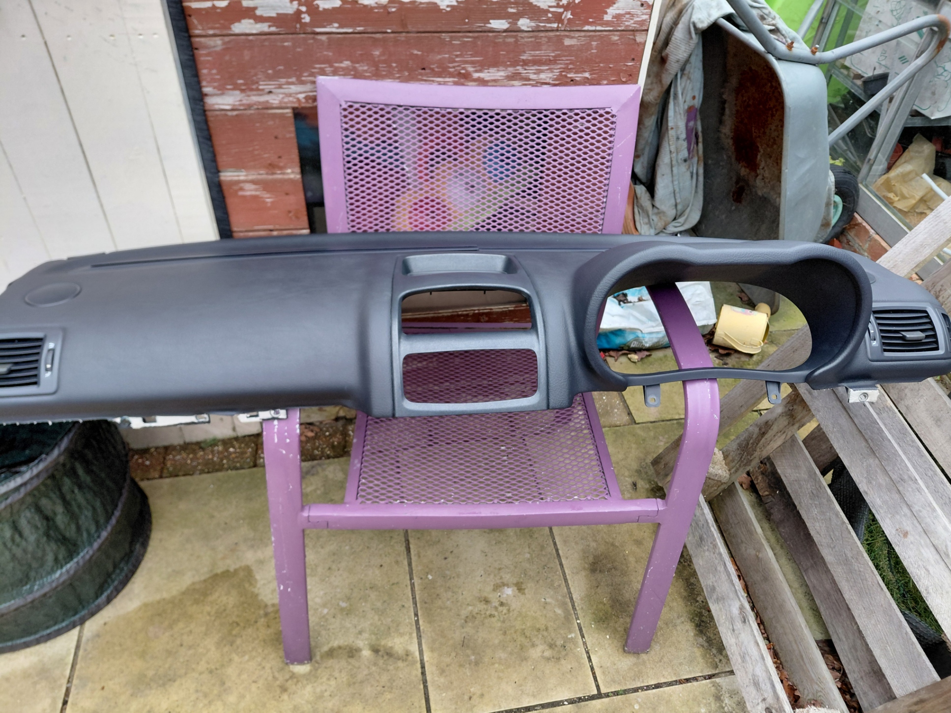

local scrapyard, buy basic clio trims. I even scored a base clio climate panel. They look perfect and it's the easiest way.

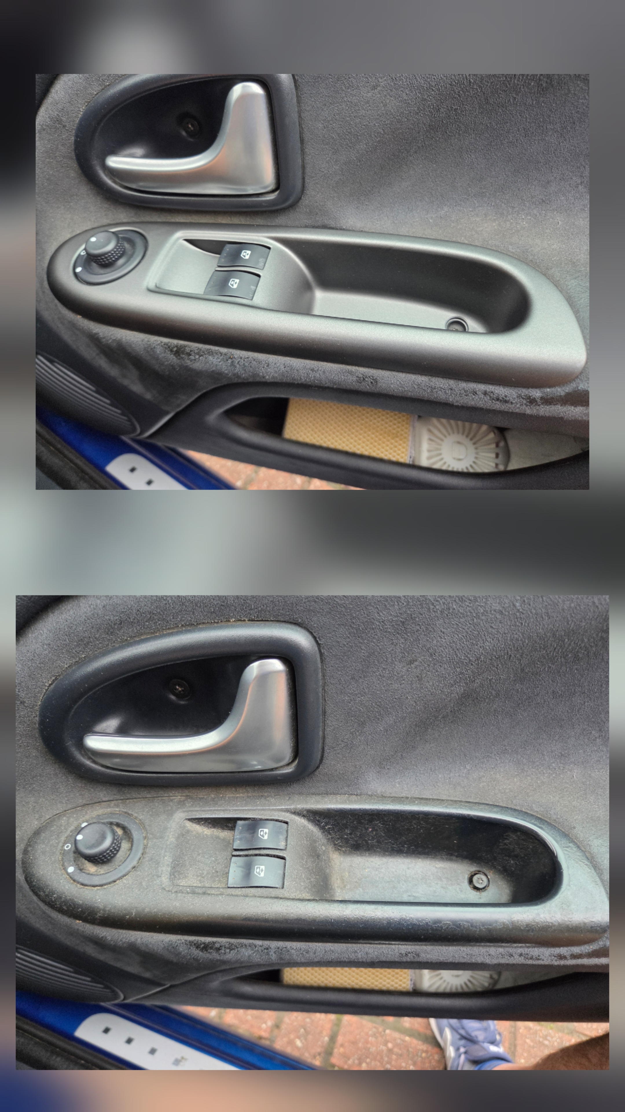

I've done the dash in both my 182's and used ZEP Sticky stuff remover and a plastic scraping tool, then original T-cut, then Mr sheen
The 1st one I primed it and spray it with Halfords Black Plastic bumper paint (came out pretty good, slightly darker than the grey of the original car, but looks clean) , the second I just cleaned it again with Zep Sticky stuff remover and plastic scraping tool, original T-cut, then Mr sheen. Both Come up lovely. Similar on door handle pulls.

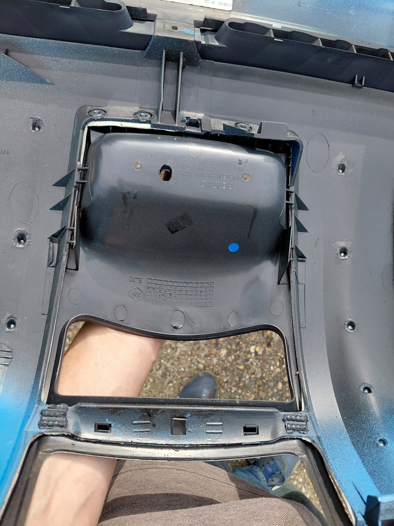

Also @benkay, including a picture of the rear of the central part of the dash behind, its heat staked in place, so not removable.
Anyone know what the centre dash bit is called, the sort of rubbery surround that includes the top "tray", then comes down around the clock and air vents? is that a separate part to the dash itself?
Did the basic Clios also have a non-sticky version of that?
I`ve just bought a 182 and it looks like the previous owner has removed all of the sticky coating bar the AC panel at the bottom. Am i right in saying the center/top dash panel is bonded in place? It looks like they might of thought it was a separate part and tried to pry it out, it`s out of alignment at the bottom and bugging the hell out of me!
