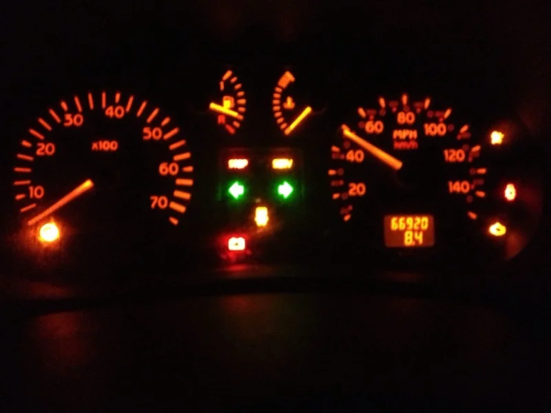

Recently one of my wee brothers asked me to keep an eye out for another car for him (he rolled his last, mint, 1.4 S after a month!) so I decided another Clio would be a safe choice and that I shouldnt worry about bodywork as much, just make sure its mechanically sound. Not long after an Aunt called and asked me to have a look at her Clio as it wasnt starting and throwing up the full disco dashboard.
Went along and diagnosed that the loom was damaged and the earth had seen better days. It was also out of MOT and had days of tax left. With it needing a service and no idea of any other issues that could cause it to fail a MOT my aunt and uncle decided to cut their losses and planned to scrap it. They called a couple of places and for it to be collected by a scrappy was only going to get them £100. So thats when I offered my brothers £100 to them and became the 3rd owner of this

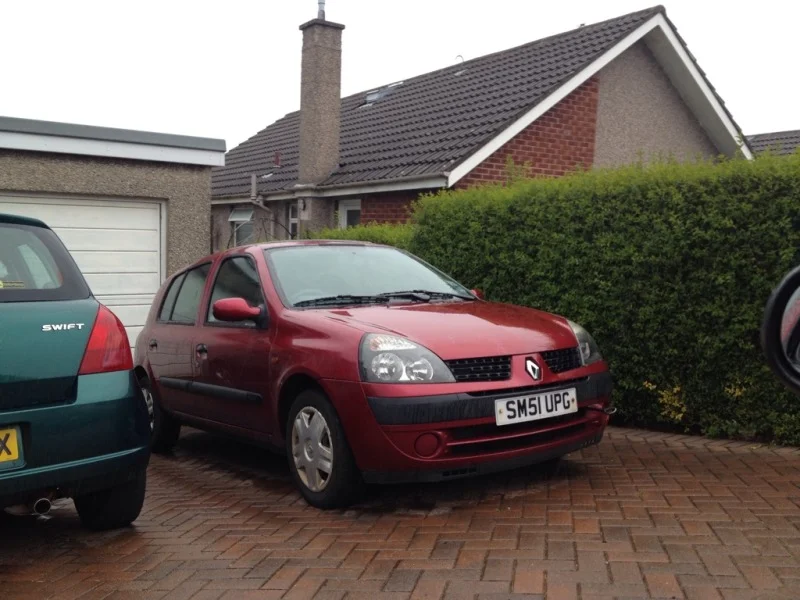

67000 miles, 1.2 16v no test, effectively no tax and pretty rough round the edges!

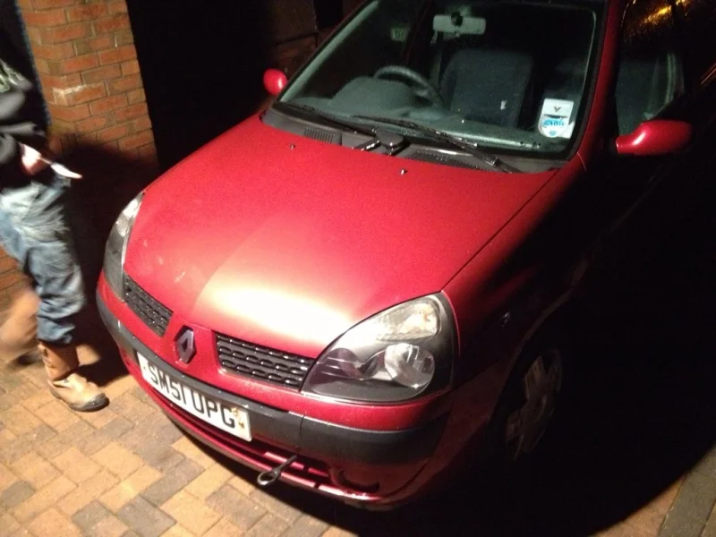

First thing to do was repair the tow eye my uncle had destroyed and tow it home. On a properly shitty, soaking, windy night!
Dave was just about to Boaby Tapp it here

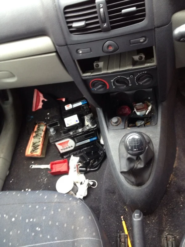

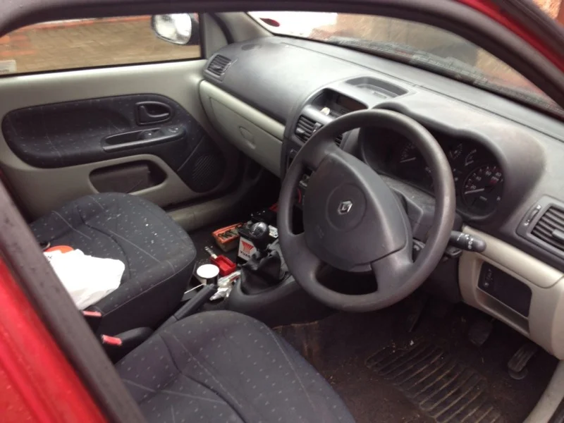

Its a bit of a state inside as well as outside, I ended up with 2 bags of rubbish and 3 bags of my Aunts belongings to take back to her!

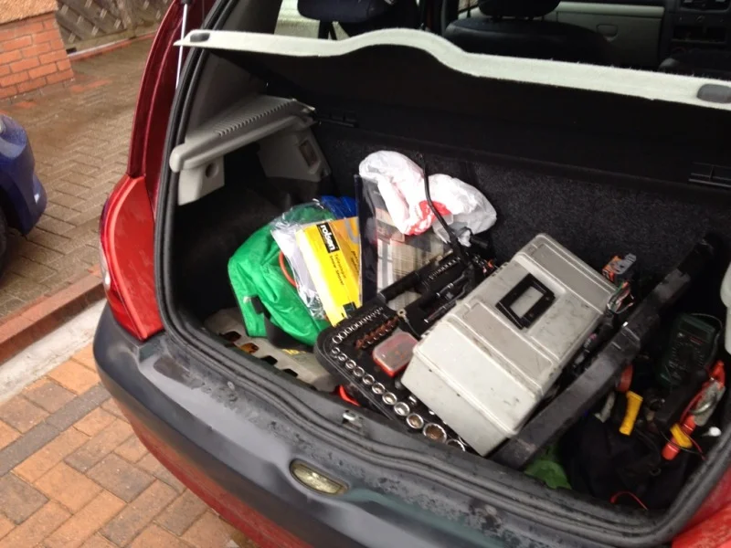

The tools are mine!

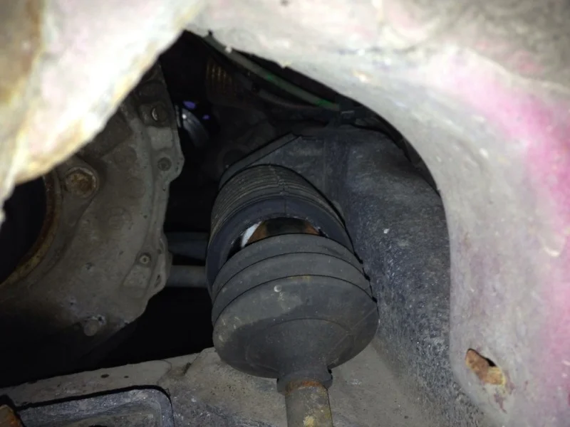

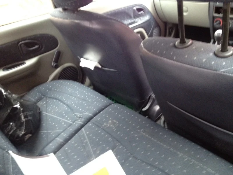

It only failed on a headlight beam being too low, a steering gaiter being properly split, a rear seat belt buckle not working and a rear door not opening. Which I thought wasn't too bad at all!
Gaiter was a nice easy fix, as was the headlight and buckle but the door was a pain in the tits! After a hour and a half of carefully trying to get the door open to replace the lock I lost the rag, went mental at it and it popped open! So down to the scrappys and a tenner had me a new lock mechanism, tow eye and a battery clamp for a tenner.

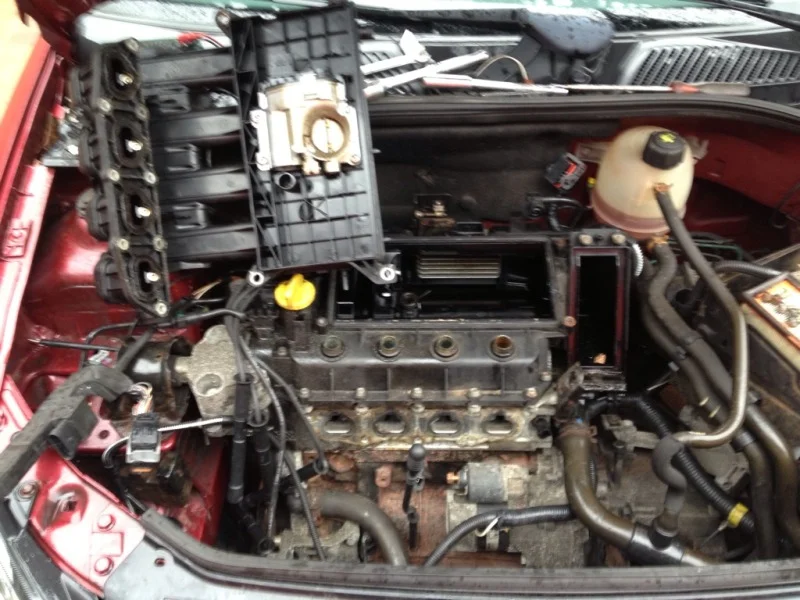

And on the way home I gave it a damn good rev and discovered a misfire above 5k! Balls!! Threw up code P0440 which I believe is the carbon canister which was unplugged when I got it but I put back in. Cleared the code and the warning light went off, another good rev and it all happened again! Oh well, something else to do to it now. I dont think the carbon canister is causing it but is more of a sign that something isn't right. I'll start by checking the plugs another day when I can see.
Djw John
Scotland - South
Changed the plugs today and it ran a little smoother straight away and the light went off with the code reader but can't say I expected to never see it again. Right enough it came back on within 5 minutes!
So dropped the carbon canister off and found that the solenoid wasnt sitting quite right in it. Whilst it was off I checked the solenoid was working by passing 12v through it and it clicked nicely so can rule that out. The plug was also getting the right voltage. Put it all back together and the light now only flashes on when you hit the limiter under load. It goes off again straight away and doesnt log a code at all.
So I'm thinking there might a lose connection somewhere along the line. The engine moves quite a bit under load so putting a dogbone on it anyway and will investigate the wiring when I'm letting the oil drain on its service. Taking it to work tomorrow regardless, more confidence in it now that I can get a tow eye in it properly!
