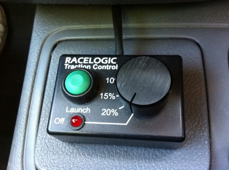

Race logic traction control? That's a good bit of kit, I have it in my car :) Usually over £500 to buy unless you're lucky and buy a car with it fitted. Soooo many wires though!
It's quite clever, it will pull 1 injector pulse in 4 if it detects wheelspin, if that doesn't bring it under control / within the parameters you've set, it'll pull a second pulse in 4, and then go up to 3 I think if needs be. It lets you get the most possible power down, unlike OEM traction control that just kills any fun.
Not sure you'd need it on a Clio unless you were pushing big power, or just enjoy being lead footed everywhere :)
