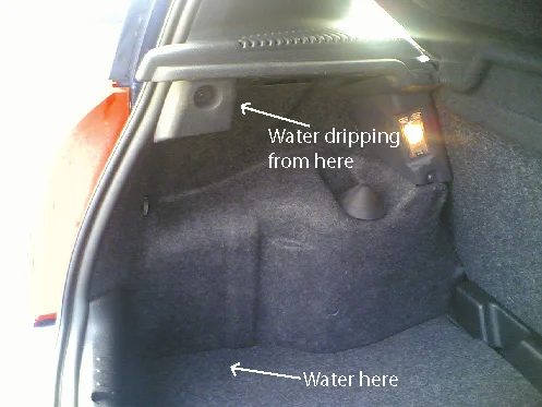

I've noticed on a couple of occasions that I have a pool of water in my boot after either washing the car or during heavy rain. The picture below illustrates where I believe the water is dripping down from. Any idea where I should be looking in order to fix this?
I lifted the carpet and the foam underside is soaked.

Check these 2 grommets , 1 on each side , remove , silicone sealant in the hole , replace the grommets and try to leave the tailgate open as long as possible until the sealant has cured .
The water usually finds its way into the spare wheel well and sometimes under the back seat .

I checked the seal, removed it and replaced it but I could not see any obvious point of entry for the water but from where I found it dripping it must be entering above those grommets. Are the rear lights a possible area of concern?
I checked under the rear seat and there was indeed a pool of water which has now been dried, that'll explain the damp smell over the weekend.
