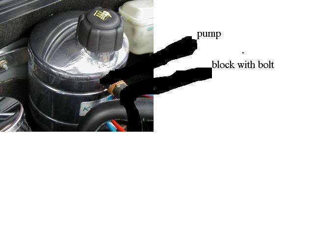

i made my own pressure tester.
we have a proper sykes pickavant one at work that i found useless because the caps for the expansion bottles you get either leak or loose pressure.
all i got was a bike tyre pump with a pressure gauge on it and cut the valve off.
hey presto one coolant system tester.
i have a selection of different diameter rubber hose /jubilee clipsband some bolts i use as blanking plugs.
all you do is locate a small coolant hose in the system that you think you can tap in to (normally the small hose going to the expansion bottle)
plug your tyre pump on the actual bottle, and block the hose you just pulled off with a bolt.
pump it up to 1 bar (dont exceed a bar) and watch it leak

cooling systems are designed to run at 1 bar (its only 14.7 psi)
the bolt wont shoot off in the same way that all the other various engine hoses wont shoot off, just make sure its a tight fit.
dont think you understand about how i connect it though, from the tyre pump, all i have is a plain peice of hose - no connecters no nothing.
crap picture but you should be able to sus what i mean. its just a case of experimenting with different diameter hose to connect it all together.
you can safely pump it up to a bar, but like i say dont exceed it
