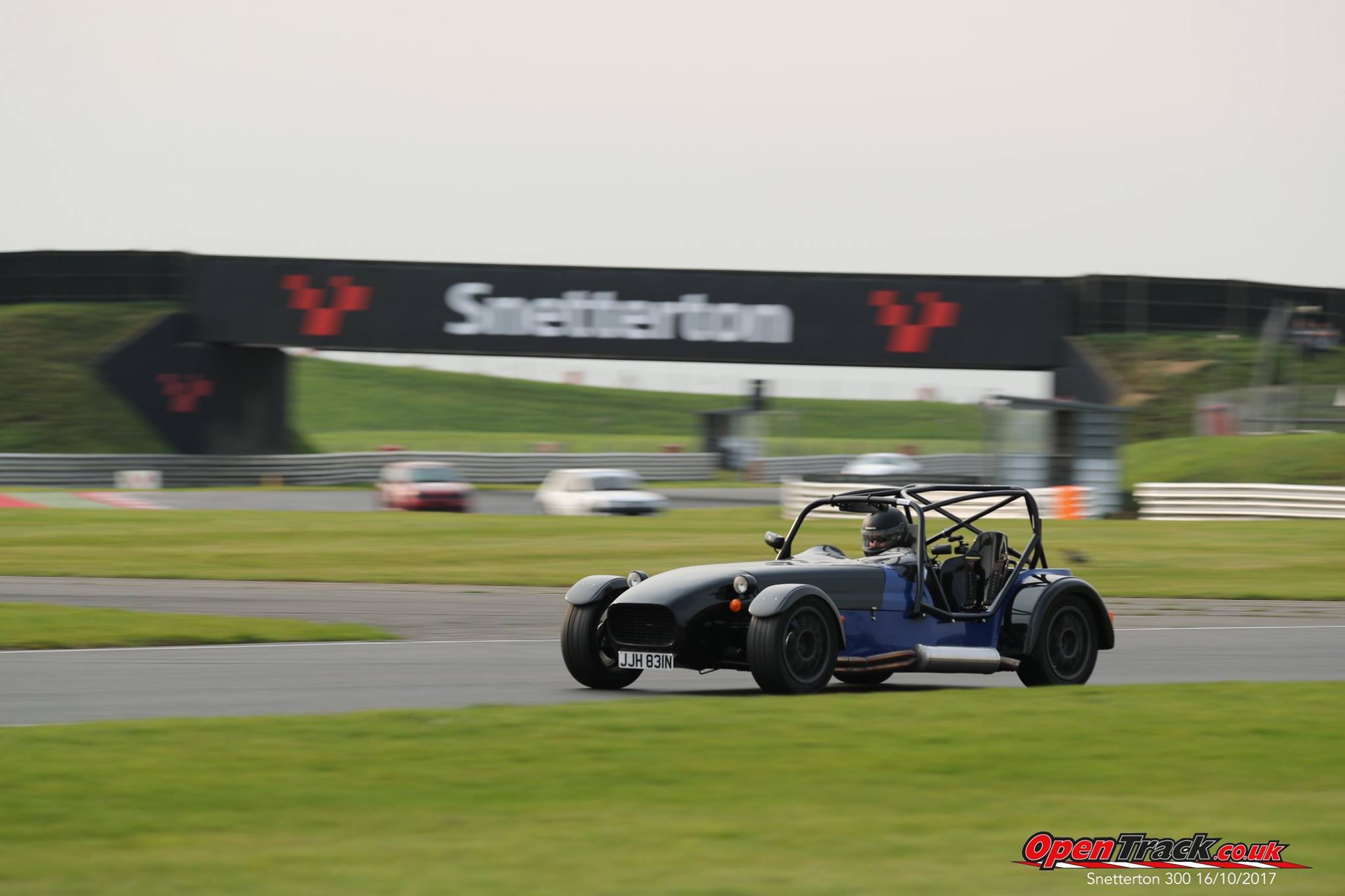

Lee it would be wrapping this.
So:
Nose cone (Removable)
Bonnet (Removable)
Scuttle (Removable)
Sides (flat)
Rear (flat)
The front and rear wings would be left black/carbon. The rear wings are detachable so getting to the back should be fine. The only complex shape there is, is the nose cone. Other than that it would be hopefully simple to learn on.
lee M4RSH
Any part that is removable makes it 100x easier mate.
Make aure you have loads of space and keep your tools on a belt as you dont want to be caught out in a sticky situation.
