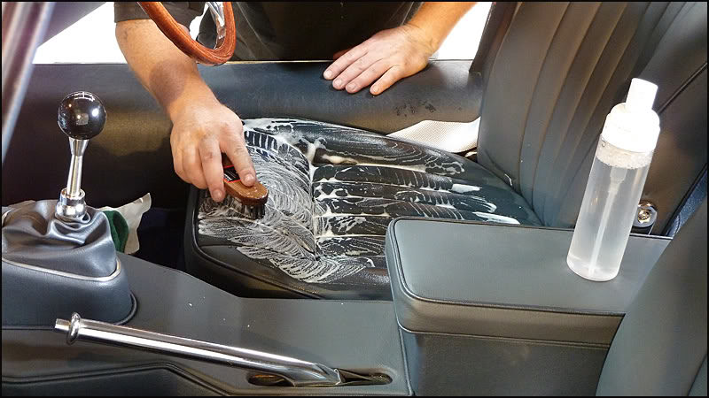

LTT is my preferred, Boberton. And you don't need to feed it. The Billywithabuffer that's done your brother's will have used a leather "milk". As most modern leather is sealed anyway, this just sits on the surface, hence the shiny look.
Dab of LTT cleaner on a soft brush (buy a set of Kiwi shoe polish brushes for a few £), damp MF to clean the seats initially and give a bit of moisture, foam up the cleaner with the brush, damp MF to remove the foam, consistently rinsing and twisting the MF dry to deposit the dirty foam into a bucket of warm water.
Or, I'll do it. Lol.
And when I say foam, I mean as if you're washing the hood foaming;
