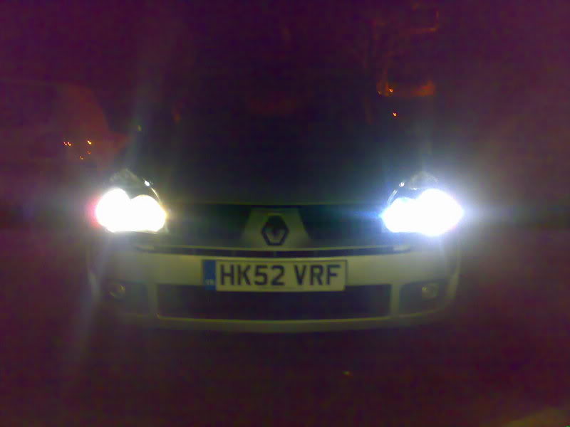

I installed some LED Sidelights to my 172ff a while ago to complement the Xenons, only now one decides to flash (so i look like an unmarked policecar)! I had a fiddle with the wiring and couldnt stop it so have now reverted back to my standard ones. Does anyone know why this has started to flash?
