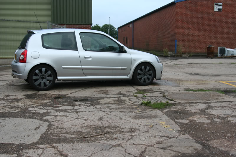

Heres a pic of mine which was setup professionally so I assume is the right height.

Far to high IMO! lol
-90mm or dont bother.

I'll mention it to the guy who set it up. Maybe he could use your experience to reduce the lap times on the race cars he sets up.;)

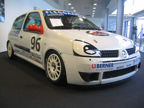

Pretty much evey racing car is slammed, you try find one which is riding high my good man.
Oh and tell your "set up guy" that hes just been subway'd!
smooth race track is not the same as british b road though is it.
Cup car has no arch liners rear coilovers no doubt modifications to the position of bump stops and does not need suspension movement to deal with bumpy roads.
You cant compare a road car to a race car.
