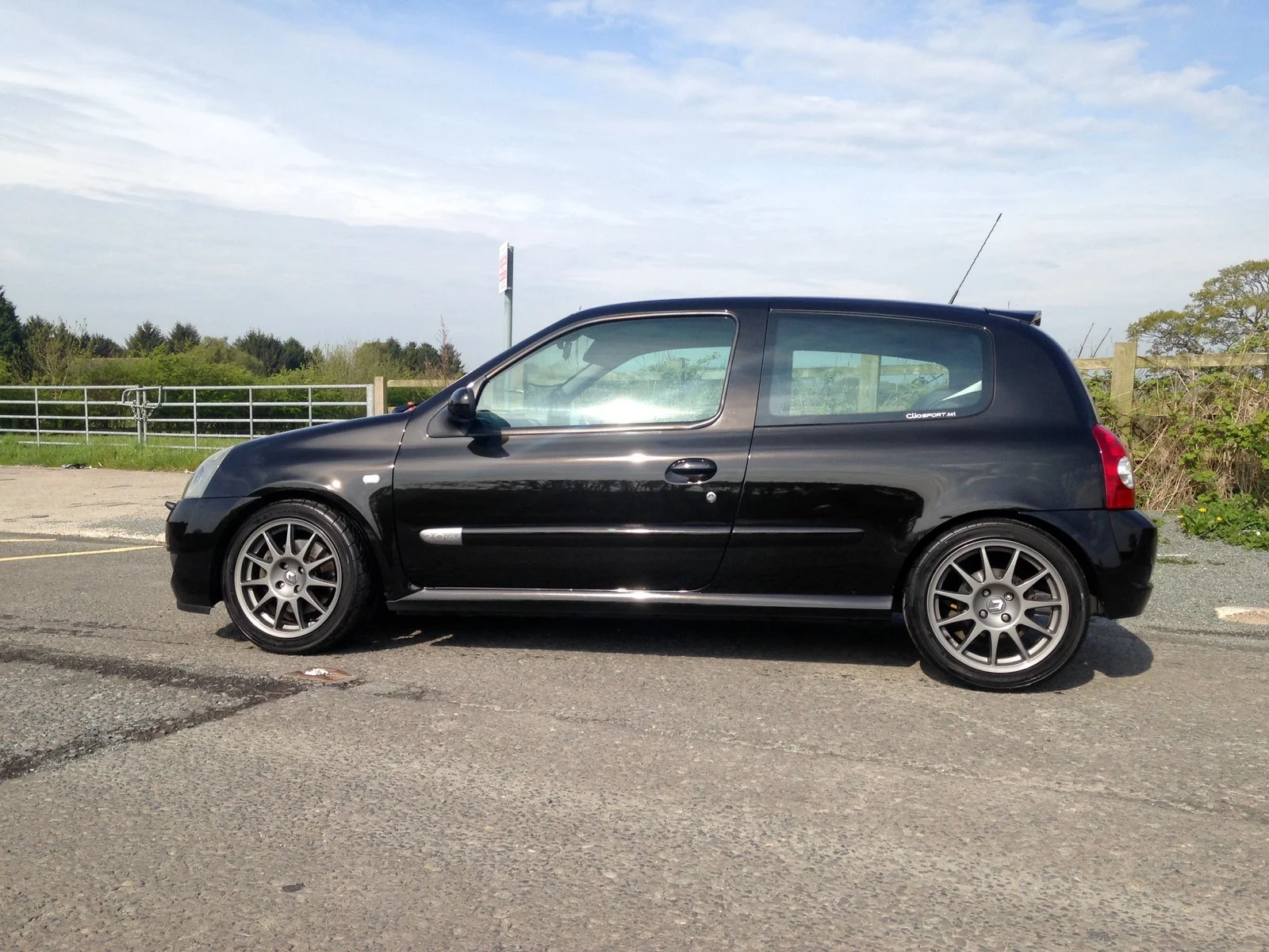

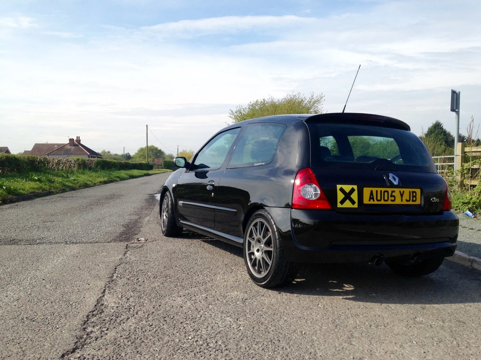

Thought I'd share my progress and few pictures of my Clio so far and yes I do give my cars names.. This being a Black Gold I thought Ebony suited her well:smile:

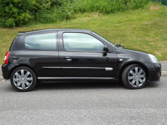

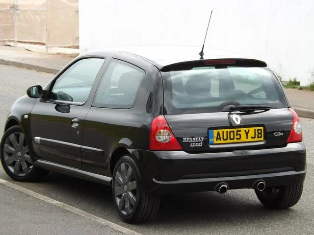

Bought the car in July last year and it was advertised for £3,450, top money considering it was due belts and dephaser pulley. I ended up part exchanging my 2006 Mk6 Fiesta ST (which needed an engine rebuild) and roughly a £1000. It was a completely standard 2005 registered car, under 70,000 miles with both Cup packs. Couple of dealers pictures...
The car just wasn't up to my standard so I started to work my way through mechanical/maintenance list;
  • Full Service
  • Cambelt, Auxbelt, Dephaser pulley & Waterpump
  • New Renault/Lucas O/S Front Brake Calliper (Snapped a bleed nipple badly)
  • New Brake Light Switch (Serv and ESP light on)
  • Coil pack, HT leads & Fuel injectors (Car had a misfire so just replaced the lot)
  • Pre-cat Lambda Sensor
  • Air temperature sensor & Coolant temperature sensor
I've still got a few more jobs to do...

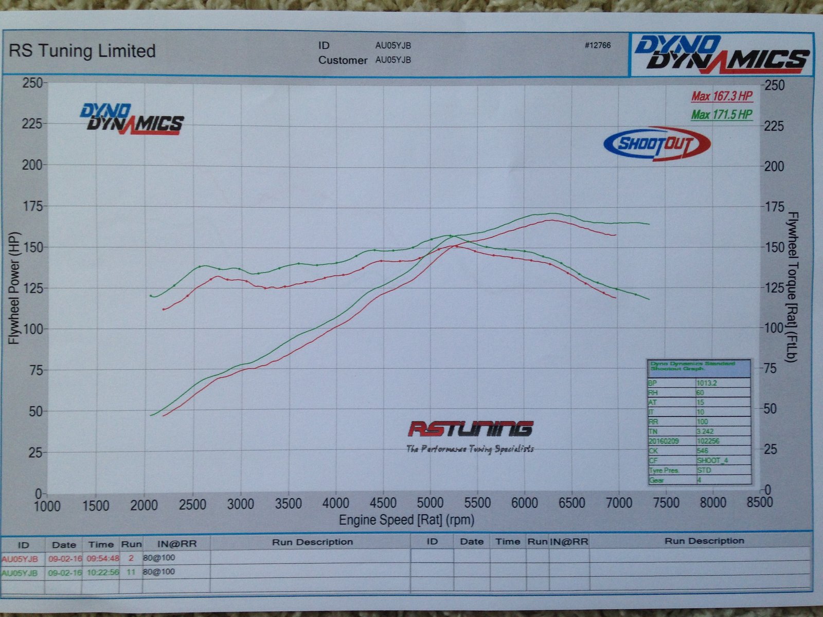

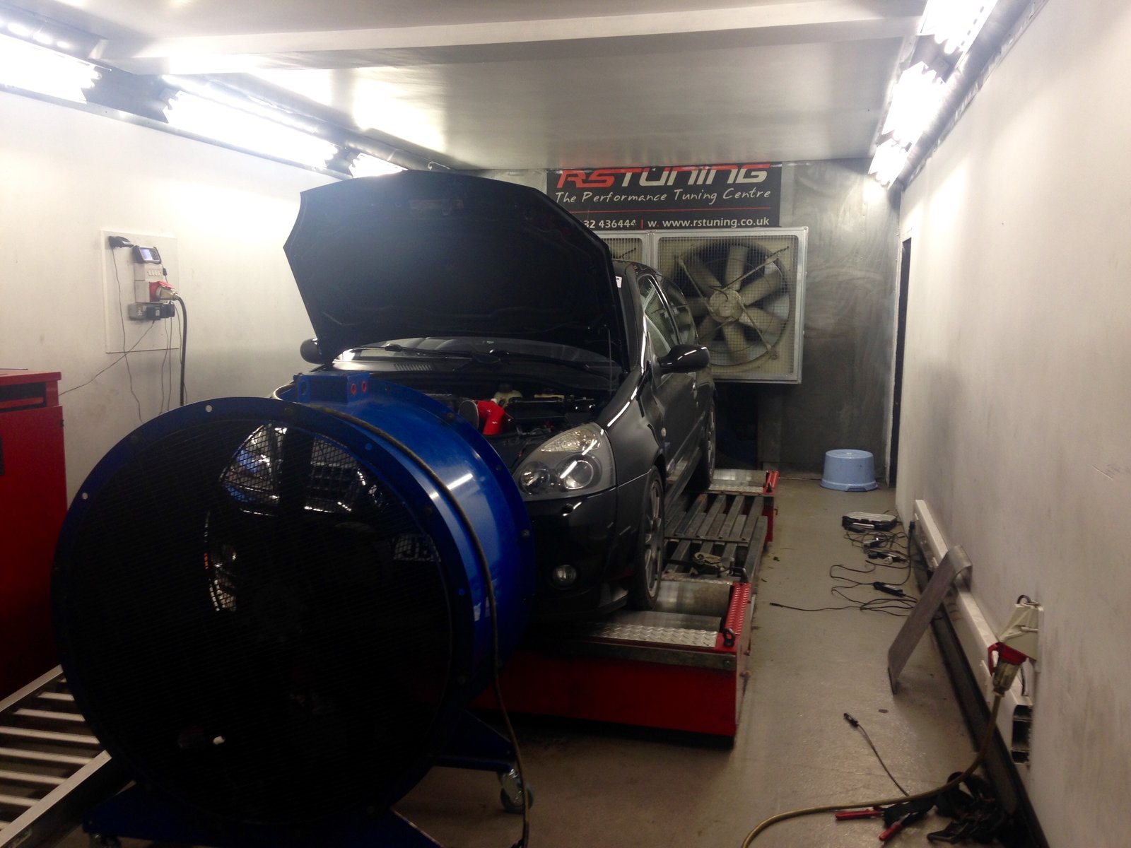

Once the car was pretty much mechanically sound I went to see Paul at RSTuning for a remap... Initially I was pretty disappointed when I saw the graph/numbers but driving the car I can honestly say it was money well spent.
Current spec;

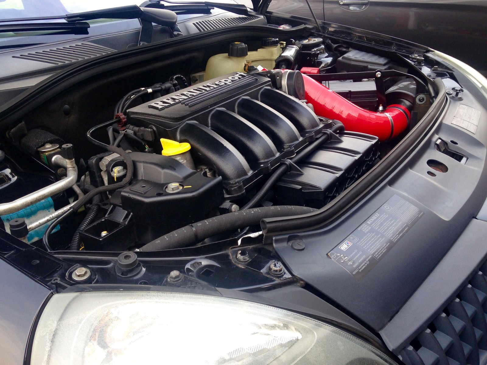

Engine
  • KTEC Induction Kit
  • Matched Inlets
  • PMS Sport Cat
  • PMS Cat-back Exhaust
  • RSTuning Remap
Transmission
  • Standard JC5 Gearbox & Clutch
  • Renault Scenic Shifter
  • Yanoo Stiff Shift 3.0
Suspension & Handling
  • Cooksport Springs
  • New Cup Dampers & Top Mounts
  • Eibach Camber Bolts
  • PMS Front 5mm Wheel Spacers
  • Vibratechnics Engine & Gearbox Mounts
  • EVOL 'Black' Dog Bone Mount
Brakes
  • Brembo HC Discs (Front), Renault Discs (Rear)
  • Ferrodo DS2500 Pads
  • Goodridge Phantom Braided Hoses
  • ATE Typ200 Fluid

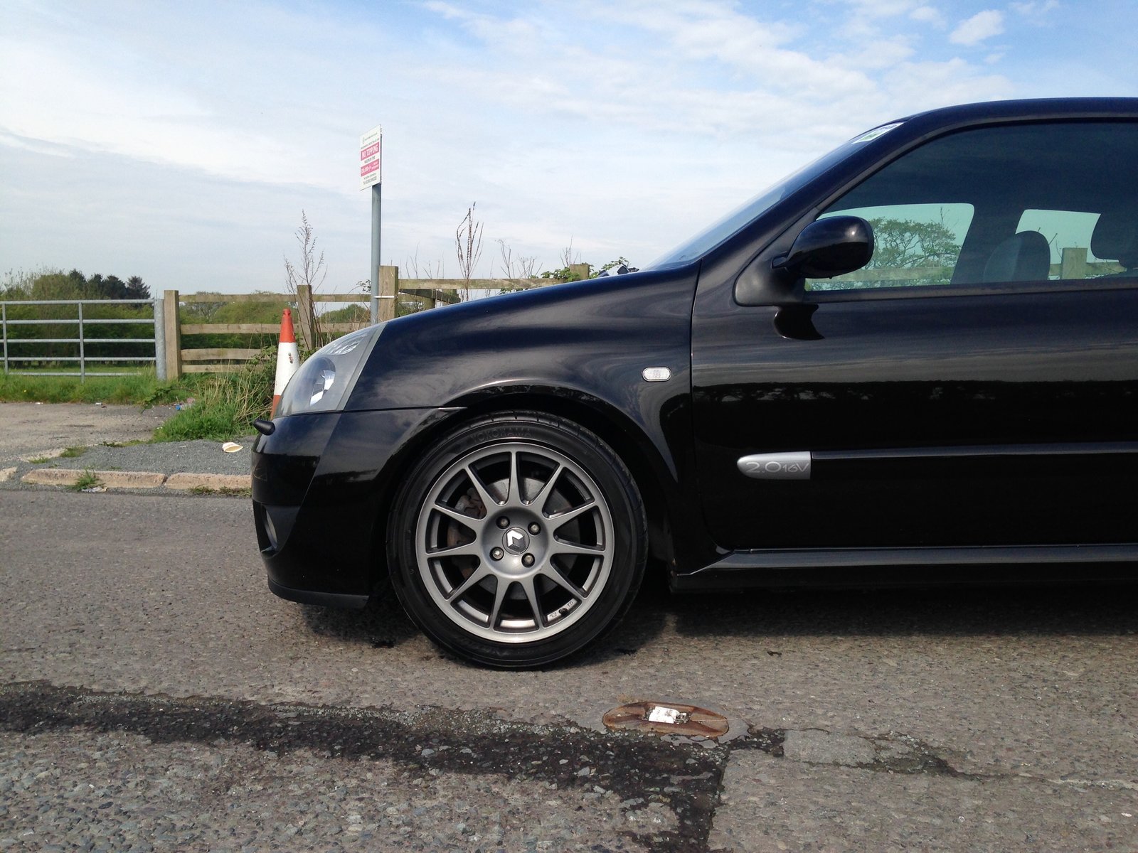

Wheels & Tyres
  • 'Cup' 16" Speedline Turinis
  • Yokohama AD08R Tyres
Interior
  • SPA Oil Temperature & Pressure Gauge
  • Carbon Dash Trim
Exterior
  • 3/4 Front Plate
  • SprayShack Door Bullets
  • SprayShack Rear Wiper Delete Trim
I've currently got some Corbeau Club Sport seats on order which are due in stock either this month or next and I've got a Sabelt 'Renault Sport' steering wheel waiting to go on once my seats have arrived too.
Future Plans... Strip, Rear cage, 15" Pro Race 1.2s, PMS top mounts and the list goes on.

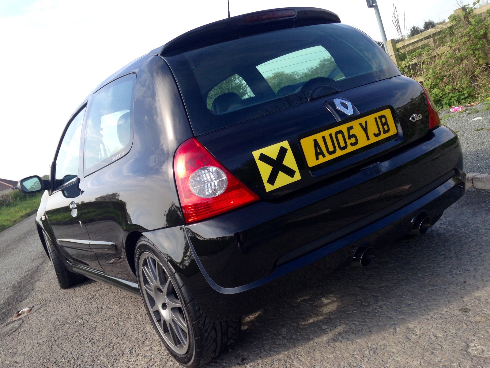

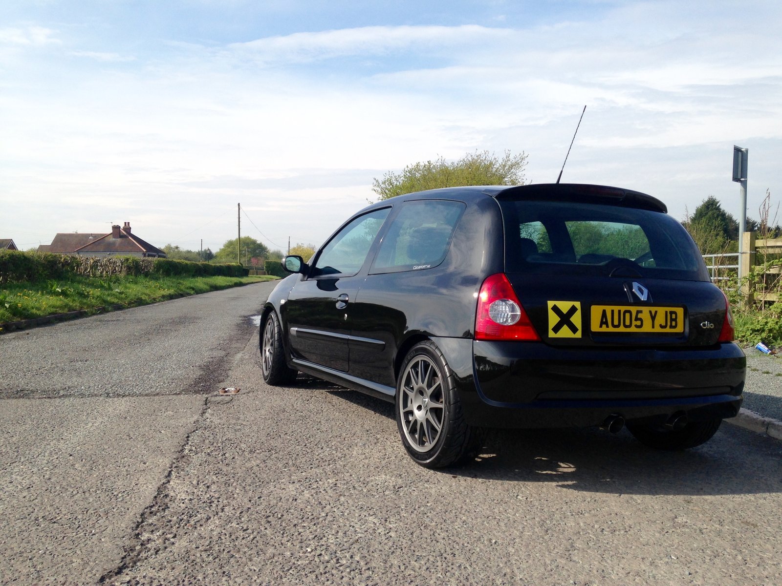

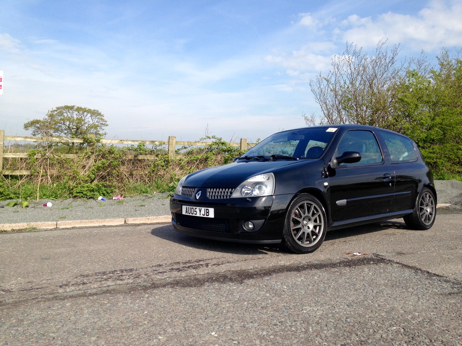

So that's been pretty much my progress from the day I bought it in July last year and today I did a little detailing in which I'm a complete novice but gave it ago anyway.. (Headlights still require some serious correction)
  1. Washed
  2. Iron X
  3. Clayed
  4. Polished/Cutting compound to remove light scratches and swirls
  5. Auto Finesse Tripple to hide minor imperfections
  6. AutoGlym HD Wax
I've never been massively into detailing although I do keep my cars clean but with this being Black it looked awful so I had to do something about it... and finally some pictures, I'm a complete novice at this too with an iPhone:smile:.

Fantastic example of a Black Gold! Love all your additions made, did you have the Turinis refurbished? I quite like their colour :smiley:
Yes I had them refurbished/powder coated so I'm not sure what the exact colour is but they do look good although they'll be for sale soon once I get some Pro Race 1.2s.

  Teg

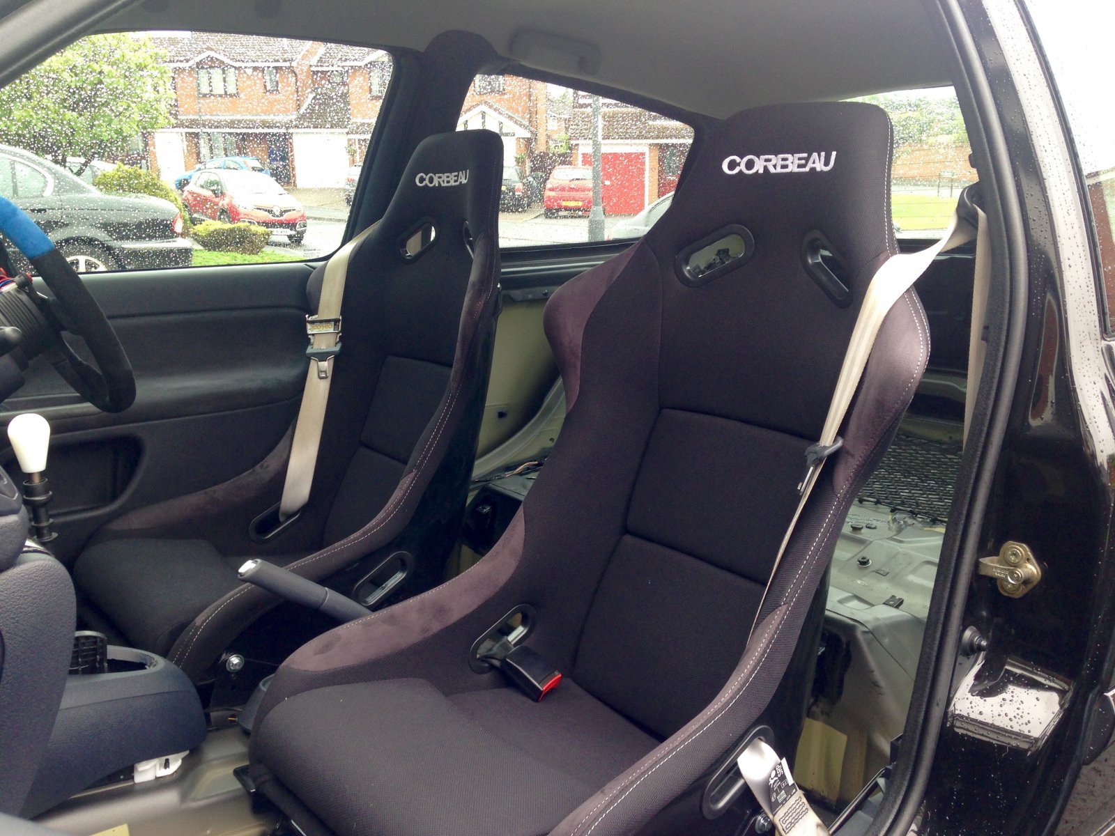

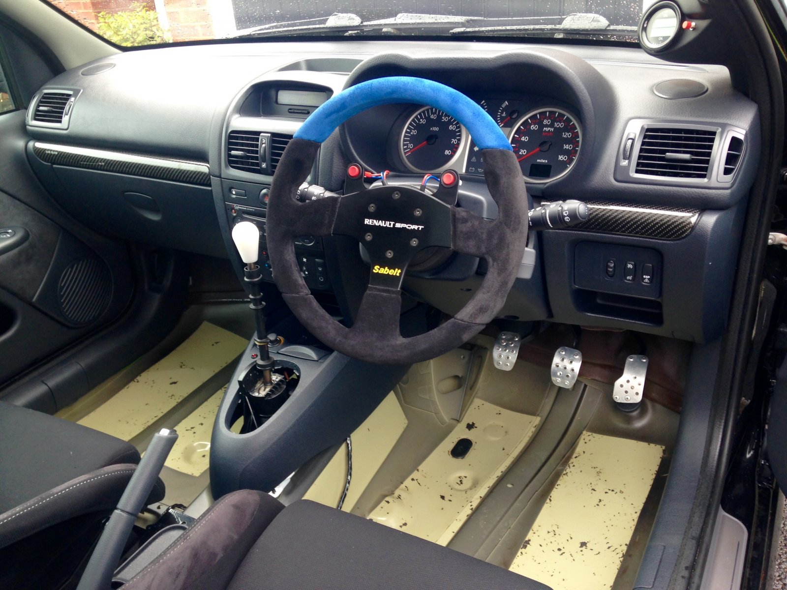

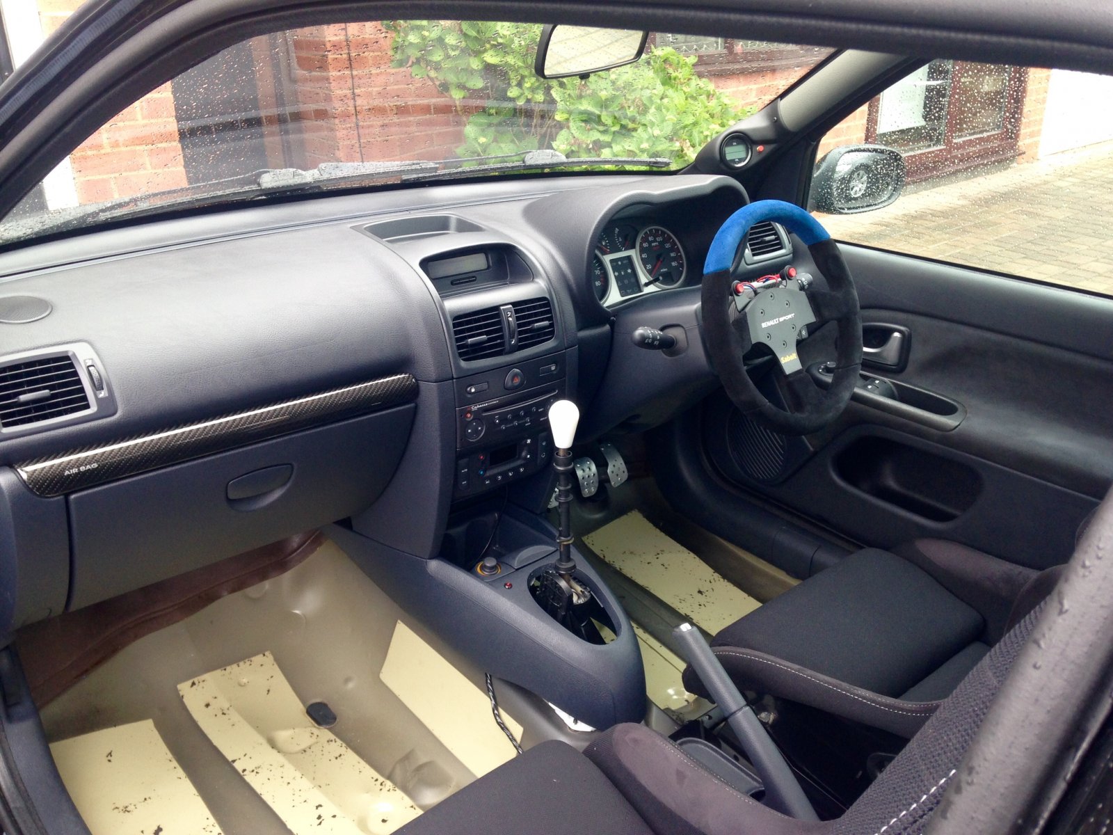

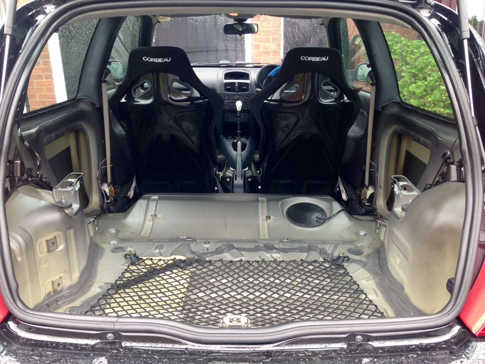

Saturday's/Today's Job was...
  1. Strip Interior(ish).. Still got headlining, front door cards and dash fitted
  2. Remove all tar/sound deadening
  3. Fit Sabelt 'RenaultSport' steering wheel
  4. Fit Corbeau Club Sport seats with VBD X-Low subframes (No runners/fixed into position)
Still got a few more jobs to do/issues to fix but overall I'm happy with how the cars coming along :grinning:.
