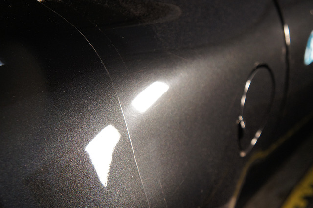

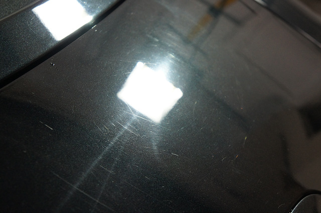

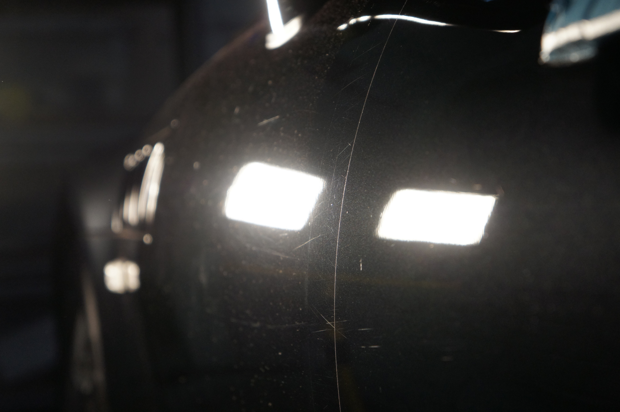

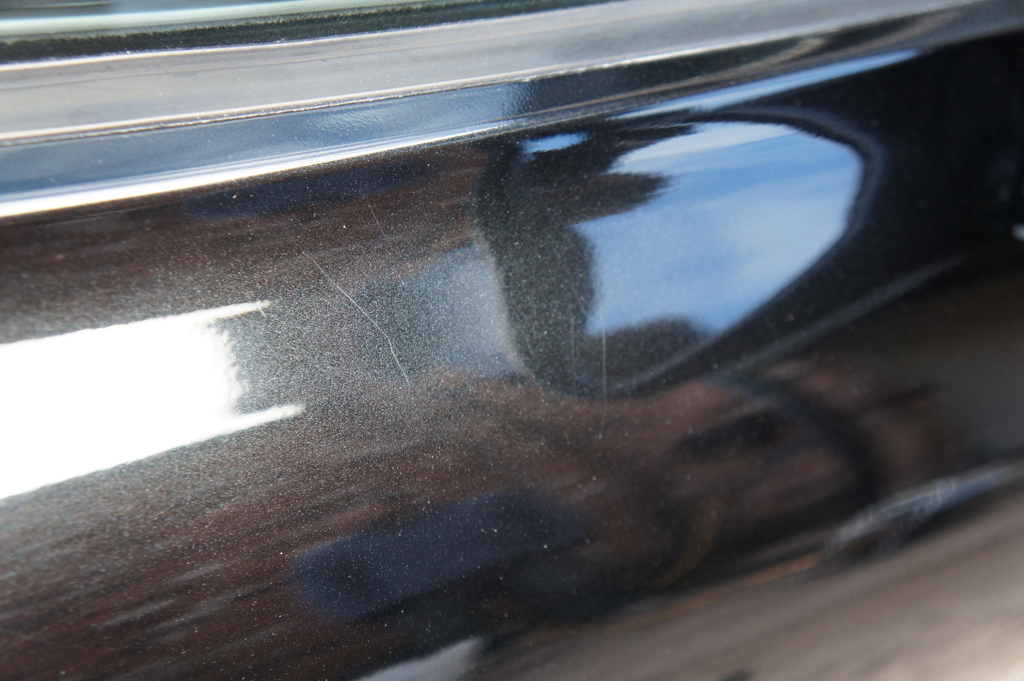

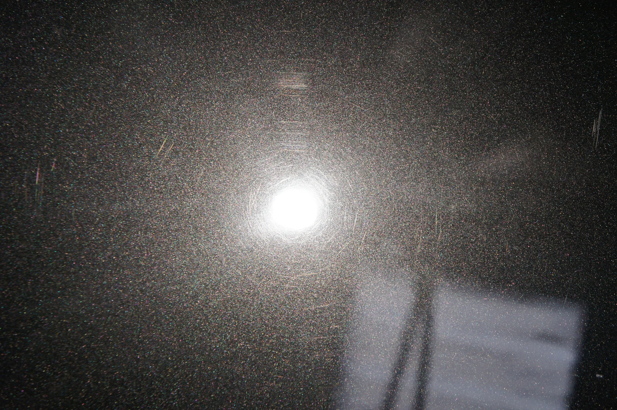

Deeper scratches visible in normal daylight.
DSC07935 by RussZS, on Flickr

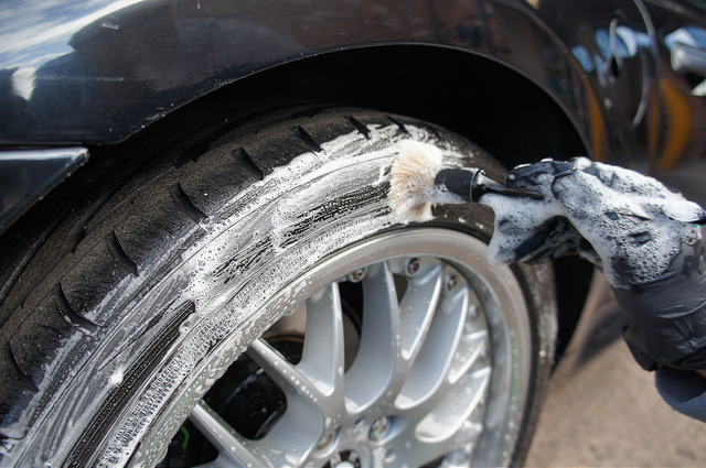

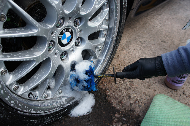

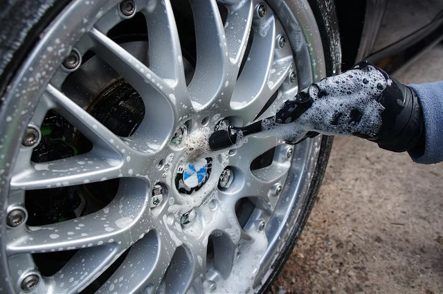

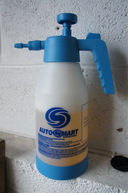

Wheel liberally covered in AS Smart Wheels cut 10:1:
DSC07938 by RussZS, on Flickr
This was worked with various brushes:
DSC07939 by RussZS, on Flickr
DSC07940 by RussZS, on Flickr
DSC07942 by RussZS, on Flickr

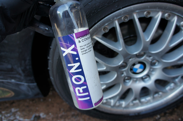

Then rinsed and treated to IronX, which lifted surprisingly little:

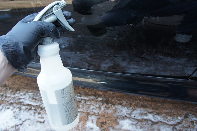

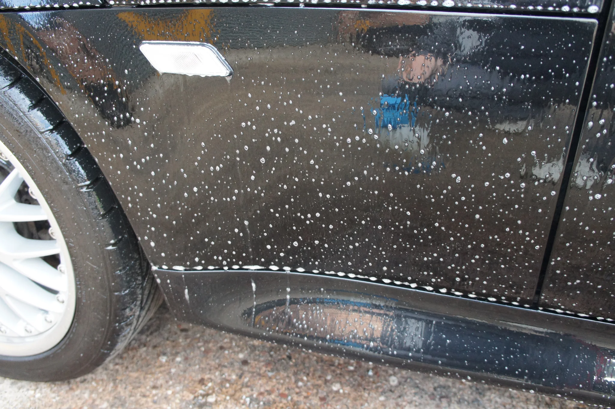

Meanwhile, the car was prerinsed with 10:1 Britemax Grime Out via pressure sprayed:
DSC07943 by RussZS, on Flickr
DSC07944 by RussZS, on Flickr
DSC07945 by RussZS, on Flickr
Whilst not as 'pretty' as snow foam, a degreaser such as Grime Out is far more effective at removing dirt/traffic film.

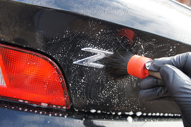

This was agitated with Swissvax Detail Brush where required:
DSC07947 by RussZS, on Flickr

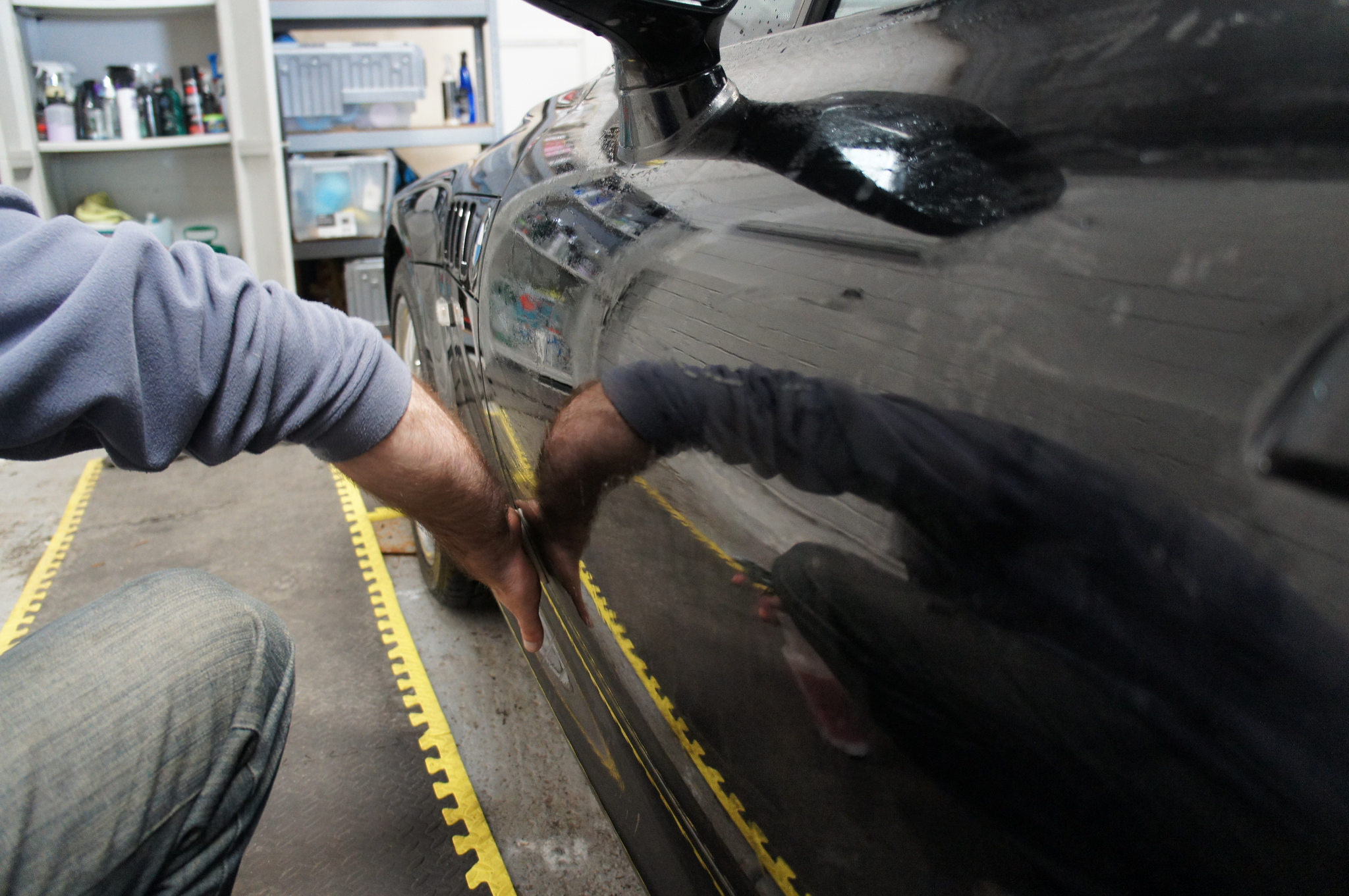

Next the car was hand washed with Britemax Cleanmax, rinsed, treated to IronX and Tardis then moved inside for claying:
DSC07950 by RussZS, on Flickr
DSC07952 by RussZS, on Flickr
DSC07954 by RussZS, on Flickr

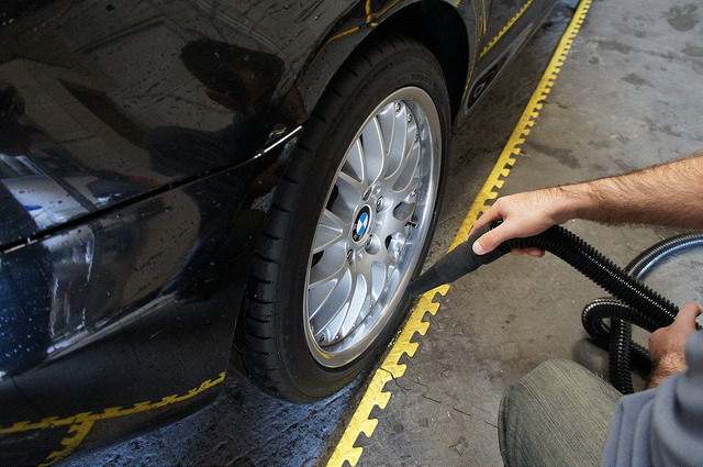

Next the car was thoroughly dried with Uber Drying Towels and Aeolus 901X blower:
DSC07953 by RussZS, on Flickr
DSC07955 by RussZS, on Flickr

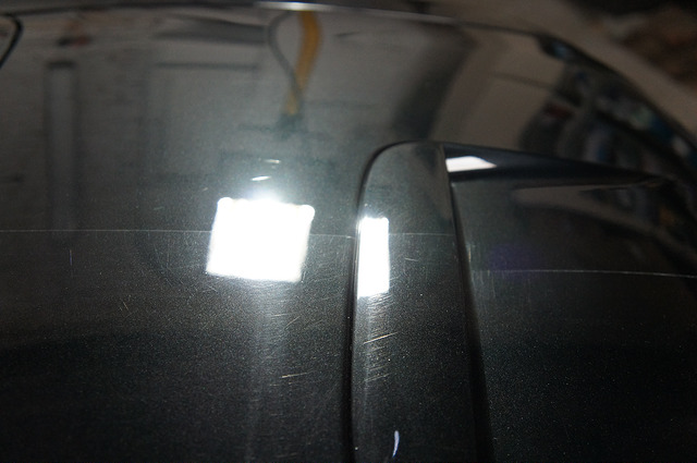

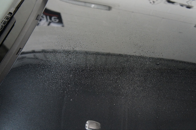

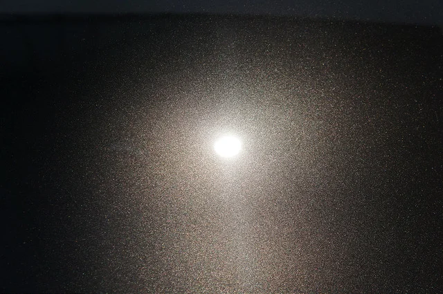

Some general pics of the defects present:
DSC07956 by RussZS, on Flickr
DSC07965 by RussZS, on Flickr

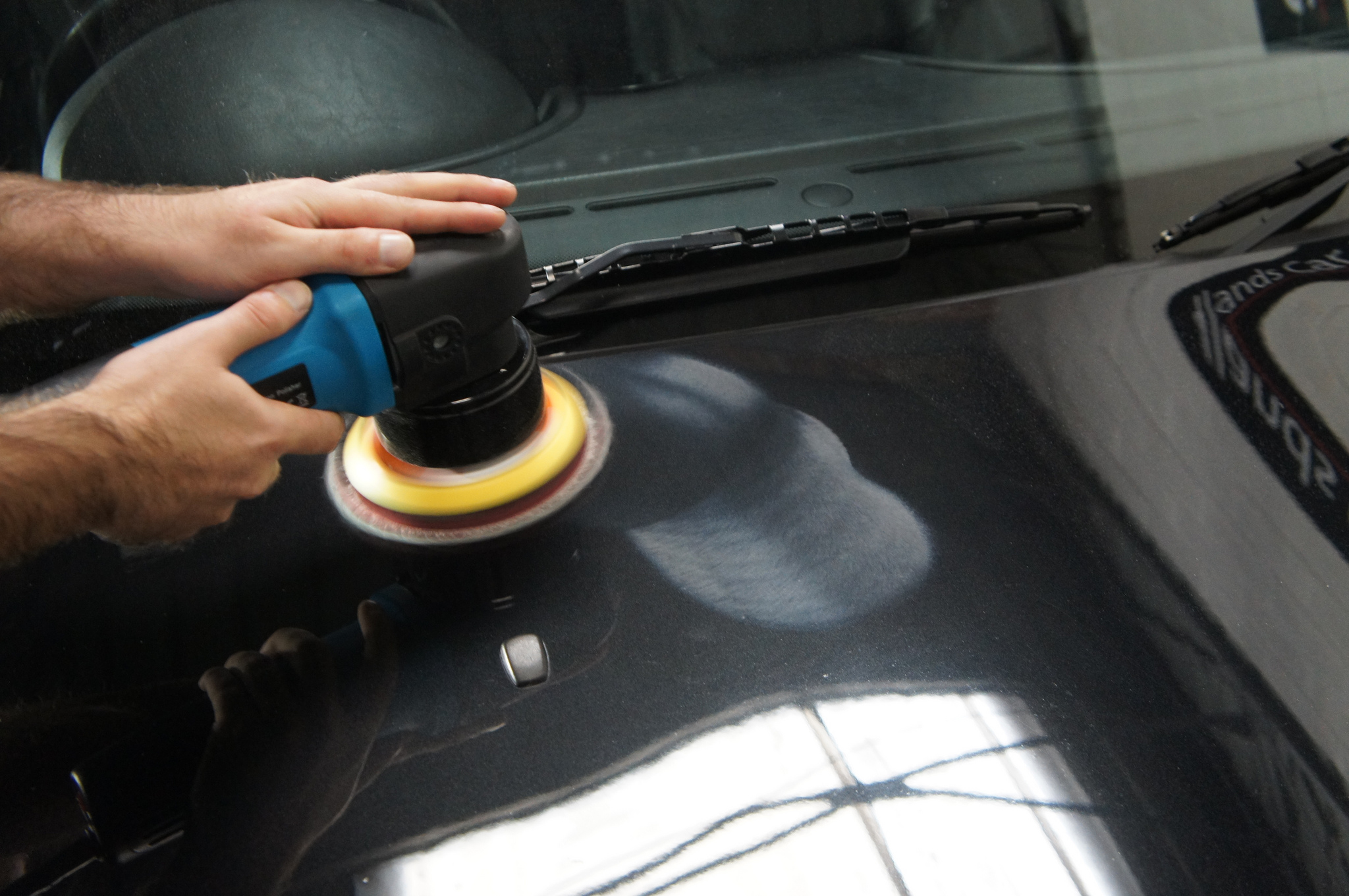

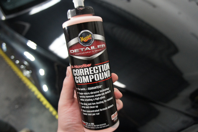

After trialling a few combinations, I found that the paint to be surprisingly sticky!! The panel was getting very hot, very quickly using relatively low speeds and a medium cut combination (3M Yellow Pad and Megs 101), so decided to go down the DA route on this detail. After assessing a few options including Megs 101, Optimum MF pads, Optimum Hyper Compound etc, we settled on Meguiars D300 and their MF Cutting discs.
DSC07979 by RussZS, on Flickr
DSC07978 by RussZS, on Flickr
DSC07980 by RussZS, on Flickr

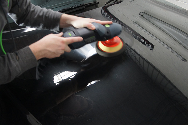

The product was worked around 4800OPM, which removed most of the defects but left a slight marring effect on the surprisingly soft paint:
DSC07990 by RussZS, on Flickr

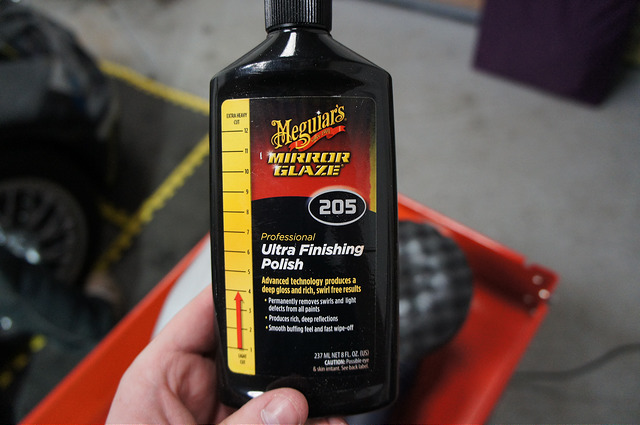

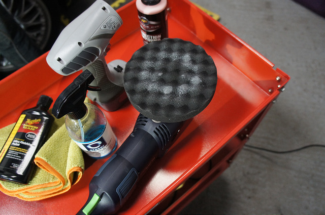

Therefore the paint needed refining further (which is the case I always find with the MF system) so I used Meguiars 205 via Festool RAP150 Rotary and the new Menzerna Finishing pad, spreading on speed 1, working at speed 2.5-3 and refining on speed 1.
DSC07981 by RussZS, on Flickr
DSC07982 by RussZS, on Flickr
DSC07993 by RussZS, on Flickr

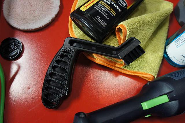

The new Meguairs Pad Brush was also on test today, with pleasing results!
DSC07984 by RussZS, on Flickr

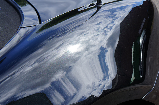

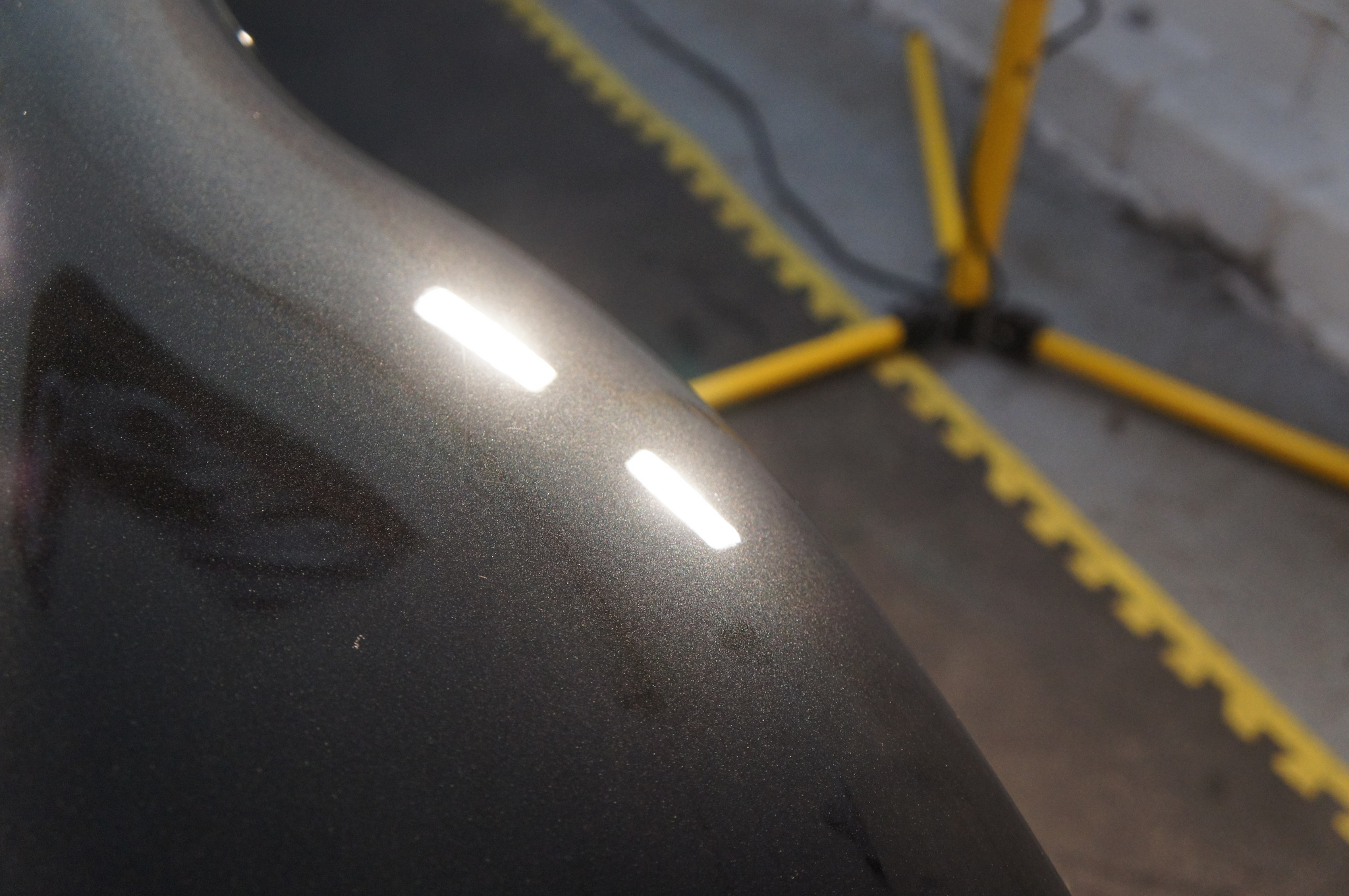

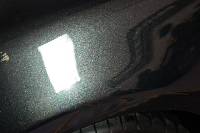

After refining, the flake pop was superb:
DSC08032 by RussZS, on Flickr

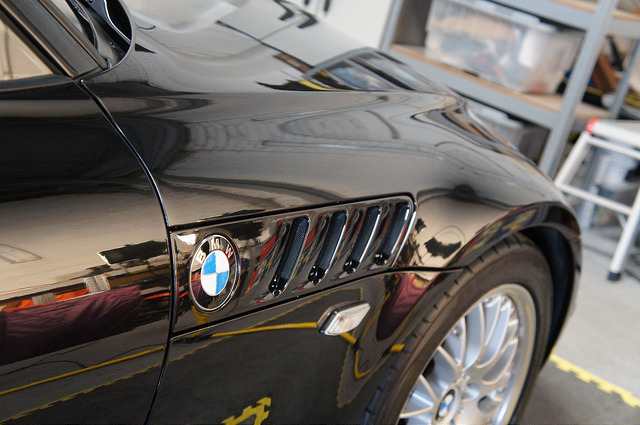

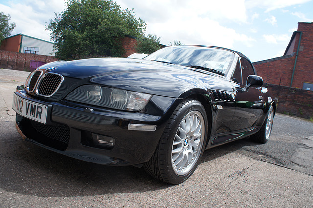

Finally, some afters:
DSC08047 by RussZS, on Flickr
DSC08048 by RussZS, on Flickr
DSC08051 by RussZS, on Flickr
DSC08053 by RussZS, on Flickr
DSC08055 by RussZS, on Flickr
DSC08056 by RussZS, on Flickr
DSC08057 by RussZS, on Flickr
DSC08062 by RussZS, on Flickr
DSC08069 by RussZS, on Flickr
Flake not muted at all from BOS:
DSC08070 by RussZS, on Flickr
DSC08076 by RussZS, on Flickr
DSC08078 by RussZS, on Flickr
DSC08081 by RussZS, on Flickr
DSC08082 by RussZS, on Flickr
DSC08085 by RussZS, on Flickr
DSC08089 by RussZS, on Flickr

What do you think of the Meguiars D300 and the MF kit? Im thinking about putting and order in. Have you used the D301 or worth giving that a miss?
  Megane R26
Its good on the right paint, but will make a mess of softer paints so it depends on the car really. 301 is poor IMO and leaves a very average finish. The biggest issue with D300 and MF Discs is the micro marring they induce in the clearcoat which isn't always apparent upon initial inspecion, so I ALWAYS follow and refine with a rotary to bring out the colour, gloss and flake.
It has its place but needs following up, ideally with a rotary.
  GTD, Lupo
Cheers Russ, you just saved me the best part of £70. Guess i better keep looking around at whats out there for me and my DA.
  Megane R26
Please don't not buy it, as it will speed up DA correction, but be sure to refine it properly afterwards with Megs 205 and foam pad, just not use D301.
  GTD, Lupo
Ok will still give the D300 a go but will drop the D301 from my list. Just one more question, out of 10 what would you score the D300 for cutting? Hard to find a definitive answer anywhere else so best ask someone who has used it.
Thanks again.
  Megane R26
Thanks again.
Depends on so many factors, but with right technique it matches wool on a rotary on some paints...
You can swap out D300 for other compounds too btw to get more cut. The disc is the key part, not the polish.
