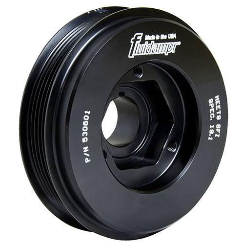

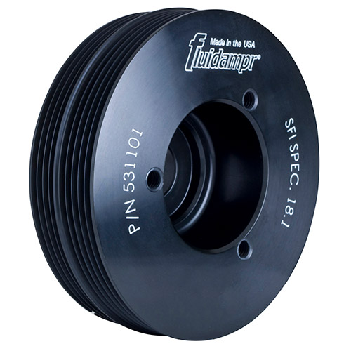

I'm actually looking at Fluidampr stuff as we speak, good idea, but the difference in pulley weight makes it unattractive.
They have a broader rev dampening range because of the viscous fluid combined with an inertia ring.
They don't make a pulley for Clio's, so I took the closest diameters.
Still wondering if some weight can be removed somewhere.
The Honda one looks least promising (unless the thick front ring can be removed), the Subaru one more so, IF you could seperate the front and rear
Standard: 123.0mm (1.0-1.2kg)
530601 Honda S2000 139,7mm (2.65kg)
531101 Subaru EJ 136,525mm (3.13kg)

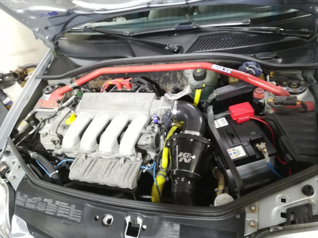

View attachment 1527256View attachment 1527257View attachment 1527258

Thank you all for your invaluable input!

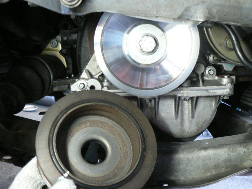

In fact, my 172 has been using lightweight pulleys since about 2012.
Of course we knew that it was unbalanced and that the crankshaft would twist.
However, the advantages of the lightweight pulleys were twofold.
1. Good engine response.
2. Semi-permanent use as there are no vibration dampers.
The disadvantages are as follows.
1. Concern about crankshaft twisting.
2. Rapid deterioration of the accessory belt, belt squeal.

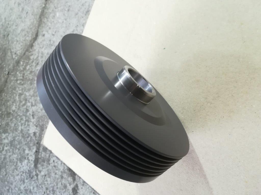

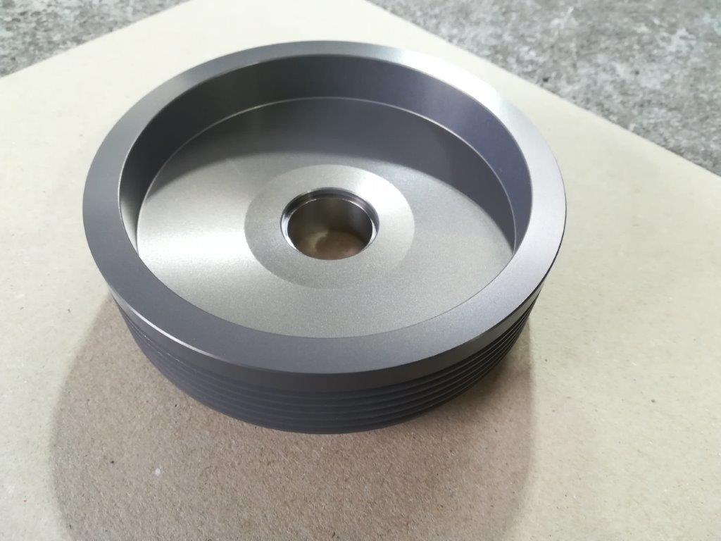

Aluminium pulley in the image.

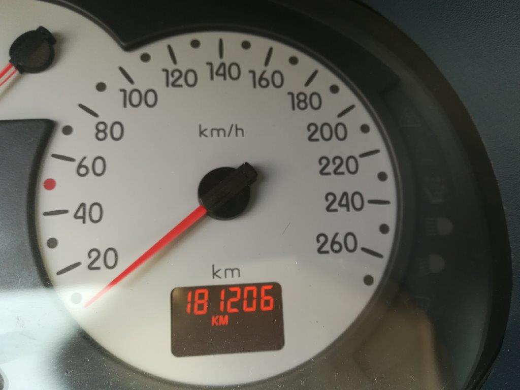

This aluminium pulley has been used since about 2012 for about 5,000 km (31,000 miles).
My 172 currently has a total mileage of approximately 180000km (112,000miles).
I am the second owner and to date I have not had any major engine problems.
I think I'll go back to the original Renault pulley after your feedback.
Original Renault pulleys are available in my country.

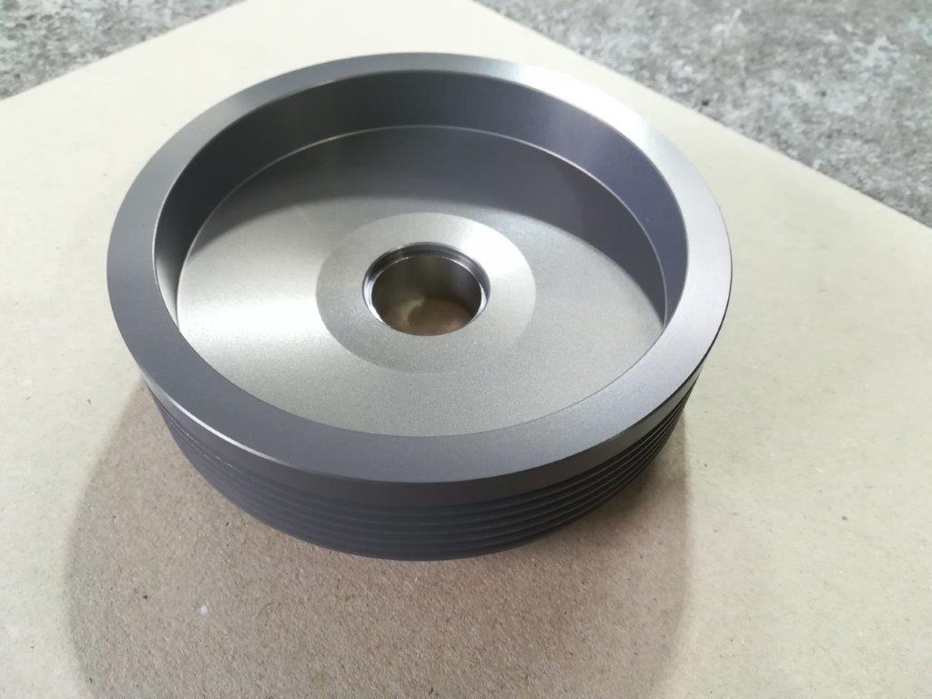

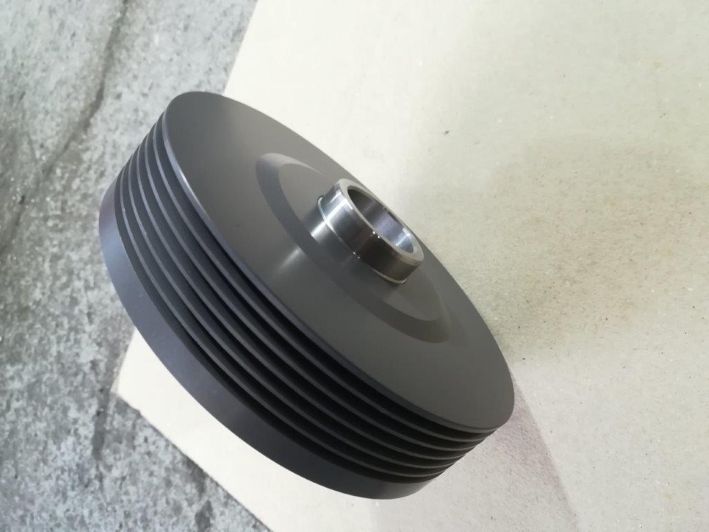

You don't have to worry, I have instaled lightweight pulleys on daily and race clios, also lightweight flywheels and some lightened crankshafts, and cars run for years now with no problem at all.
Check www.elmet.hr for this parts
