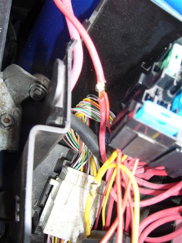

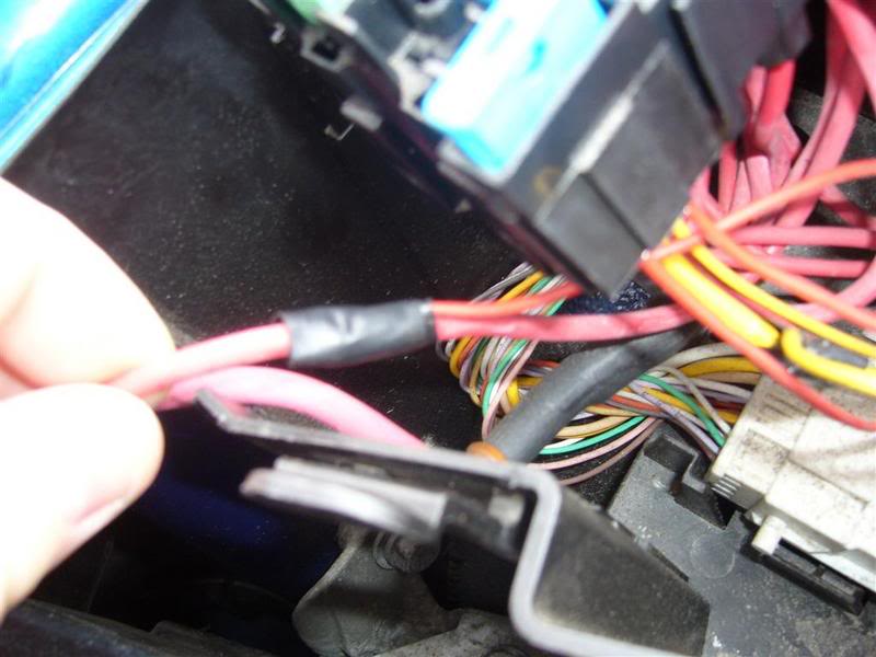

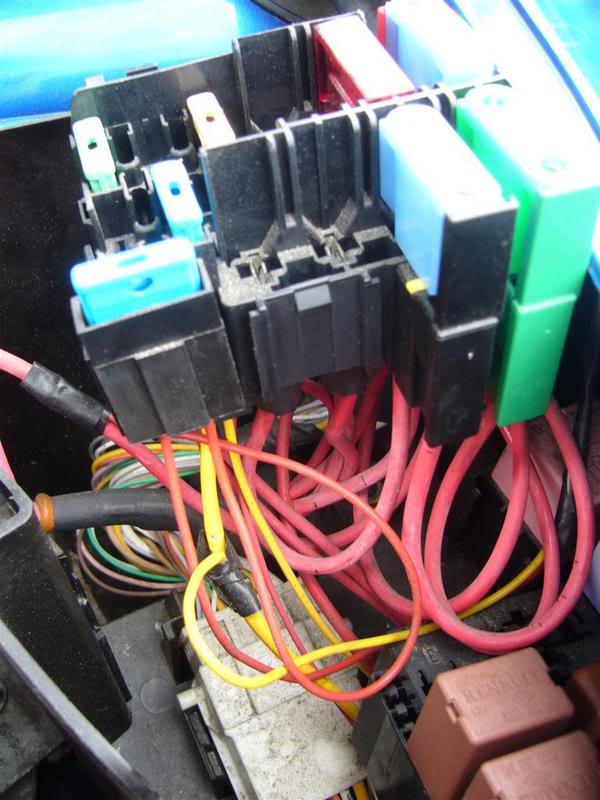

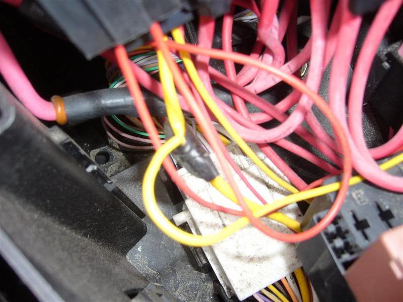

Good afternoon folks,
Mike i have taken off the fuse cover, and had a good look in the fuse box for suspect wiring, and i found the following.
now it looks like it has been soldered together - is this normal???? and what is it exactly?
  Lionel Richie
they all get pissed abut with in there it seems, i guess its for the alarm, i've never checked, but mine had spliced wiring also
