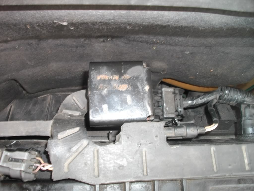

Yea ECU cover rubs through the engine loom. Its an Inlet off job but its not too bad to do, a couple of hours if youve never done one.

the box at at the back was very very lose m8te and it has been re solderd be fore almost a year ago but i am guna un ravile the electricle tap at the top and see if i have any isssues ill take pics to see if im looking in the right area.

the loom is about £125-£130 from renault. It's not just the cover rubbing that's the issue, they corrode quite badly too.
The inlet manifold removal is the worst part of the job. I'd always give the throttle body a thorough clean whilst it's apart, and replace all the gaskets (including the rocker cover)

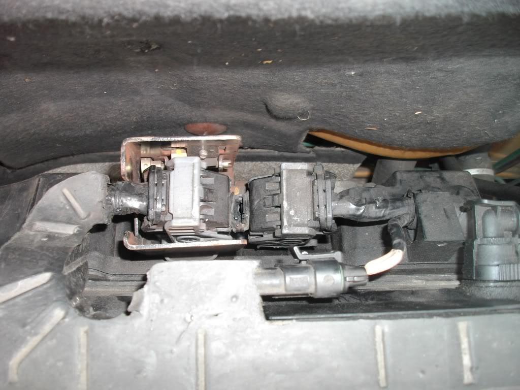

Just had a quick look and tooks some pics there has been some rubbin on the electrical tap but carnt quite see if its hit the wires.

get rid of that silly cover for a start. does nothing but damage
I think the damage has already been caused lol bad times.

Have this problem day in day out on d4f. The main problem is poor connections to the throttle body inside the manifold.

Monday tuesday im guna remove the inlet and have a look at all upper wiring loom to throttle pedal - throttle body.
