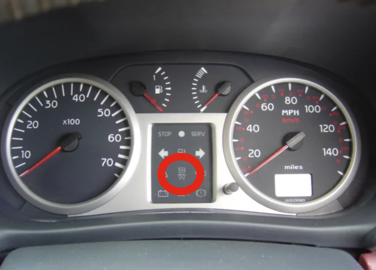

Hey there,
I think the topic says it all, but basically the car is running fine until I press the brake pedal. Then I get the limp mode plus the light on the dash.
I've tried not to use brakes at all, but I guess I'm not brave enough in traffic :)
I have a Carly, which says error Internal GR92 - Engine Control Module - This fault results from a generic communication issue in the ECU.
If I go full throttle or 2/3 throttle and left foot brake the error doesn't appear, but if its below 2/3 throttle or idle and touch the brake pedal the error comes in straight into limp mode. Going to the shop and back is like 40 restarts of the engine. It makes me crazy.
Do you have any ideas?
Thank you in advance.
