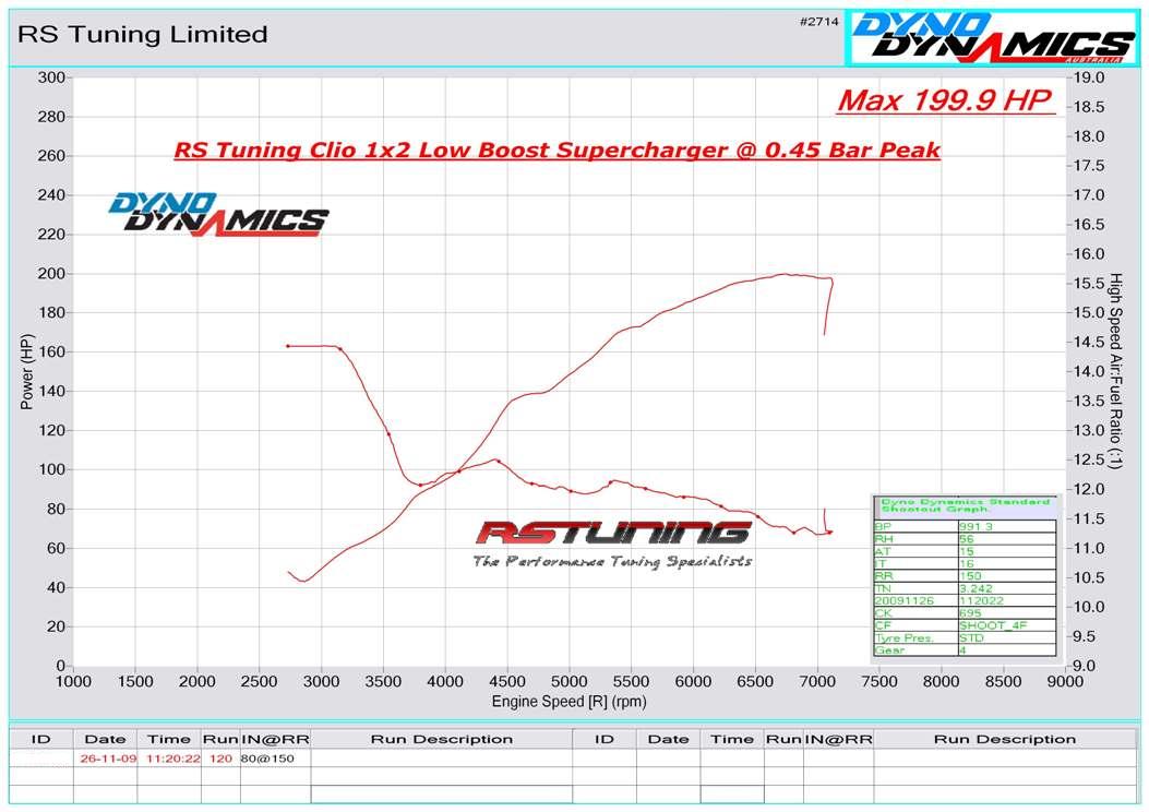

excess crankcase pressure as stated by danny, stock bottom end + boost = fail! F4R's do suffer with oil drain at high rpm anyway, but if its doing it at normal revs (3000-6000) then there something amiss downstairs!! Does it run too rich? Could be something as easy as bore washing!
AFR is fairly spot on, runs lean if anything!
Couple of other people I've spoken to have said cracked ringland. Don't know much history on the engine, usually ran fairly hard, it was bound to happen! Just building forged engine sooner than I though but its not like thats a problem ;)
Now don't start another Mapper Vs. Mapper thread please ;) :)
