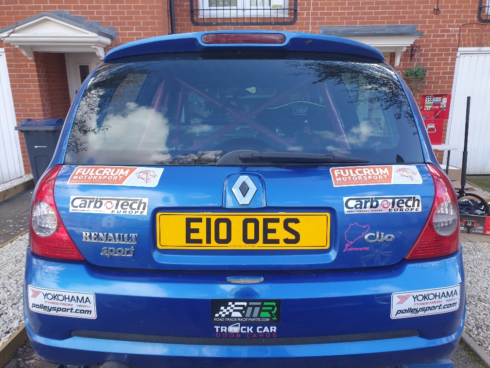

From what I have noticed.. a Campus bumper carries the rear number plate and the tailgate is smoothed over.. A Sport model car 172/182 have their number plates on the actual tailgate in a recess and the bumper is smoothed over.. So basically what you are asking for isnt a direct replacement for your Campus..

aye was looking to replace the original bumper withe the 172 one. Might be wrong but i thought it was a direct fit.
I wasn't saying it wont fit.. I'm saying if you do change the bumper to 172 then you'll have nowhere to screw your number plate and illuminate it.. Your number plate is where my RTR sticker is...
