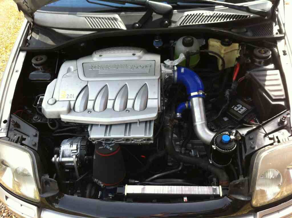

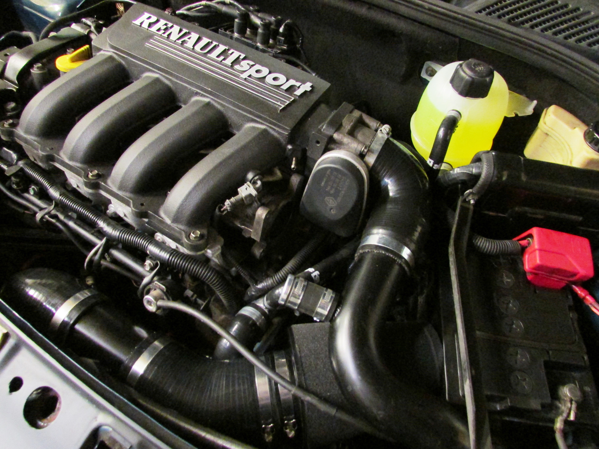

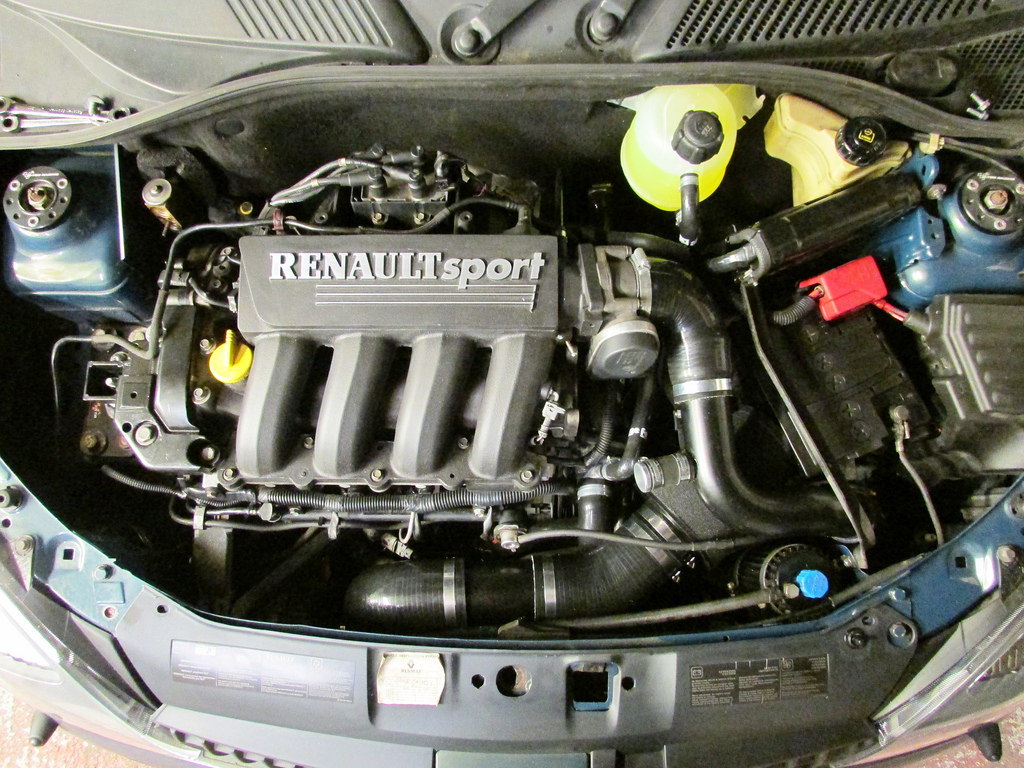

Agreed, no harm in asking questions. The owner can hopefully answer questions with confidence along with photographic evidence and/or invoices to back it all up. Like anything go with your instincts, if you don't feel positive vibes from the answers or info politely walk away afterwards.
Regards supercharger conversions, as mentioned the biggest outlay for a failure will be the supercharger itself. No rebuild and an outlay of around £1100 for a new unit, other than that there isn't much in the way of parts from the supercharger kit compared to the turbocharger kits.
Intercooler
Boost pipe runs
Supercharger unit
Oil cooler and associated lines, Header tank for traction fluid
Induction run layout and air filter
Bare in mind it should also have (In my opinion on some)
Megane 225 injectors
Megane 225 Crank pulley
Complete Phase 1 Clio 172 fuel setup: Fuel rail, fuel lines, fuel sender
Walbro 255 fuel pump
The Phase 1 fuel system is a much more stable fuel system on turbo/supercharged Clios
. by Ricard o1, on Flickr
