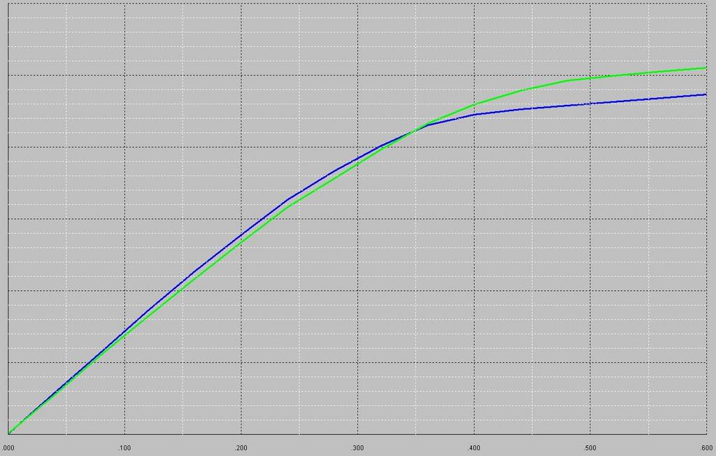

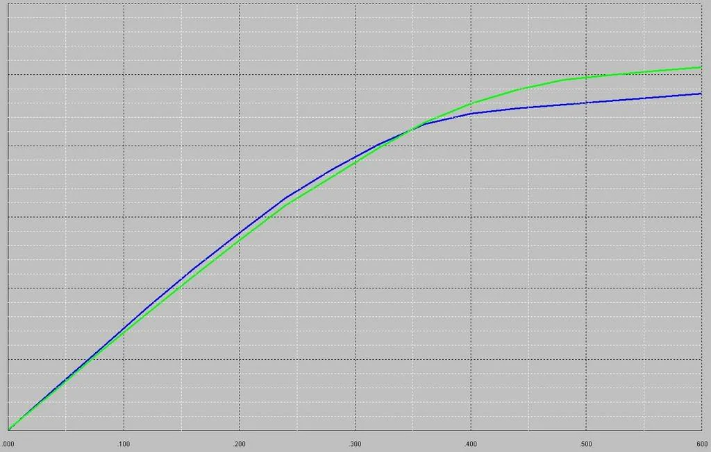

was going to say, ja.jack is talking about the F4 as it is CNC finsihed, the F7 is plain cast and not as good in stock trim.
However, if that were the case then i wouldnt see these sort of flow gains with JUST a valve seat job and shortside blend.
Inlet
Blue is stock head with just CNC valve job, and the green is the older traditional spec stock valve ported head. As you can see, upto lifts of 0.35" or 8.9mm the VJ only outperforms the ported head....and since the stock engine only lifts up to 9,9mm your pretty much quids in for cheap flow gains since there is no extensive porting to do, thus no labour.

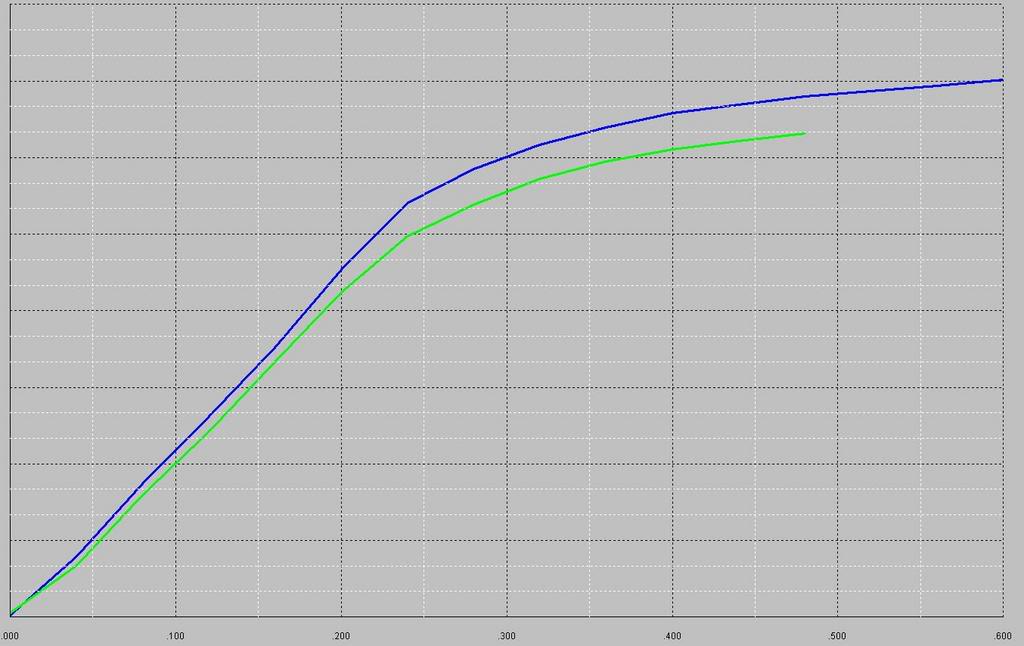

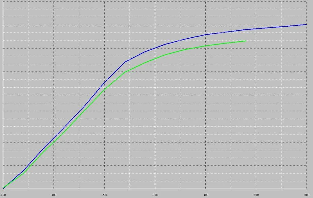

Ex
Blue is CNC valve job on ex, green is stock ex, but the gains are even better.
This is without even any porting bar a short side blend into the new VJ which is what i've been spending alot of time developing.
So IMO, its worth doing the new valve seat design rather than full headwork on midly tuned motors. New peak flow fully modified figures are now substantially higher than previous work.
