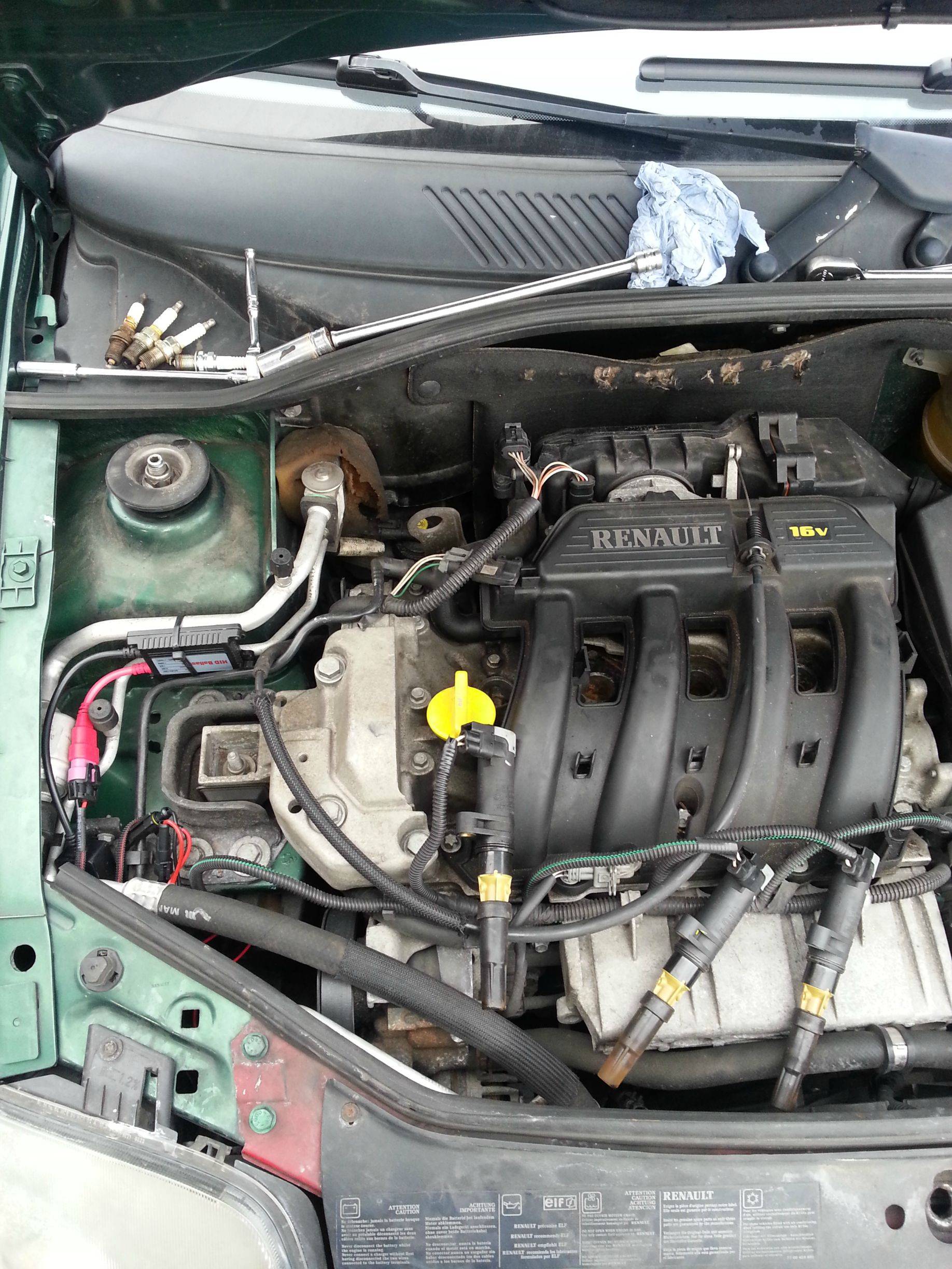

Here's what they look like on my 1.4L engine. The wire that goes into them unclips, and the little bit that stick out is where the screw goes on mine.

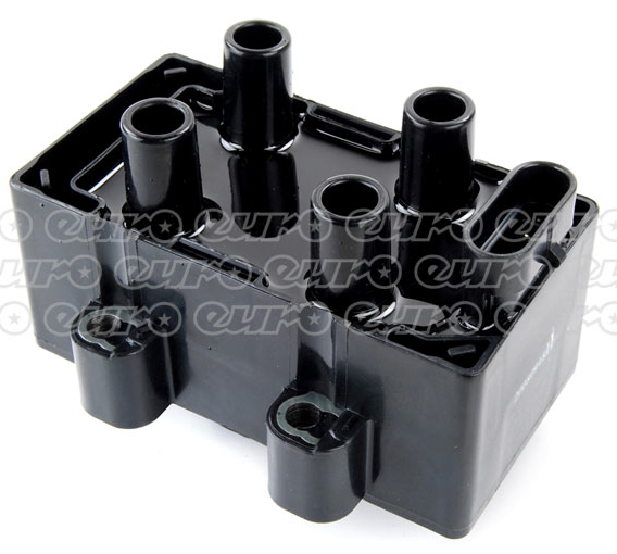

Nope. 1.2 doesn't use those. This is a coil from a 1.2:
