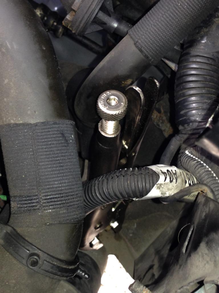

If you can't get at the clip from the top, get the front up on axle stands, undo the bottom of the front bumper and try and get access from there. Not the best picture... but.. here's me removing part of the bottom rad hose with them from the top.

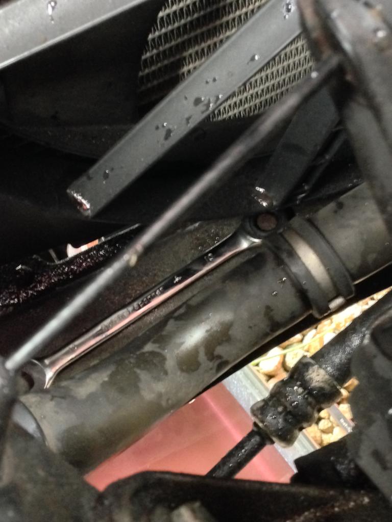

Also if you're removing the hose entirely, you might have trouble with the bottom hose where it's held in place, bottom centre of the rad. Just keep spinning the bolt slowly with a socket set, while applying some upward pulling force and it will come out. Don't use a ratchet spanner like me!
