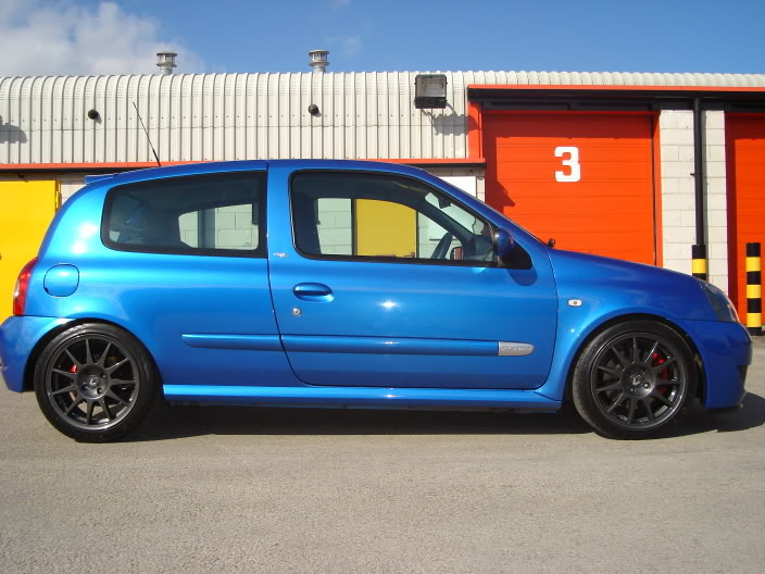

how mine sits with the gaz rear set up....^ (currently)
how it sat wiith the h&r set up (last summer ish)
