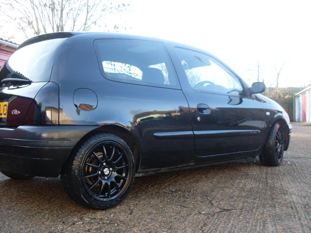

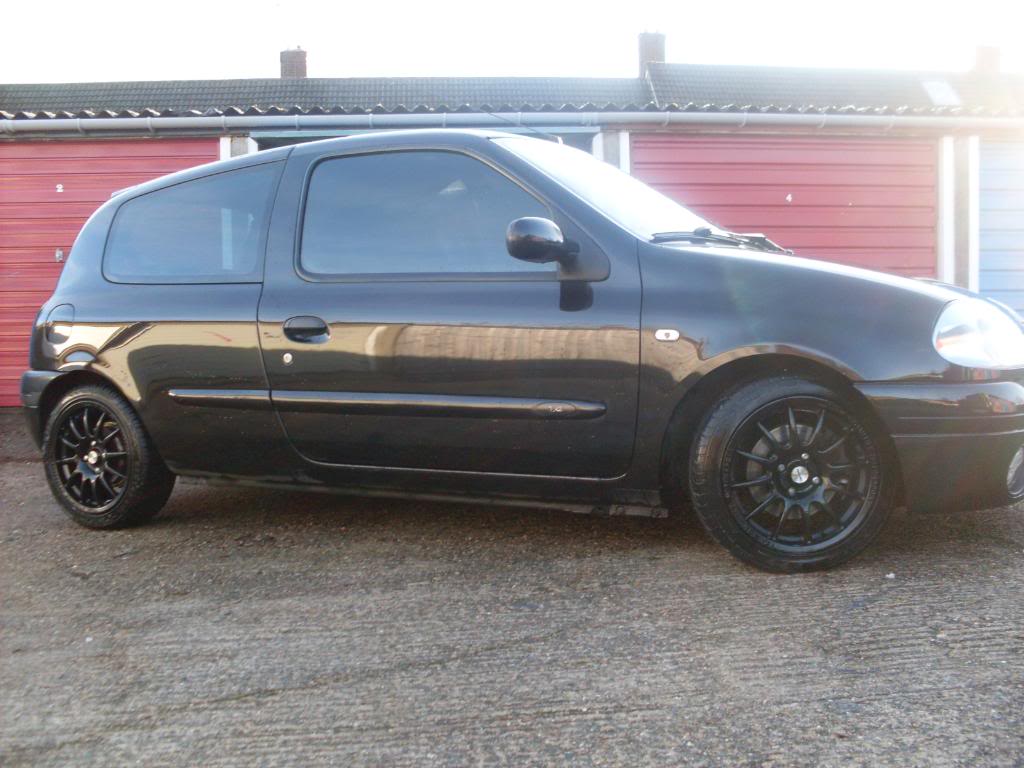

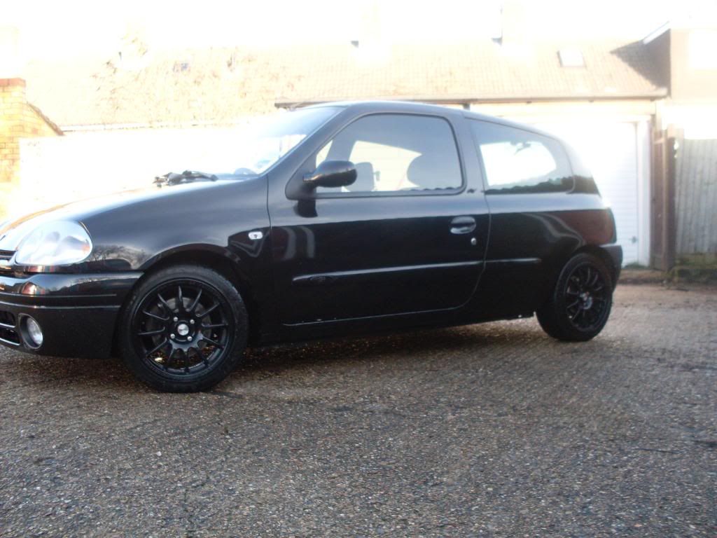

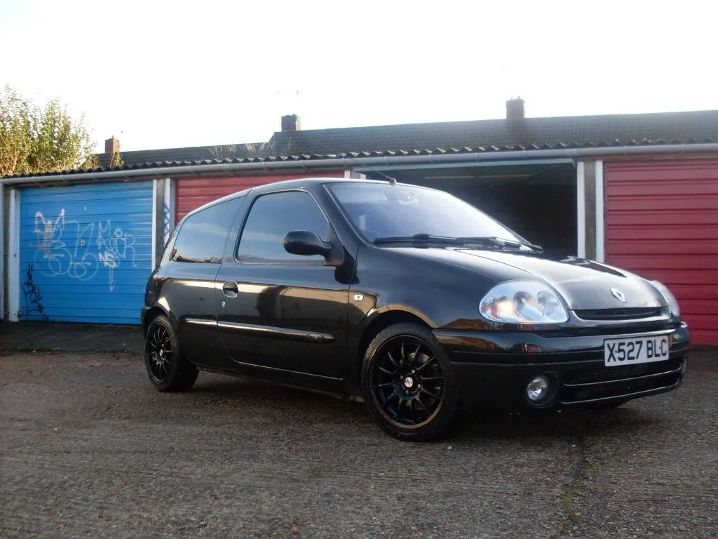

Fitted the 60mm KTR springs today, here are some pics... hopefully it'll drop a bit more when they settle in. comments welcome!!

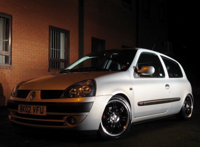

wtf!! bet i luk tw*t, honestly tho m8, mine is genuine 60mm ktr apex fings (yellow) same as wot u have and mine sits tonnes lower at bak, my pic was only taken 1day aftr having them fitted, and are still bedding in and going lower?...makes me think ive done somefin wrong?? yours luks smart but deffo not same drop as mine??????

did u put the bump stops back in? and has yours got lower now thay have been on for a little while now?
just a black rubber thing. dont fink it would make alot of difference but some1 said to take them out. ahh well, we'll c over the next few days.
not sure what the hells going on this those springs,
min are apex60mm springs from ktec,
it sits lower than the first picture, but its on 17s so it might just look that way
looks nothing like that silver ph2!!!
That silver one looks lowered about 90mm lol.

looking at both of them has confused me now as to which springs to get.Have you both put eveyrthing back in propeyl, as the black one looks like 40mm and the silver looks like 90mm as said
everything is bk in as it came out.. does any1 know if it wil drop a bit more as these are brand new and only fitted today? if so.. roughly how much..
Dude they def aint 60mm i would have a word with ktec, i live around 2mins from there and ive seen a few round my way with 60mm springs and they look like the silver one.
Hope you get it sorted mate. Car will look ace when its slammed tho!
taking bump stops out wont do anything but f**k your dampers as they act as dust covers to stop dirt n s**t getting in and plus the dampers go lower than they should causing them to bottom out and bursting the seals
i ordered 60mm springs, have emailed ktec and just got to wait for there reply! i just said that theres no way the springs i have are 60mm and sent them pics.
i think they mean the bits of rubber that sit above and below the spring
cheers alex. And for those that are interested, i have spoken to ktec, i got the part no.s from the springs and it turns out that the rears are 40mm, just got to wait for ktec to confirm, then i should think they will send me some 60mm rears instead :)
