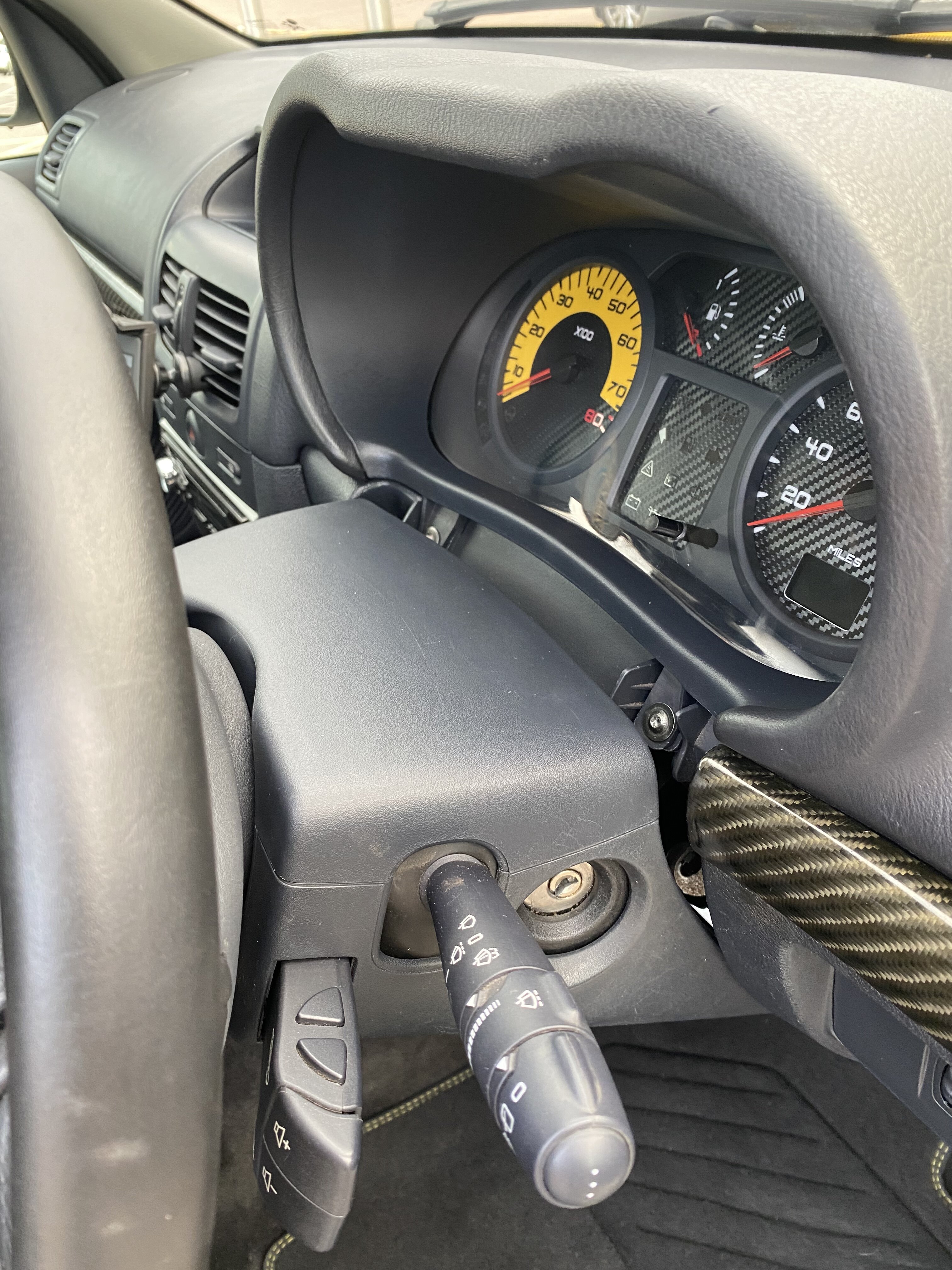

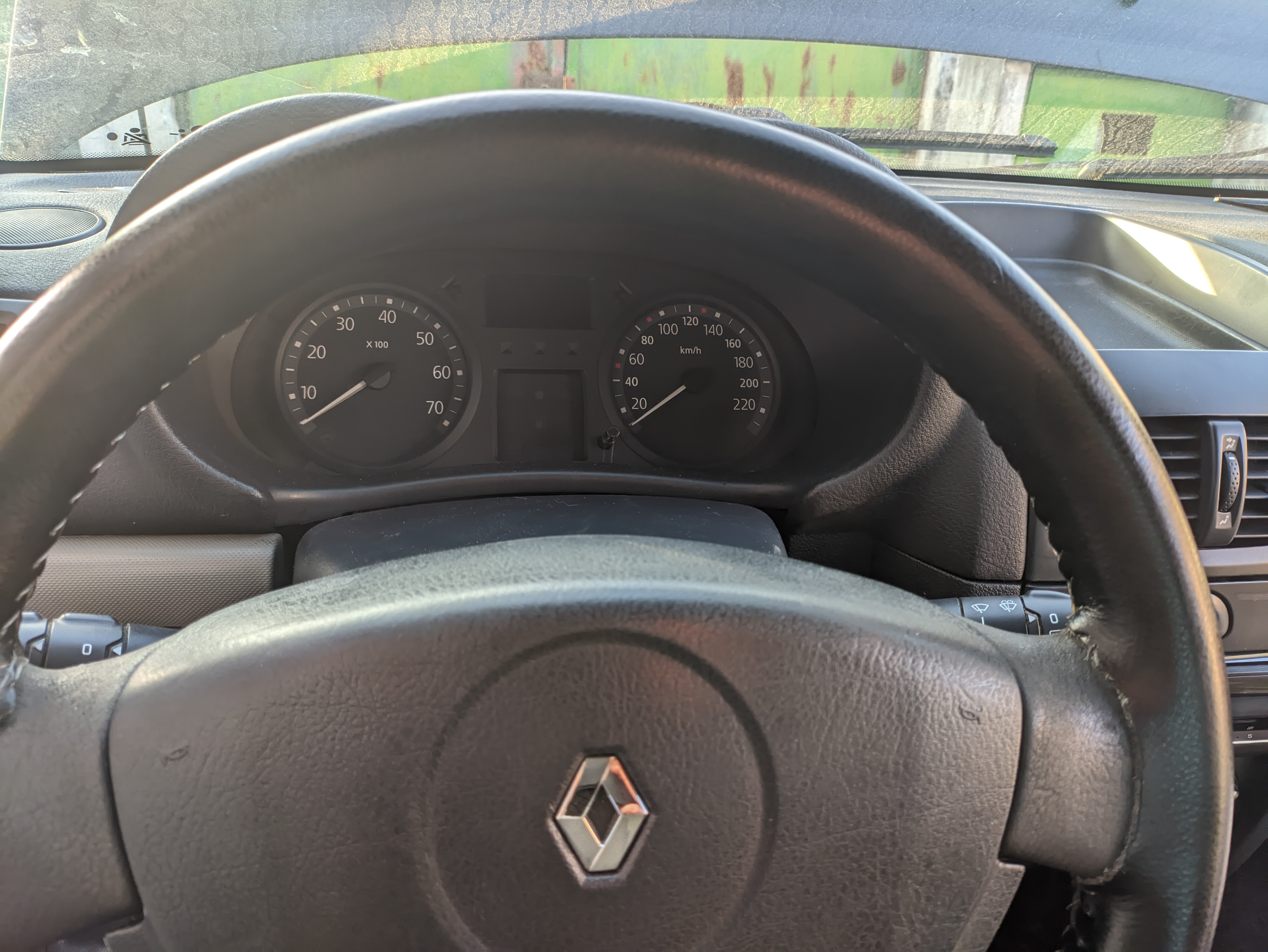

So had another go tonight, bent the tabs so the column appropriately. Fitted the spacers made by @VenomUK.
Absolutely perfect for me, I can see the dials perfectly and the steering wheel is at a much better angle. Look like that even with around 8mm spacer I have lost around 1” in wheel height.
One thing that annoys the crap out of me now though is the gap between the wheel cowling and binnacle, so next job is to make some kind of leather ‘cover’ like more modern cars seem to have

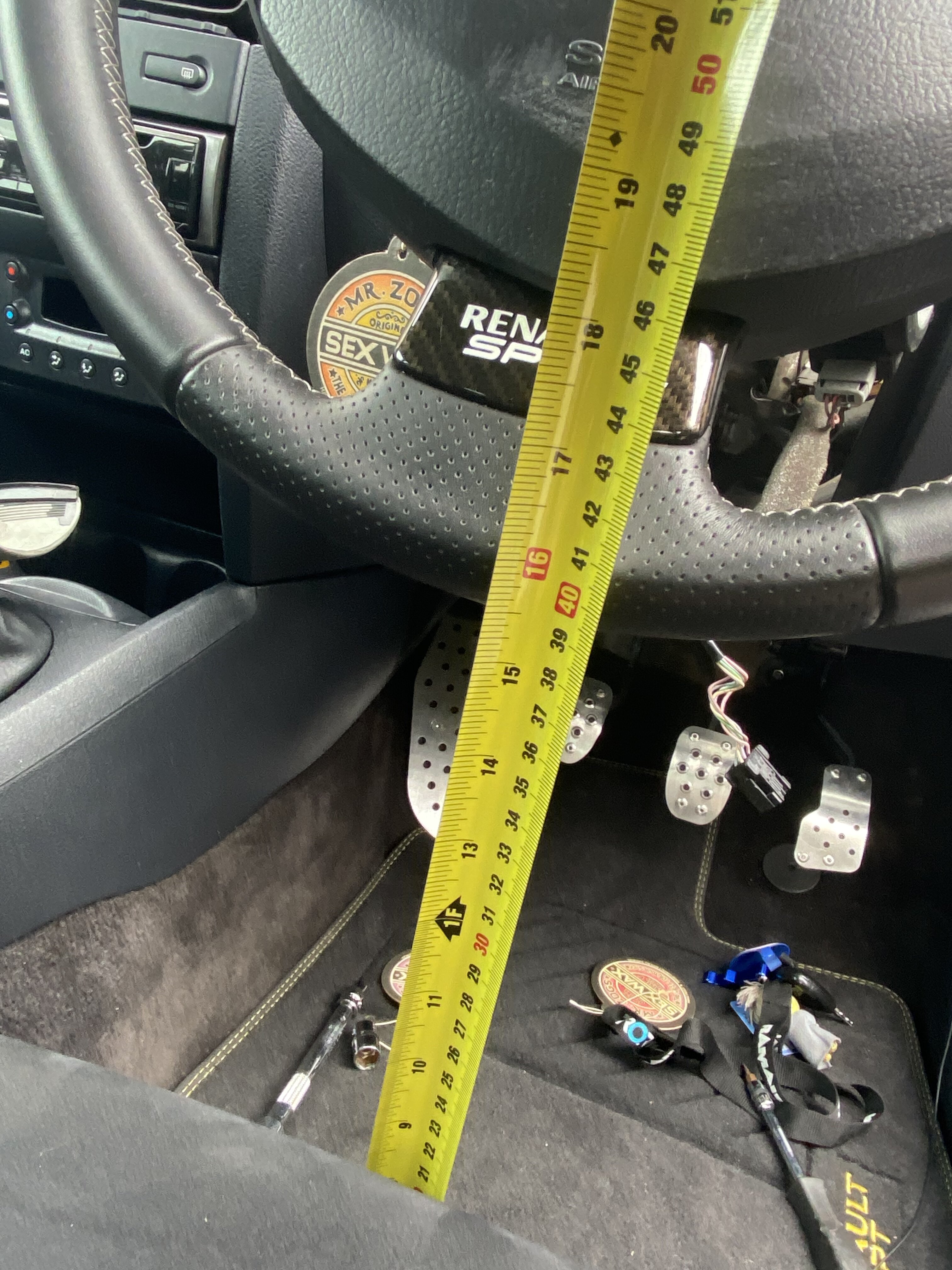

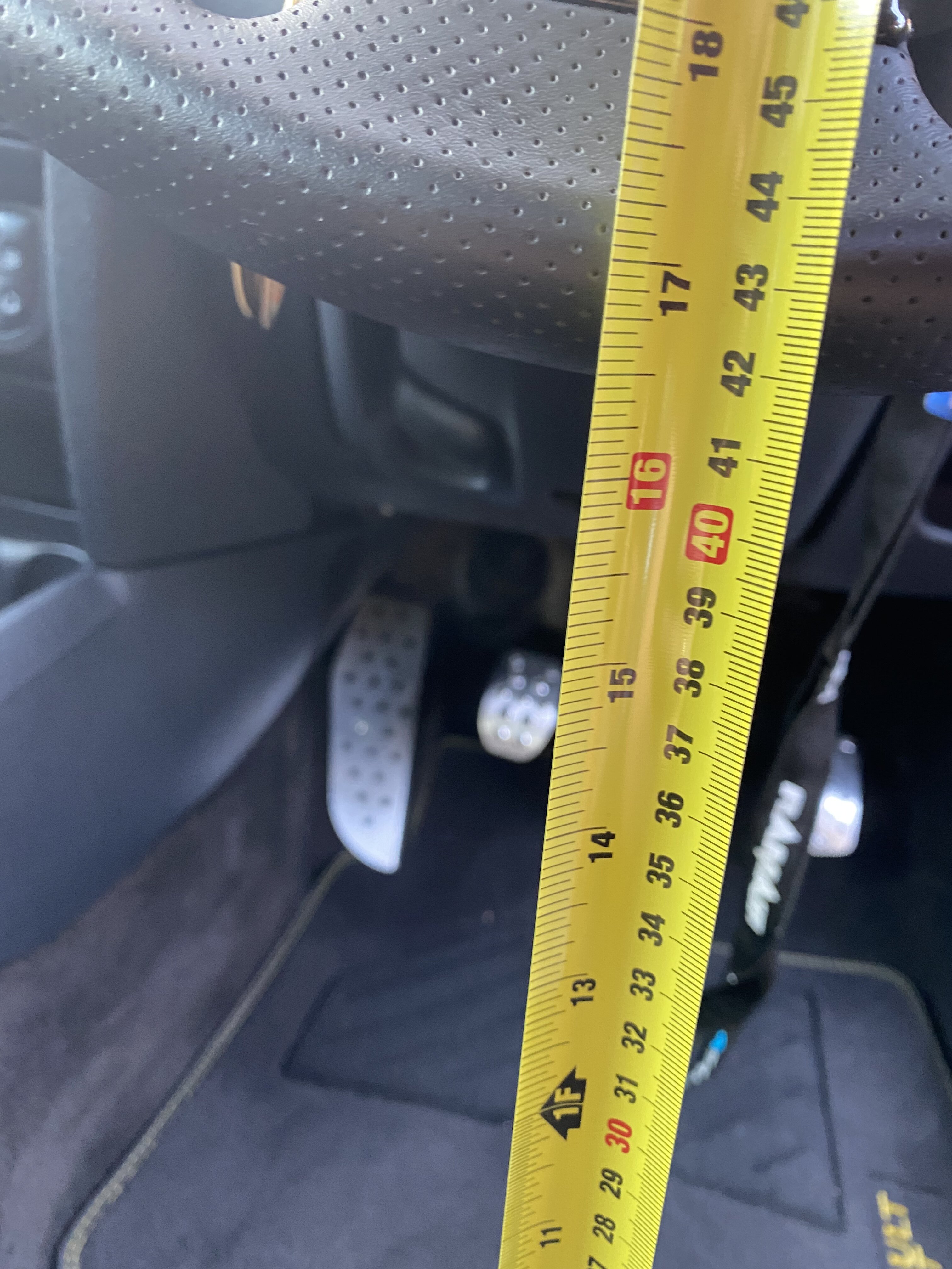

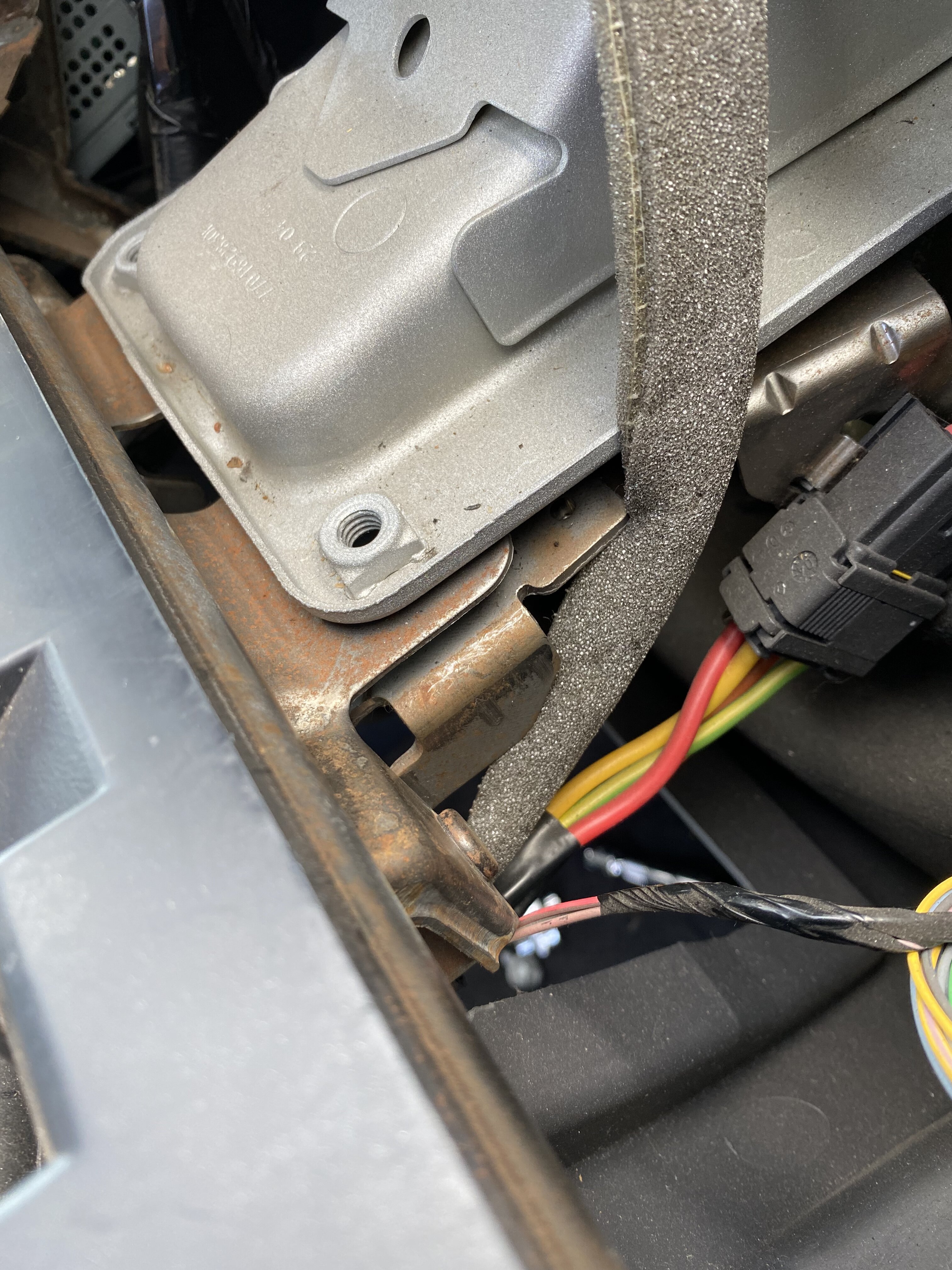

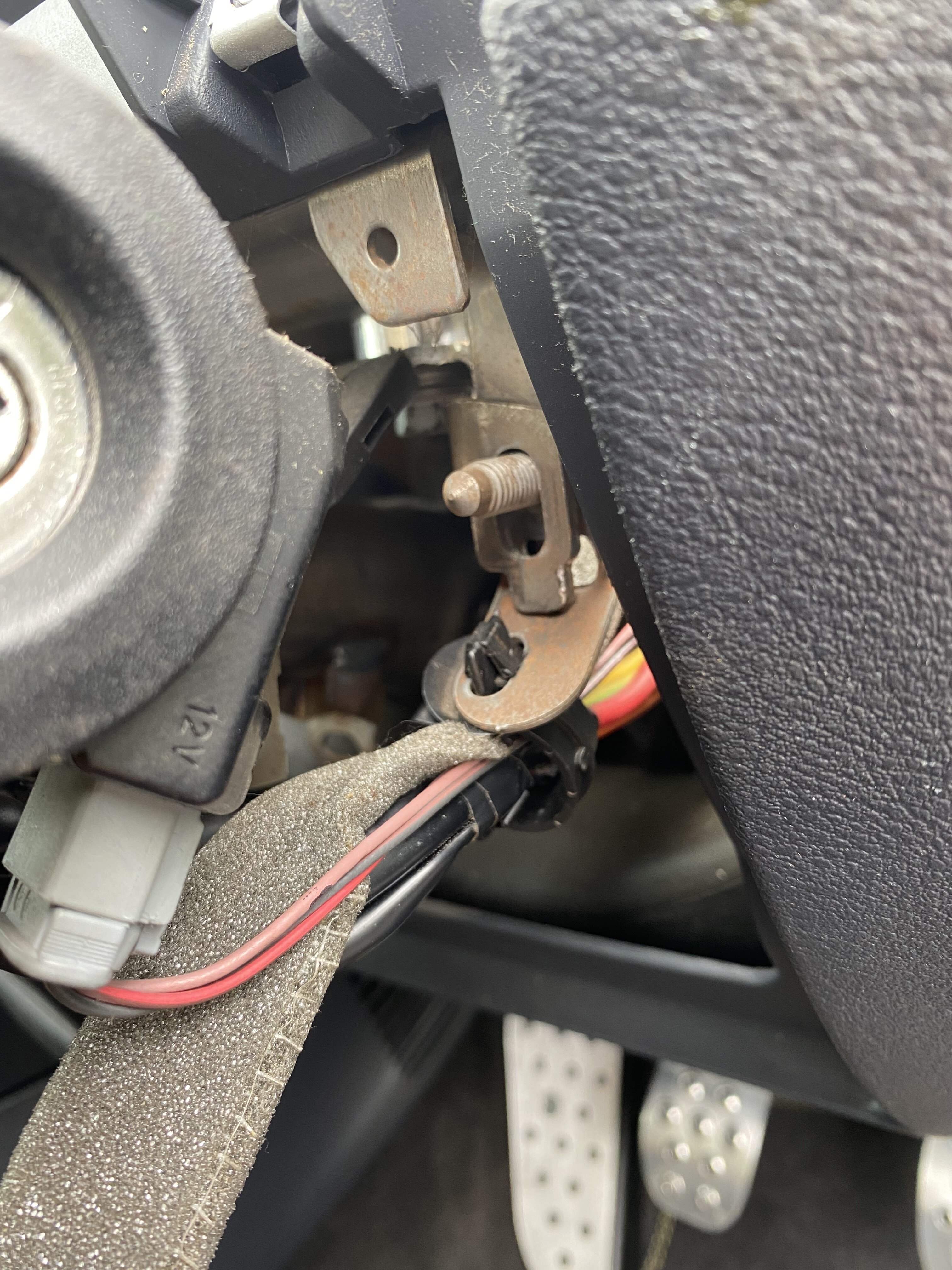

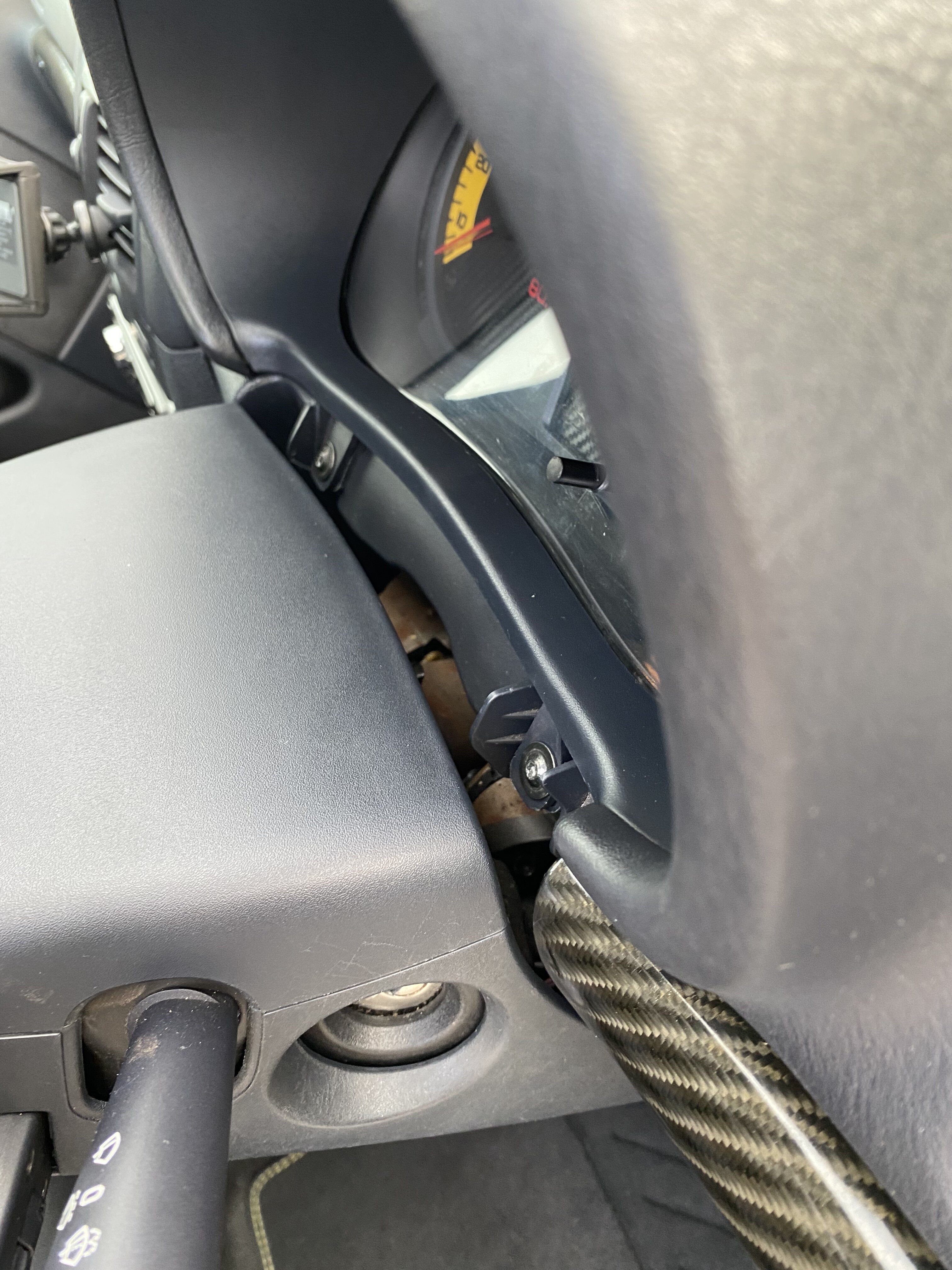

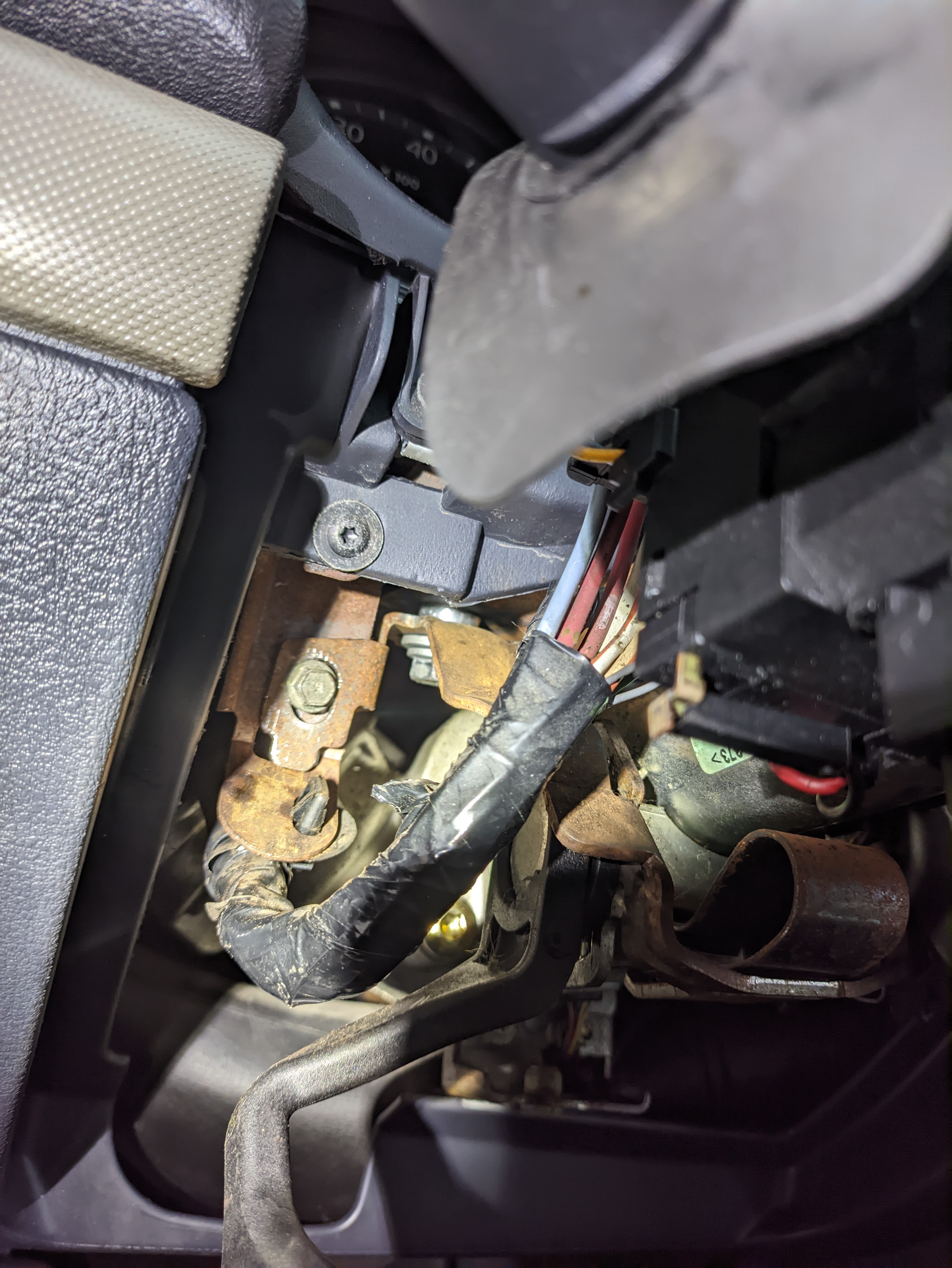

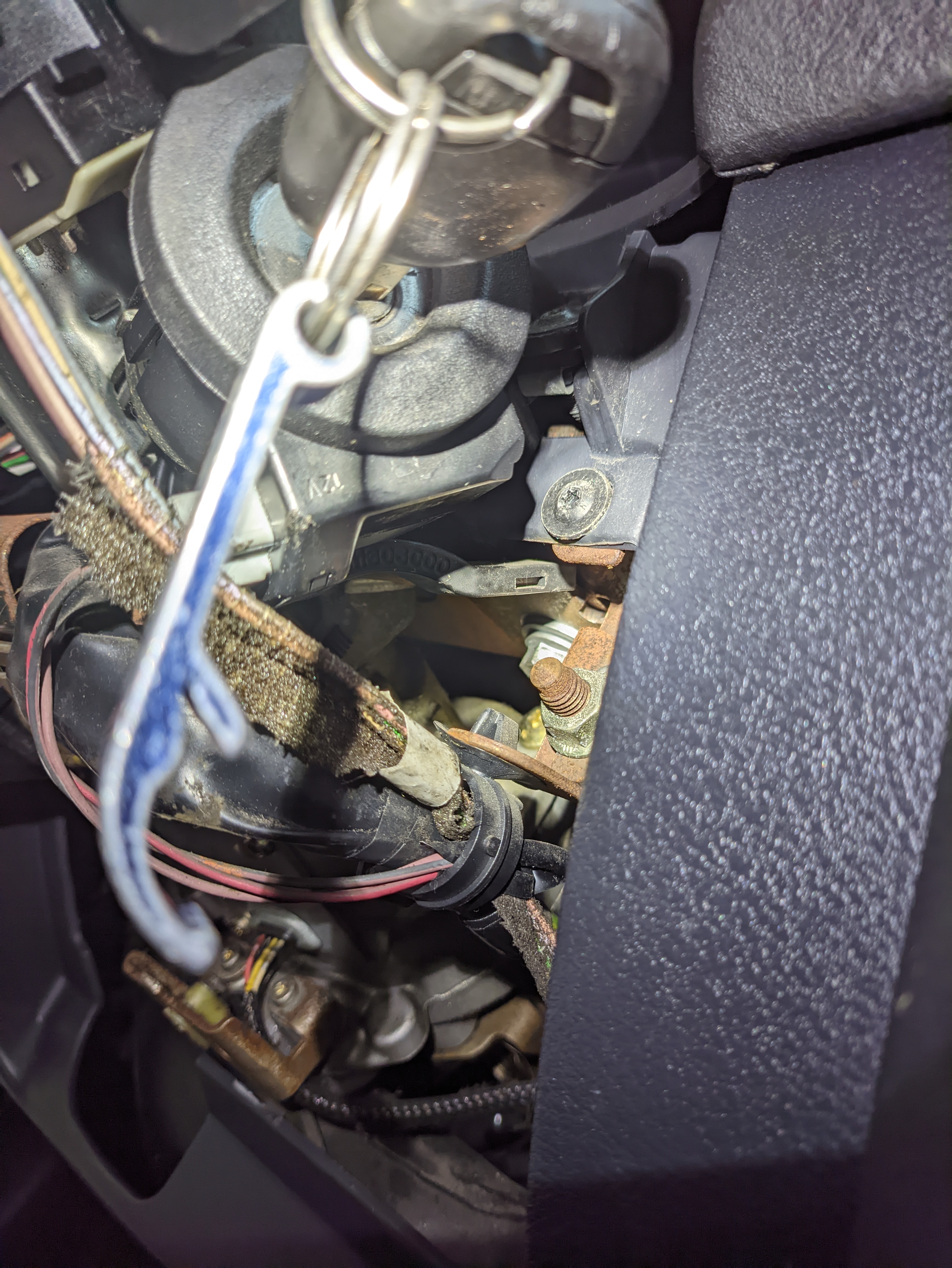

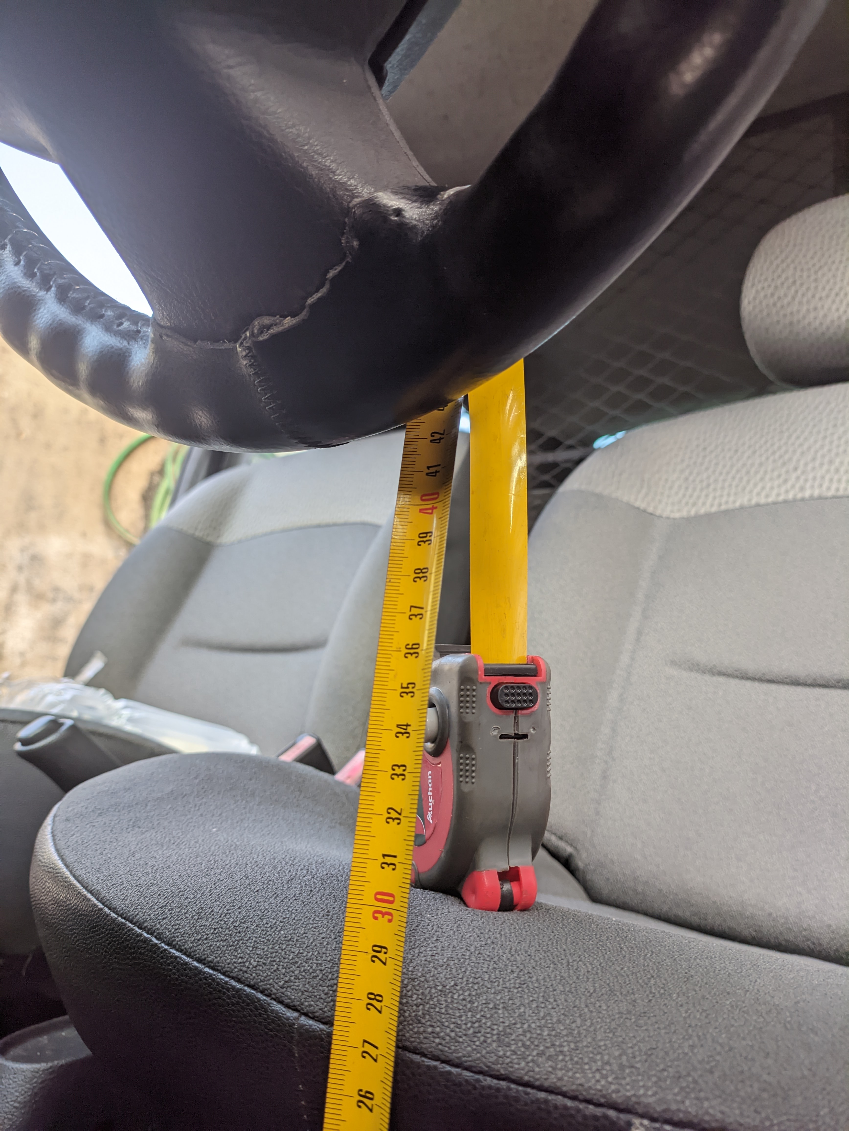

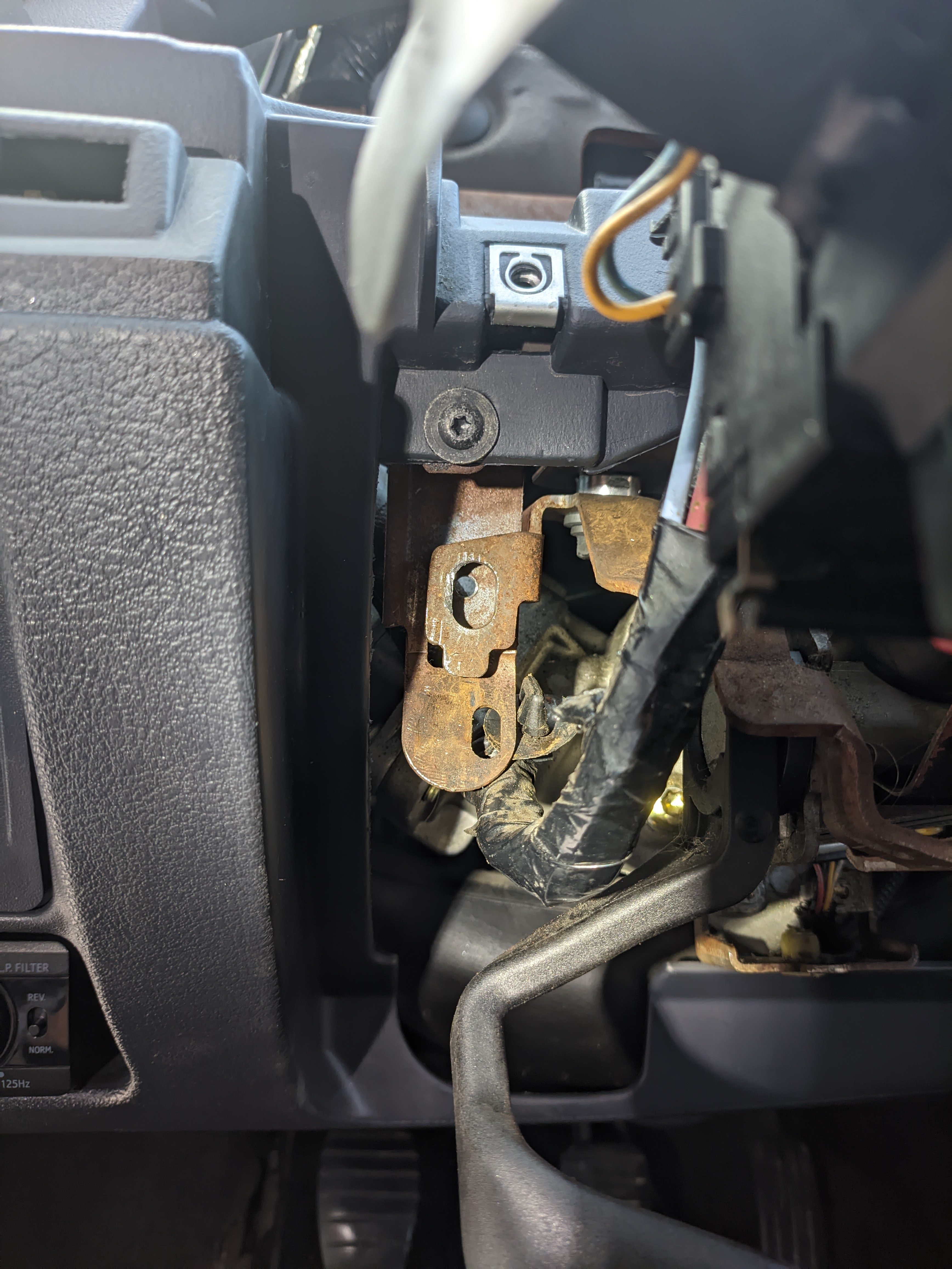

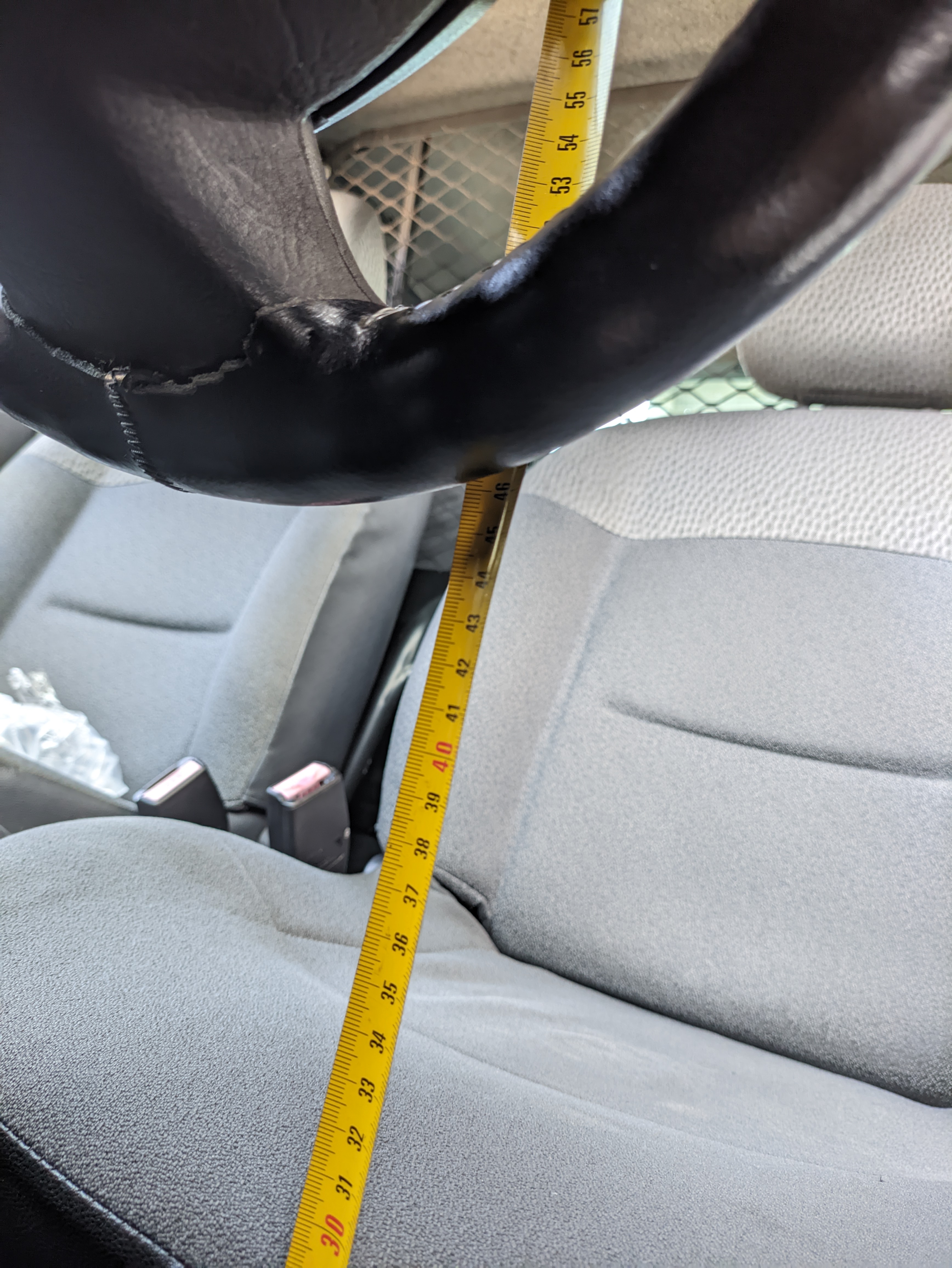

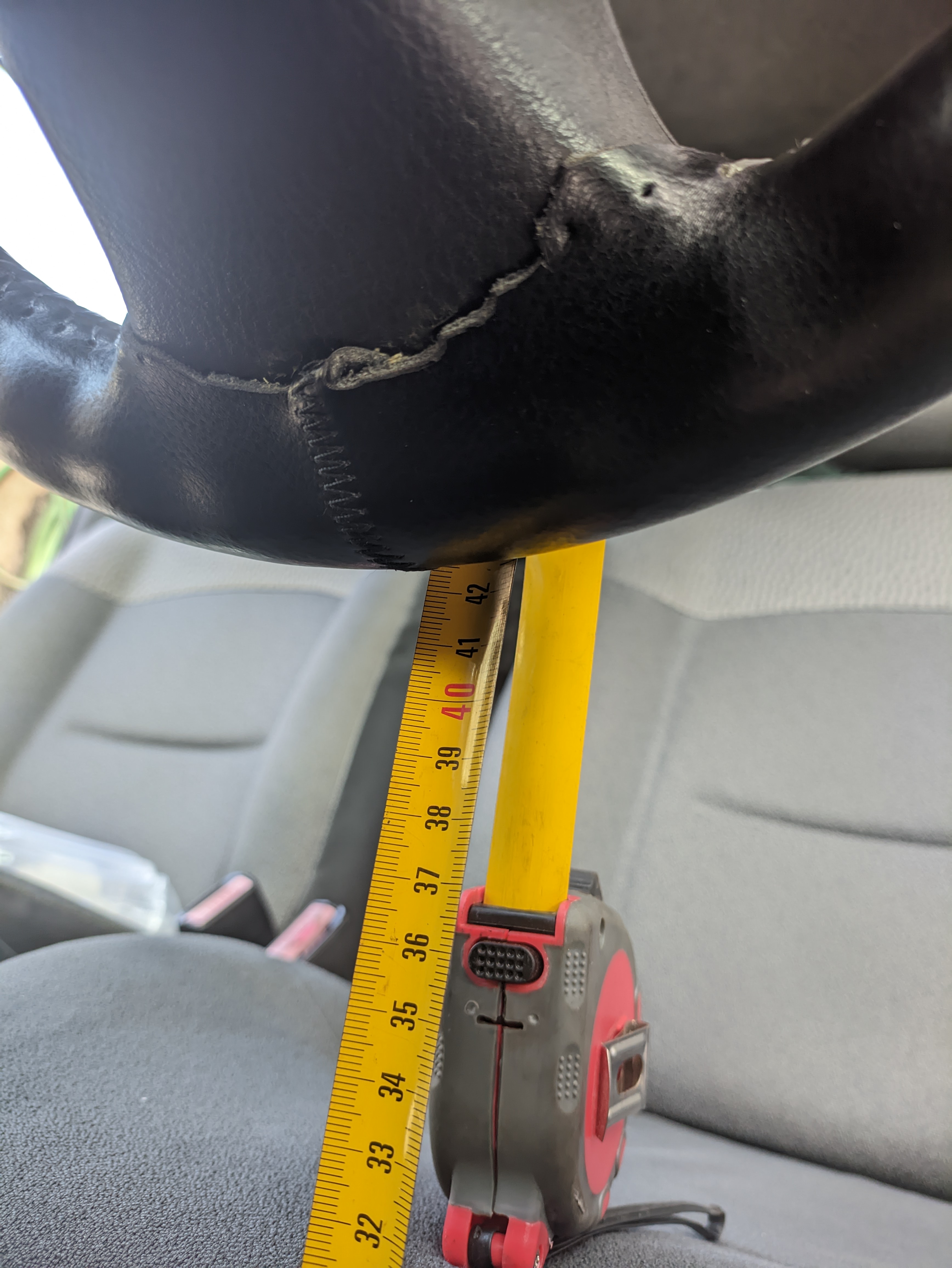

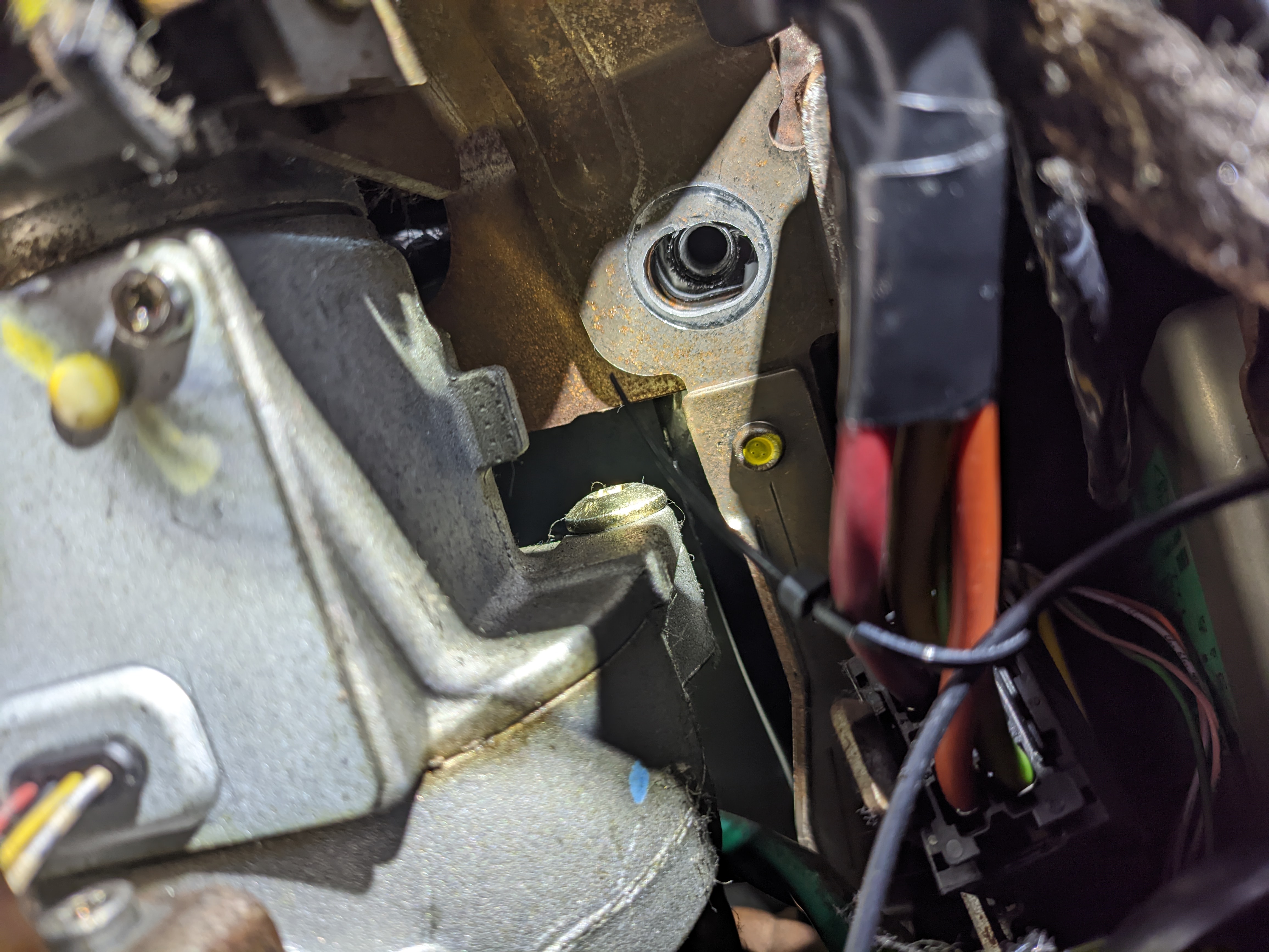

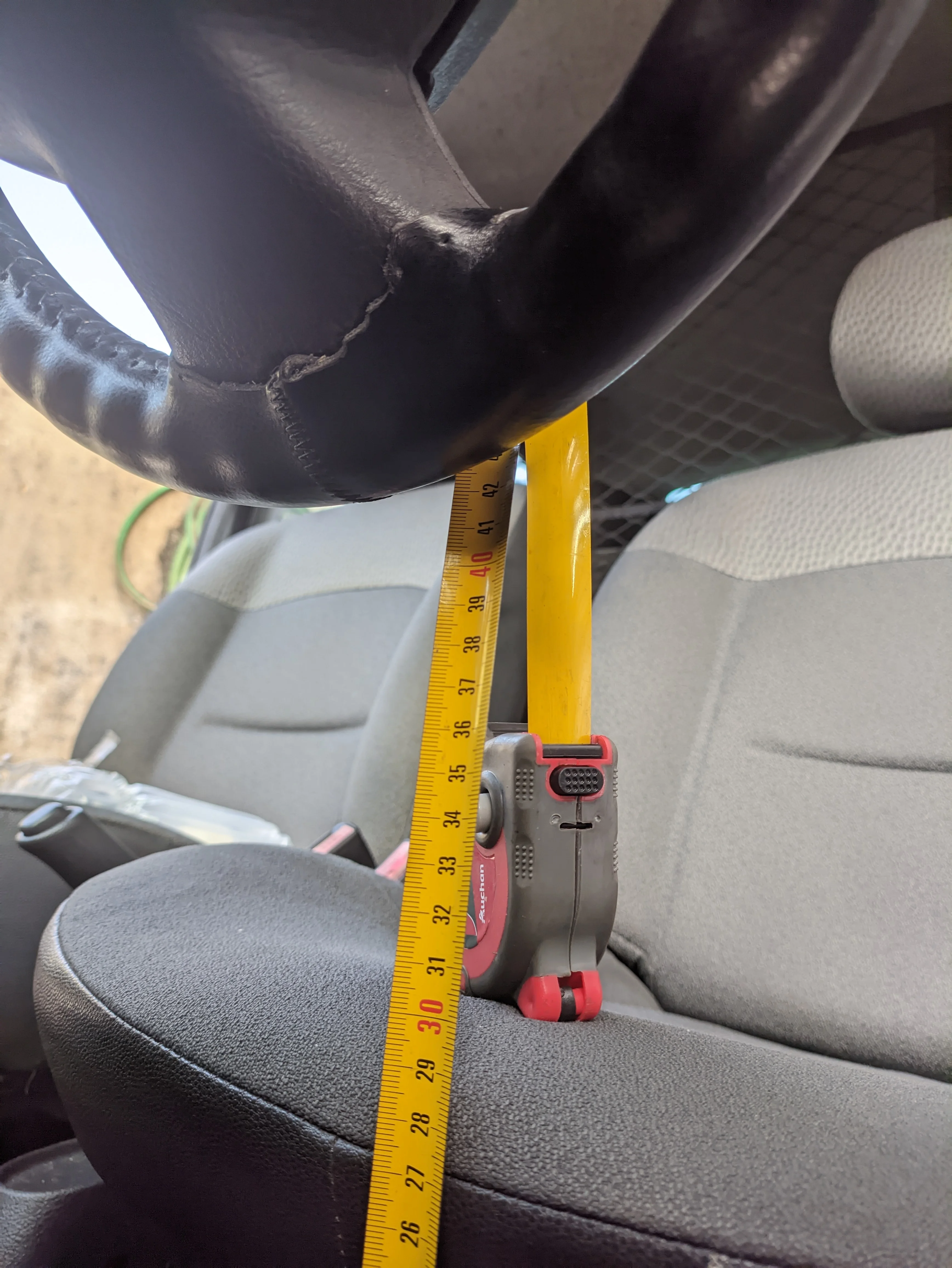

Tried to do this today on a dci 04 plate ph2 , is the steering column different or am i doing something wrong?
The spacers go in the vertical holes right? Because only one side lowers when unbolted, the other side is fixed.

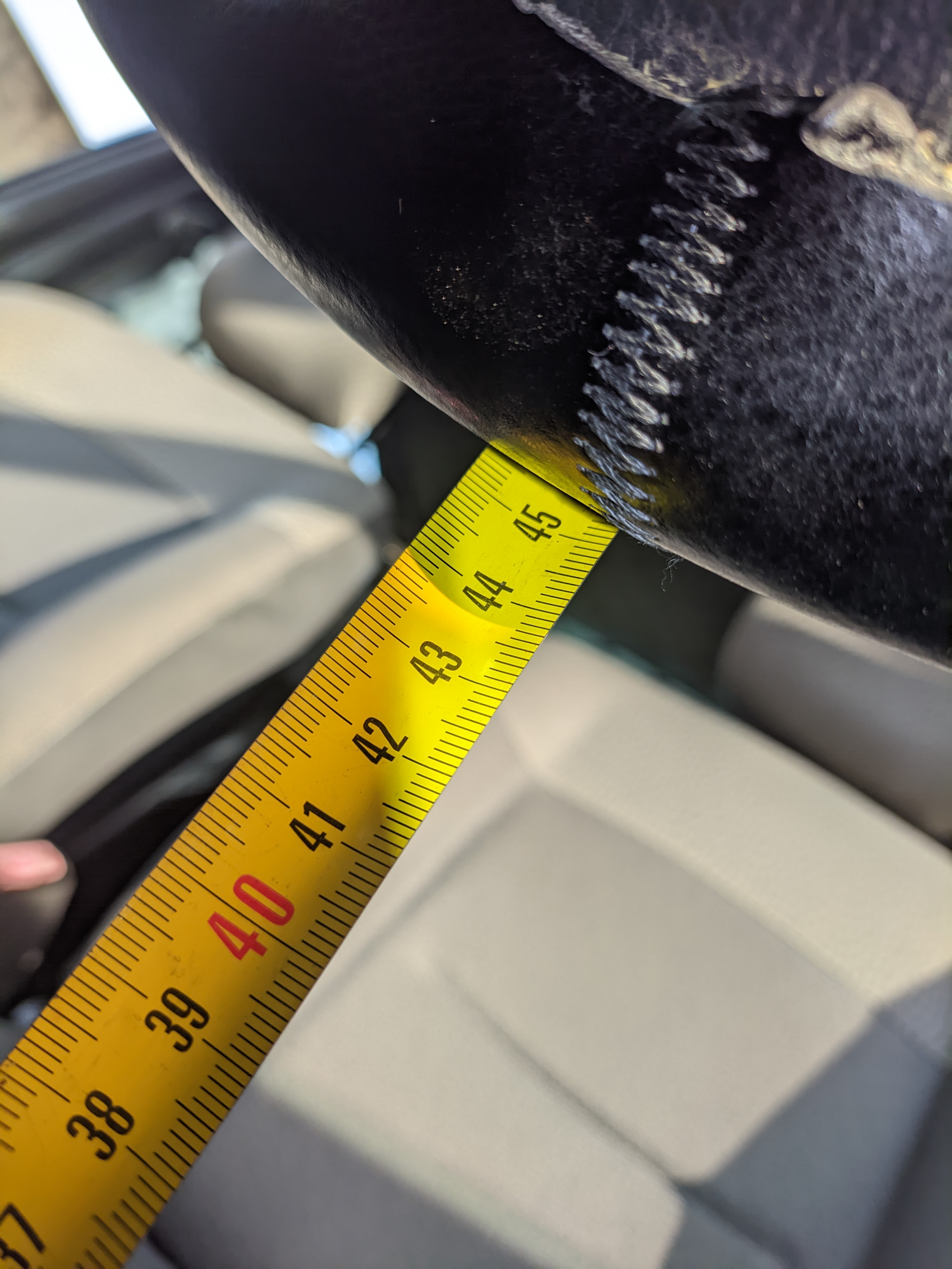

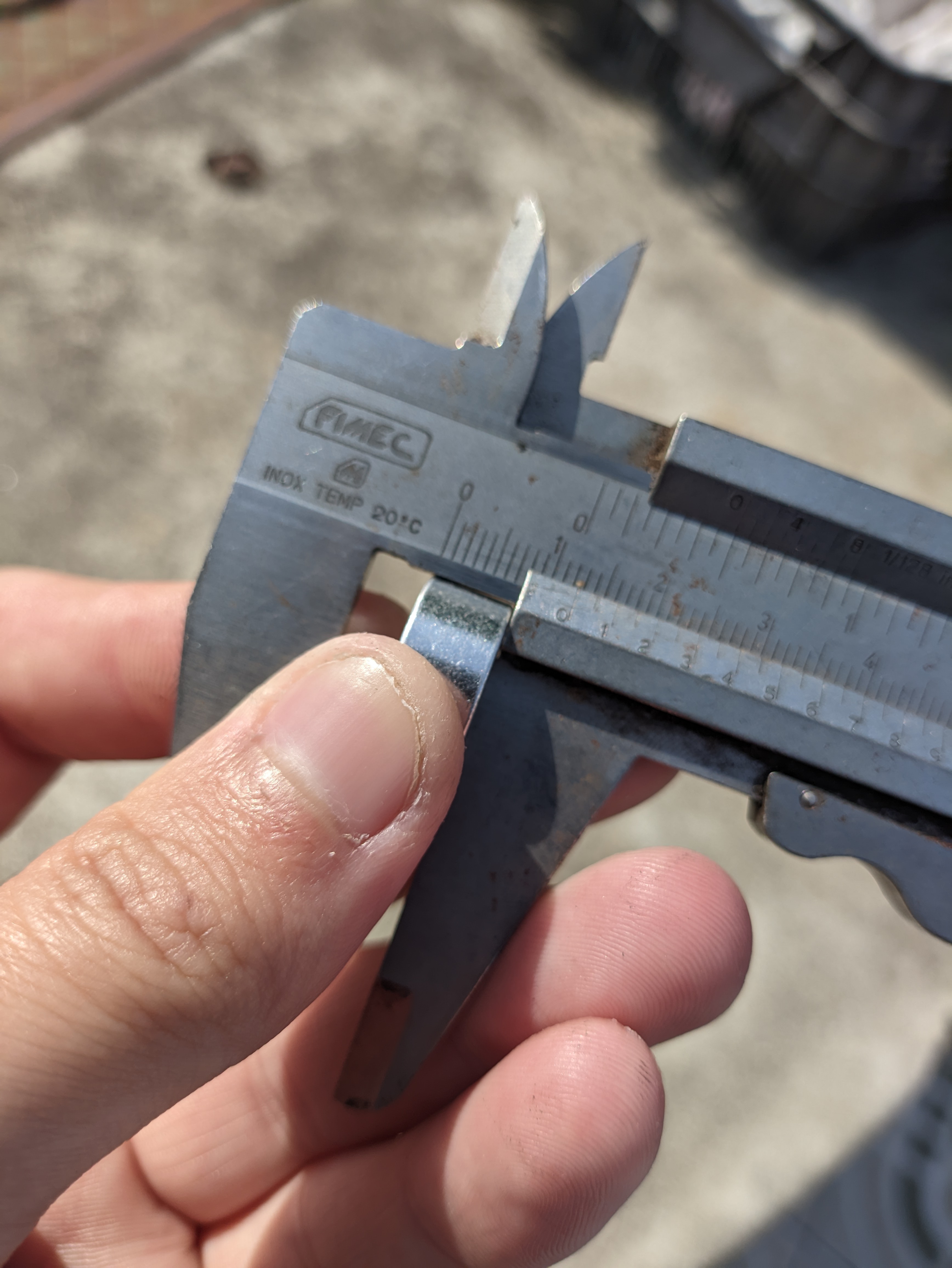

Basically the difference lowered with only 8mm on one side was basically 1cm (almost the same as the spacer, i also bent the tabs so i could fit it, but i must be doing something wrong that i cannot find another place to fit a spacer?
Pictures below.

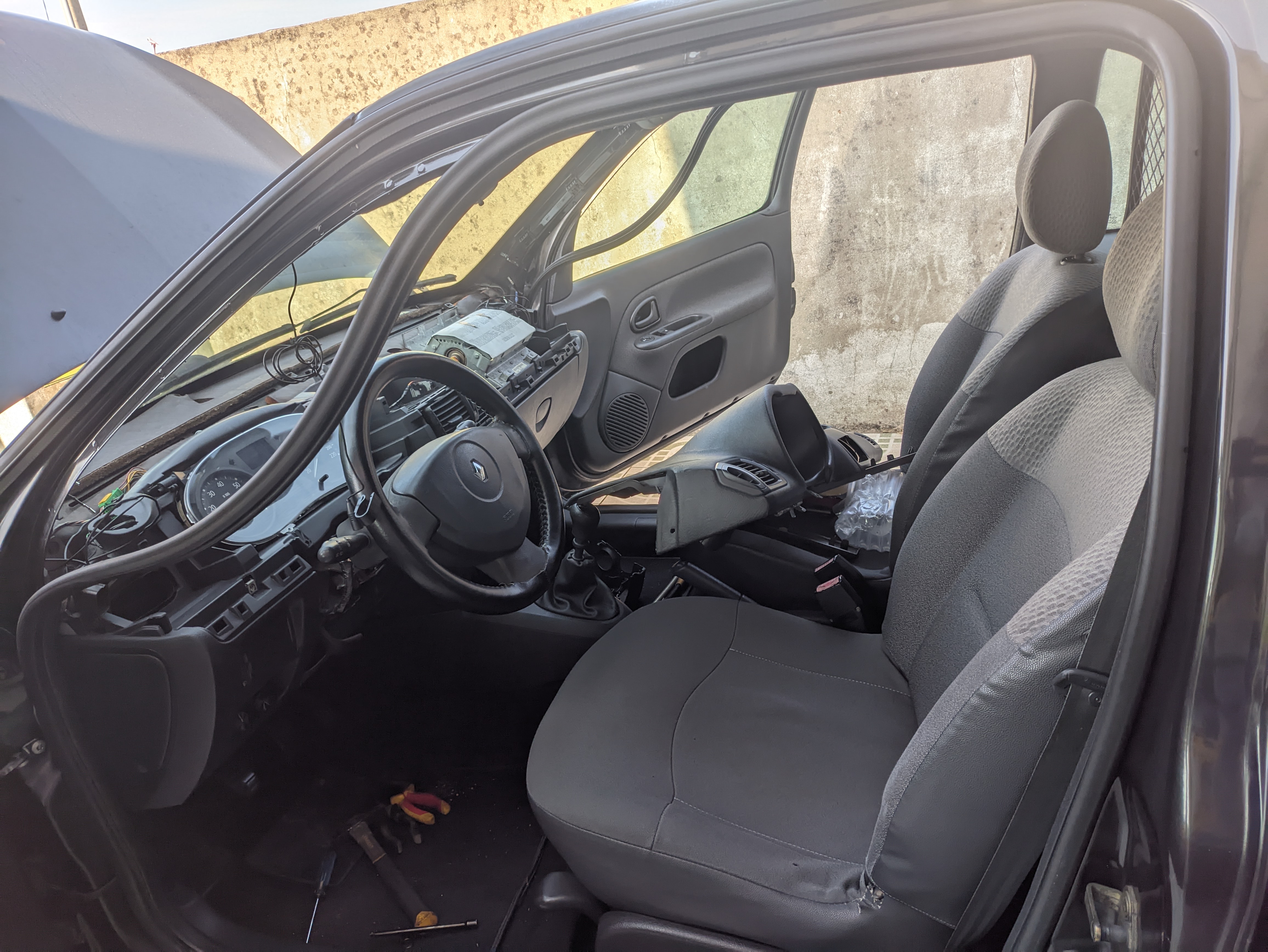

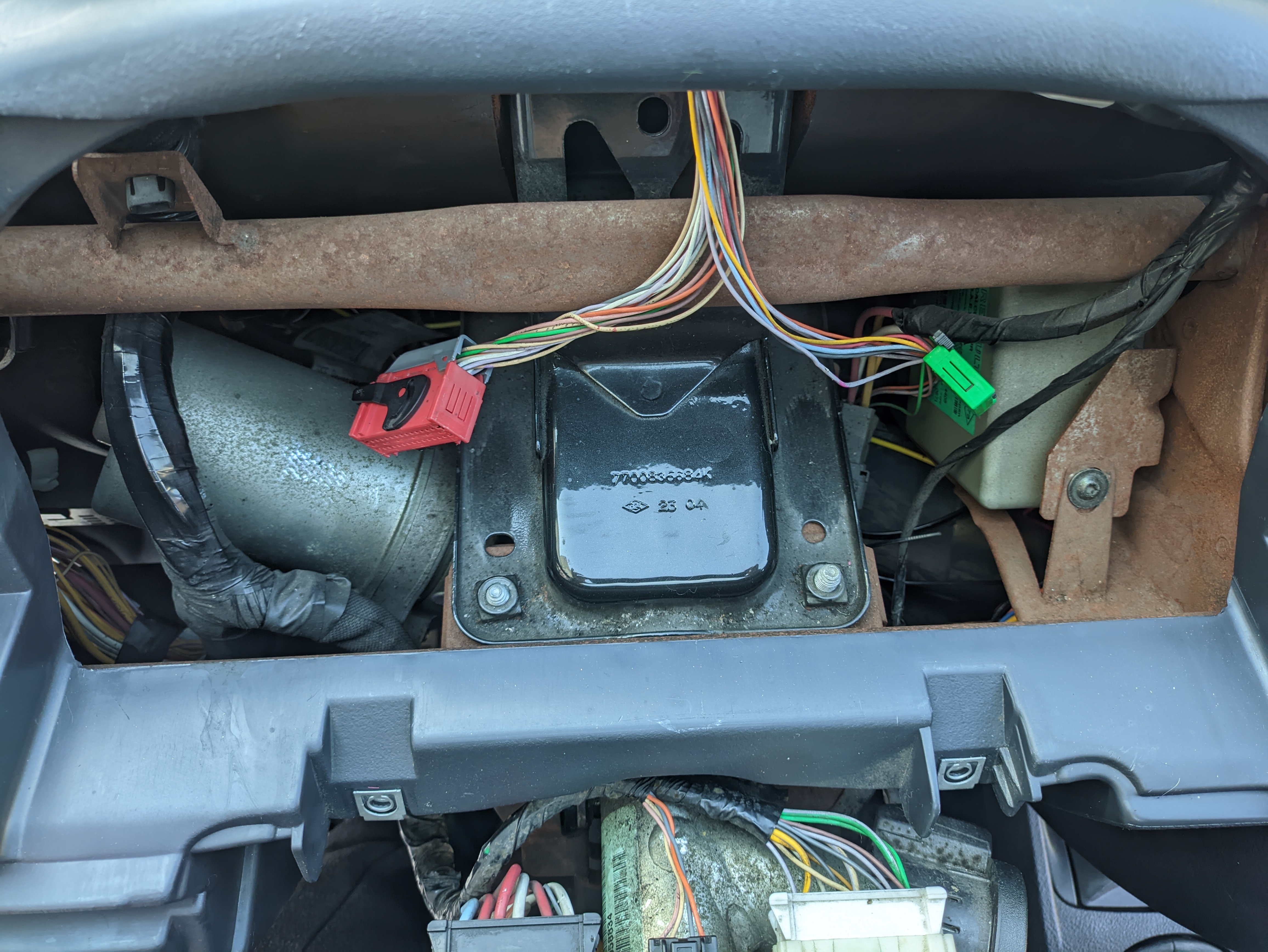

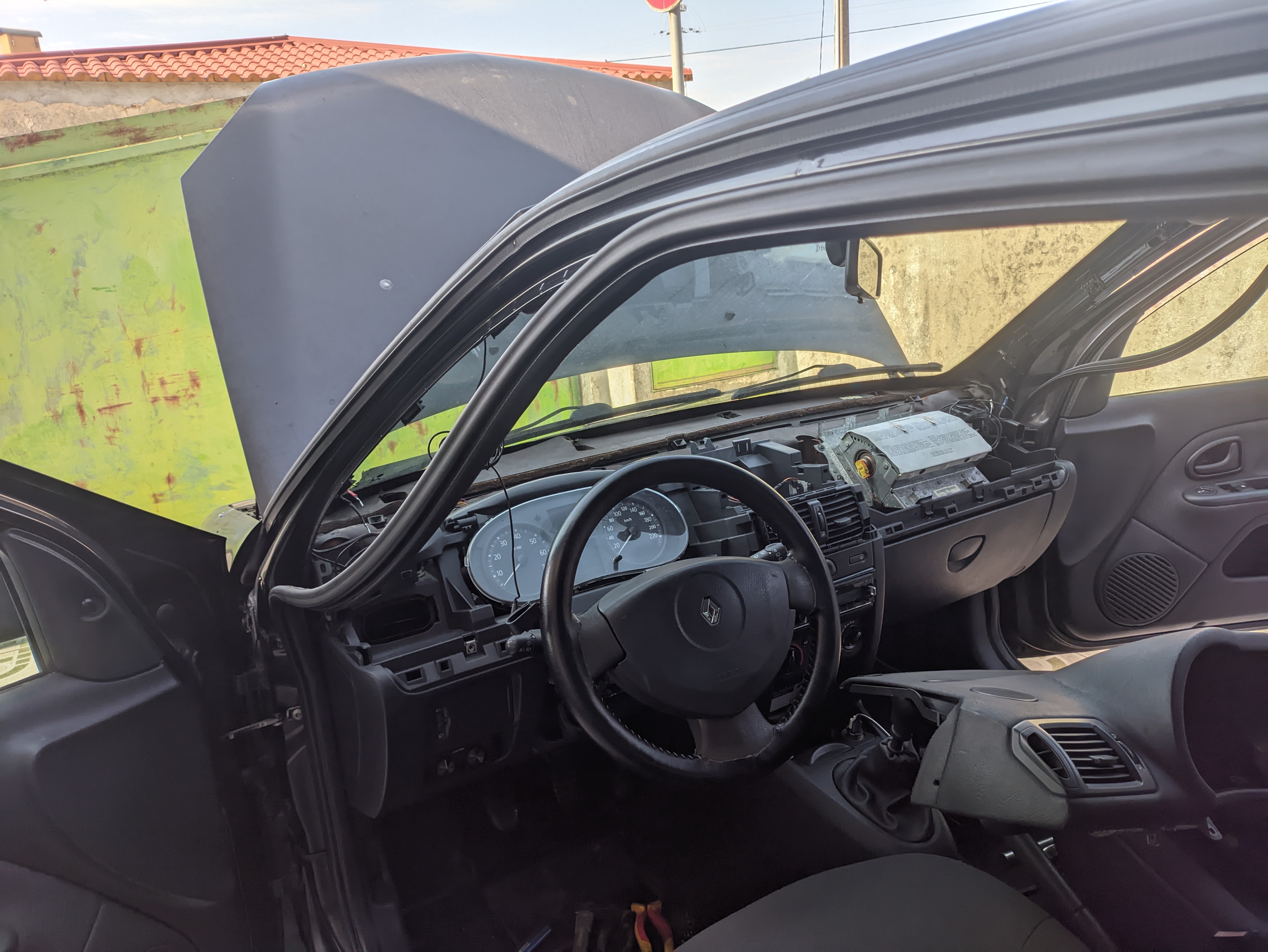

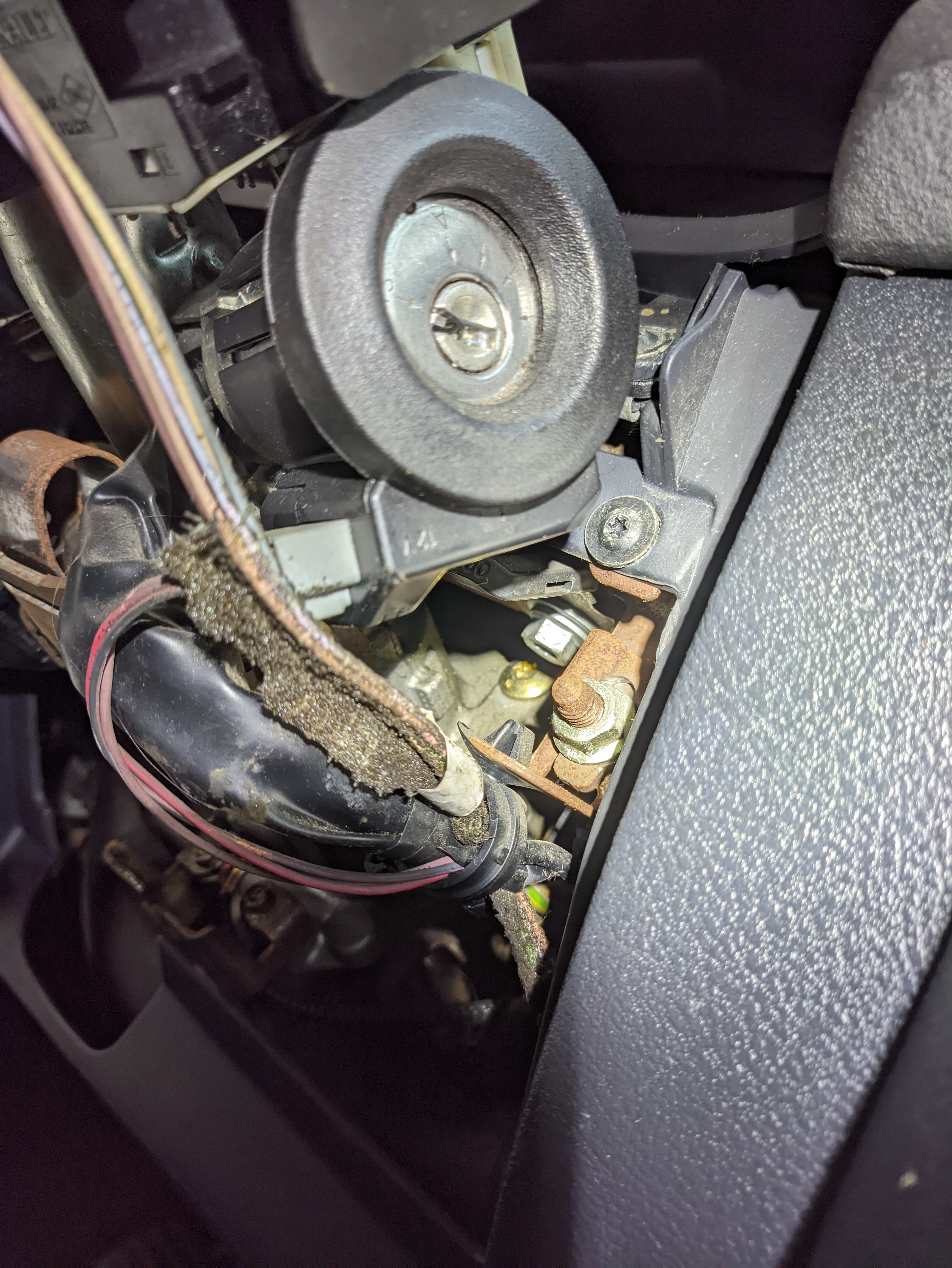

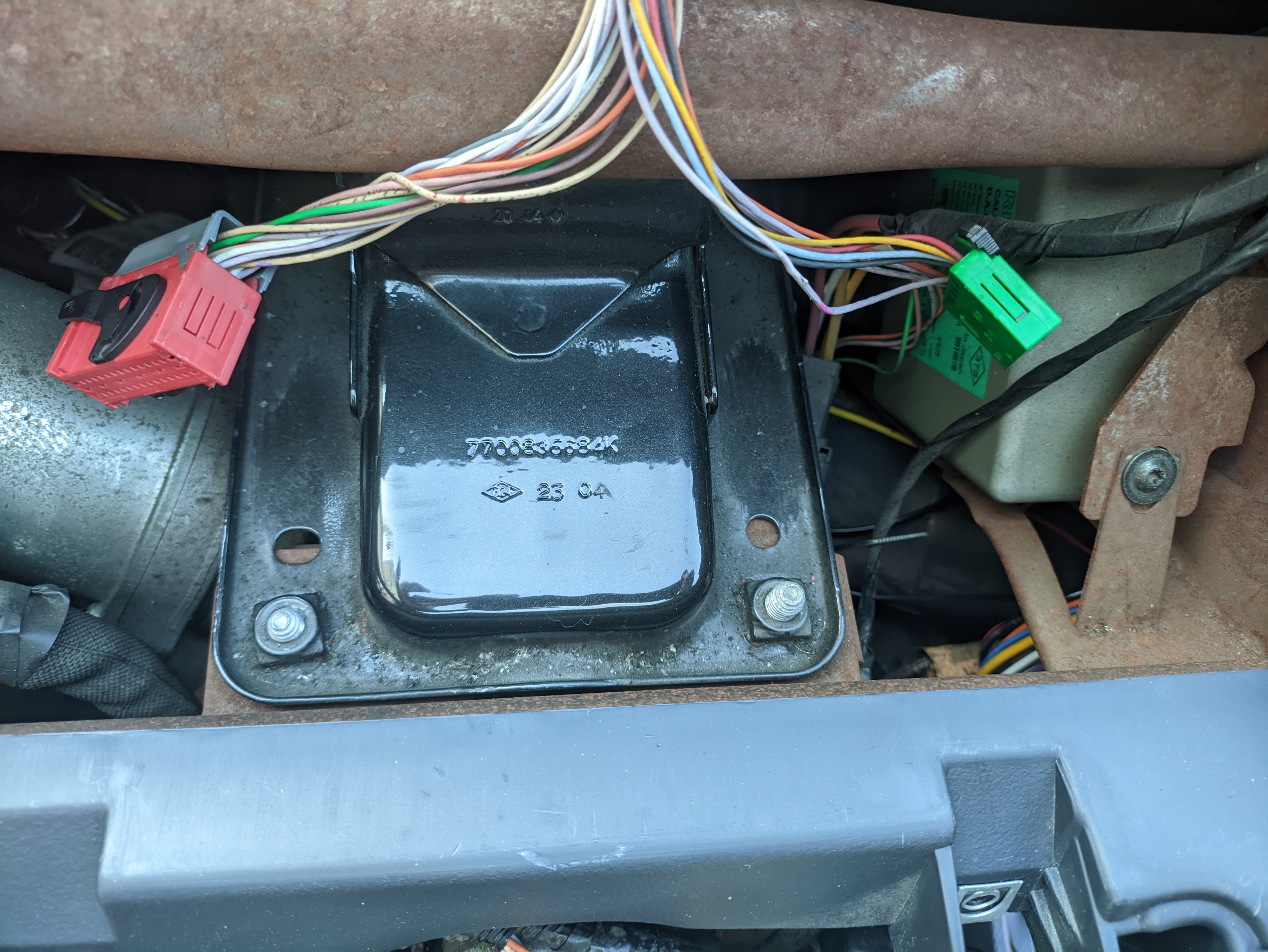

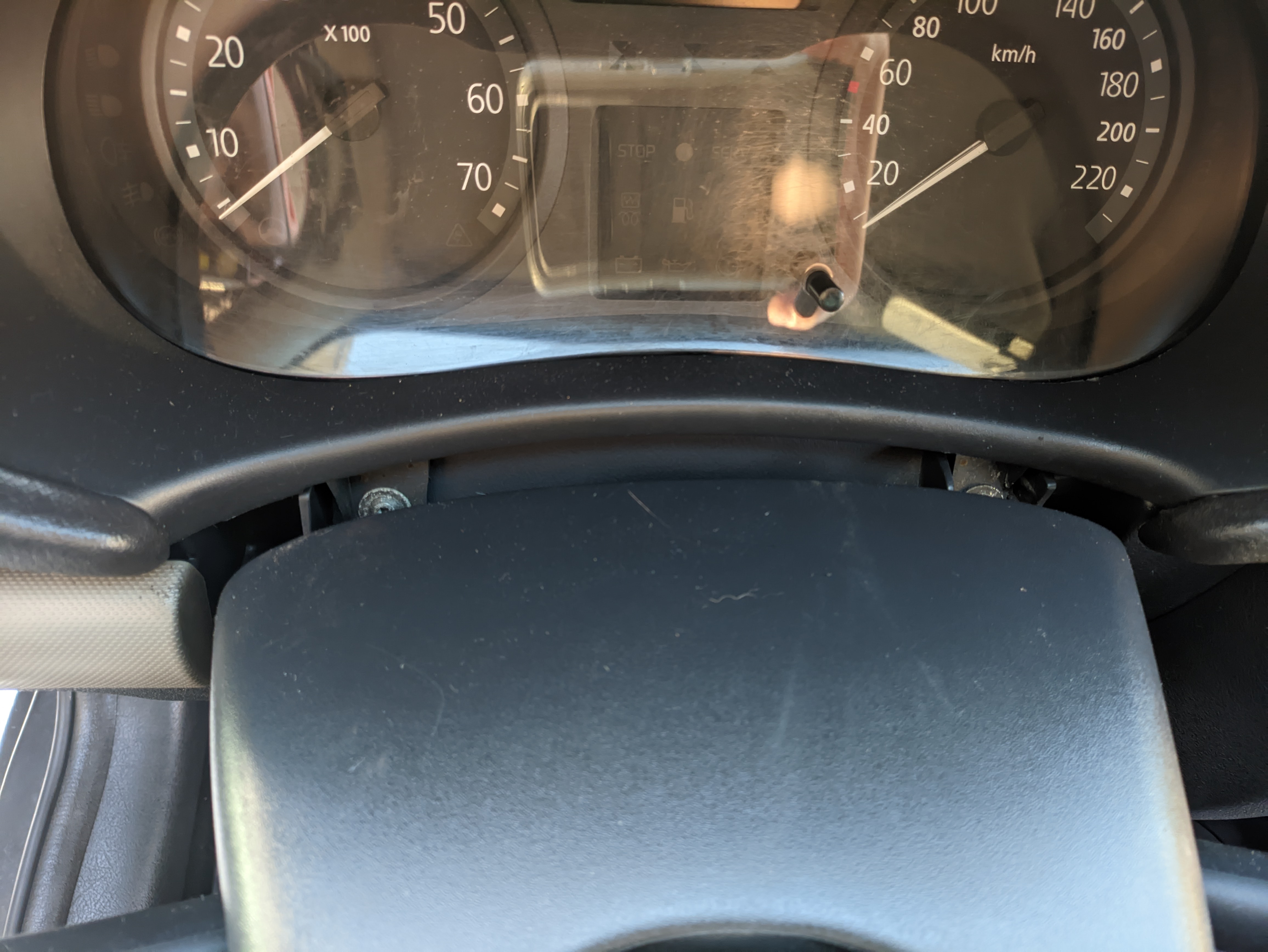

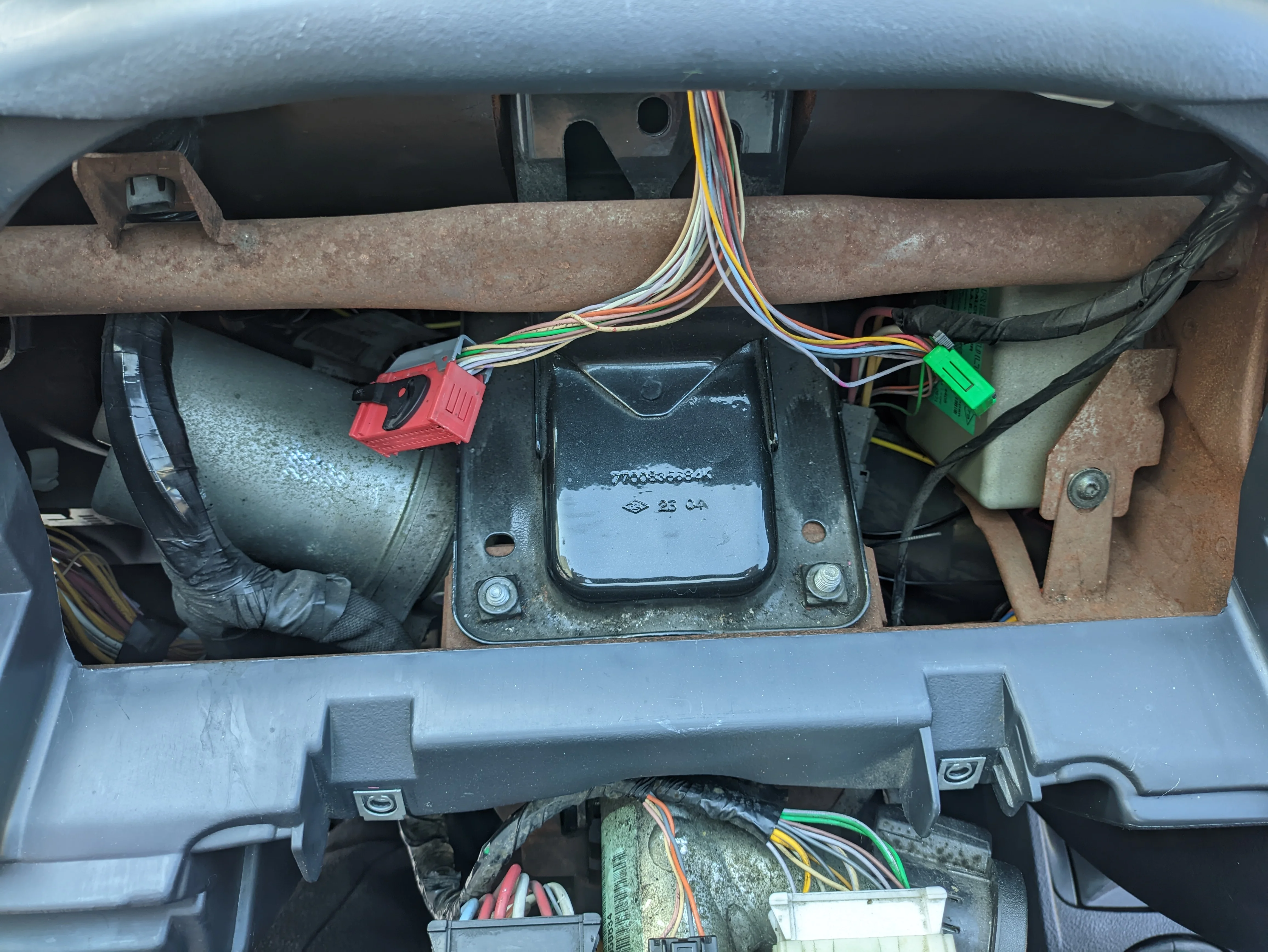

Well, i think i solved the issue, i had to loosen the right-side bolt (close to the ignition that was holding the steering wheel higher up, basically loosening it let it slide back 2cm and then tighten it again.
Removed first the top dash which took some more work... but it was not needed.
I'm pretty sure i could fit 10mm spacers in there with the same bolts easily, specially on the right side (ignition side) .
Some pictures and a youtube link below to show how it stay'd before putting everything back together.
Still have not driven it, but i'm pretty sure it's better now, will post again :)
Excuse the ugly paint and the ugly-mounts on the A pilar, it was worth it for me :P
How it ended before mounting;
