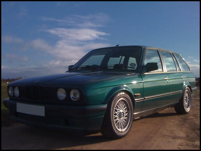

LPG'd E30 Touring Lux Lagoon Green Daily
Dont know how many people this will interest, but I'm bored and I know a couple of people have E30's on here. Well after SORN'ing the Clio for winter (well more than likely forever) I was on the lookout for a winter daily to get me about, and move car parts around. A mate was selling an E30 estate, that had been converted to LPG a year ago. Although it was only a 316i, it was alright to use as a runabout. Decided to buy it as the price was cheap..
The downsides were it had done 200k miles, was quite slow when fully loaded, and had the all the common E30 gripes - cracked dashboard, sagging roofliner, faded paint and a rusty tailgate. I purchased it without the 14" BBS wheels, and stuck with the 14" Steels inc pimp trims..
In the first week I tidied it up a bit, checked over the LPG system and just drove it as intended. I had the headlights apart and smoked the reflectors in the dipped beam, then fitted Xenons to the projectors. It still needed the main beam 'smoked trick' doing, but I never got round to it.
After only 10 days of ownership I spotted another E30 Touring for sale on another forum. It was a 318i Lux, with 15" BBS, Sunroof, 3 years newer, only 120k miles, Tax until April, MOT until Feb and full BMW service history.

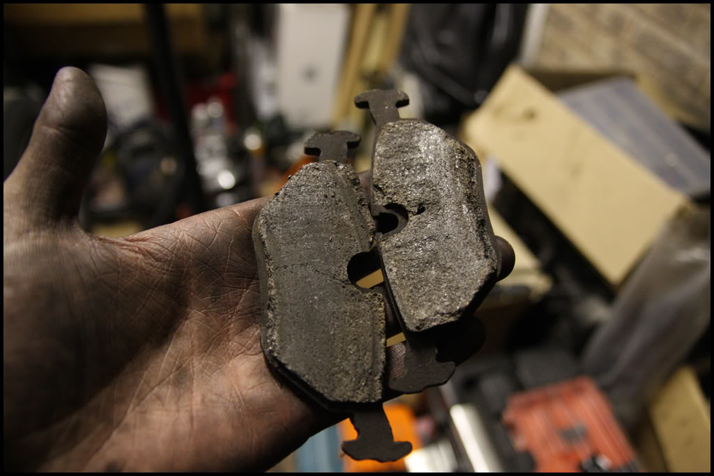

The other main thing was the front brakes which I spotted when the front was lowered - the pads were OK but the lips on the disc were huge! I had a look round the internet and managed to win some brand new Brembo Disks + Genuine BMW pads for £26 on eBay - never used from an unfinished project. They would have cost over £100 easily elsewhere, so another little bargin.

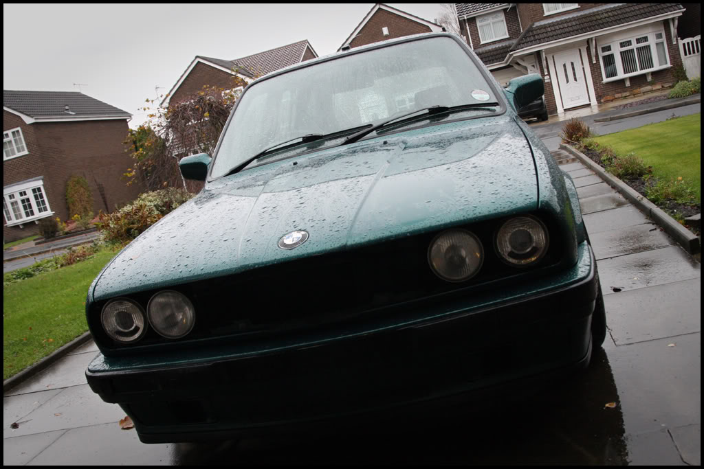

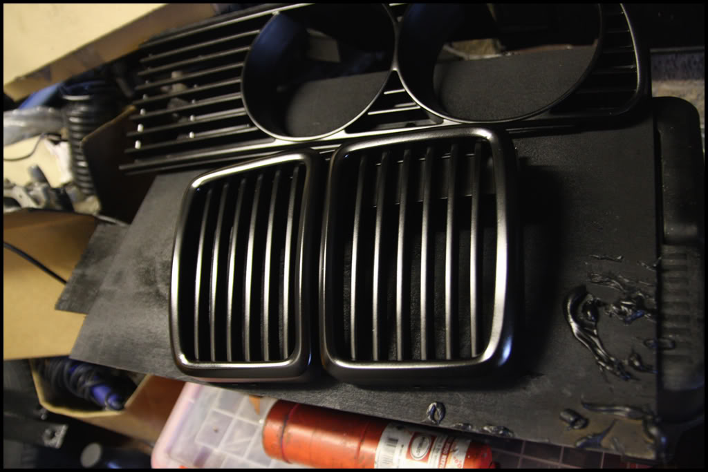

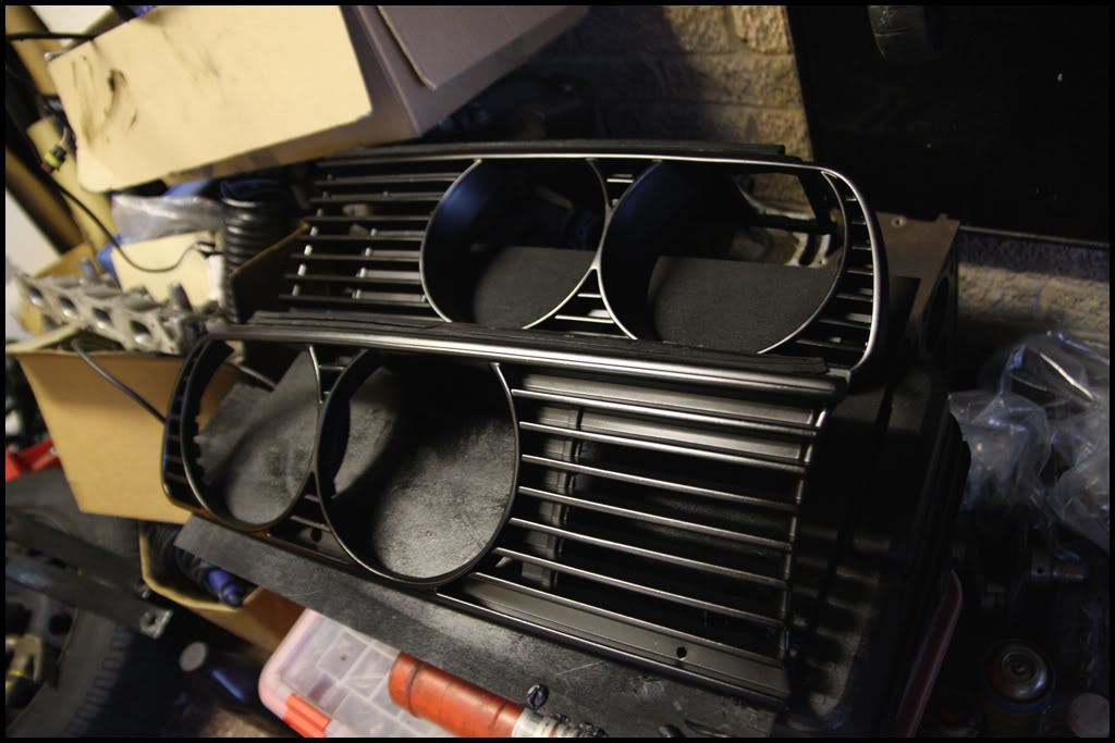

The first thing I wanted to do was respray the entire front grille in satin black, as parts were becoming faded with age. Removed the lot the other night...
Then got painting..
Which will hopefully look a lot better. I need to split apart and smoke the headlights again at some point as I much prefer them like I did on the Red 316i, another small job to do sometime. I also painted the black bits below the doors (sills), and the black border round the bottom of the rear bumper with some decent chassis paint, which tidied it up no end.

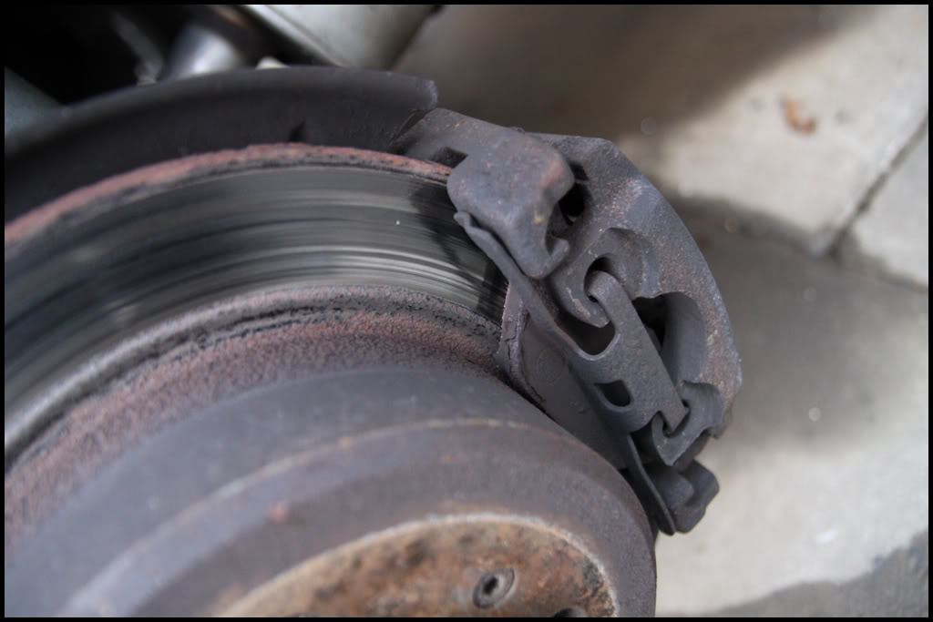

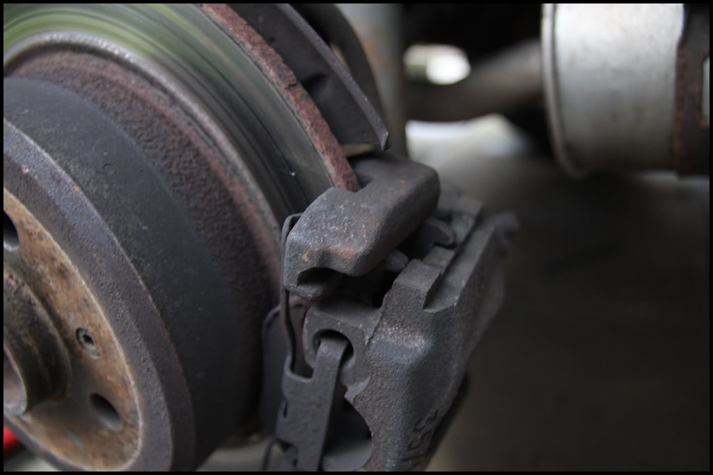

I thought the ABS might be related to the back, so I had the wheels off and checked over the brakes which were pretty worn too. I decided to just order some new rear disks and pads, so all the brakes on the car will be new when I get round to fitting them - one less thing to worry about :cool:

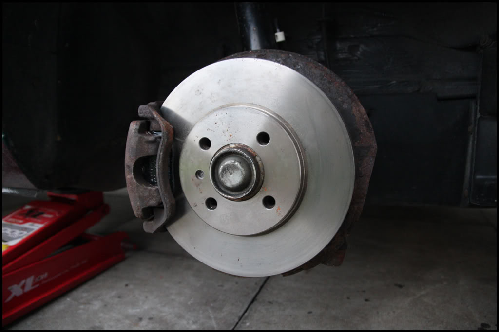

Managed to get a few jobs out of the way on it over the past couple of days, mainly bits that were annoying me. The brake pad warning light had been on since I got it (but I thought it was pretty rare they work properly, especially on a 20 year old car!), along with a squeeking noise every so often from the N/S rear. After a week of driving the rear wheels were covered in brake dust compared to the fronts so something was obviously wrong. The disks looked pretty old/pitted, so I decided to just replace the rear disks and pads...

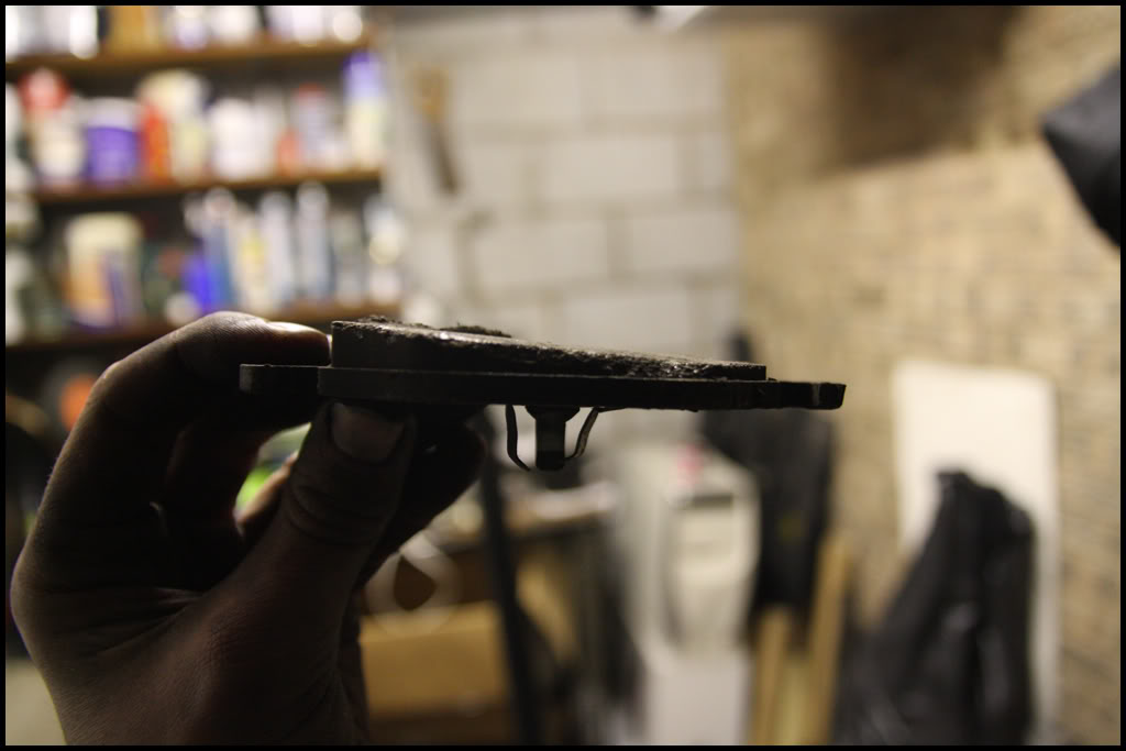

When I came to take the old pads out of the caliper I noticed the outer pad (on both sides) was sat incorrectly, and the caliper was jammed at a funny angle. The pad had pretty much fallen out of the carrier and could not go any further due to the disk..
I thought someone may have fitted them wrongly, but I have since found out they are possibly E36 pads that someone has tried to fit instead, obviously causing this issue. Due to them being sat like that the wear was pretty uneven to say the least..
After a bit of a battle with rusty bolts everything came off and the new stuff went on fine, with plenty of copper grease. After around 30 miles everything is still in place as it should be - so hopefully no more issues with the rear brakes for a long time to come.

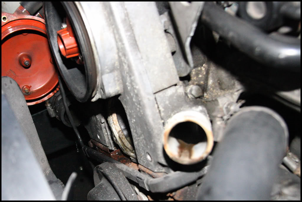

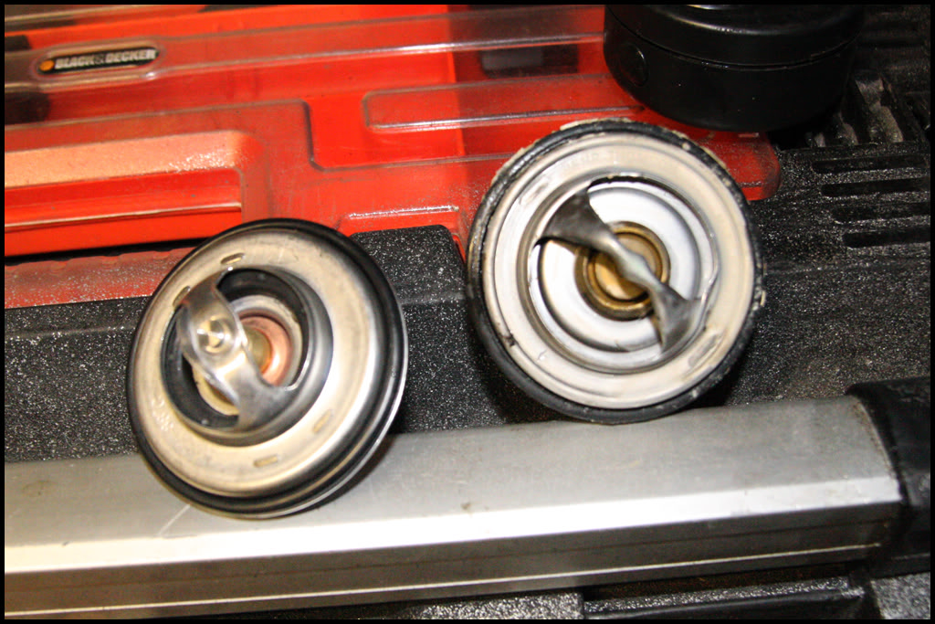

The car has never really got upto temperature since I've had it, and once driving it would always sit near the bottom of the gauge. I thought it was a knackered thermostat that was stuck open, but thought I would bleed the system again anyway to double check there wasnt an air lock in there somewhere. After bleeding it was exactly the same, so I picked up a new thermostat and fitted it to the car..
Removed the bleed screw, topped up the water and ran the car upto temperature. Gave it a good drive and the needle now sits bang on in the middle all the time along with the heaters getting red hot when required - problem solved :)

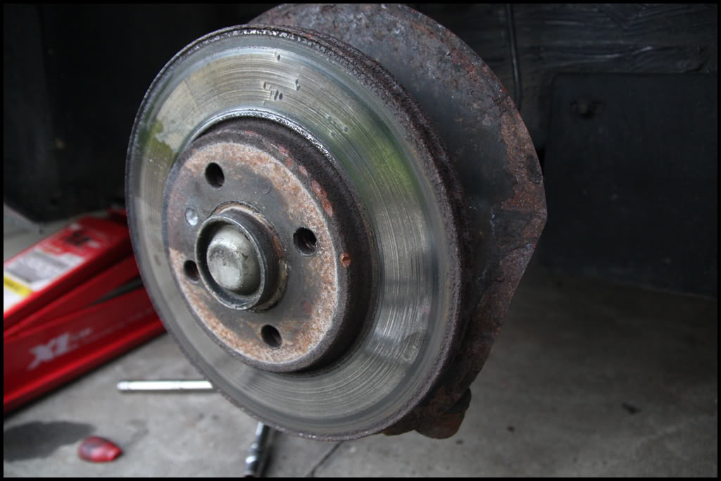

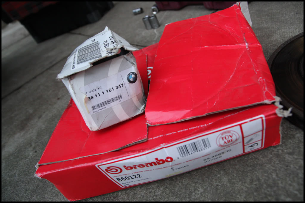

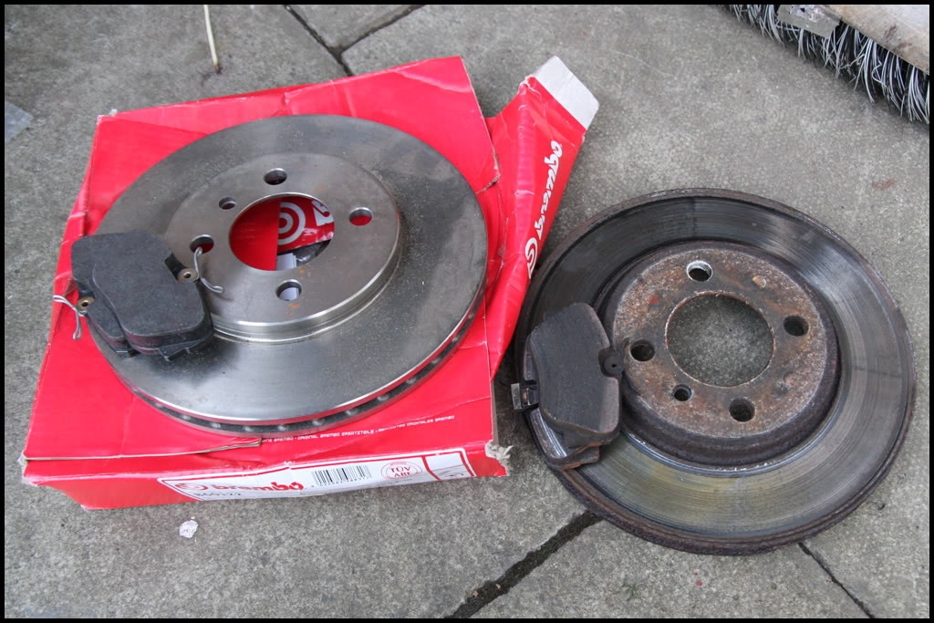

Anyway, the front brakes needed sorting badly, as the lip on the disc was huge and the pedal felt crap. Managed to win these on eBay for £26...
Brand New Brembo Disks and Genuine BMW Front Pads, another good bargin.

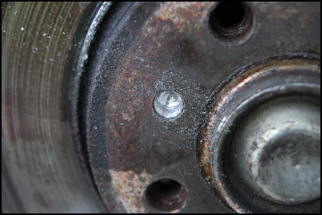

Set about removing the old discs to find someone had already been there before me and rounded off the retaining bolt - on both sides! Had to drill the heads off to get the disc off. These things remind me why I hate working on old cars, especially when people have f*cked up in the past and just left it :dead:
After p*ssing round with that for a while, managed to get them off. Didnt bother wasting more time trying to get the threads out as they wouldnt move easily with the grips, so just ground them flat and left them there. New vs Old..
..and all fitted back to the car...
The whole car stops 100x better now, especially with new rears too. Sorted a few other niggles, checked the front and rear wishbone bushes etc - all seem fine thankfully. More soon :)

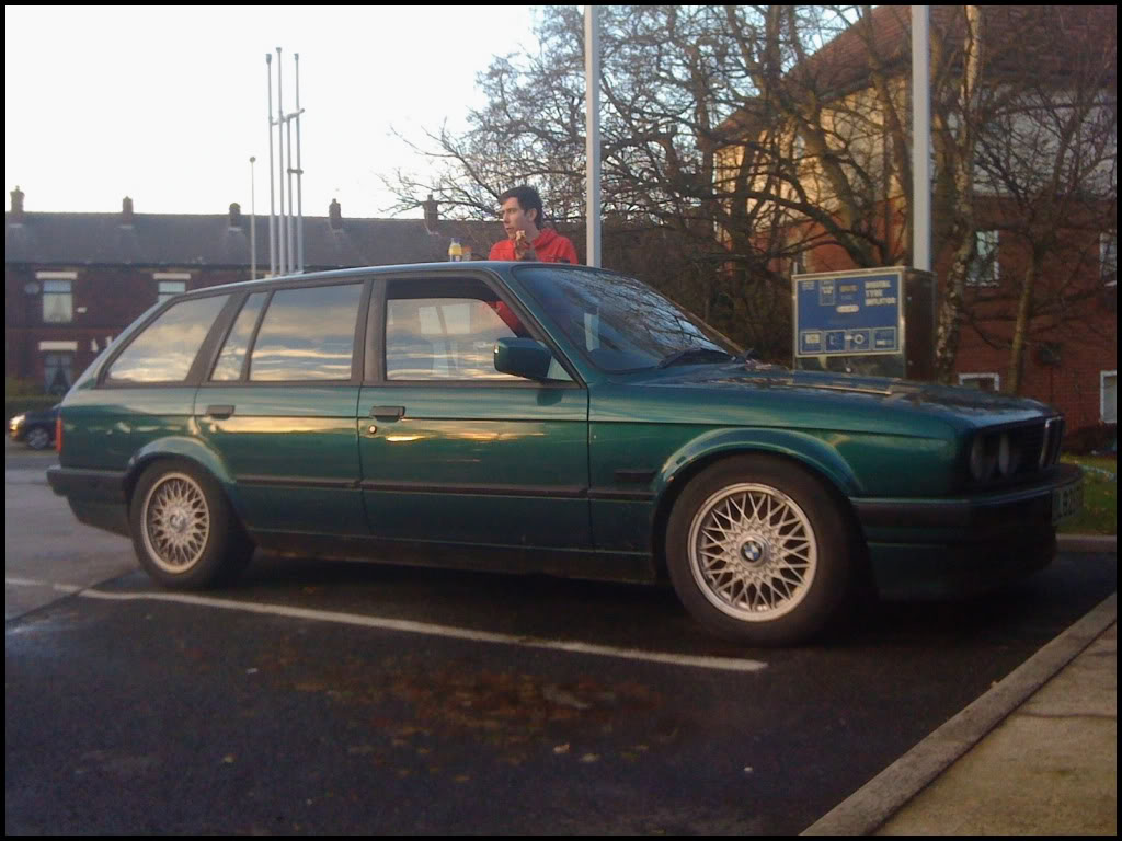

Finished the LPG install the other day, done around 300-400 miles on it now but all seems fine. Needs a slight tune I think, but will be getting that sorted soon. Made a new filler pipe mounted from the towbar instead of having to drill the bodywork too, il put some details up about it (and the whole system) sometime soon :)
The back has also been lowered around 20-30mm too, matches the front well. It now has the advantage of the rear springs being slightly stiffer too. Grabbed a couple of pictures on the phone the other day..
