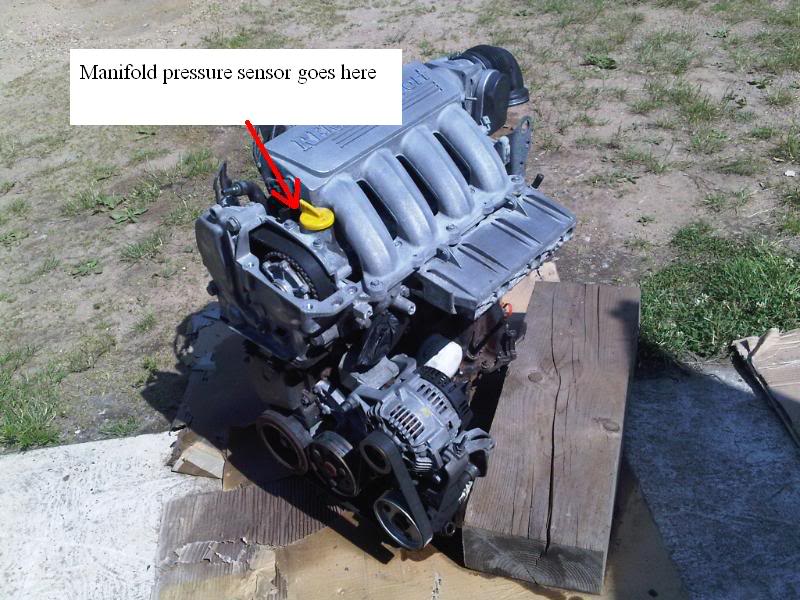

It started first turn of the key, but cut out pretty much straight away and wouldn't tick over. After investigating a little bit further, I found that i had broken what I would call the manifold pressure sensor (see below) and found out that this can affect the engine idle speed.
I replaced it, and it runs better, but I'm still faced with the fact that the engine doesnt tickover smoothly like it used to, almost sounds like its misfiring. Once its over about 2000rpm it runs beautifully, and develops plenty of power - I still get that lovely kick at around 5k rpm :)
