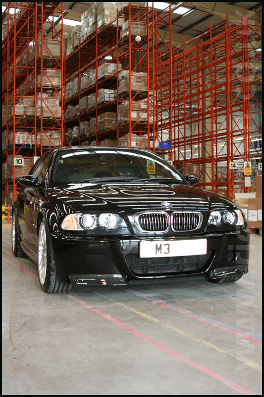

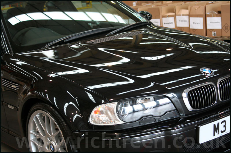

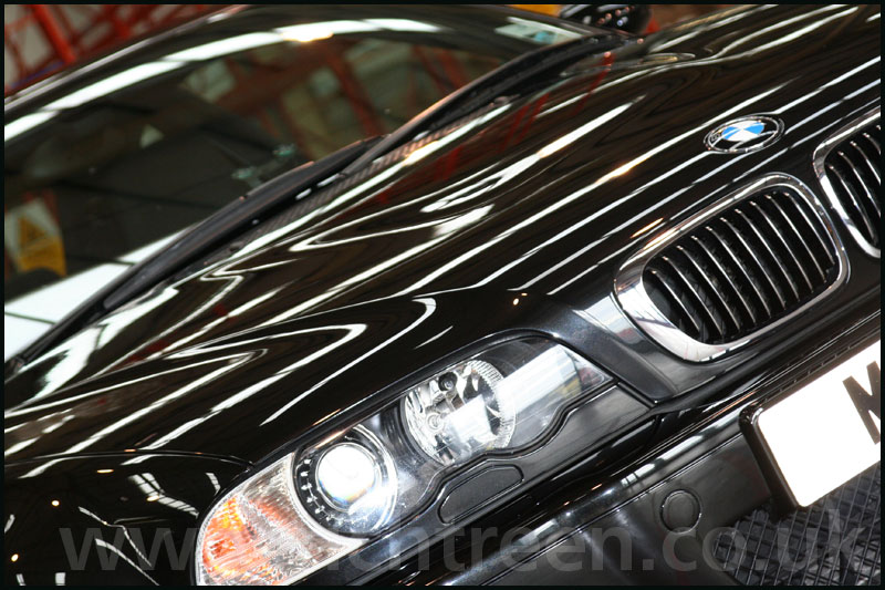

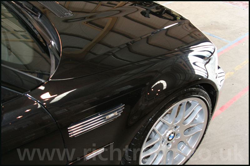

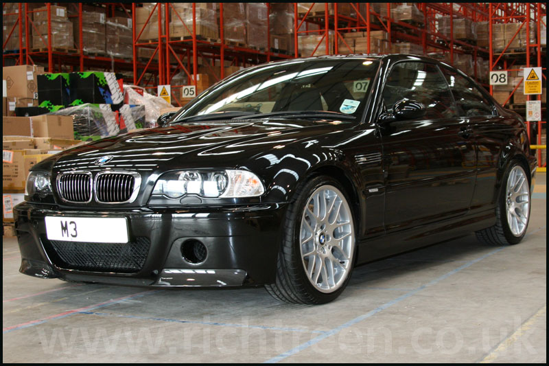

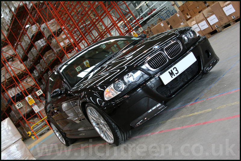

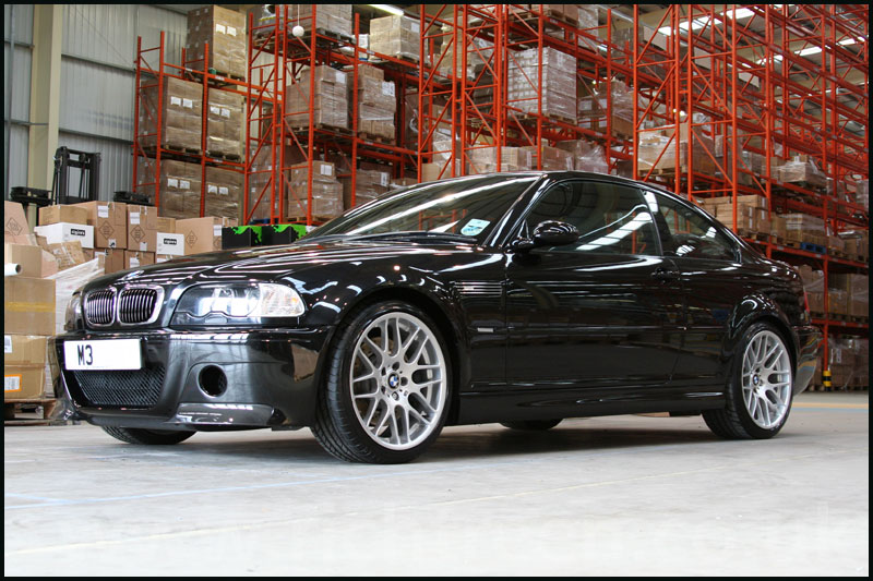

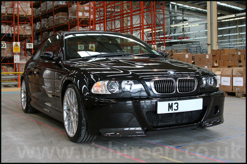

Was picked up bright and early this morning by Mark (Brazo) to go and do this earlier.
9 hours later ...
  106 GTi
The Process.
Bodywork washed with QEW ( quick and easy wash) Waterless wash.
Wheels and arches using Car Soap and water, AG engien and machine cleaner and Meguiars APC and various Brushes.
All Metal Panels - Rotary Polished with Menzerna Intensive Polish.
Plastic and Carbon Fibre Panels with the PC , Light Cut Pad and Poorboys SSR 2.5
Whole Car PC polished with Merzerna Final Polish 2.
Sealed with Zaino sealant x3 layers.
Waxed with Pinnacle Souveran.
Wheels polished and sealed with AG SRP and EGP.
Tyres dressed with Autoglym Rubber plus topped with AG Vinyl and Rubber care.
Wheel arches dressed with AG Vinyl and Rubber care.
Glass Cleaned.
All trim and details, vents etc Quick Detailed
Exhausts polished with wire wool and Megs NXT metal polish.
Glad it had two off us on it!

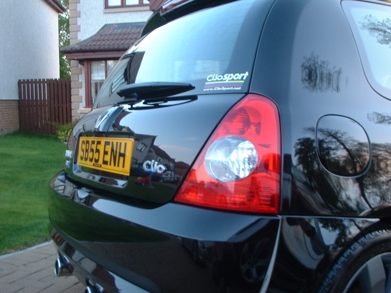

Washed with Extreme body wash n wax
Clayed using chemical guys clay,with maxi suds and foam gun
Laser Buff Scratch and Swirl remover via pc
Cherry wet wax via pc
M seal paint sealant by hand
2 coats XXX Hardcore paste wax
Trim gel on trim and tires
