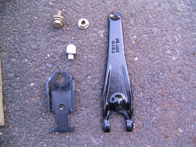

How i got round it was to fit a clio mk2 clutch fork ,release bearing and bellhousing bracket (the one which the outer cable sits in before the fork).
Also there is a little green pedal stop on the mk1 that when you release the pedal it sits against it, if you go down the mk2 conversion route above you will need to shave 2mm off the block so that the adjuster mechanism takes up the extra cable due to the longer travel.
Or just put up with it you soon get used to it.
Here is a picture of whats needed and how it sits once fitted.

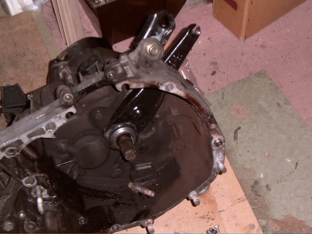

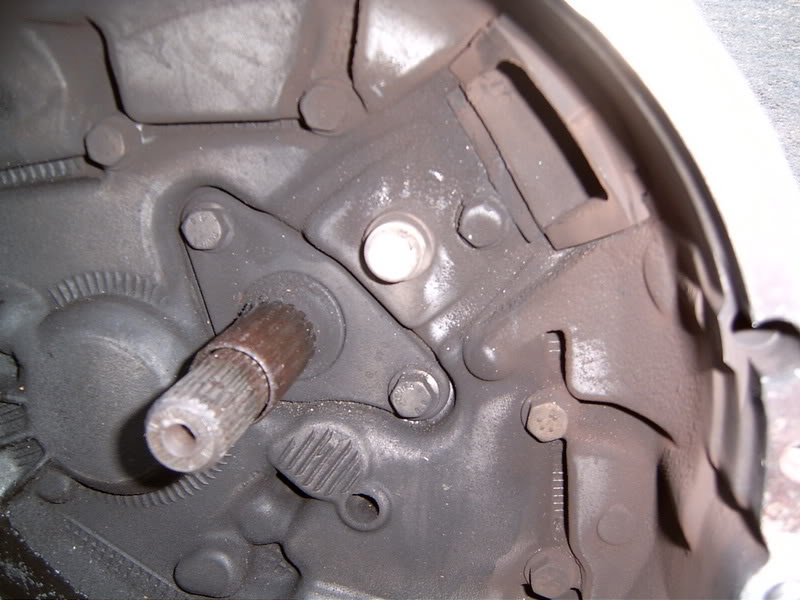

Pivot cap /bush fitted the white part to the right of the input shaft which helps the pivot of the clutch fork due to being slightly bigger than the mk1 version.
Fork,bracket and release bearing in place
