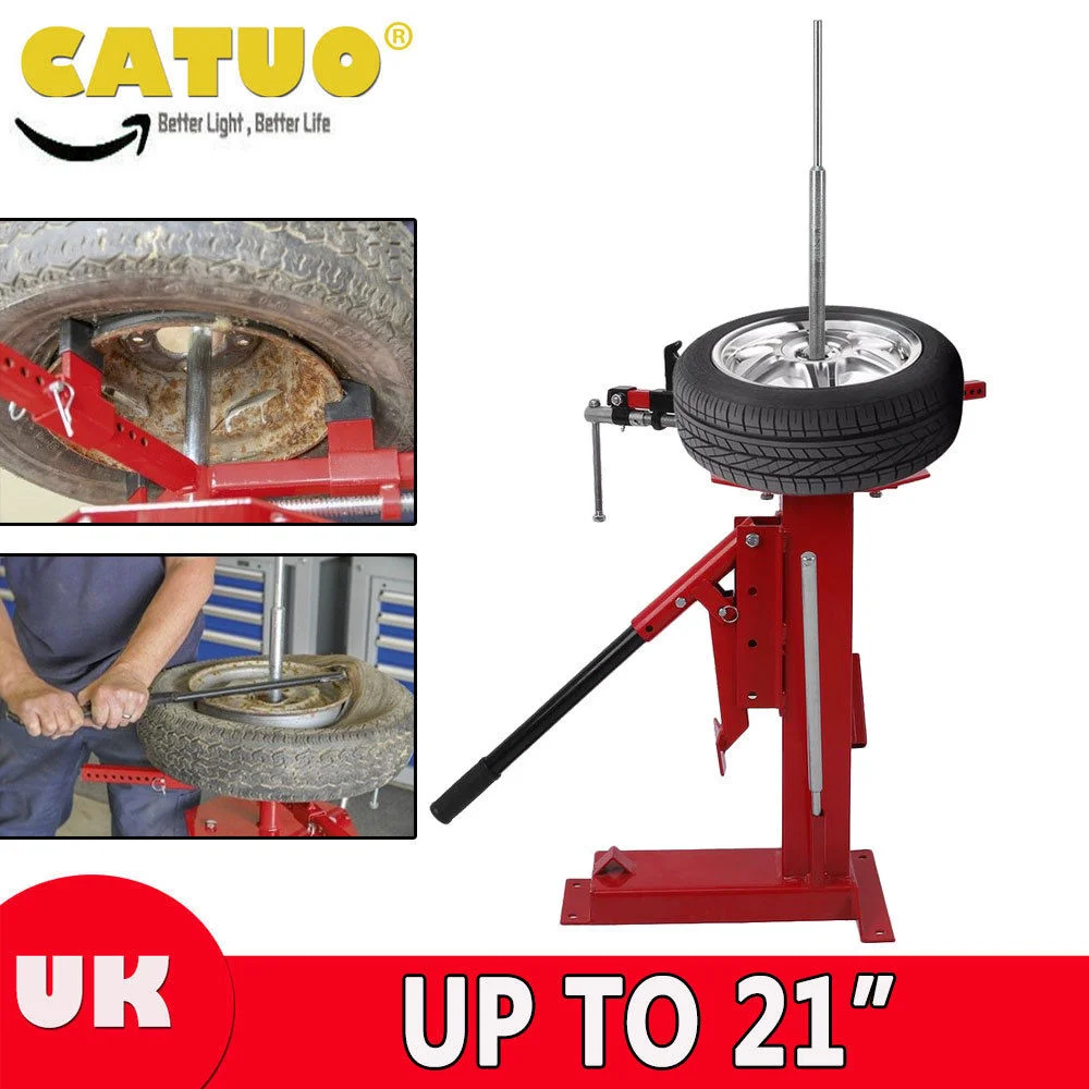

Constantly swapping tyres and paying £15 a pop each time at a local used tyre place
Reckon could be doing 8 a year or so
Anyone got experience of one of these car tyre changers/ bead breakers and are they as easy to use as the UTube vids? Saw one bloke get a tyre of in around 2 minutes
https://www.ebay.co.uk/itm/Tyre-Changer-Bead-Breaker-Tire-Car-ATV-Motorcycle-Manual-Hand-Machine-21/253809515916?_trkparms=aid=111001&algo=REC.SEED&ao=1&asc=20131017132637&meid=03f3f3697e5a4707b0b06cdc6e8652fa&pid=100033&rk=1&rkt=8&sd=232927879428&itm=253809515916&_trksid=p2045573.c100033.m2042
Didn't see him put one back on, but others have done it in several minutes
Expect its back breaking work?
Are they worth it- would save a few £'s that could be spent on the tyres
I use a trolley jack and a ratchet strap to pop the beads.
Works a treat.
Obviously on track wheels or ones your not to fussed about.
