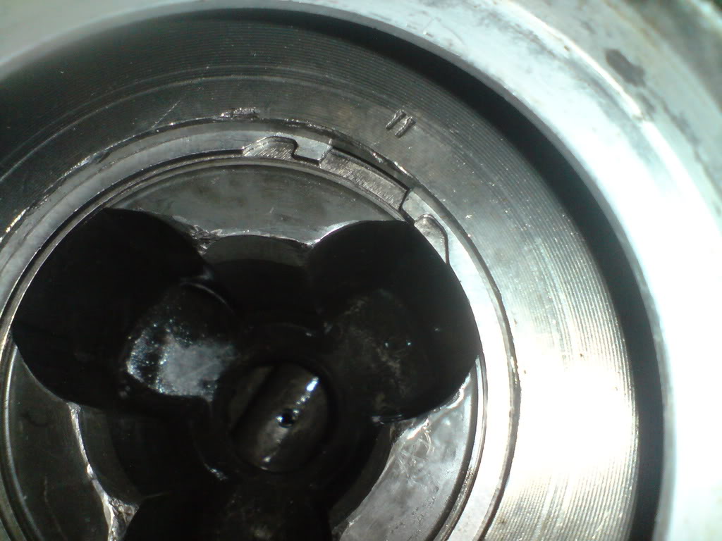

Yep sounds like circlip. Seen here:
ok just had a look and there are two circlips loose behind the rubber cover on the gearbox so thats the problem!
whats the best way to go about refitting them? i've got a circlip compressor but where do they go etc?
