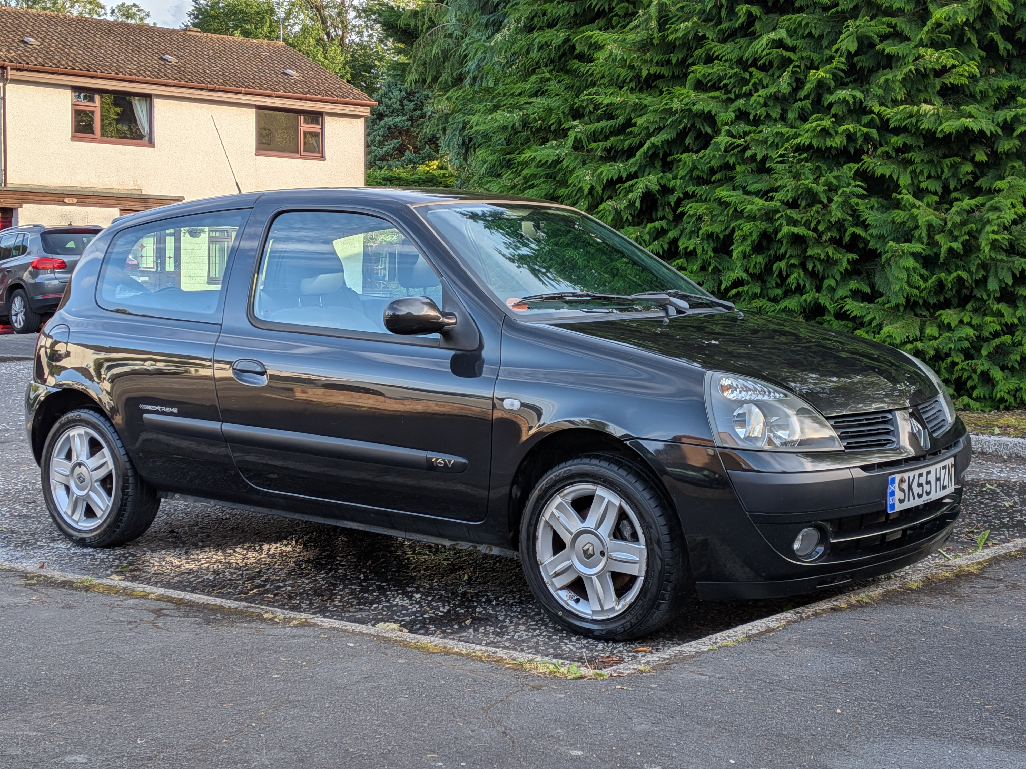

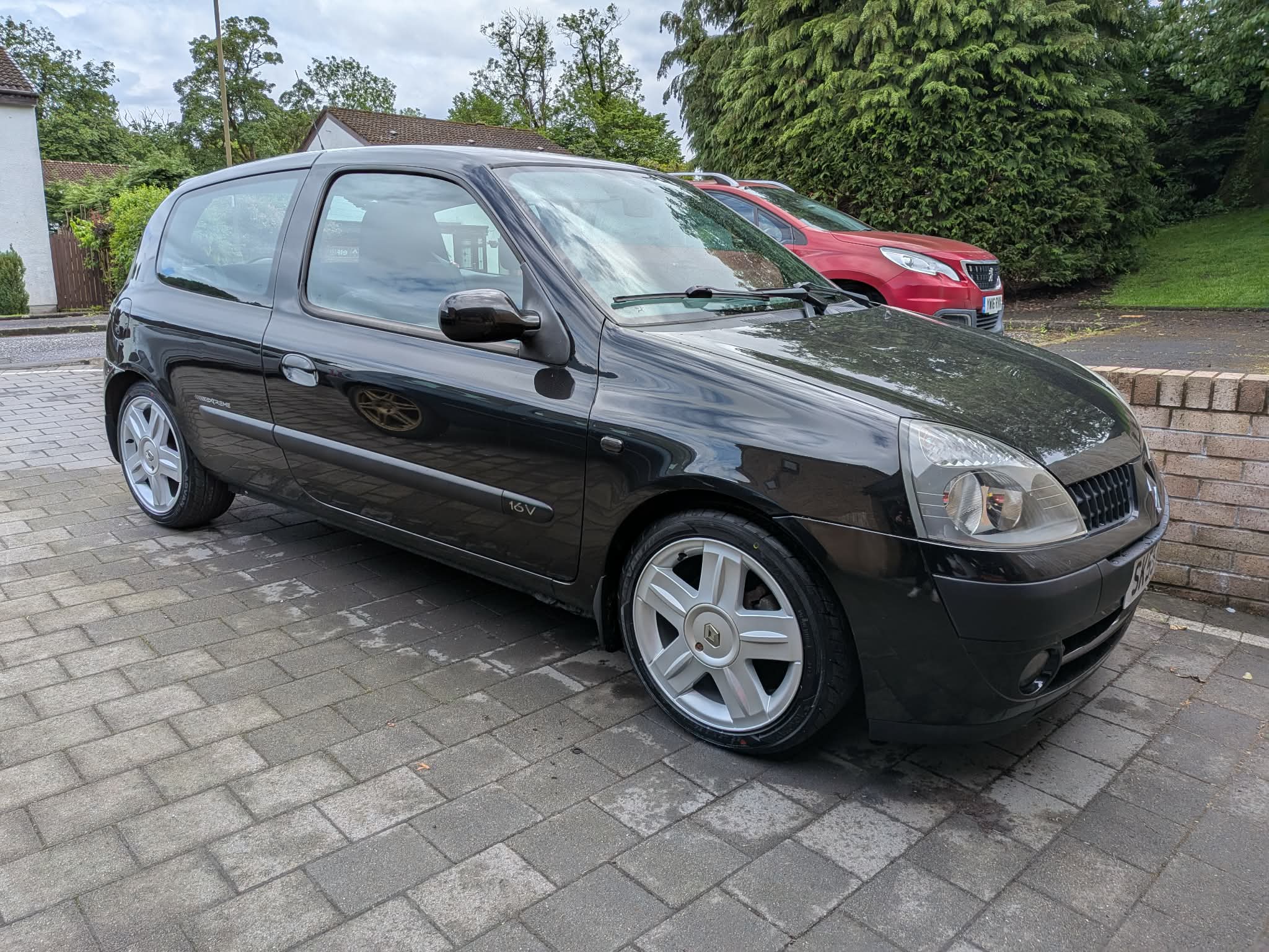

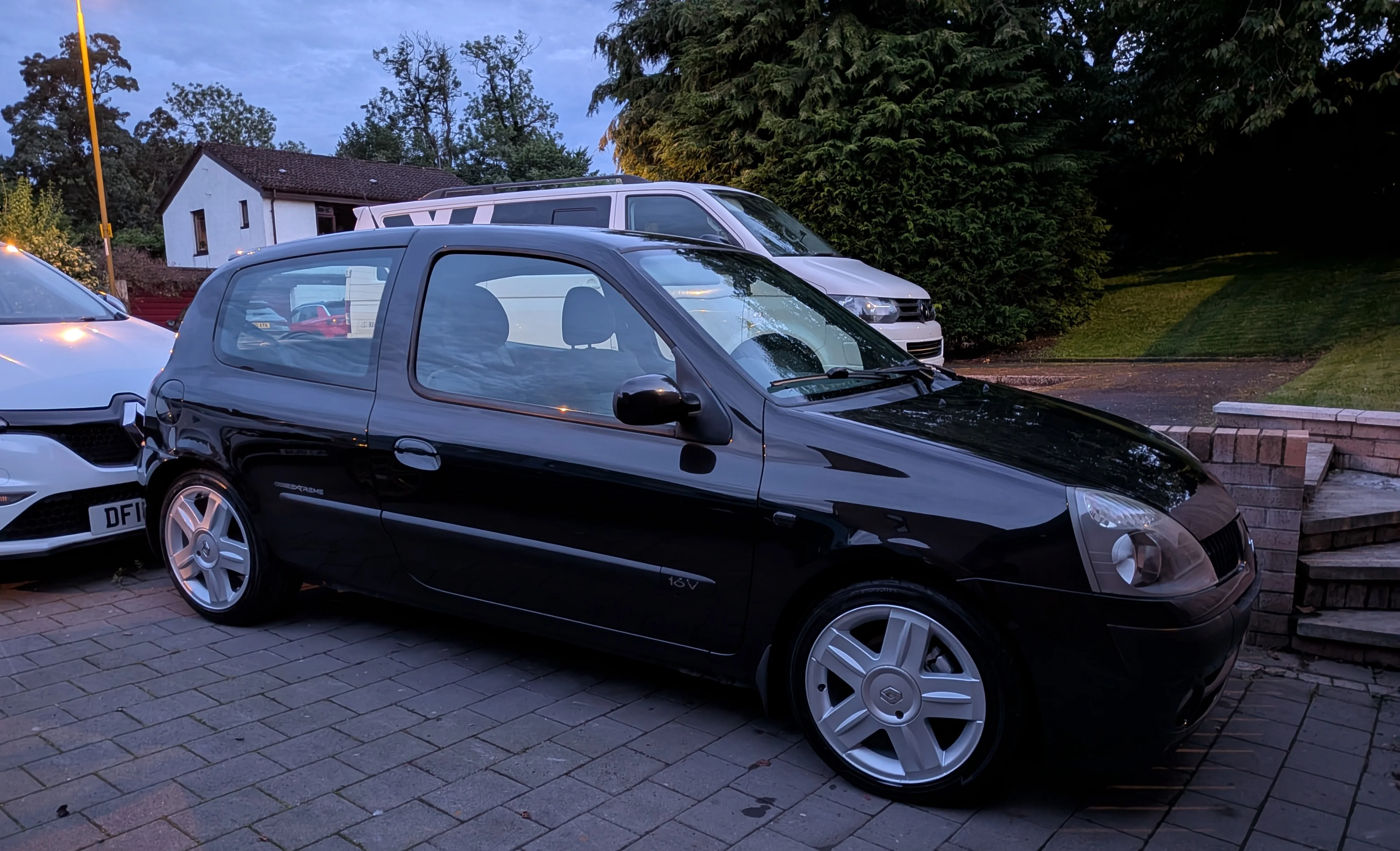

A quick tidy up project, "Ill make an easy £500 on that"......... "I like that wee car i might run it for a wee while" - Usual story for me, been here before!....

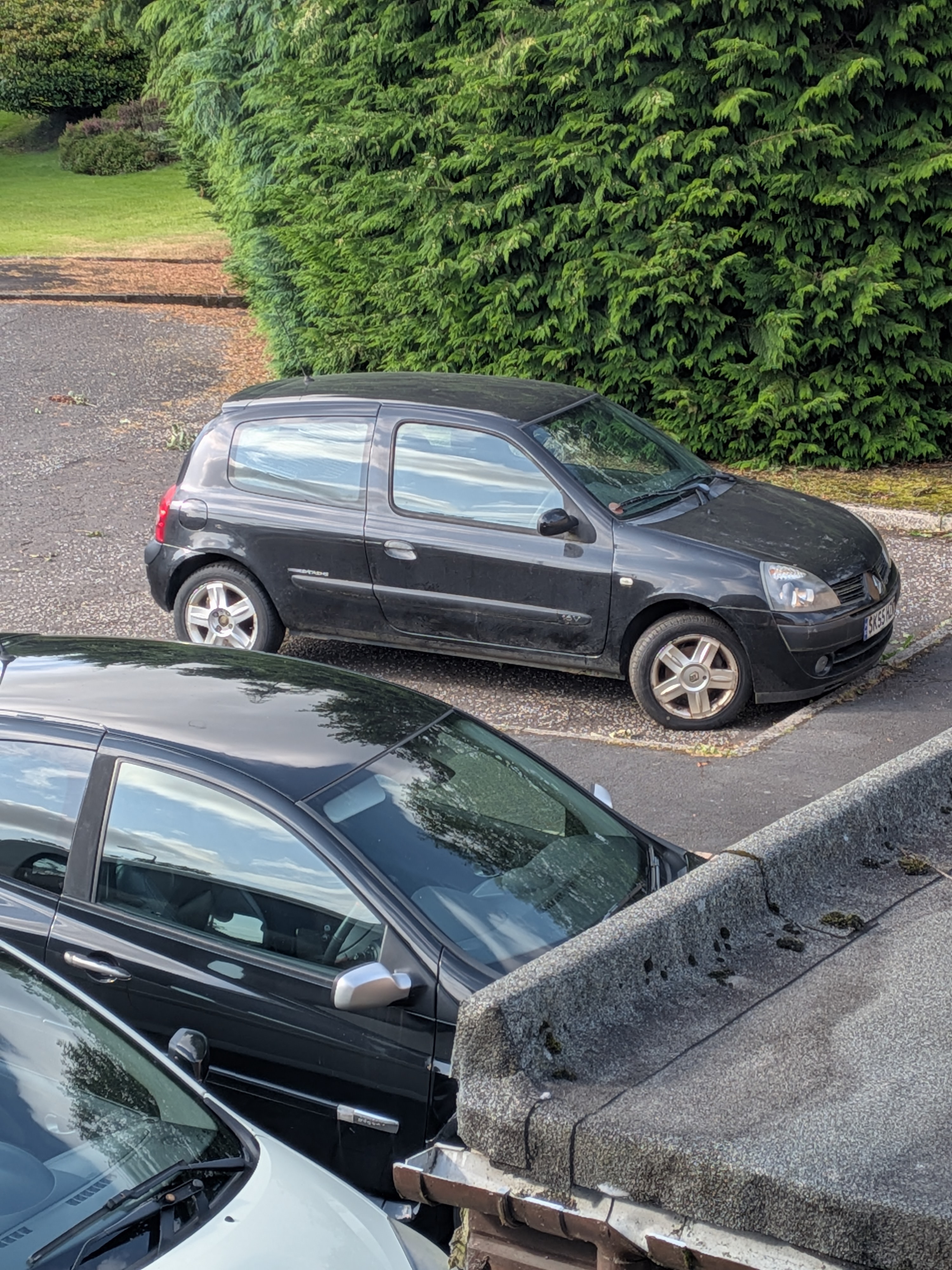

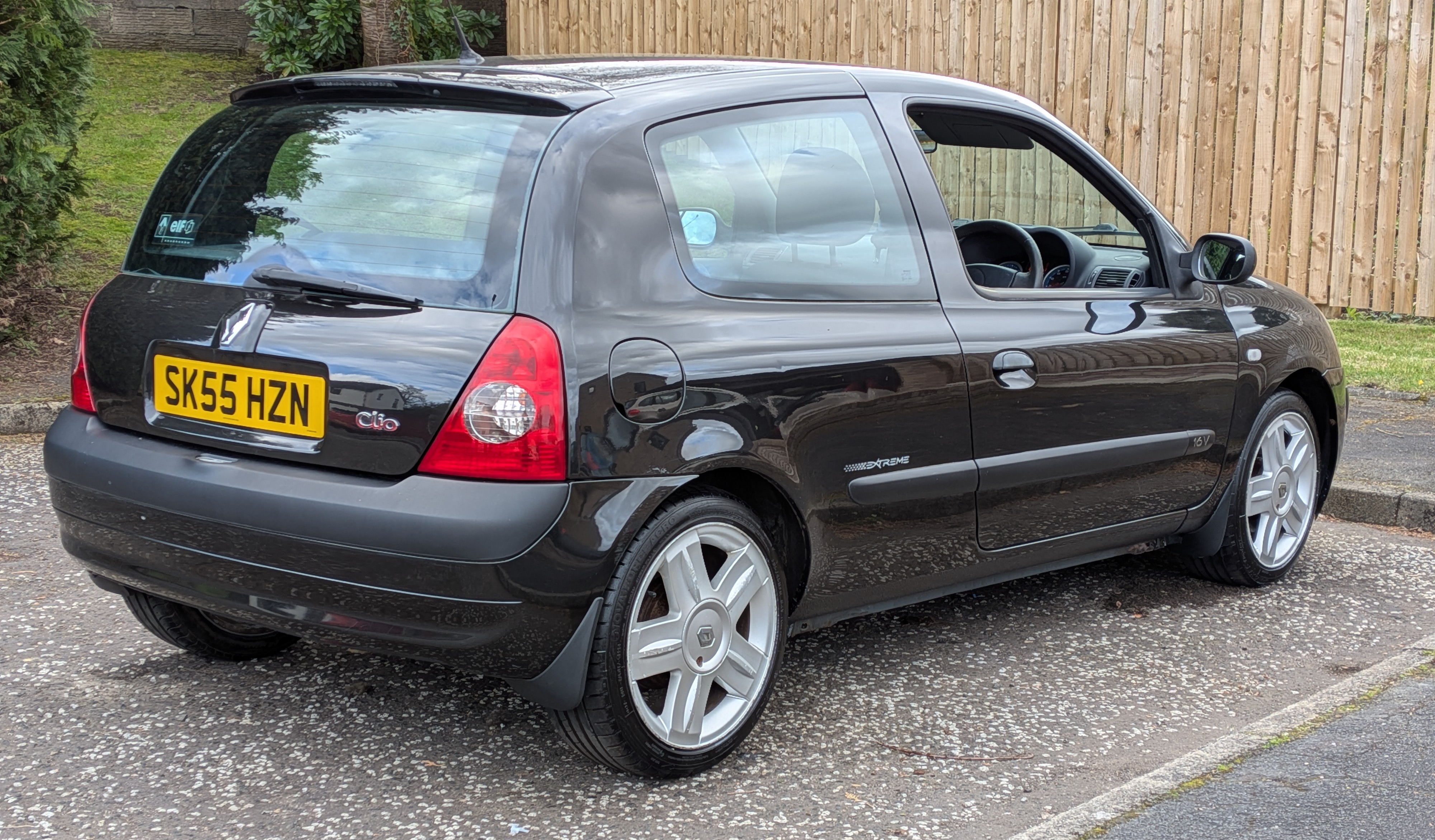

Anyway, seen a 2005 Clio 1.2 16v Extreme 4 listed on eBay, Starting at £100, Pics were rubbish, description was rubbish. - But it was only 15 miles away.

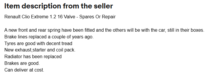

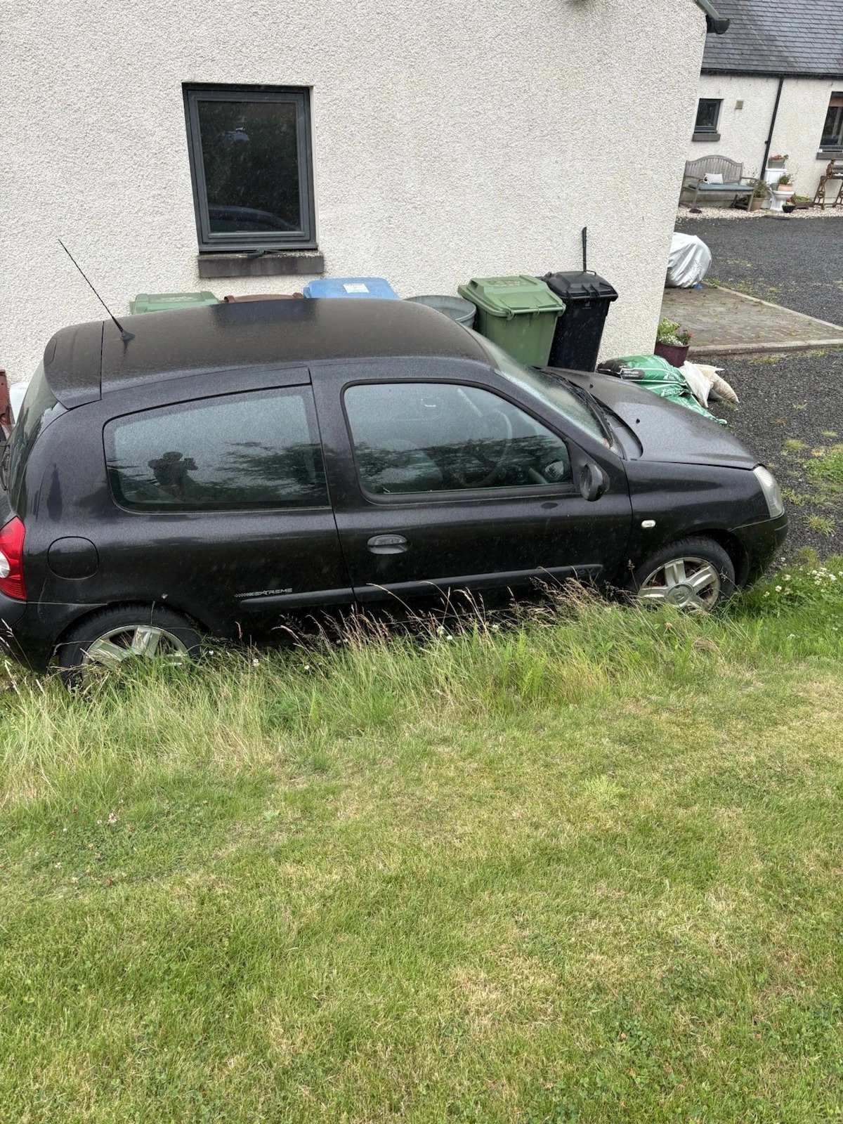

stuck a bid in the last 5 seconds and won it, £155, worst case it needs an engine, ill still be quids in, Description does say spares or repairs but doesn't mention if it runs or not. Messaged the seller and turns out it doesn't, turns over slowly, sounds horrible, doesn't start, engine may be starting to seize. so i gave my mate a shout who has a recovery truck.
I was away in Leeds with work and got a text from my Mrs saying assume this is something to do with you?...

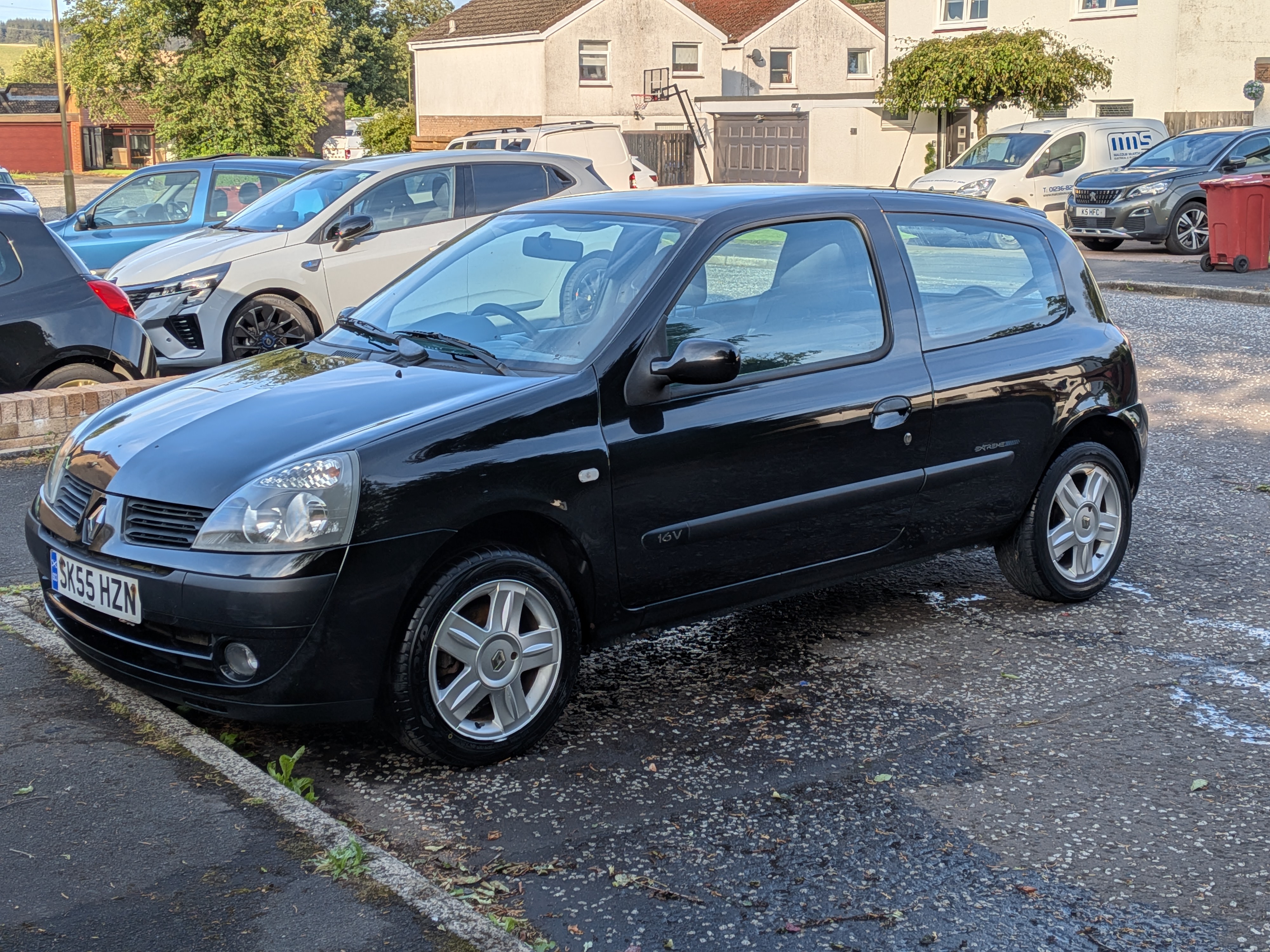

Got home had a look around it, needs a good clean, bit of bubbling on the rear quarters at each side but otherwise looks fairly straight, so me and my young lass got to work, tried to turn it over...
At first it sounded terrible then i remembered, "IVE BEEN HERE BEFORE!"
Cut the alternator belt off it..

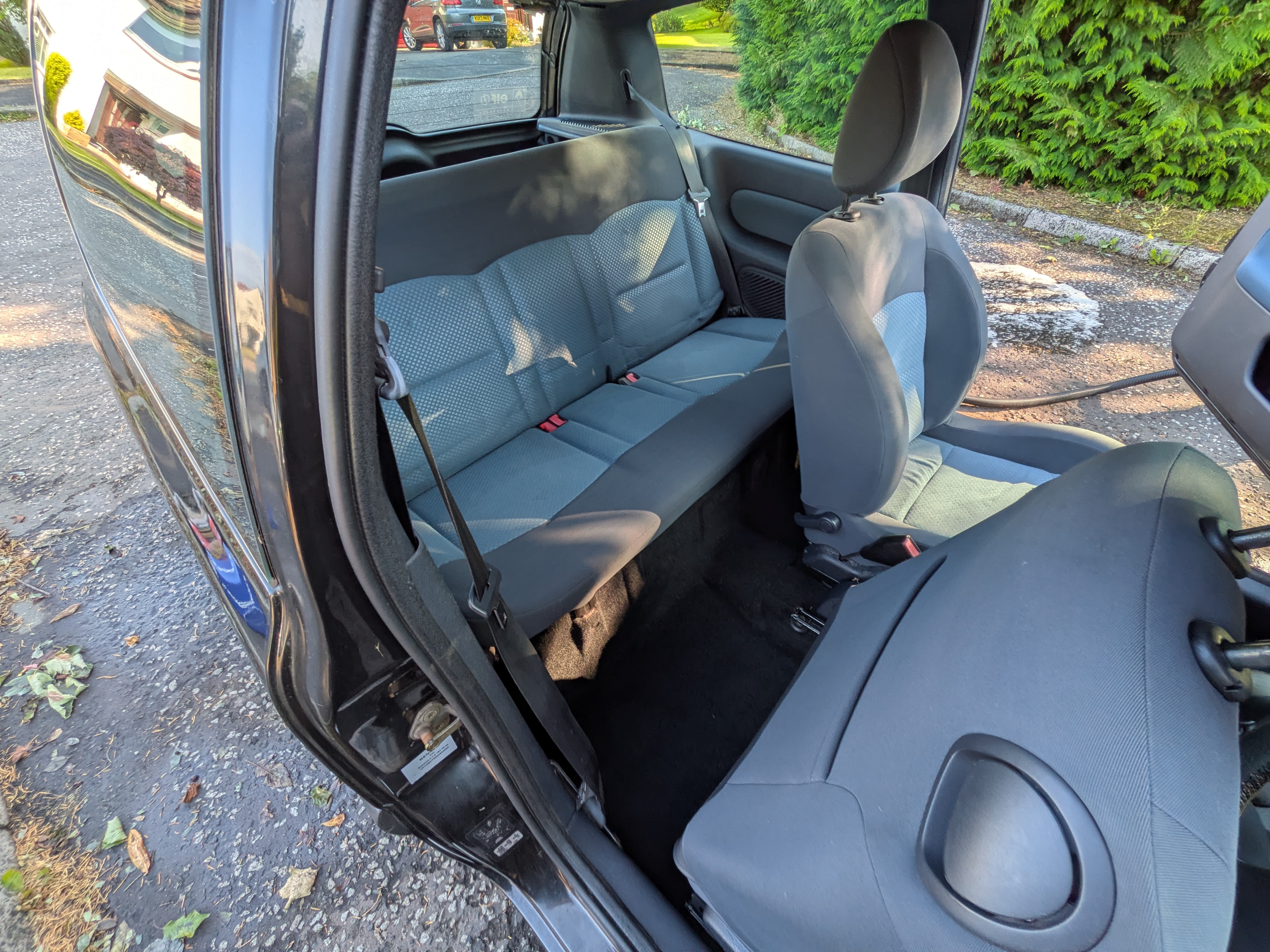

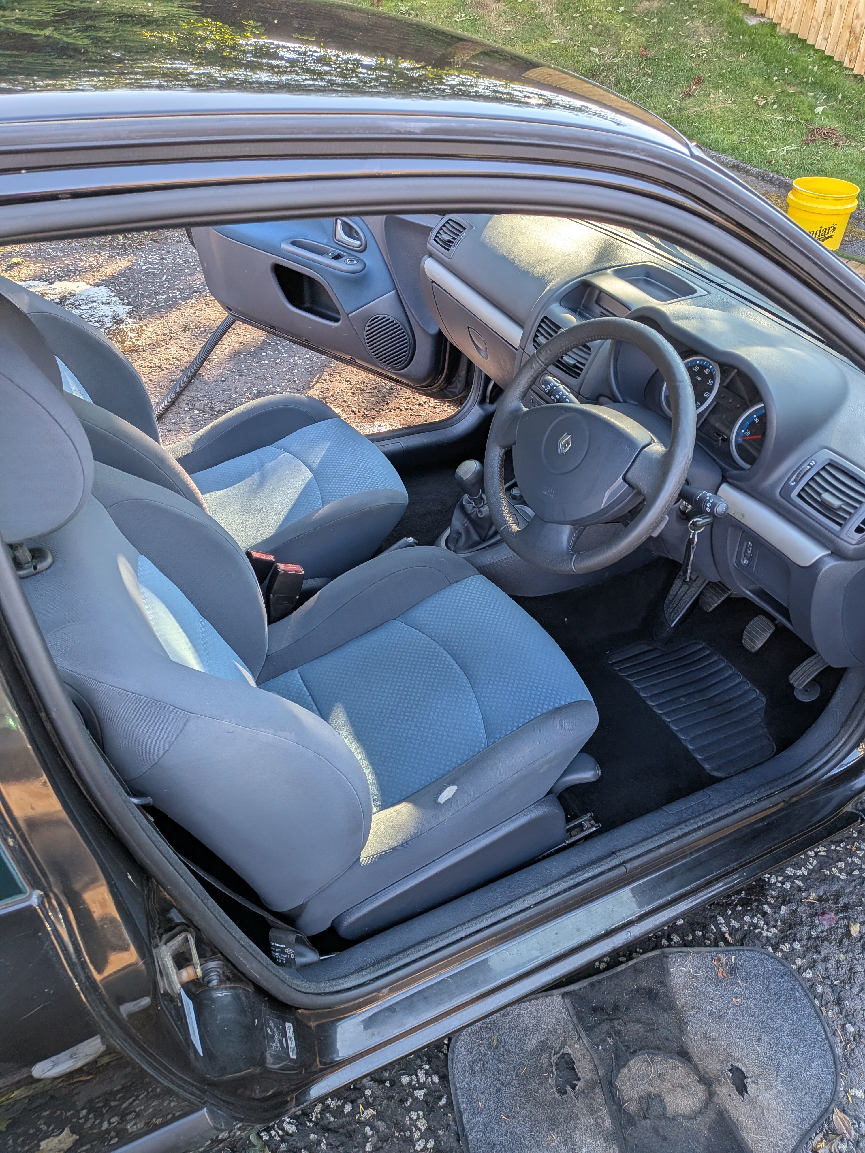

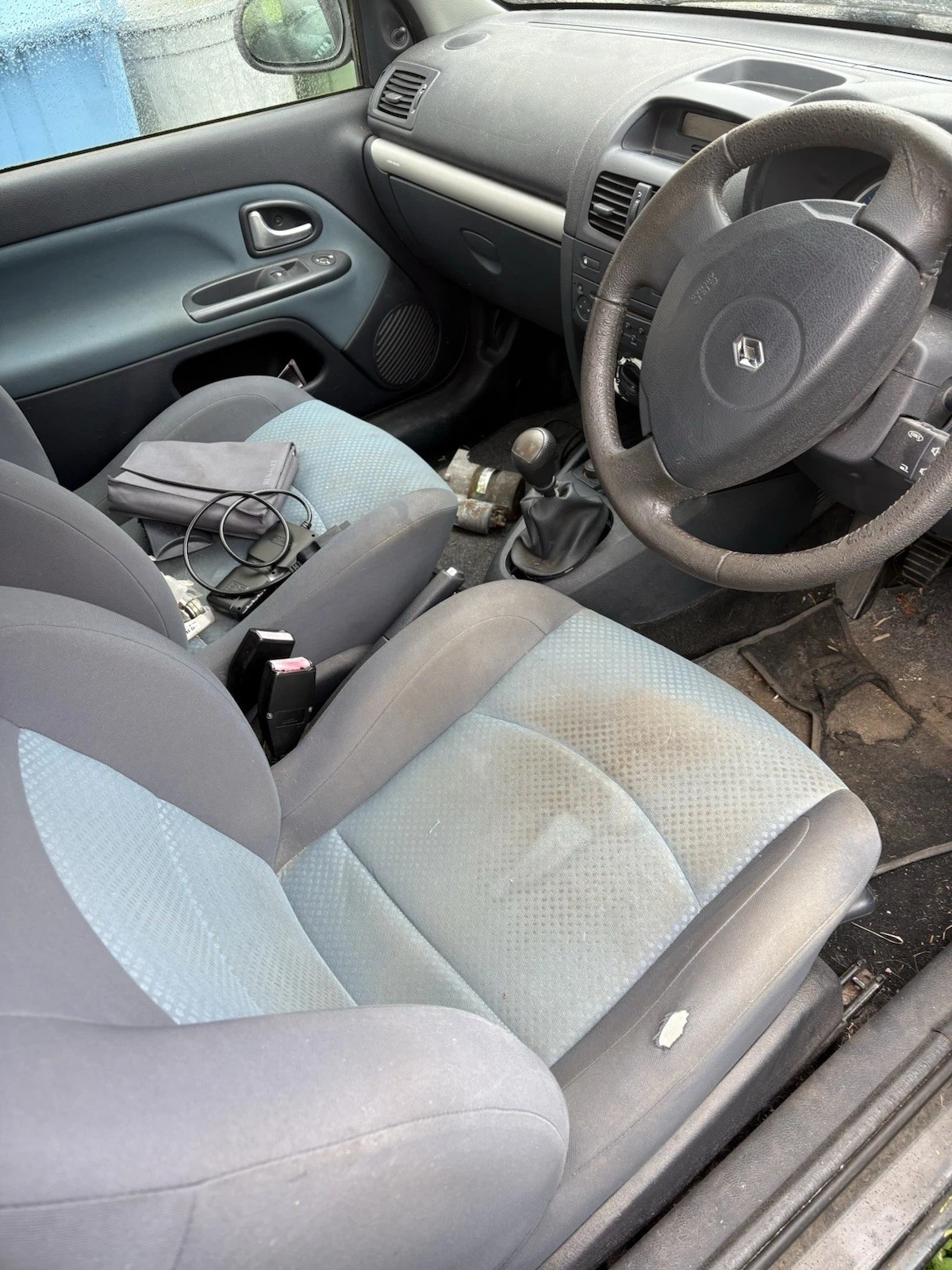

Gave the insides a shampoo as it was horrid.

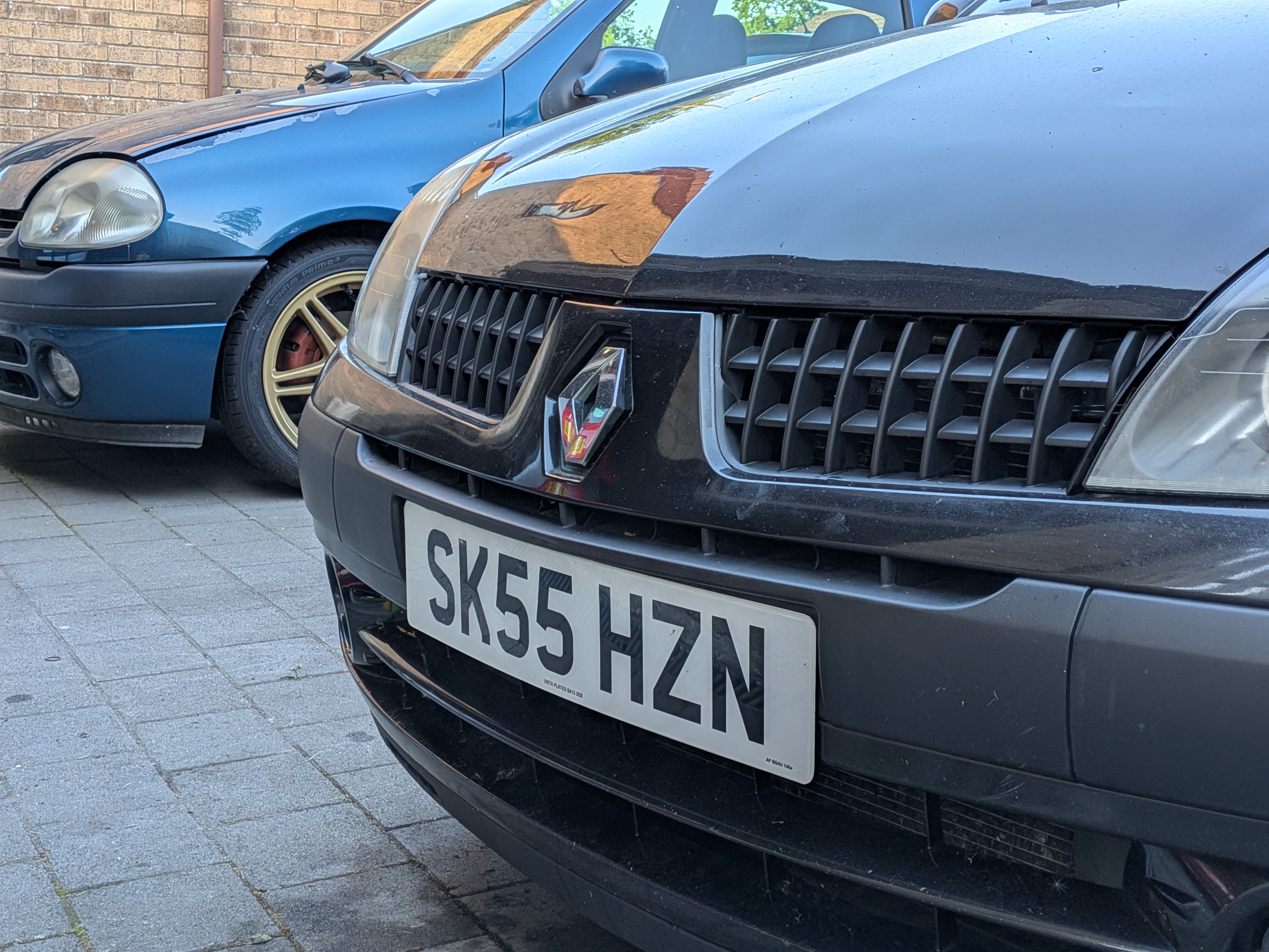

and a detar, clay and quick run over with the machine polisher..

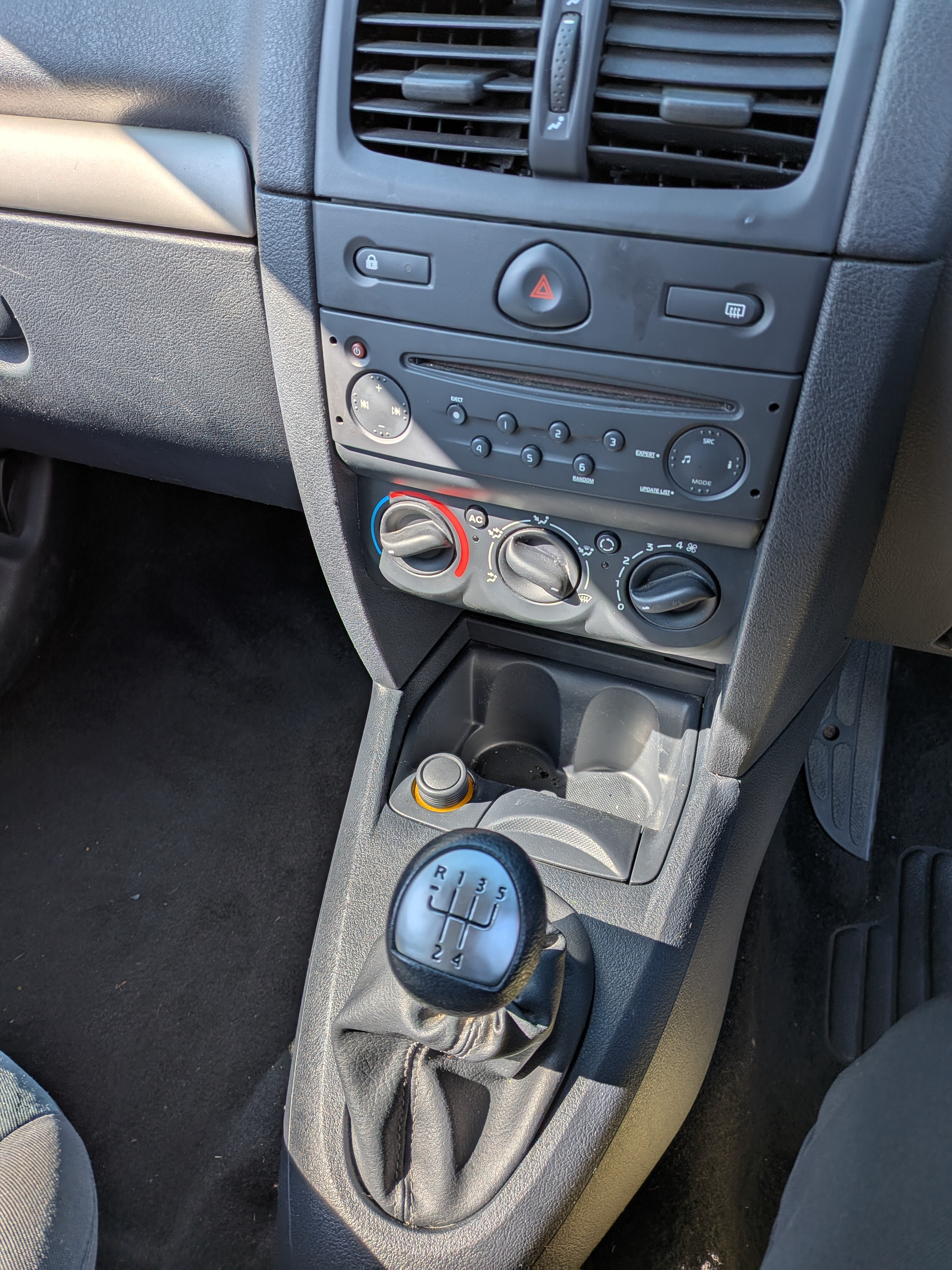

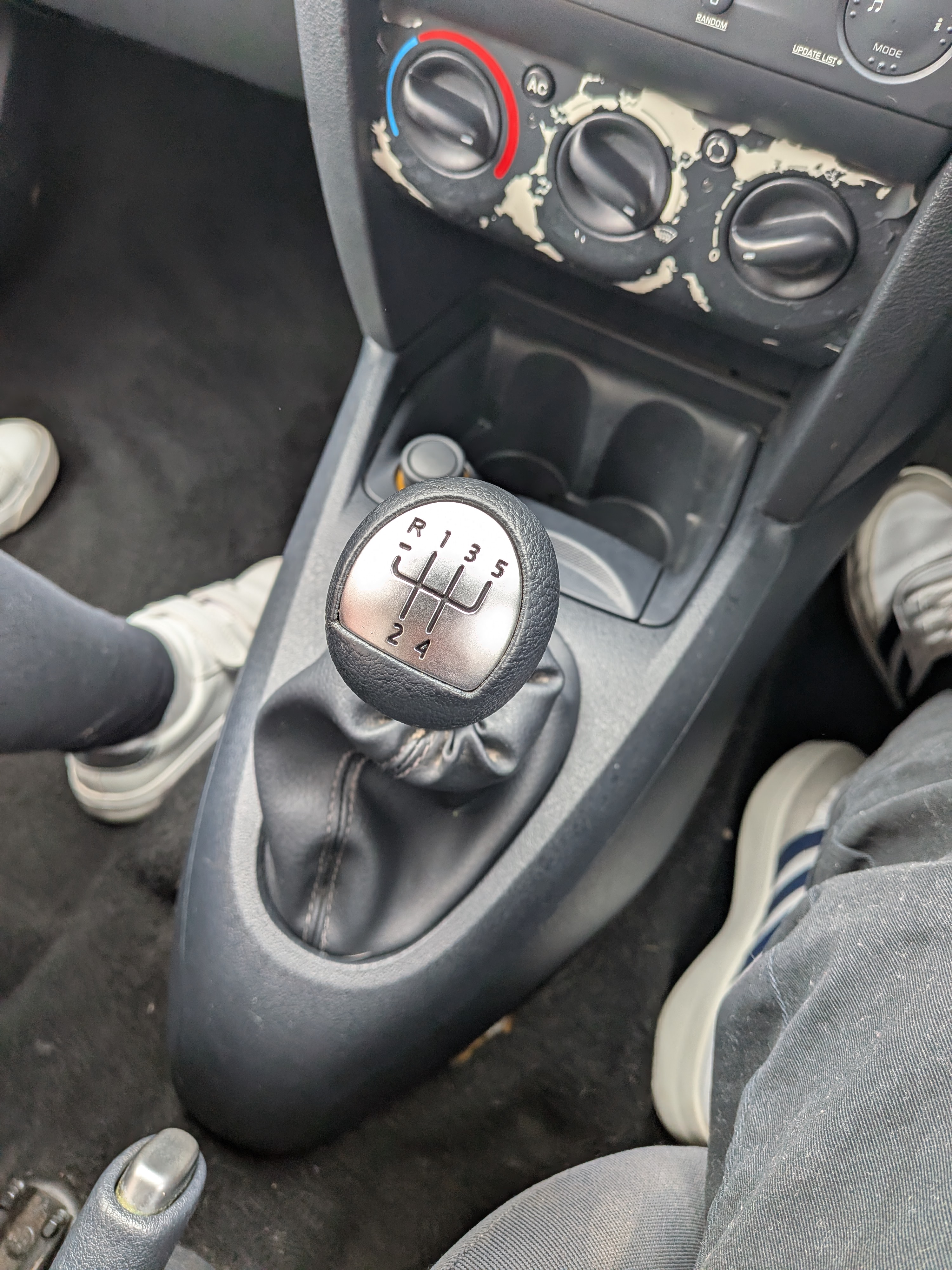

Found a refurbished ph2 gear knob insert (gear pattern indented rather than printed on the ph3)

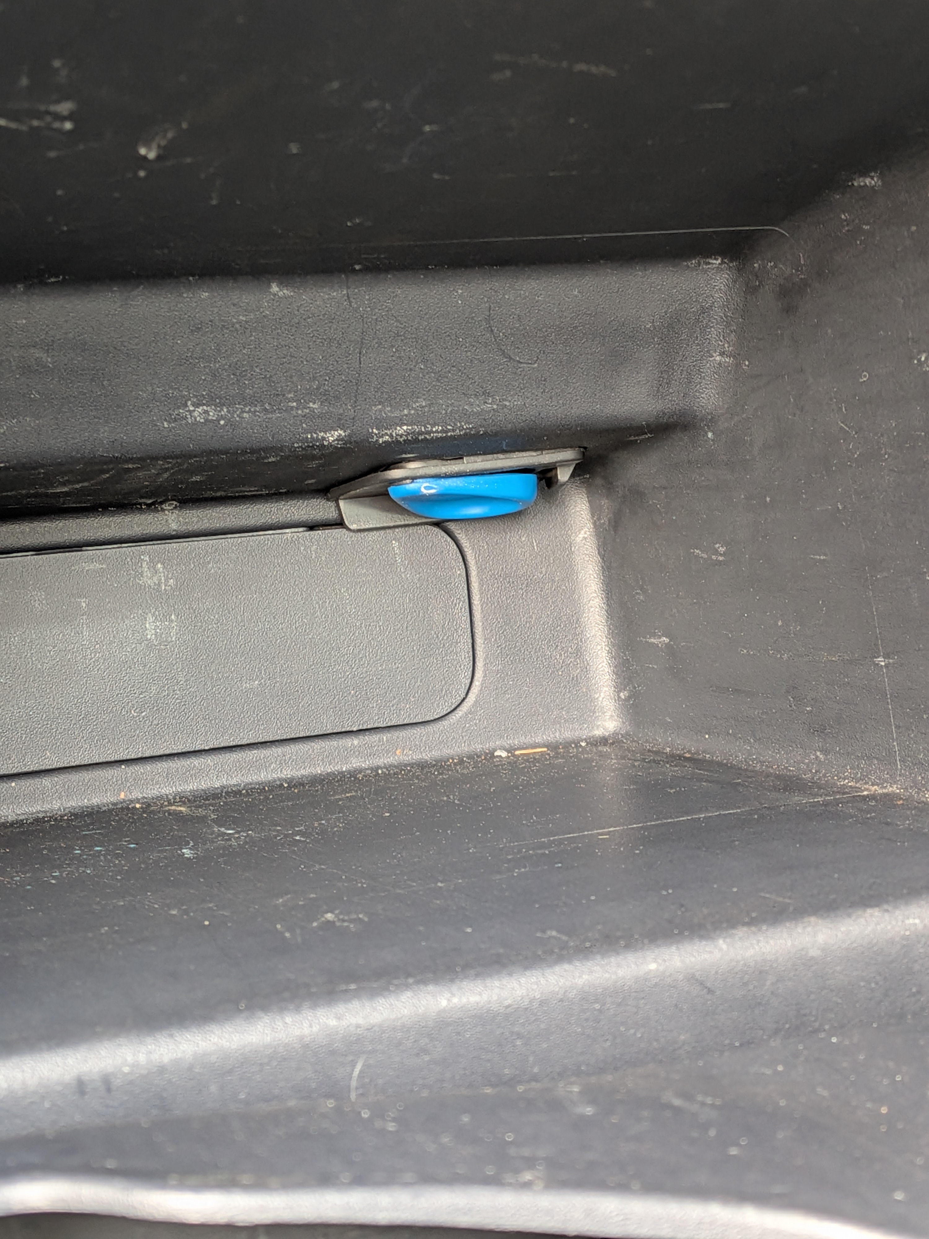

Its an AC car, although some ersehole has removed the condenser and snipped an AC pipe (watch this space :ROFLMAO: ) who remembers the genious mk2 clio AC cooled glovebox?!!!

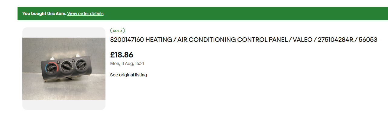

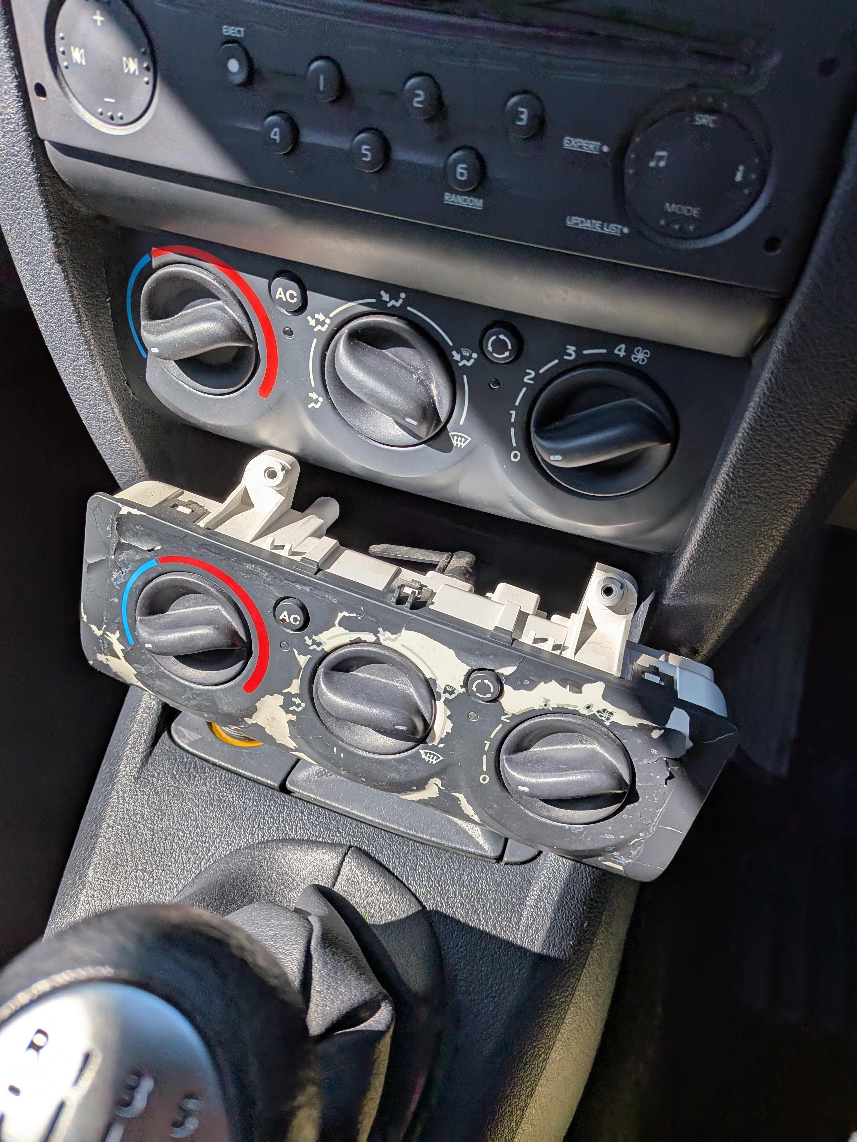

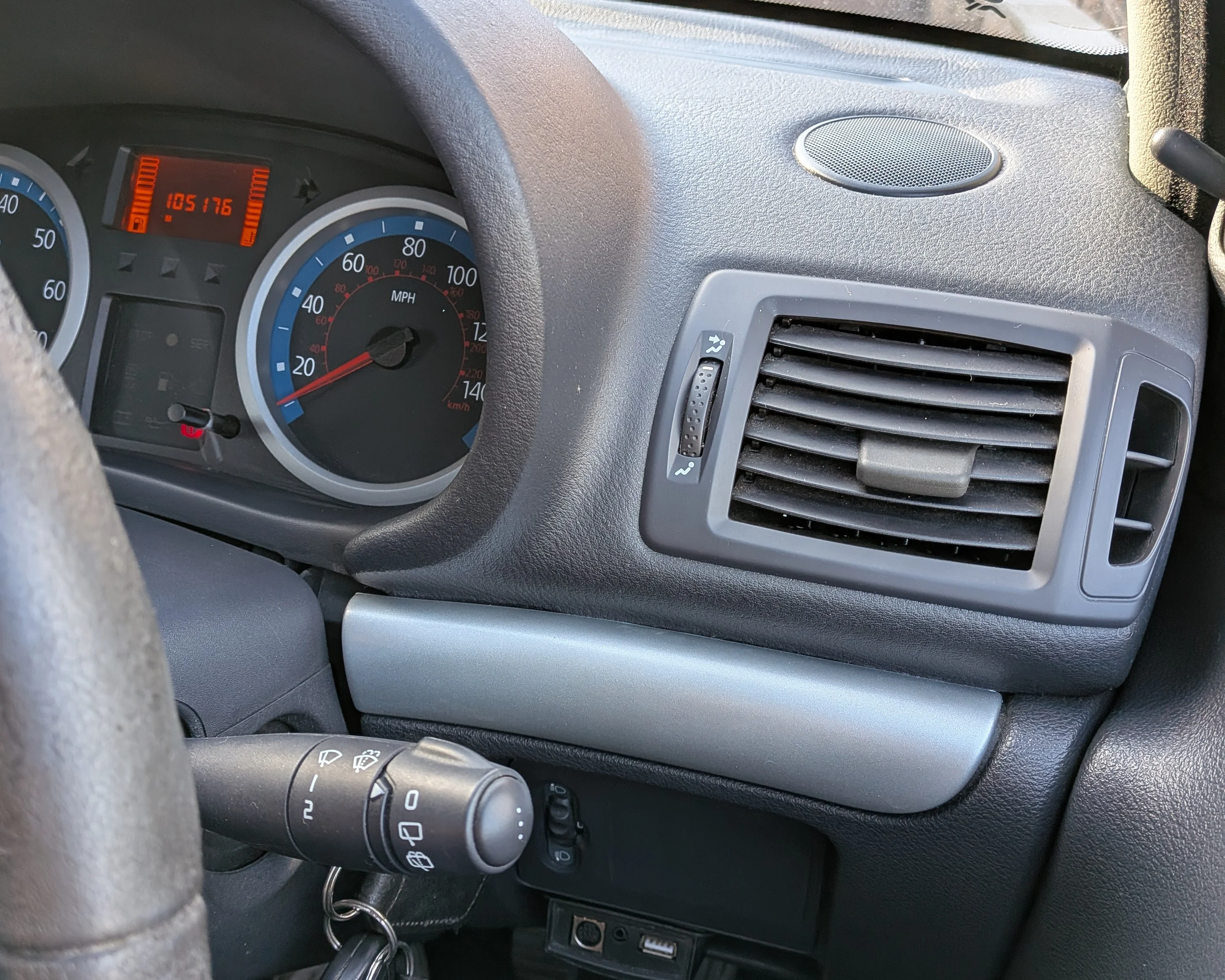

It has the usual ph3 peeling heating control panel, so ive got one on route from spain from an early car (they dont suffer the same failure)

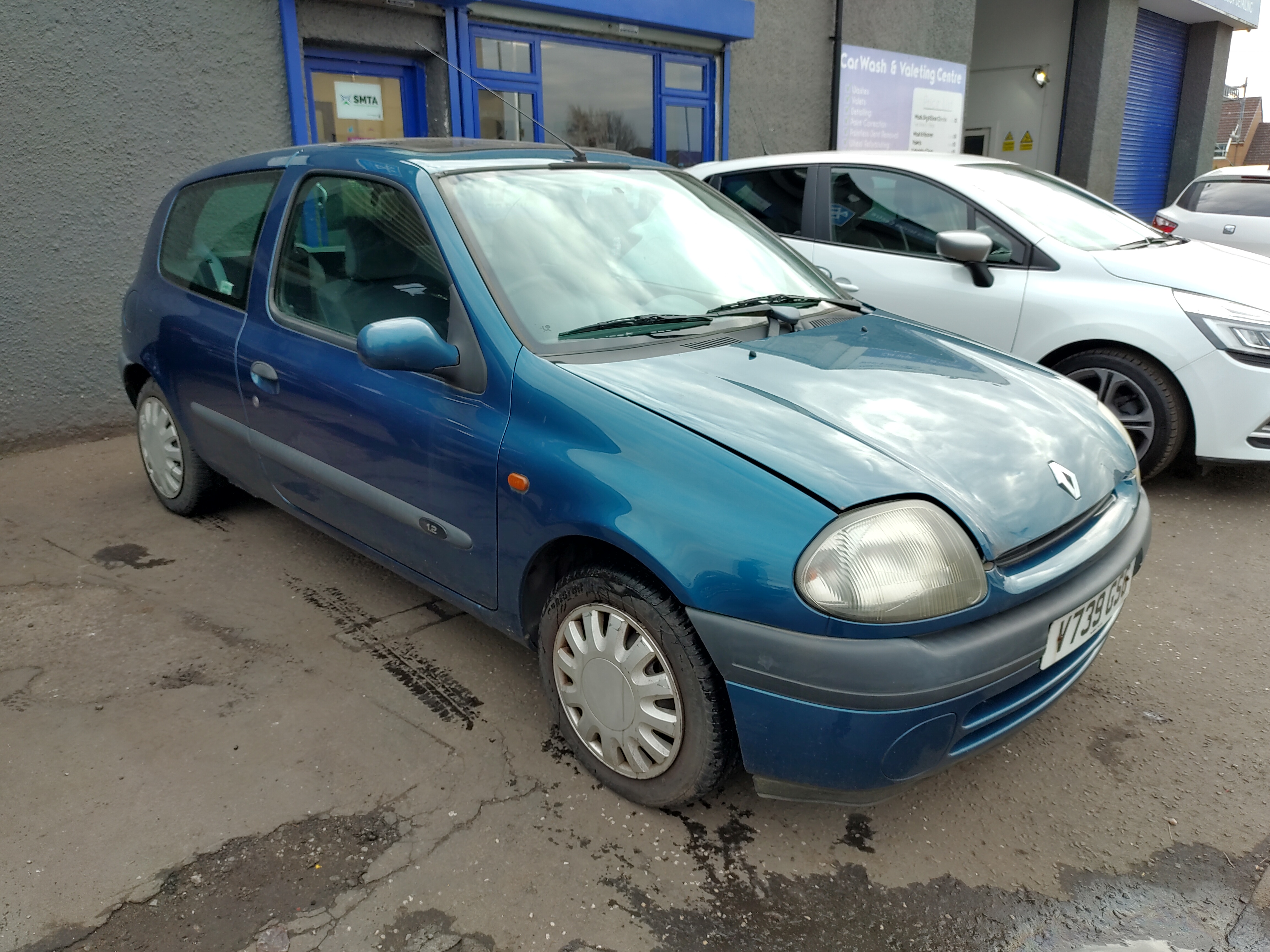

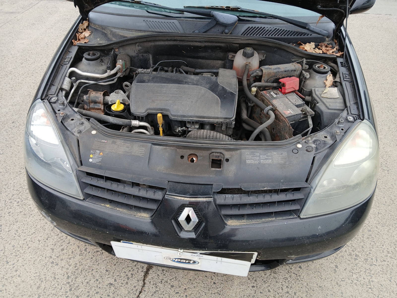

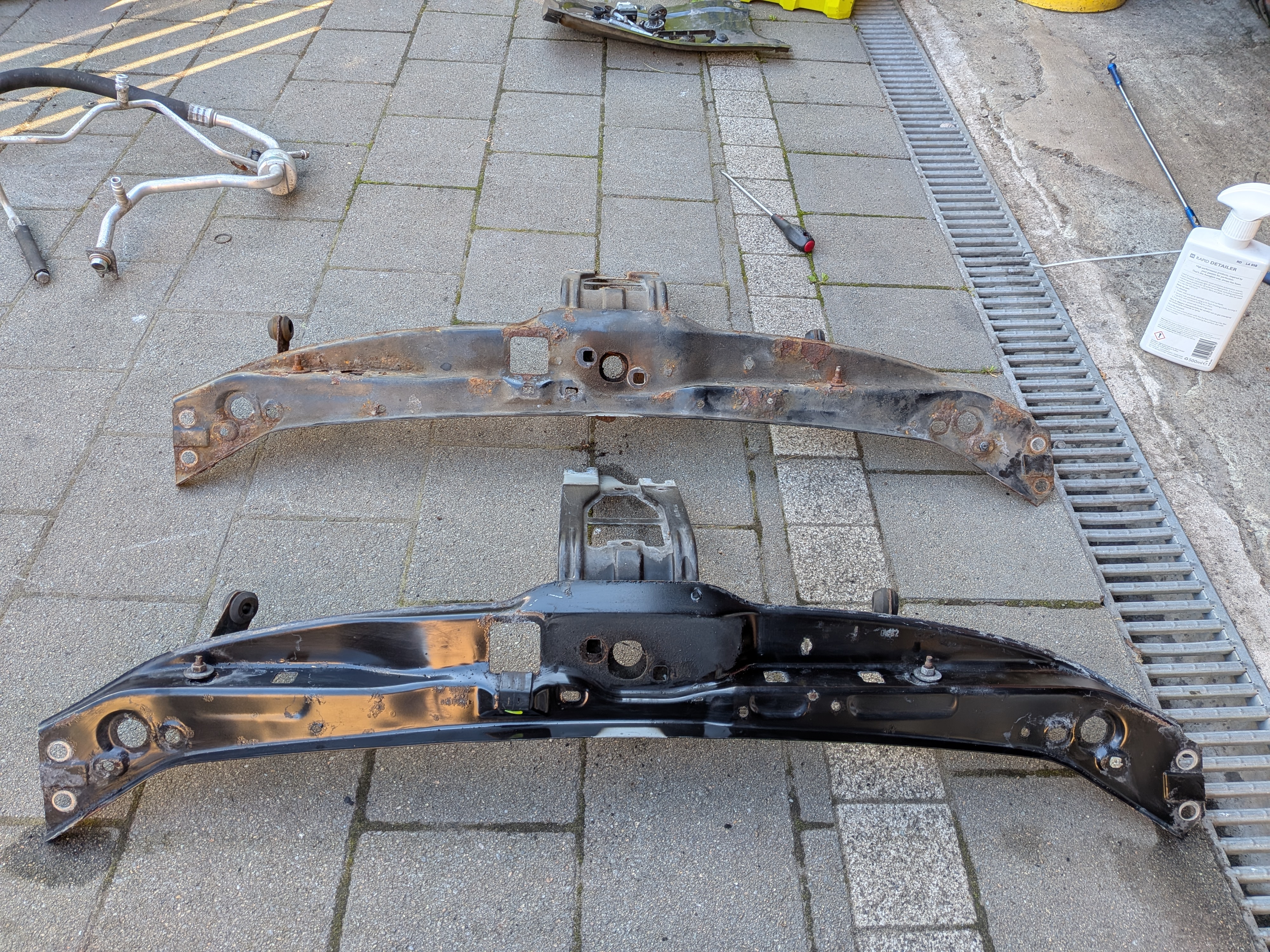

Was at the scrappy as there was a fairly late 1.2 16v Campus in, i actually went for the bonnet because mine is rotten on the underside, bonnet was good on the car in the scrappy in the pics but some genius had lifted it right up and back against the windscreen f**king it in the 2 days it had been there! great!

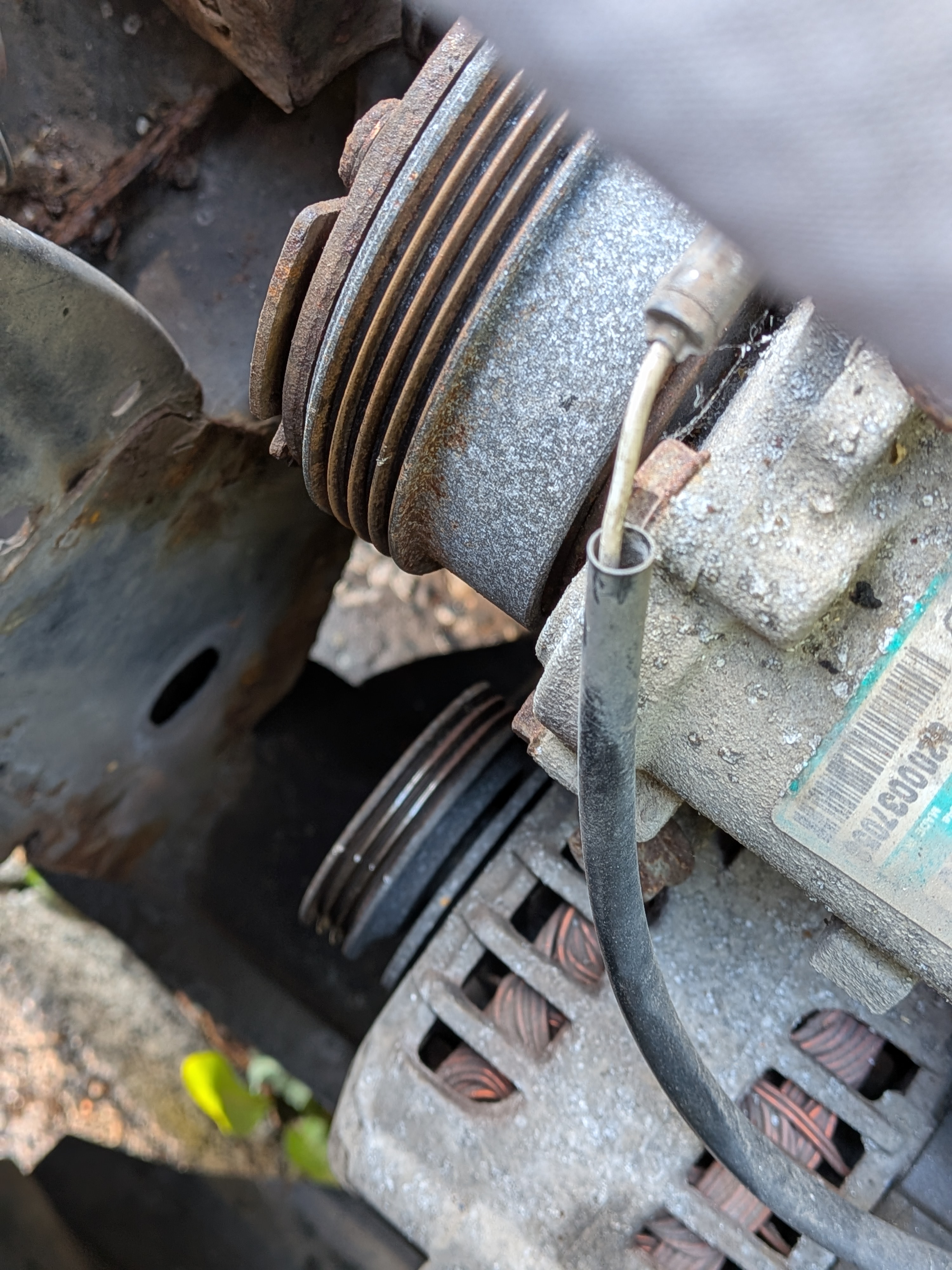

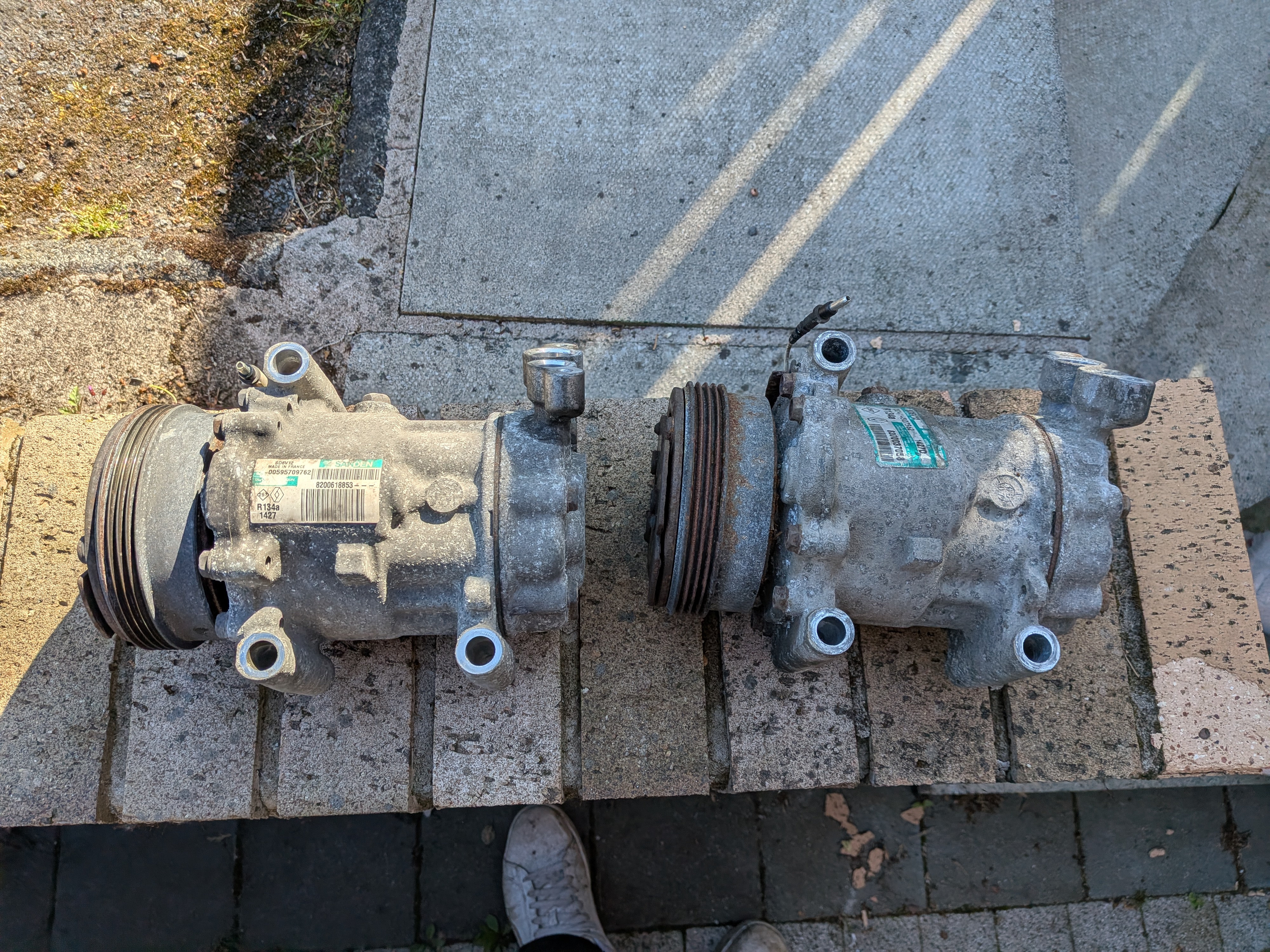

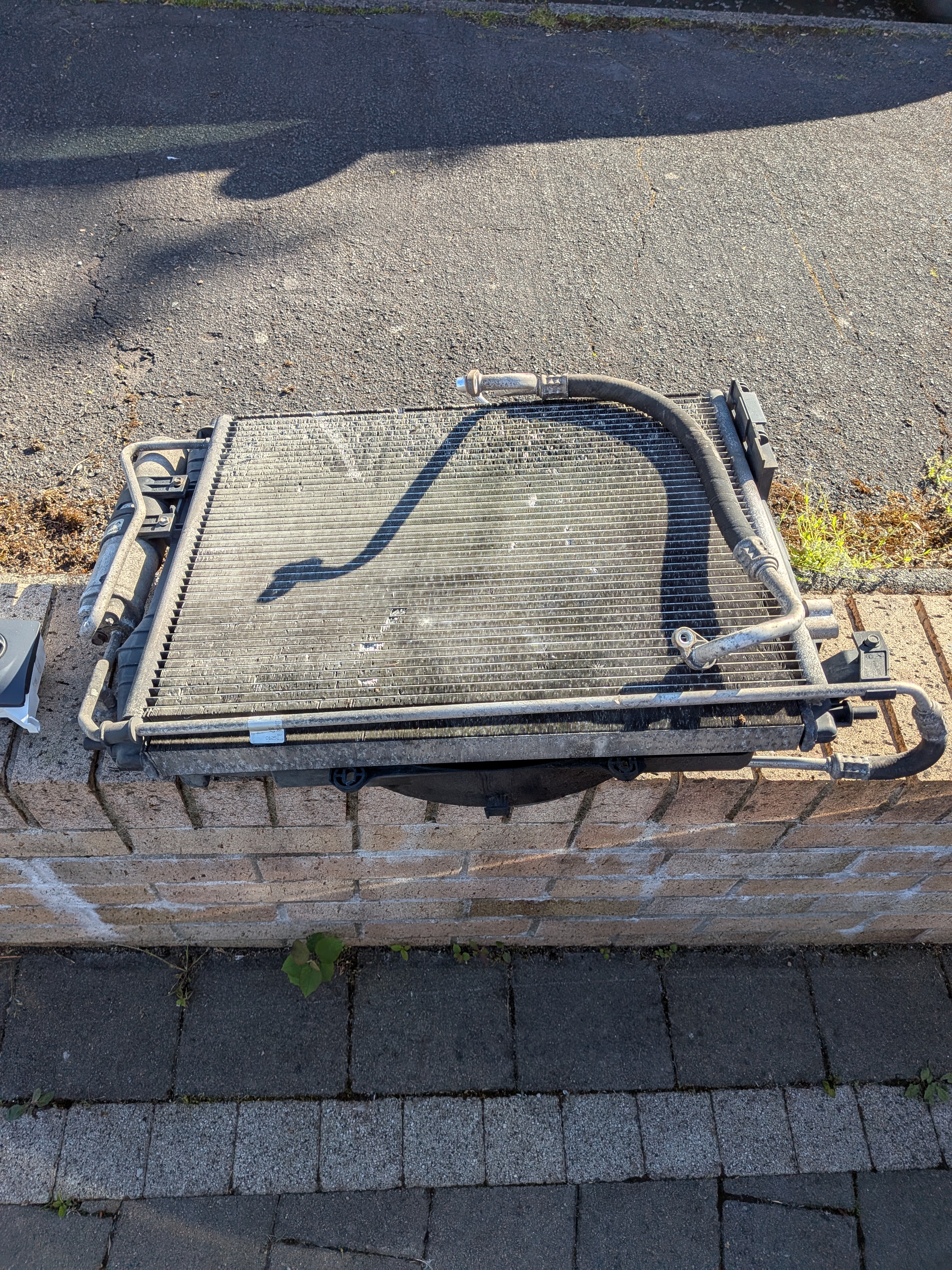

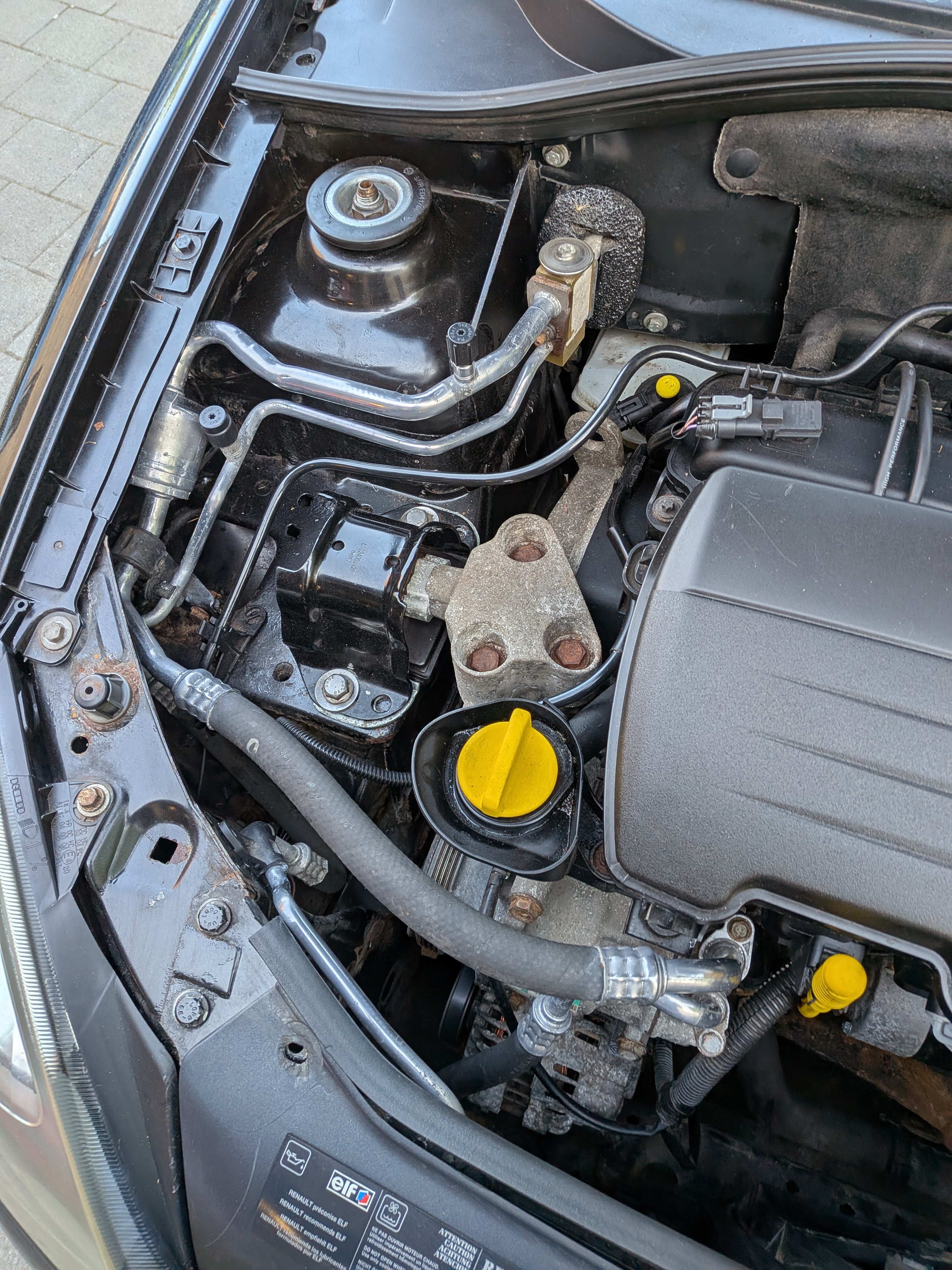

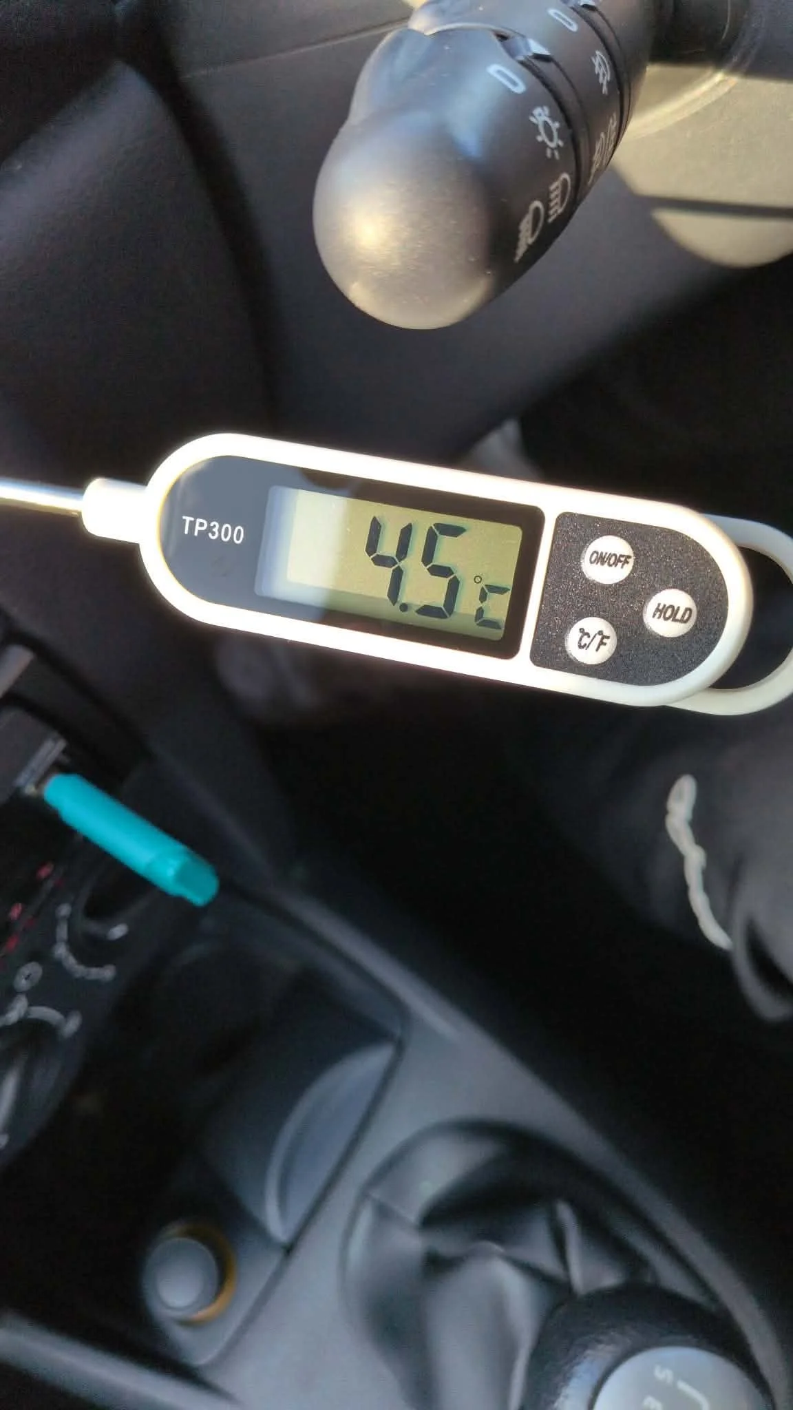

However it was an AC car and my car at some point has had a new radiator and they have just snipped the AC pipes and removed them from the compressor! The scrappy remove the AC gas before it goes into the yard but a quick test of the valves showed they were still holding residual pressure so i can only assume the system is fairly healthy!
I grabbed the Compressor, pipework and full rad pack :cool:
Along with the slam panel as it was much better than mine!
Installed with new seals/O-rings - Awaiting a belt and tensioner from autodoc then i can get it regassed.

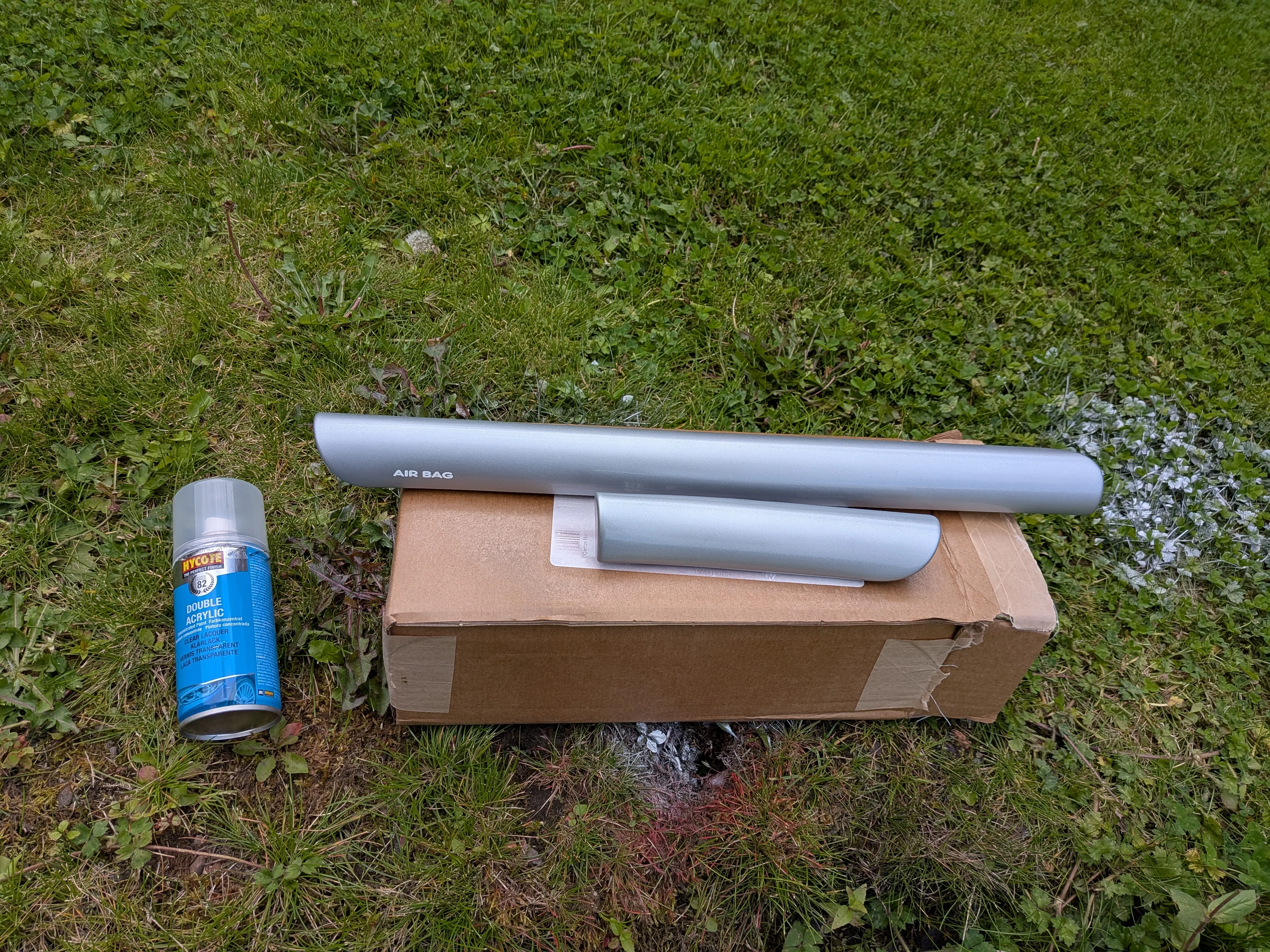

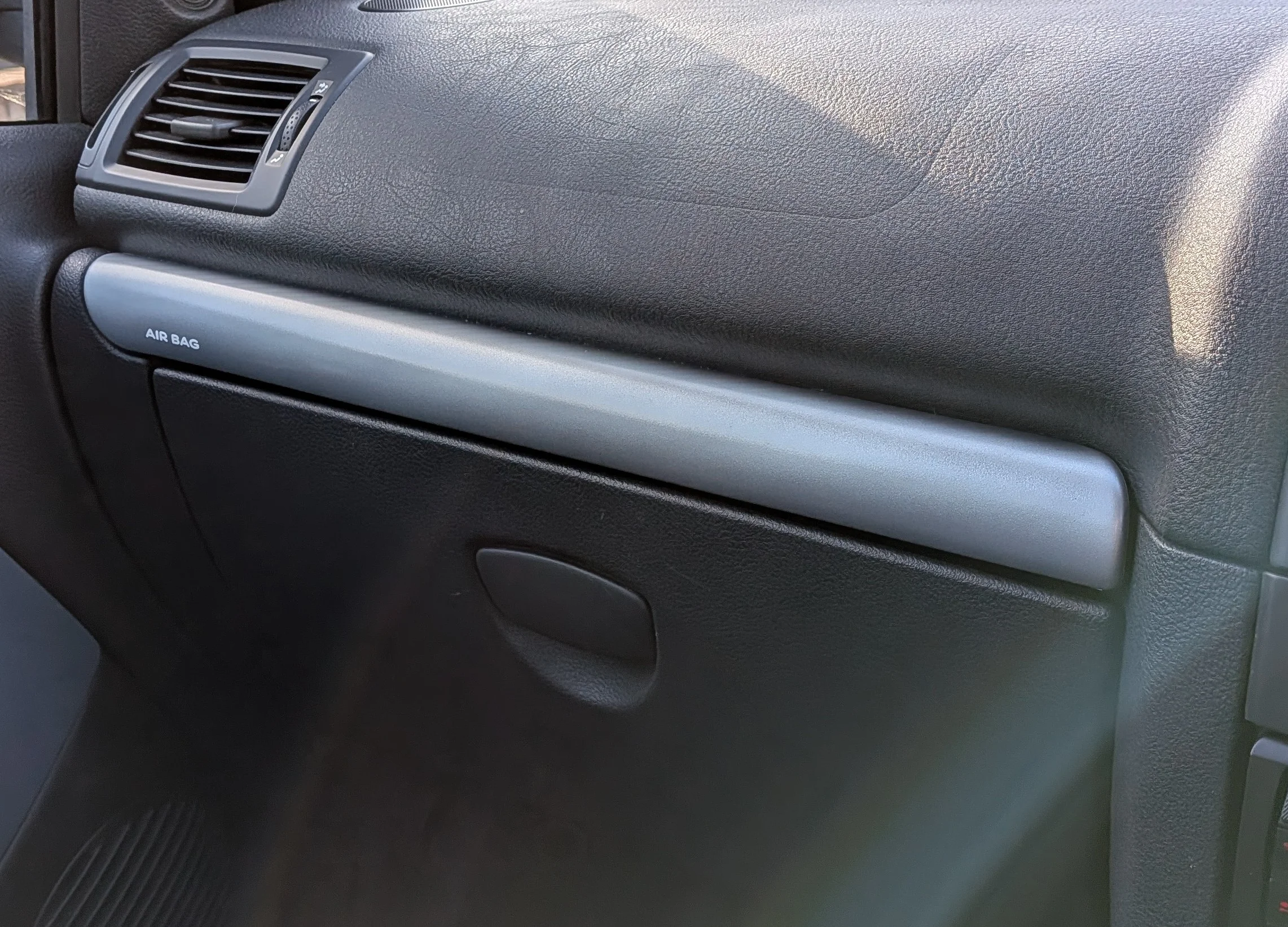

Found an RS grill in my garage, been there for years! gave it a quick going over with matt black paint and stuck it on

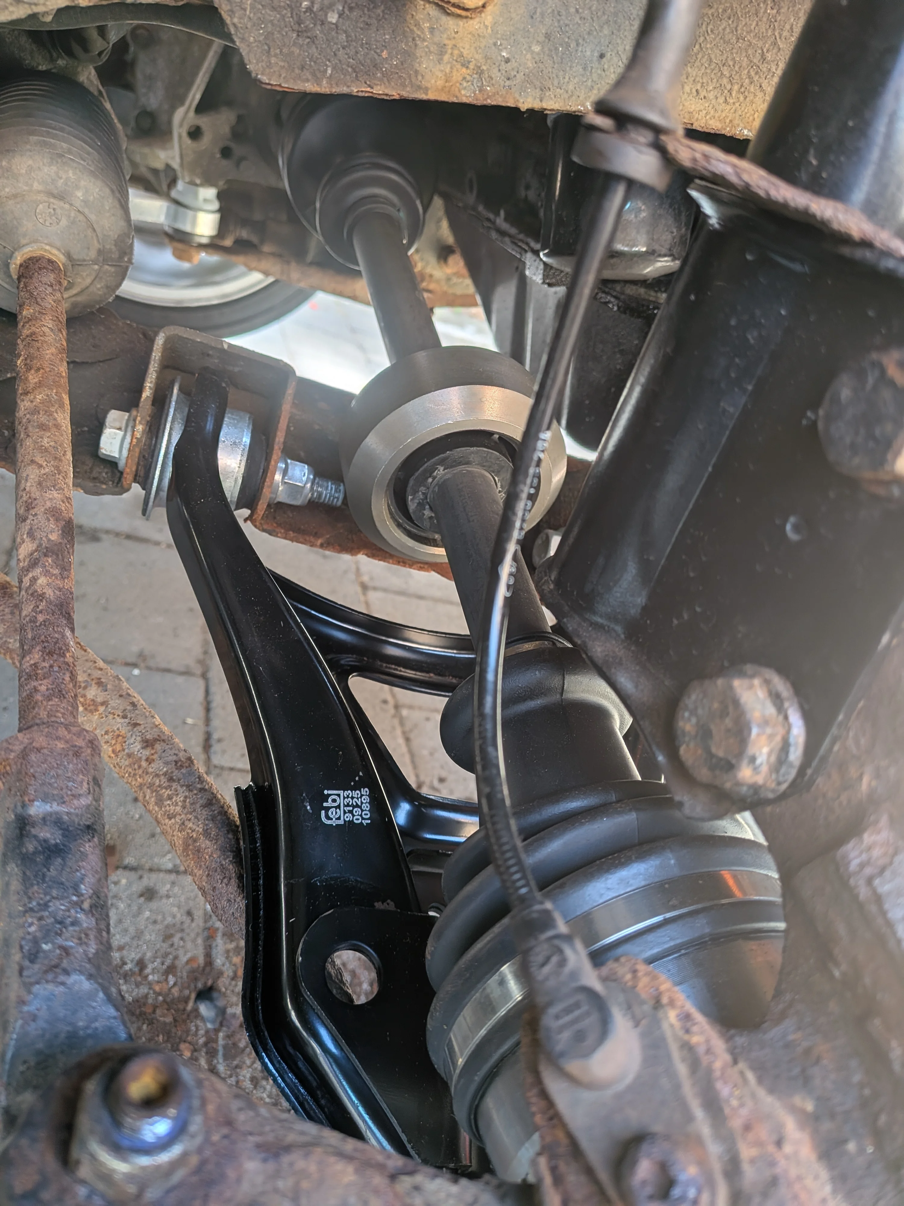

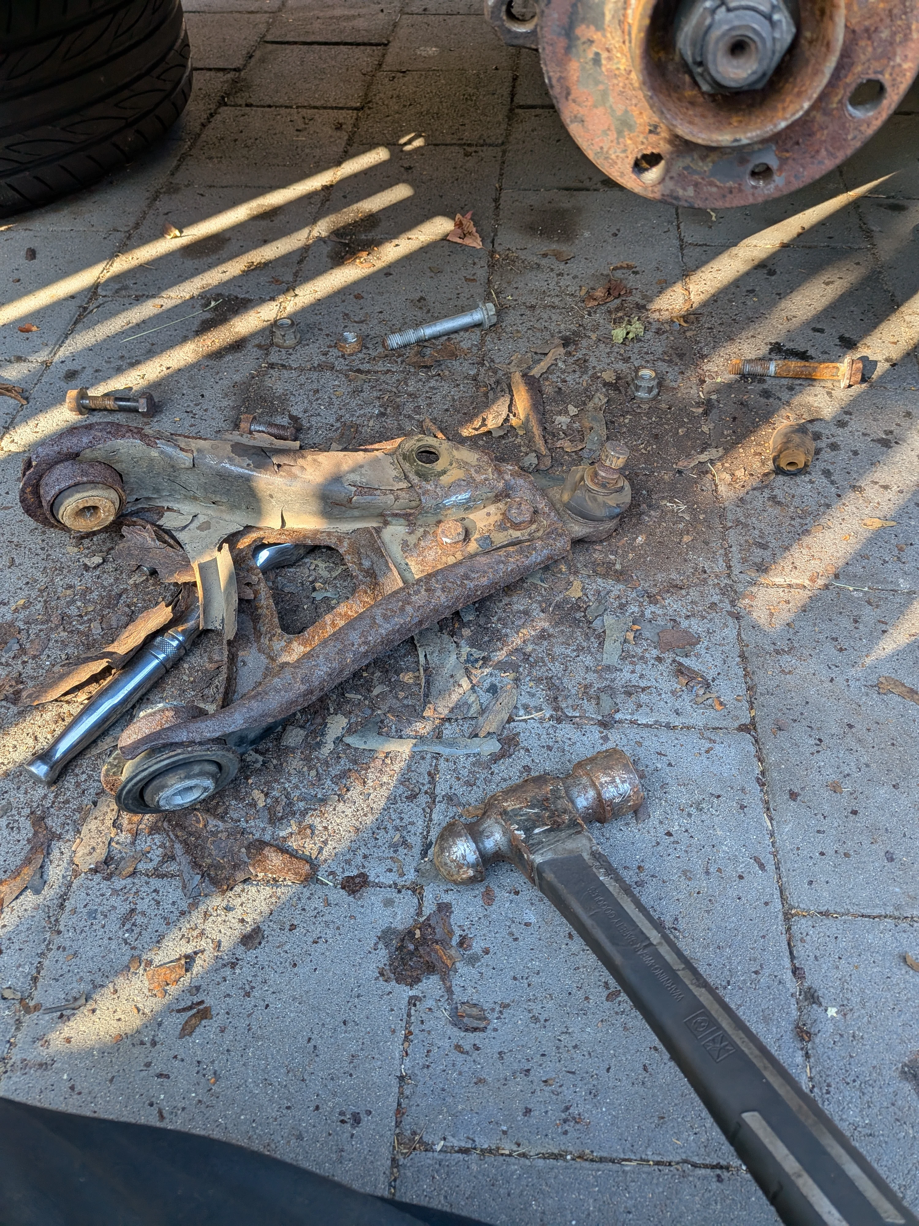

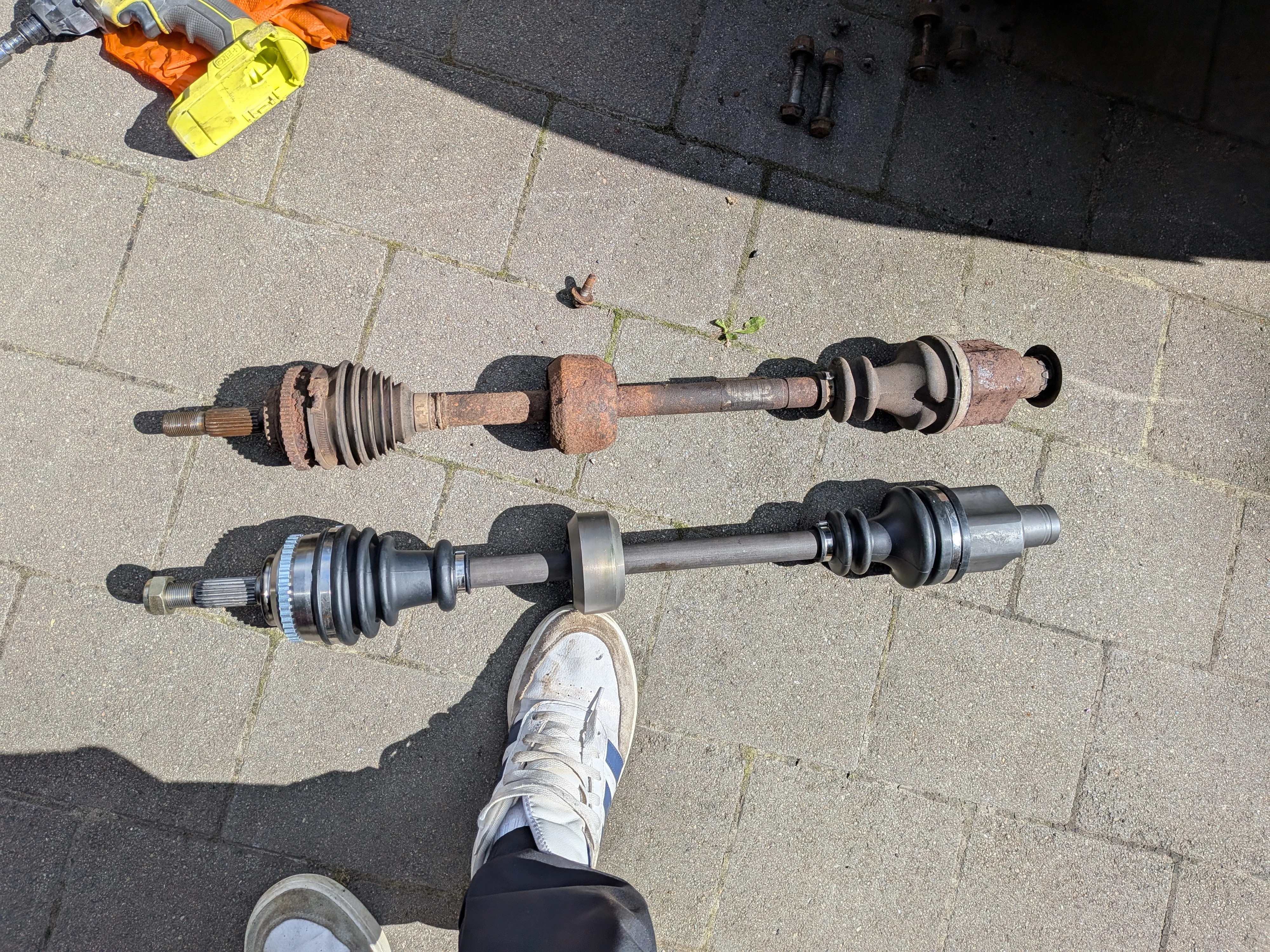

Shaft was clicking and knocking, cheap enough from Autodoc to replace, done lower arms and ARB links while i was at it as they looked like they had seen better days!
The febi arms come with all new mounting hardware which was nice!

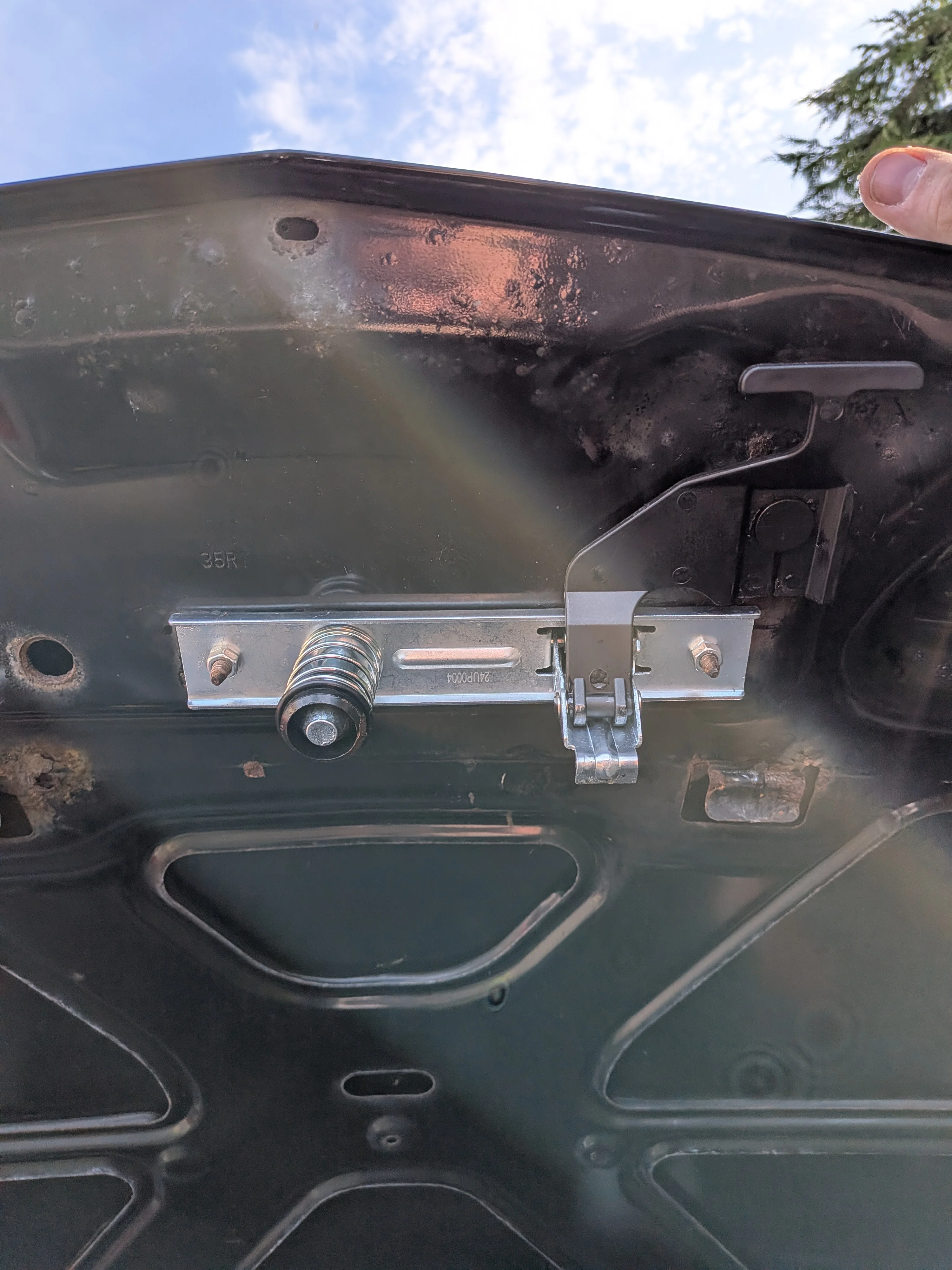

Bonnet latch felt horrible on it and didn't open or close properly, again cheap as chips from autodoc and its smooth as butter now! - Although the bonnet is rotten so trying to find a decent black one

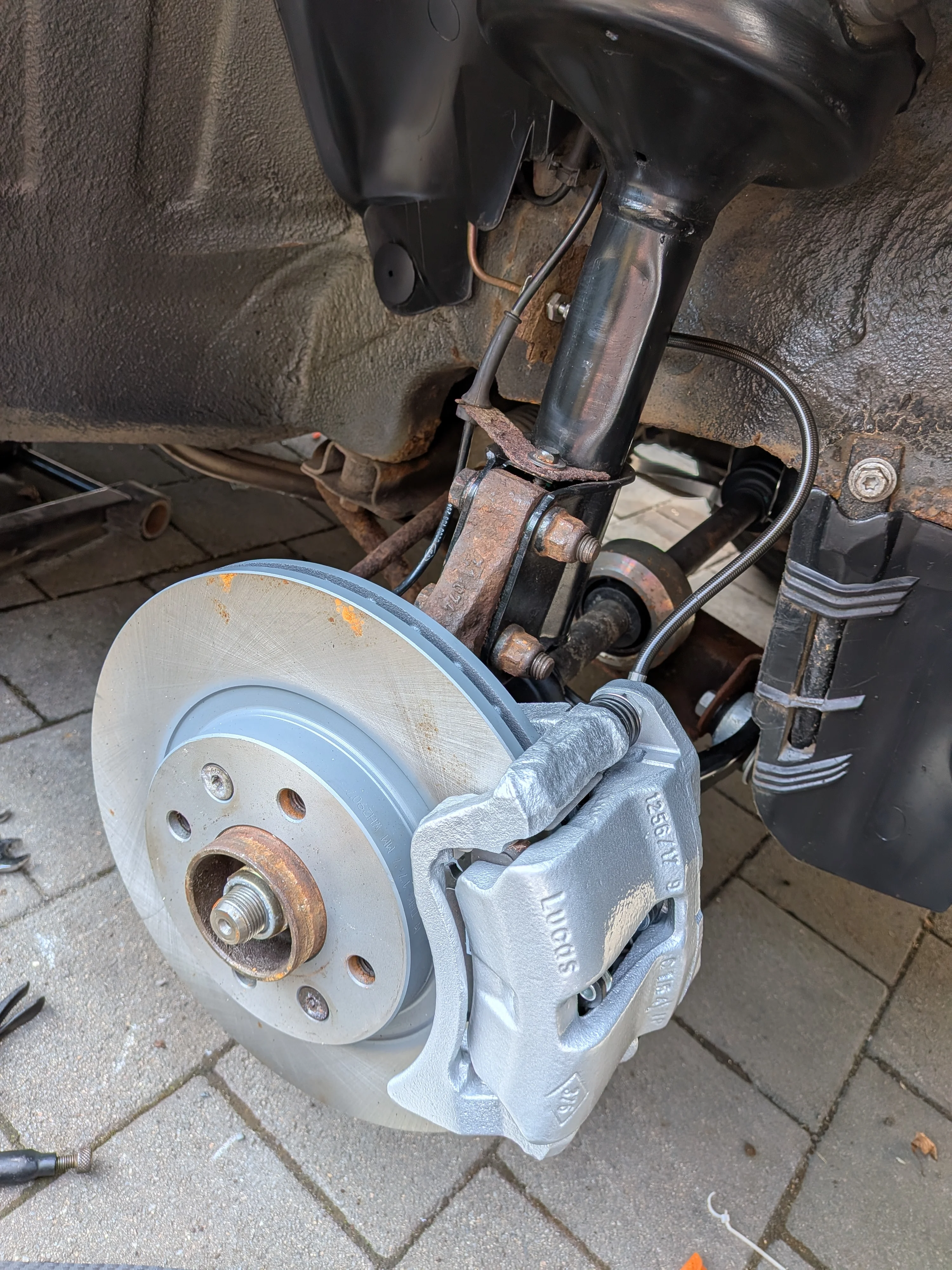

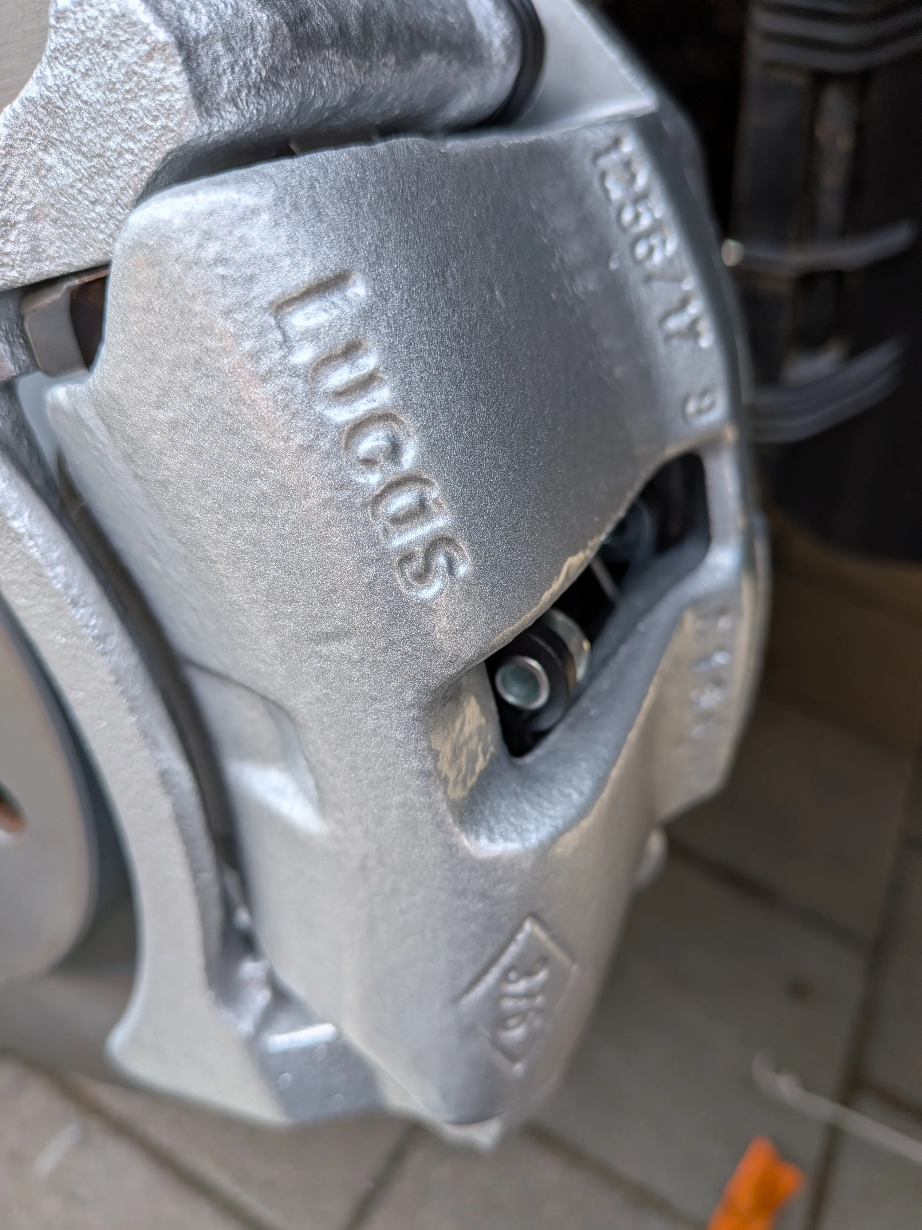

Both calliper piston seals were ripped and the front left was starting to seize, sent them away to SSL Autoparts on ebay for a refurb as I've had really good experience with them in the past

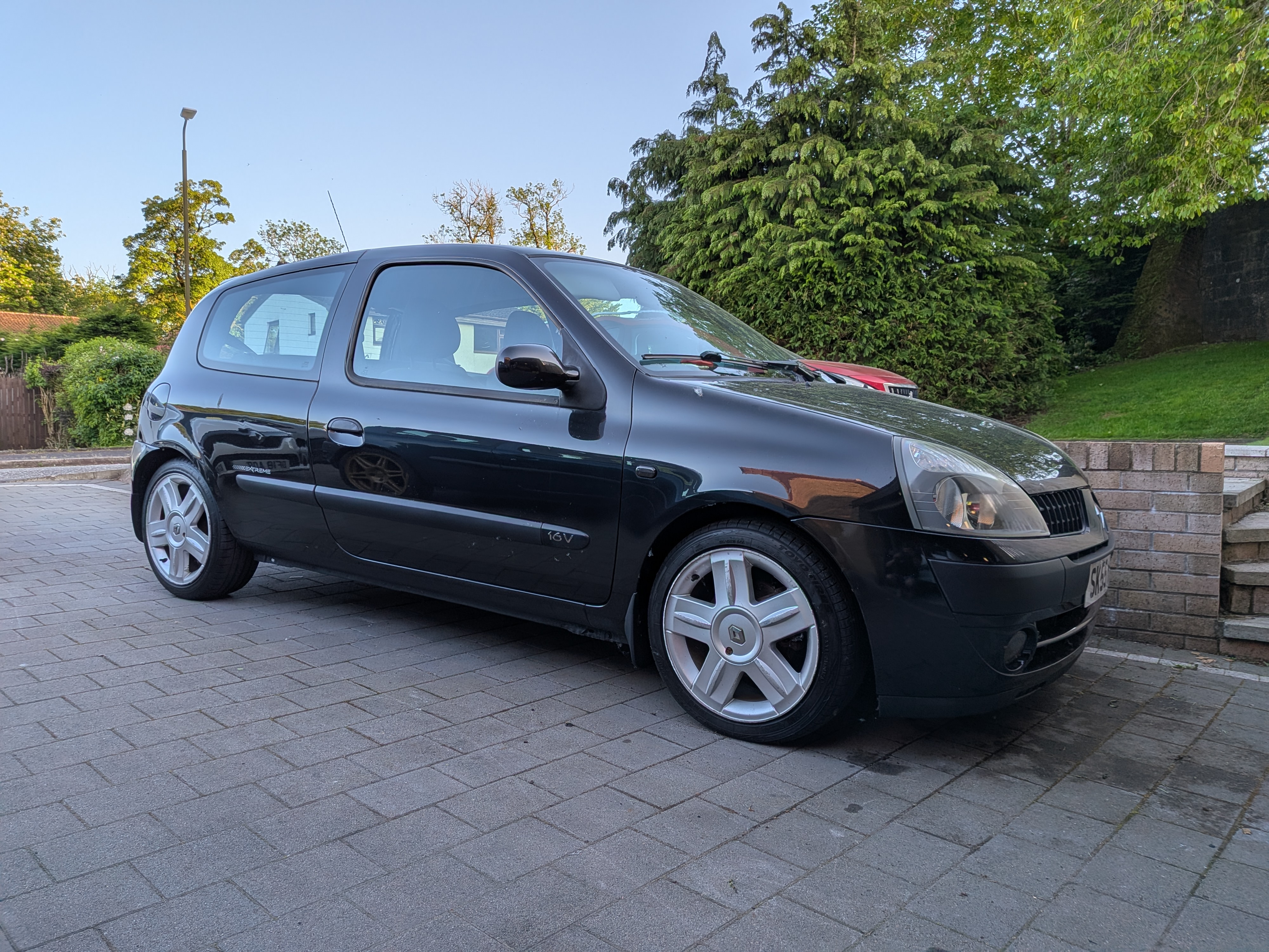

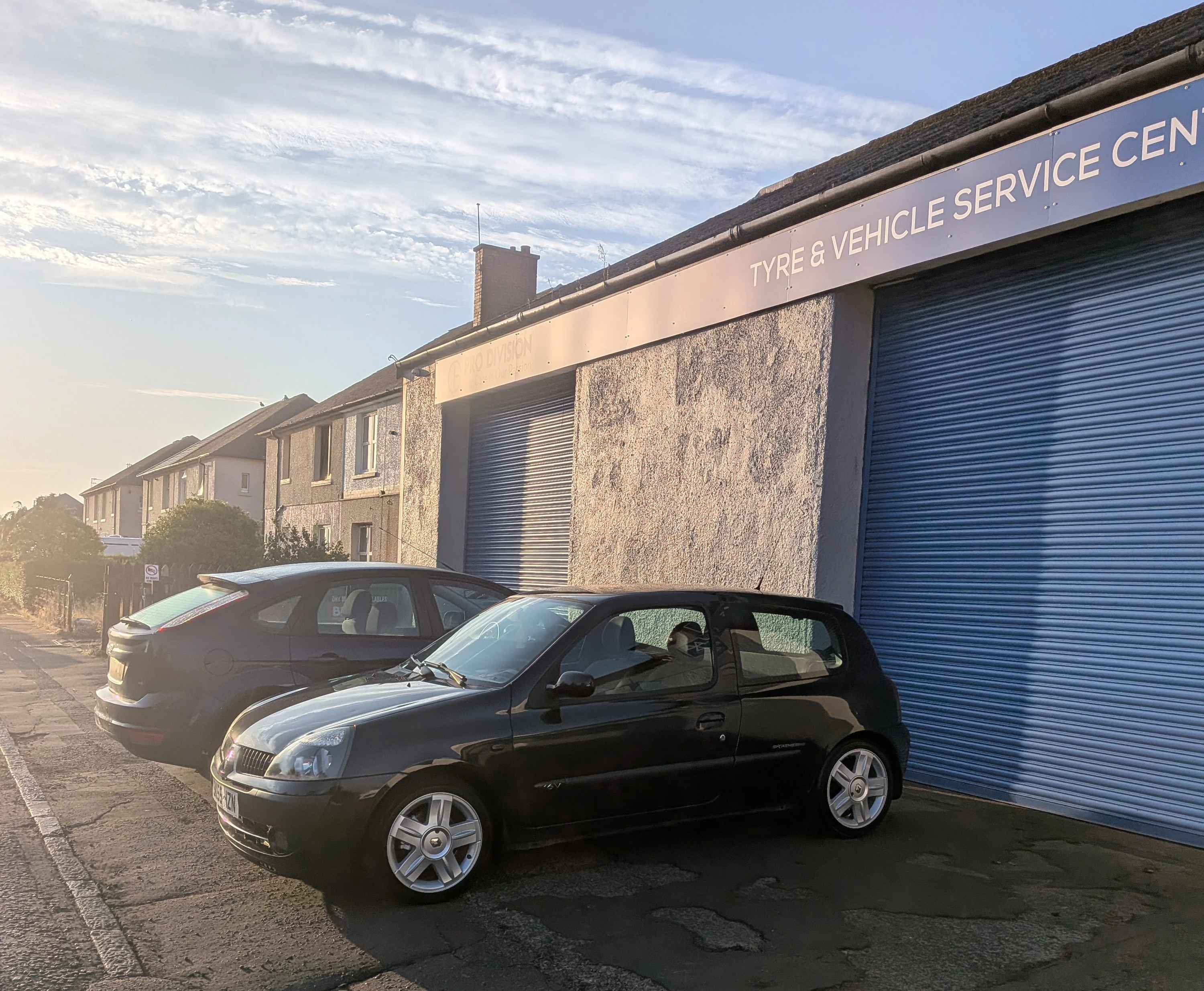

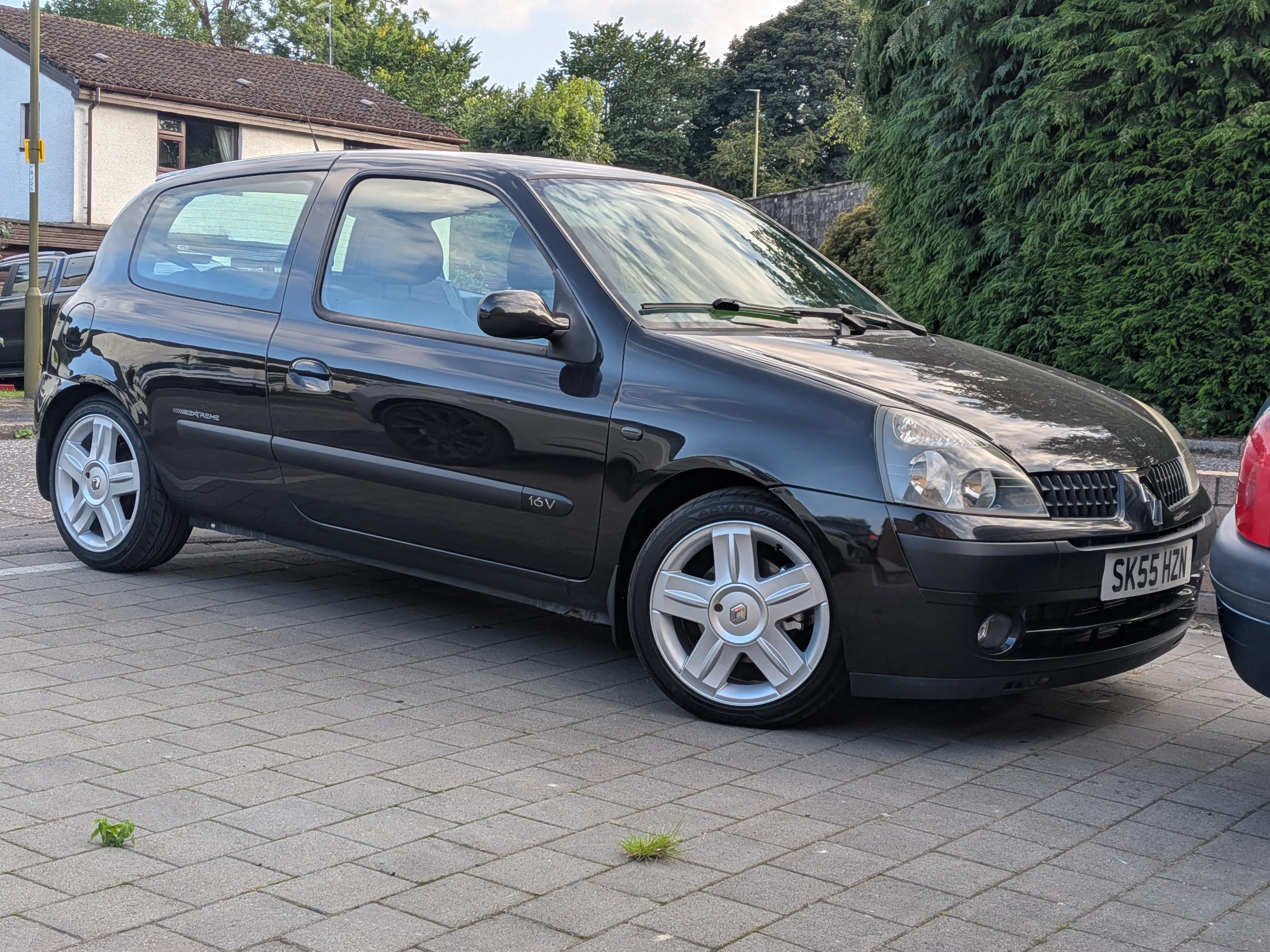

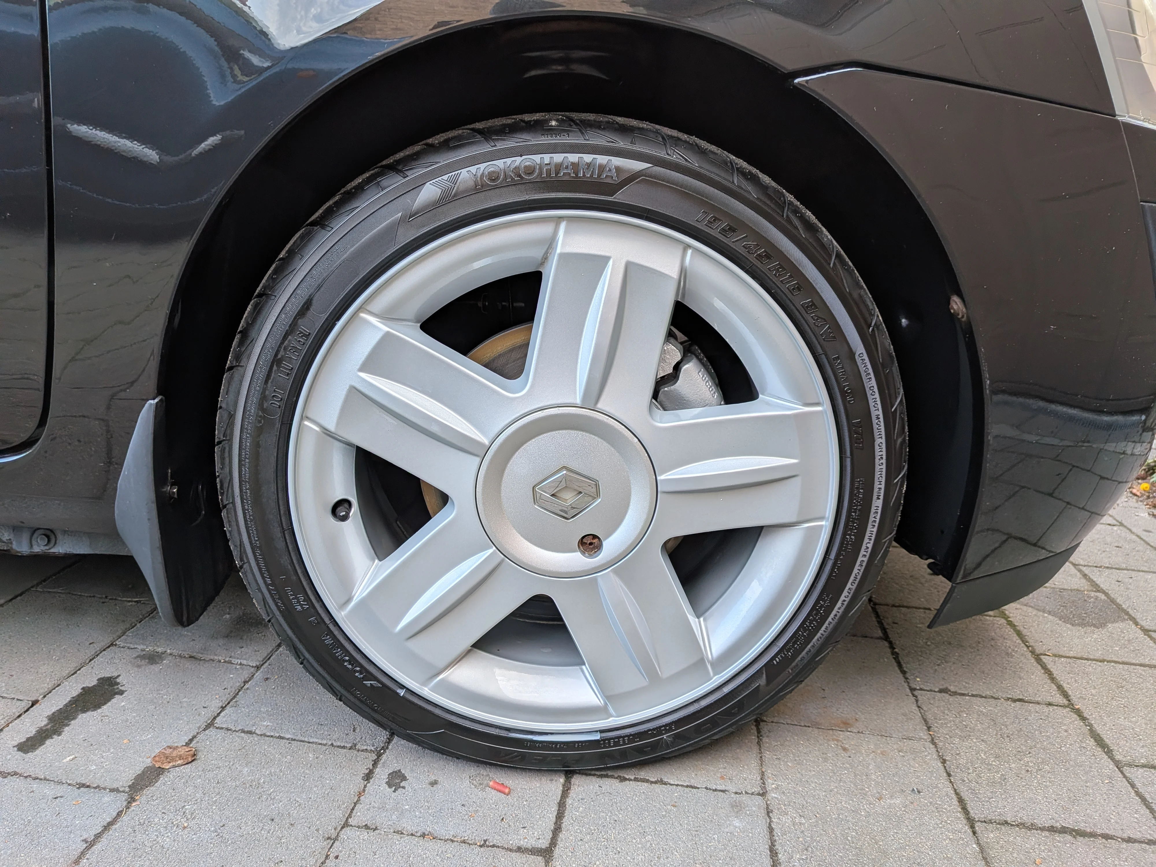

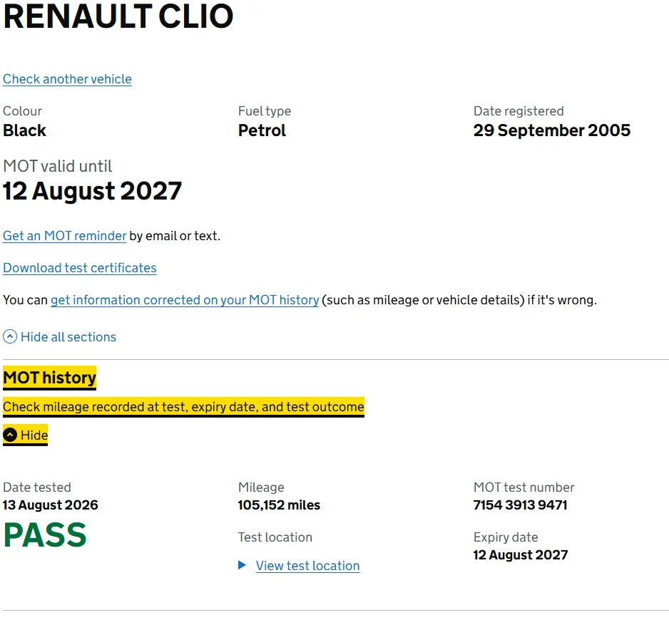

Dropped it off and left it for its MOT and AC recharge the other day, was feeling fairly confident after all the work its had!
Clean pass! and ICE cold AC!
Planning to get some miles on it now!
