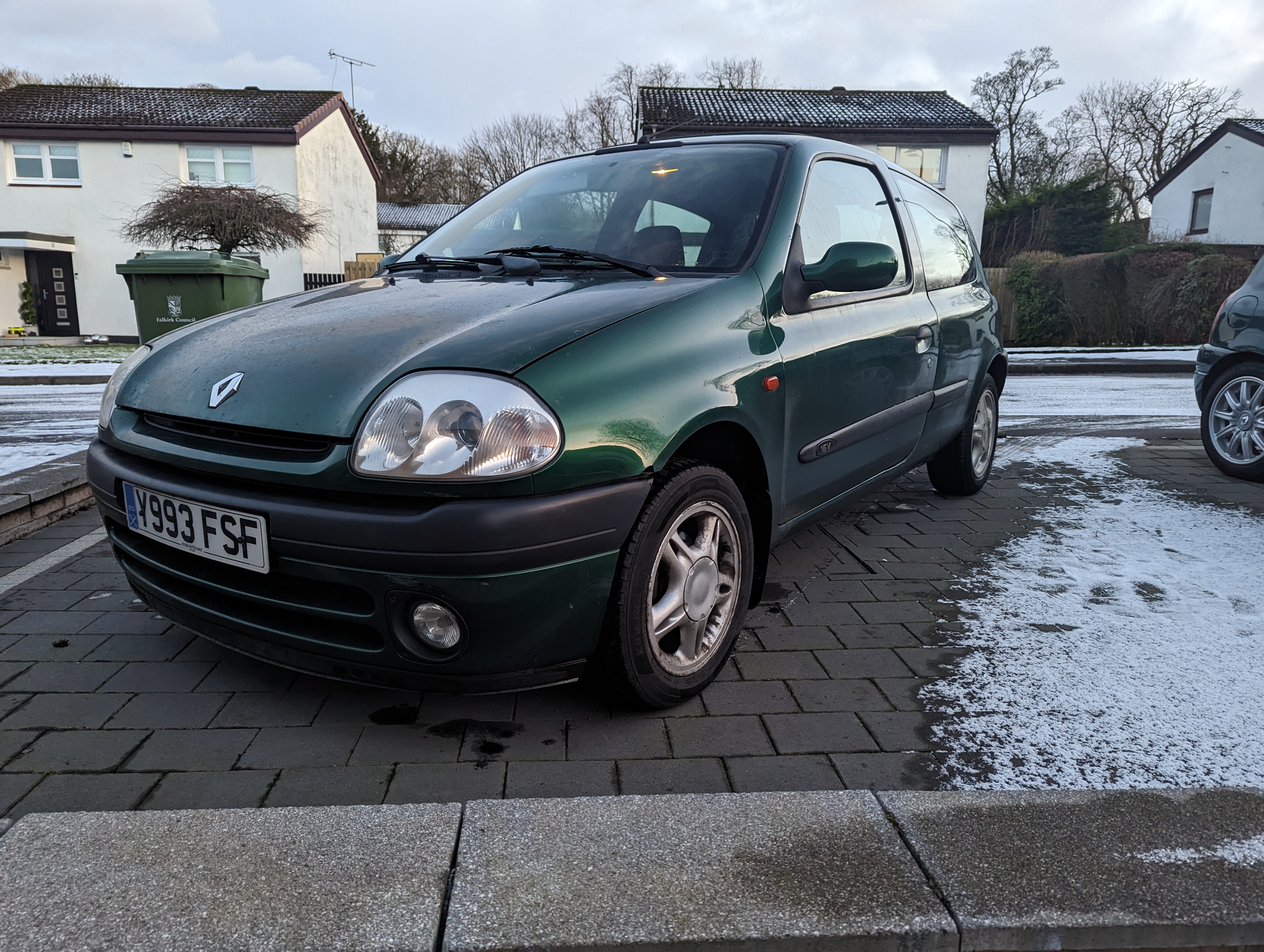

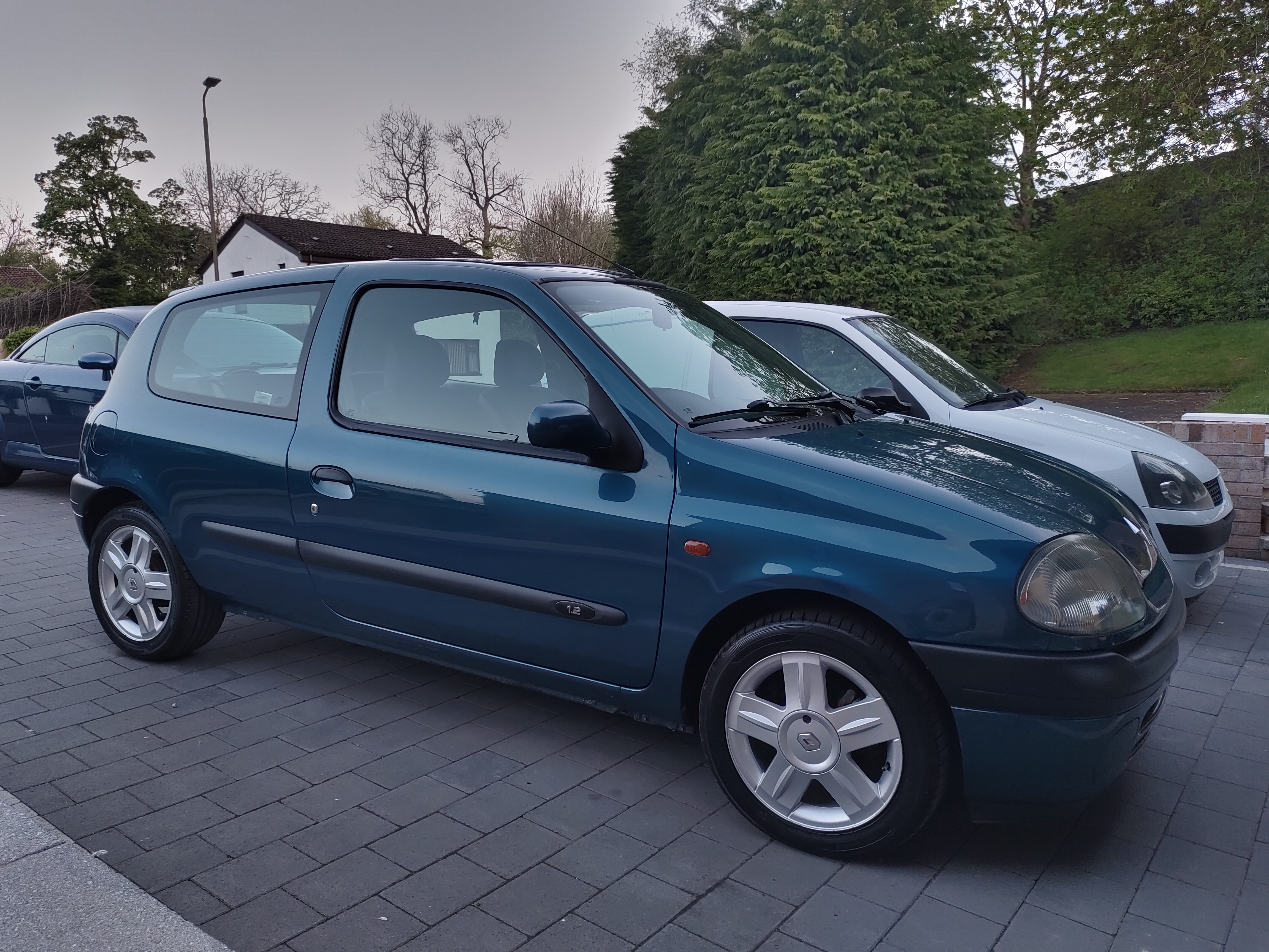

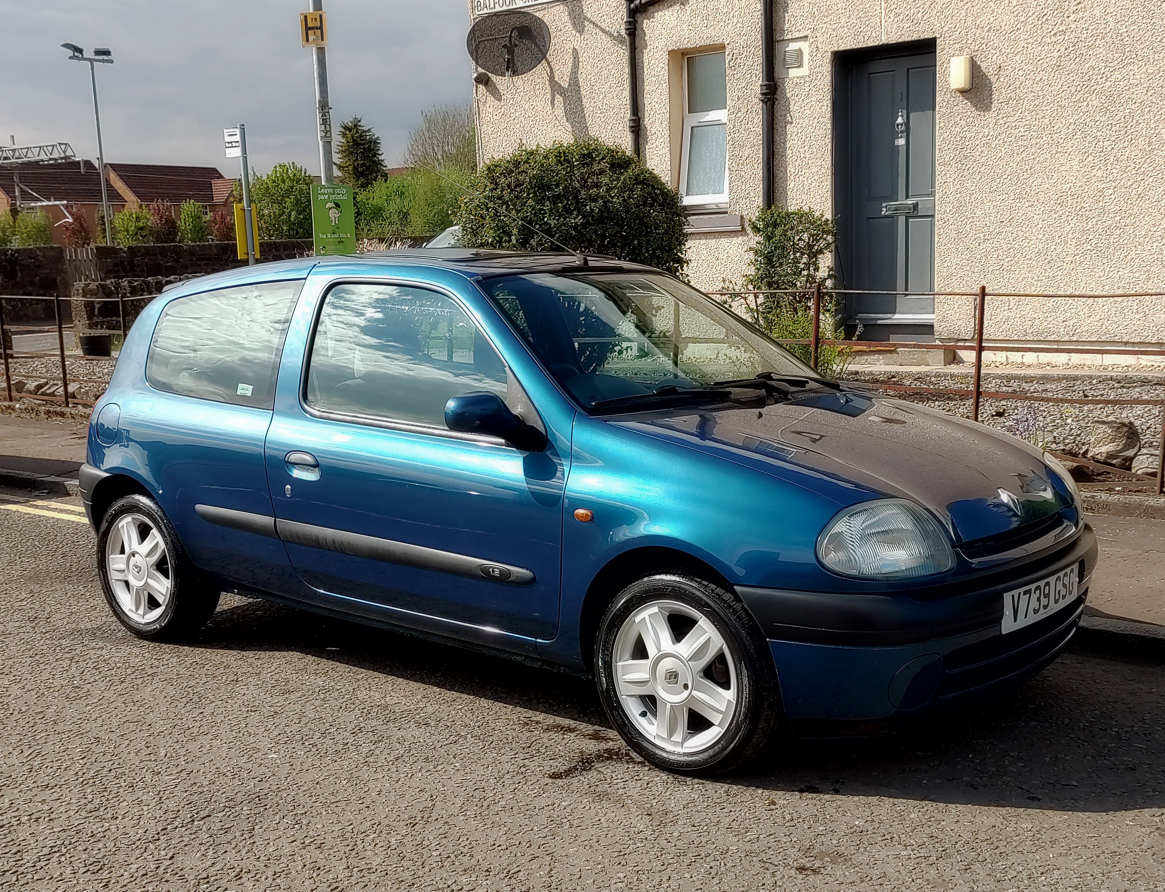

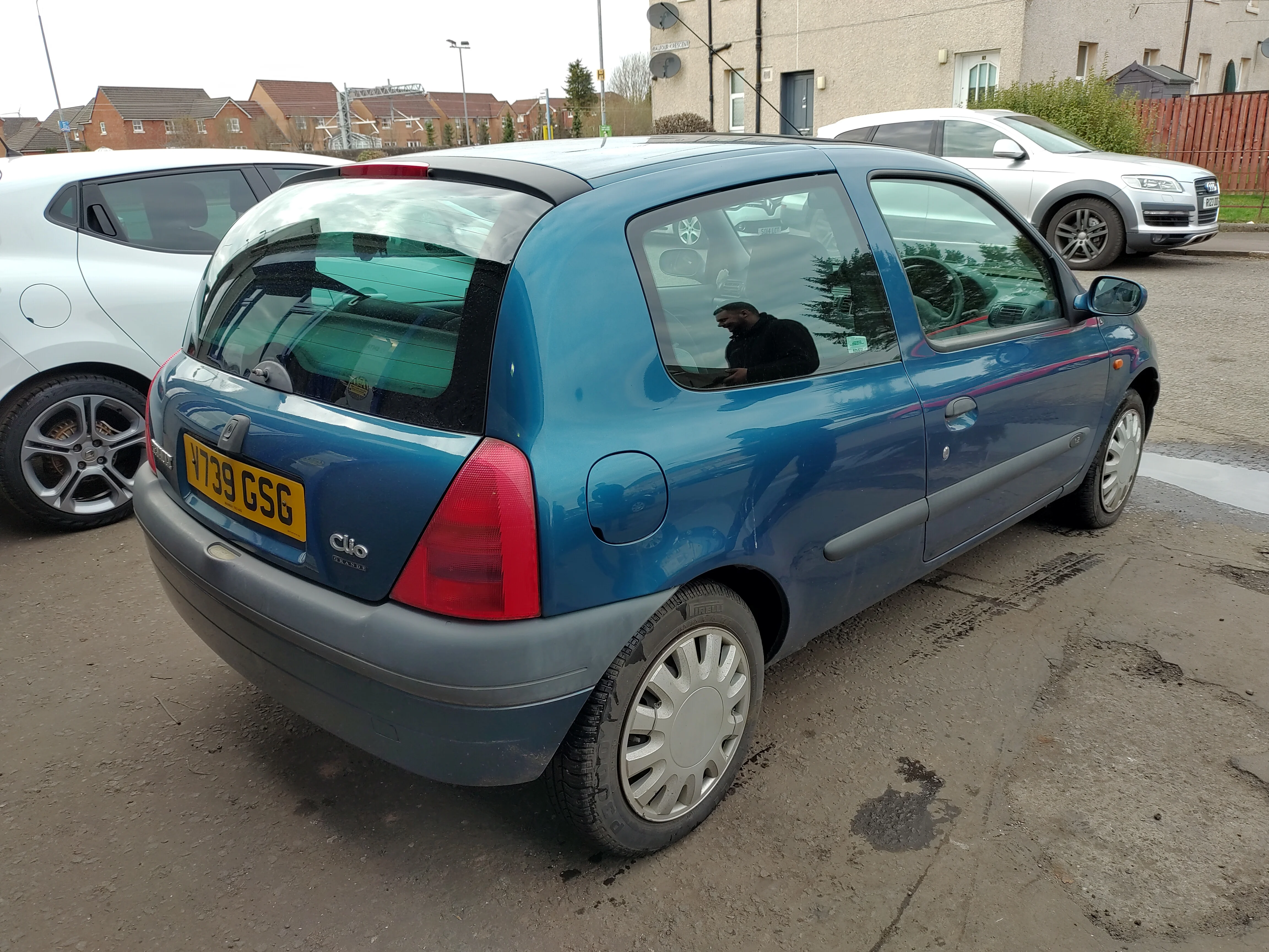

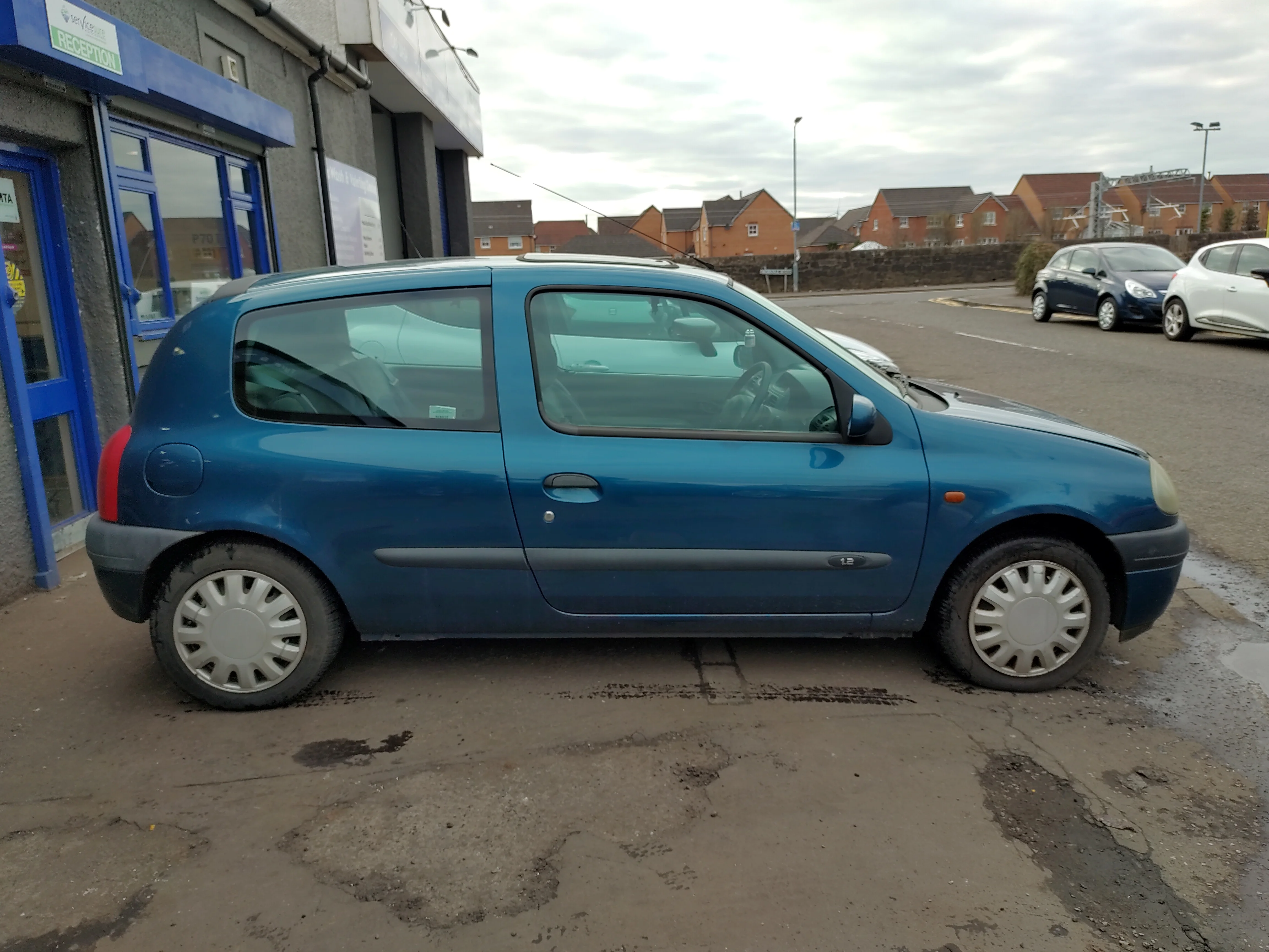

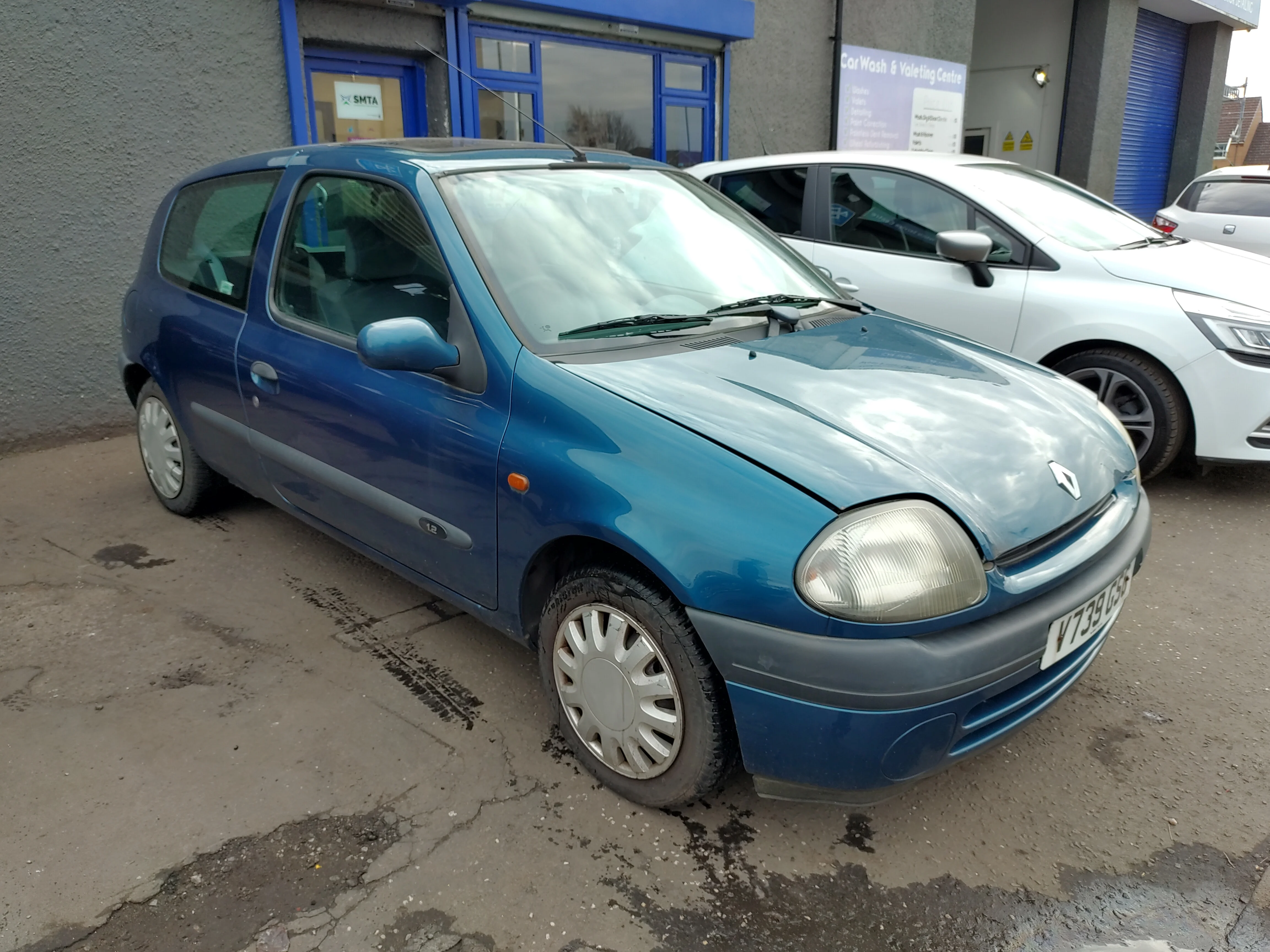

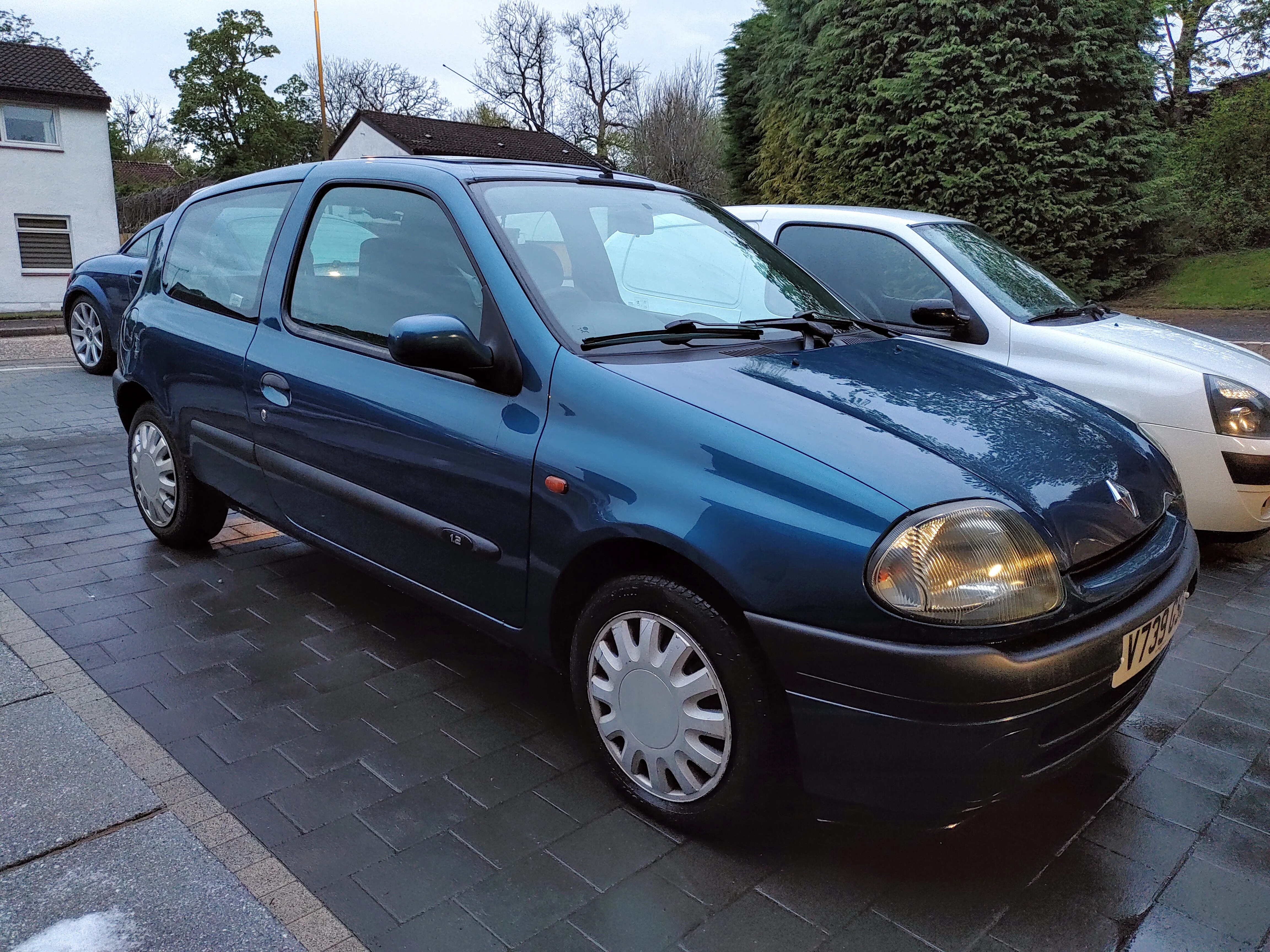

Guy was buying a Hyundai i30 at work that we had up for sale. He wondered if we would give him anything for his Clio to save him the hassle of scrapping it.... we gave him £350 off the Hyundai for it, after a brief look round it I gave my boss £300 and it was mine! Someone came in looking for a cheap runabout a few hours later and offered me £500 for it but where's the fun in that?...
V reg - 1999
2 previous owners
51,500 Miles
FULL Service history

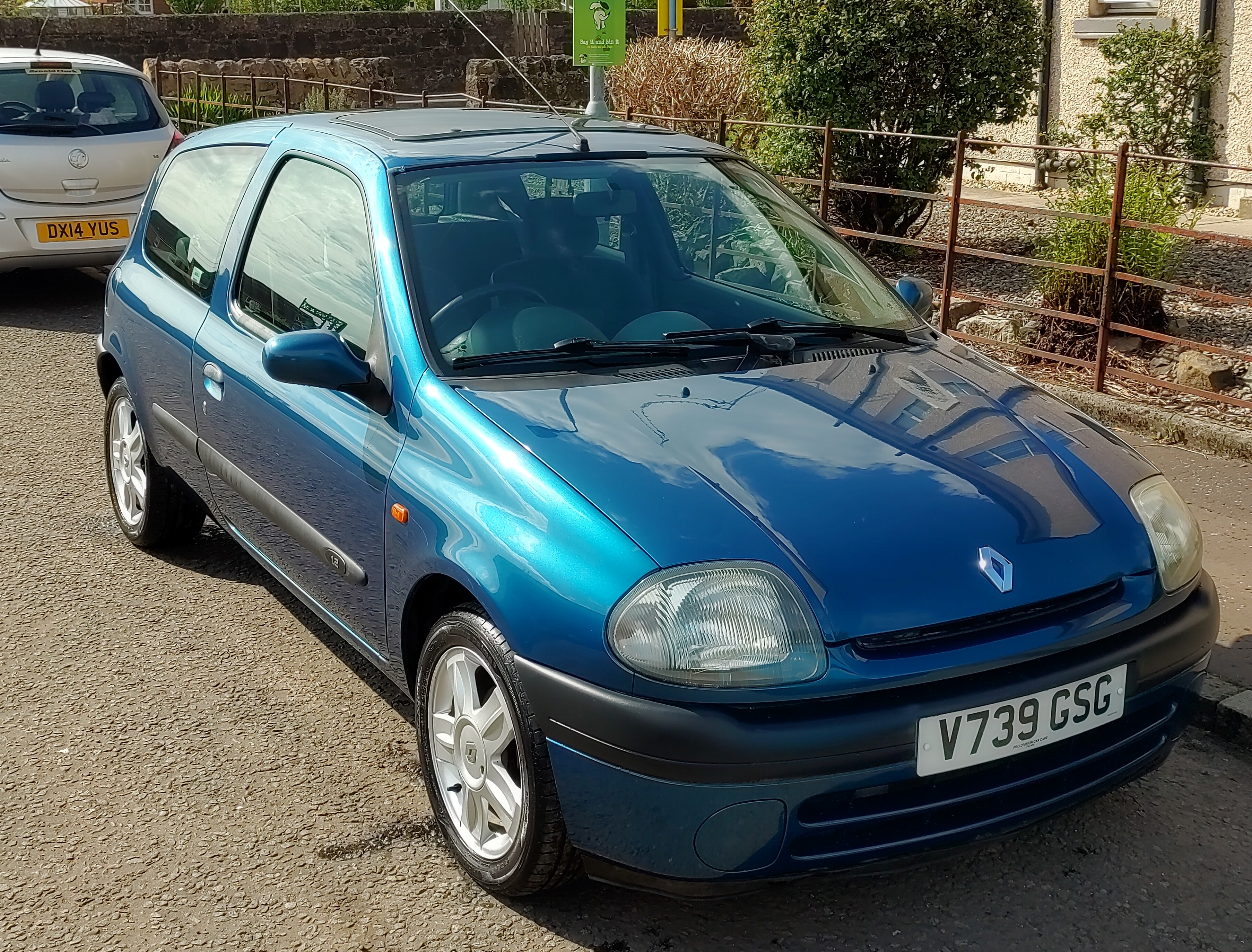

Gave it a quick going over at work on the ramp and its seriously seriously mint underneath, all it required was a high level brake light (faulty - more on that later!), Sump (badly corroded), inner ARB Bushes (perished), a set of wiper blades (looked original!) and a rear exhaust mount (collapsed) So last Saturday I done all of that and a full service since I was doing the sump anyway. - Put it though its MOT and it sailed with no advisories.
Brought it home to join the fleet!

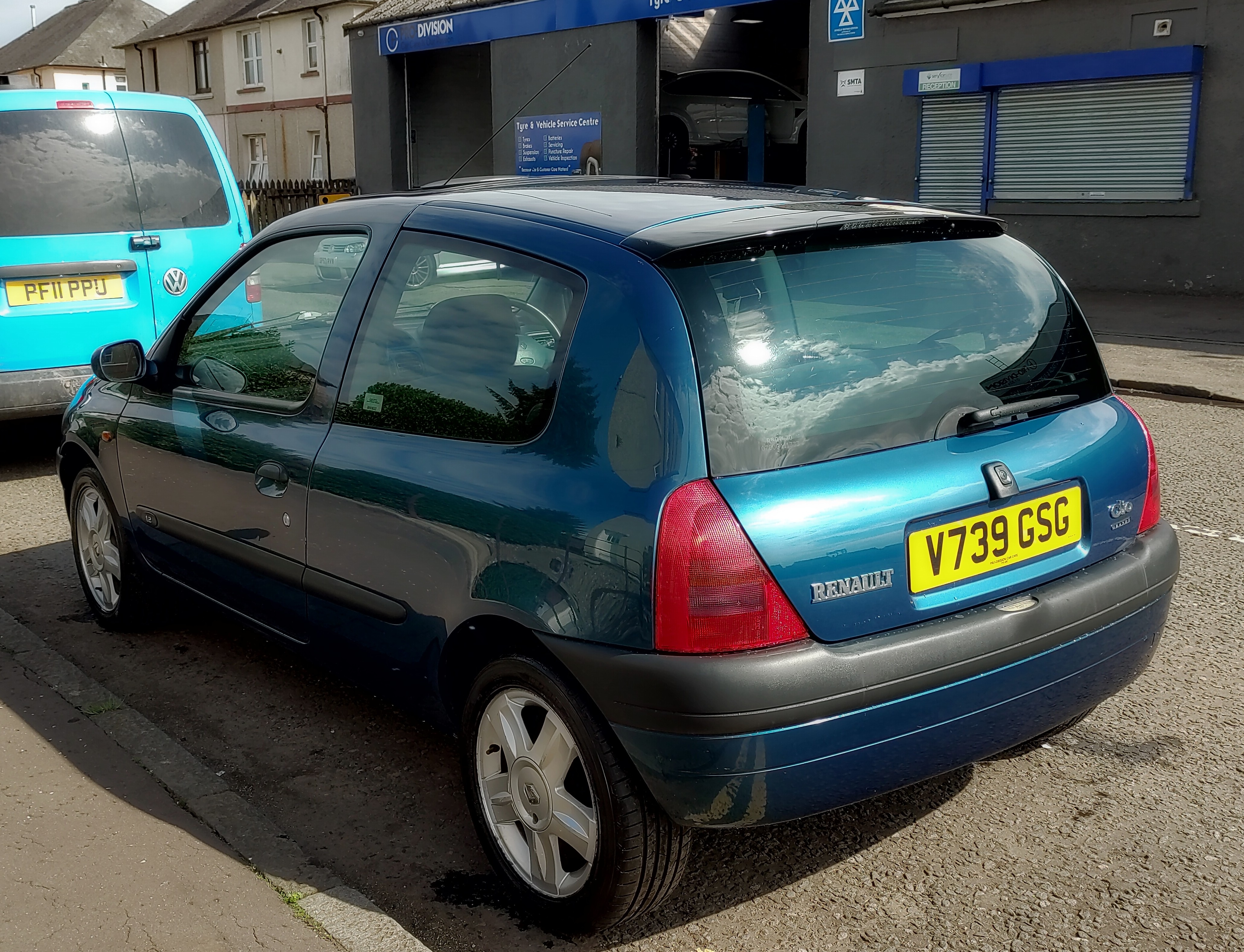

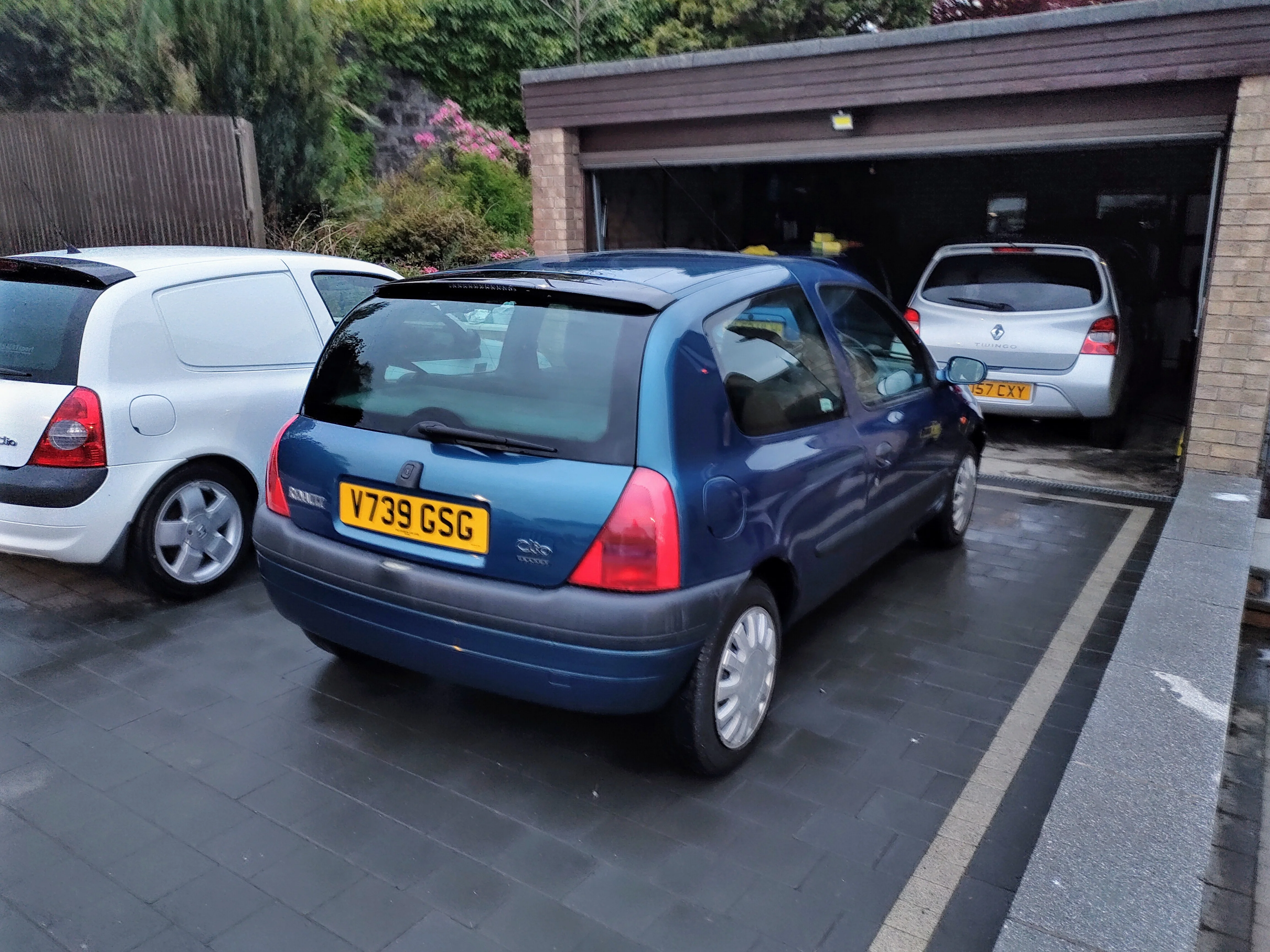

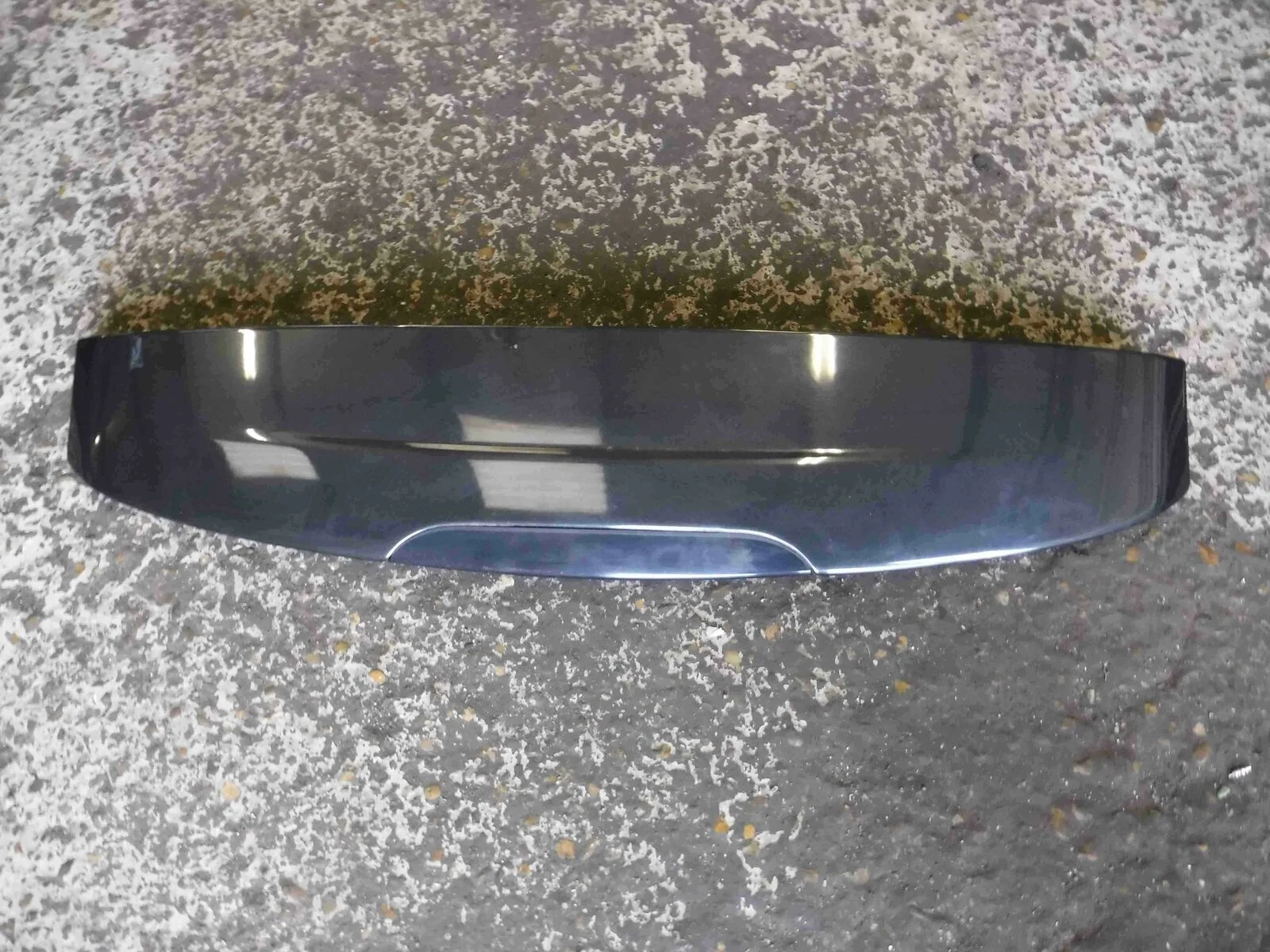

It needed a high level brake light so a nice cheap pearl black PH3 spoiler was sourced:

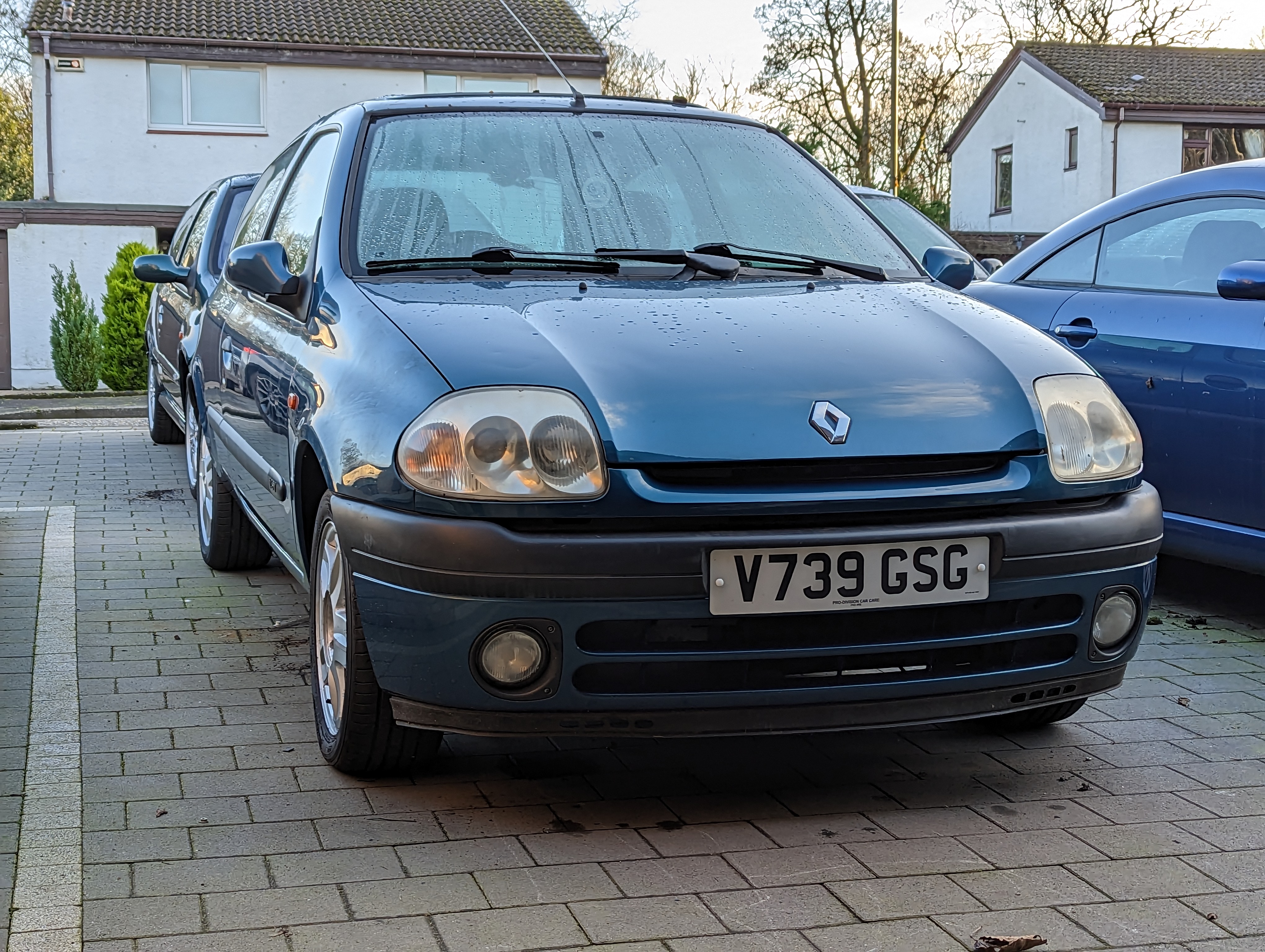

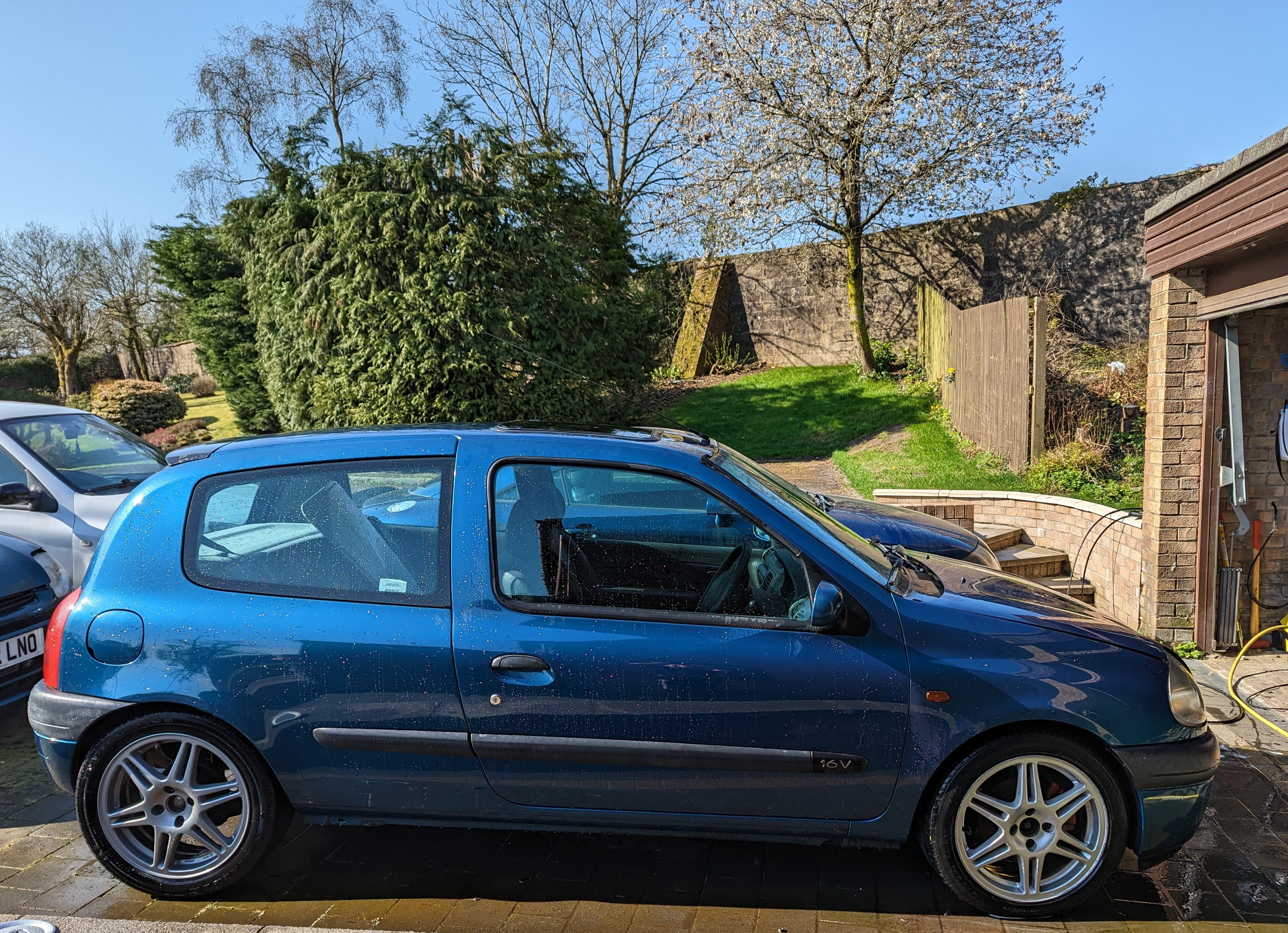

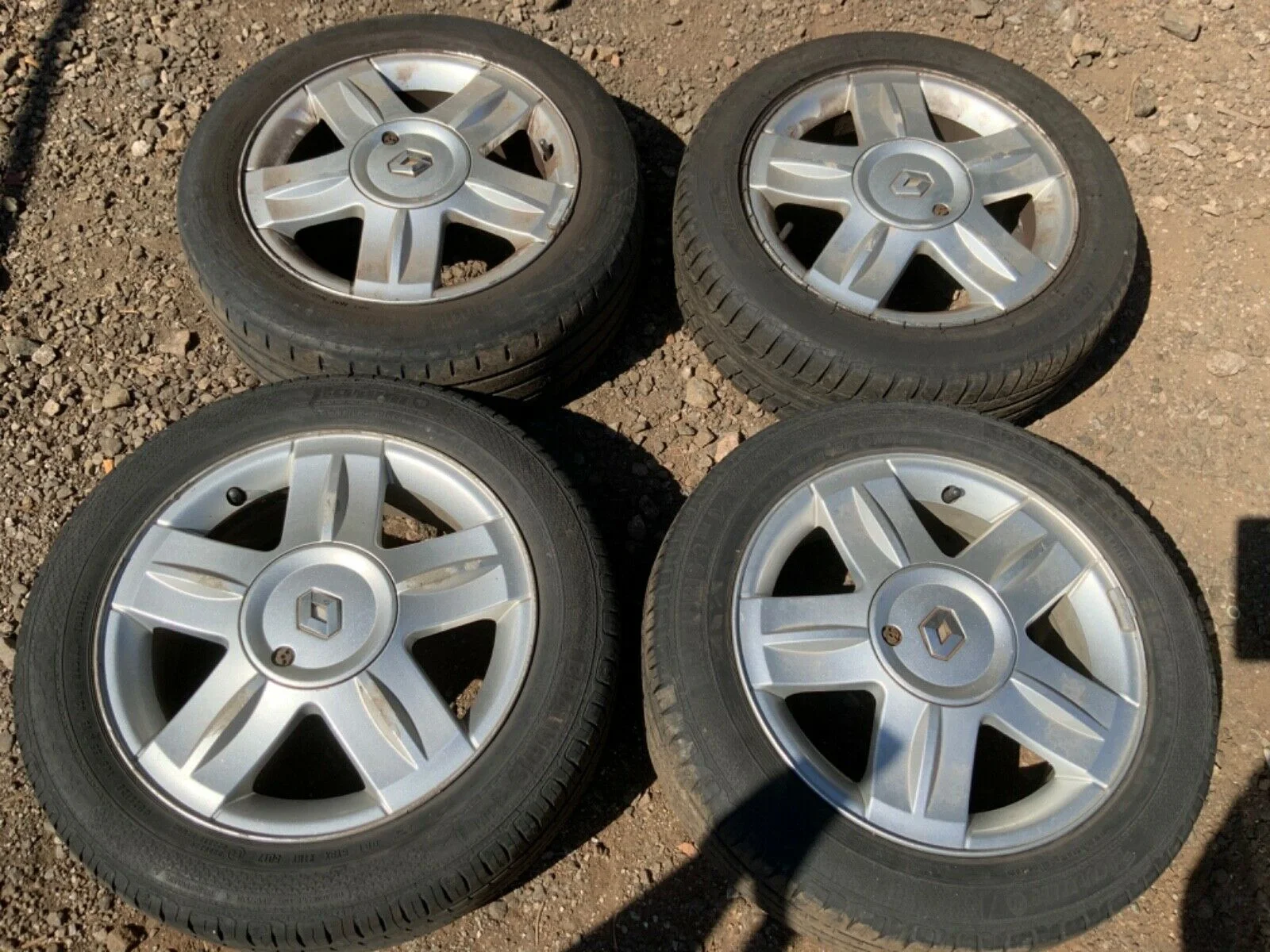

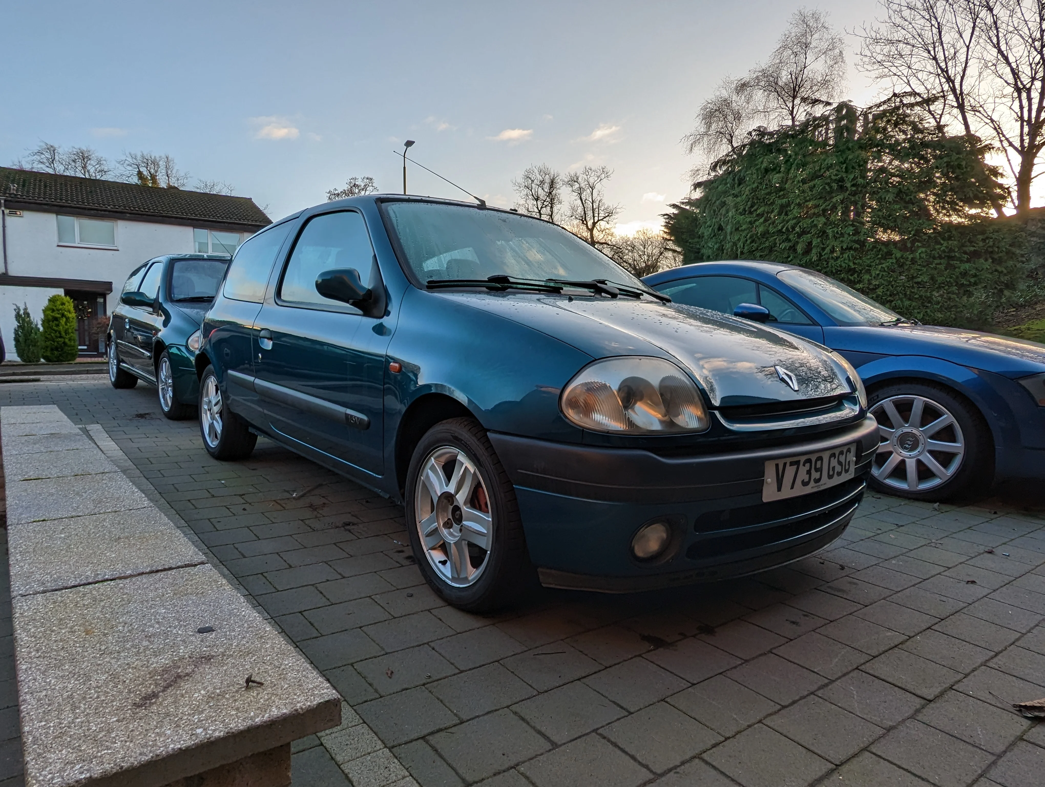

I managed to source a cheap set of ph3/Campus 15" alloys in decent condition on eBay. They were listed as all tyres needing replaced but I assume that was just the sellers get out of jail card as actually all 4 were ok, in fact 2x looked fairly new! but by the time they arrived I had already ordered a set of Hankook 195/50/15. No biggie as I knew they would look better on a lower profile tyre anyway and it meant having 4x matching new tyres.

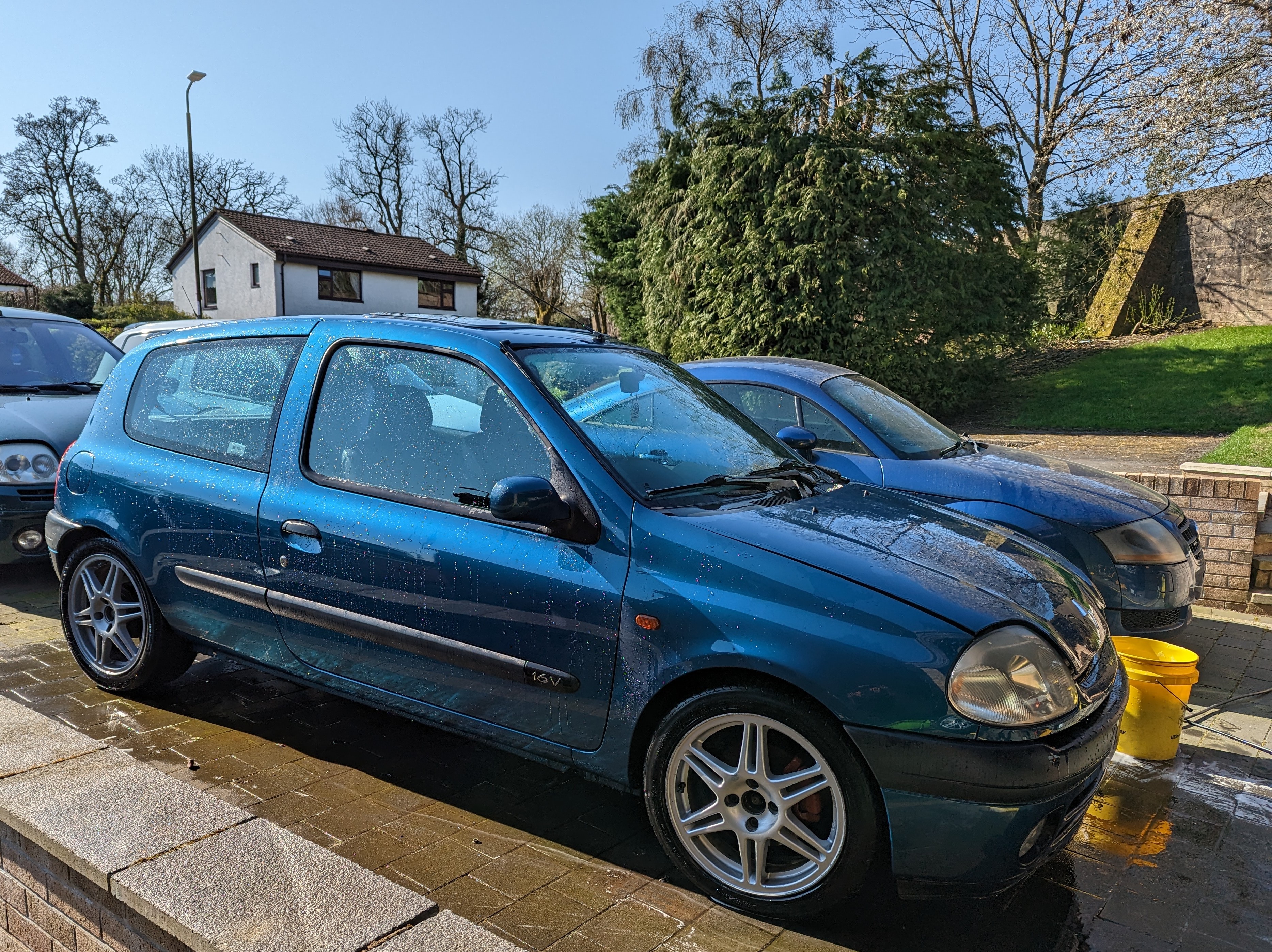

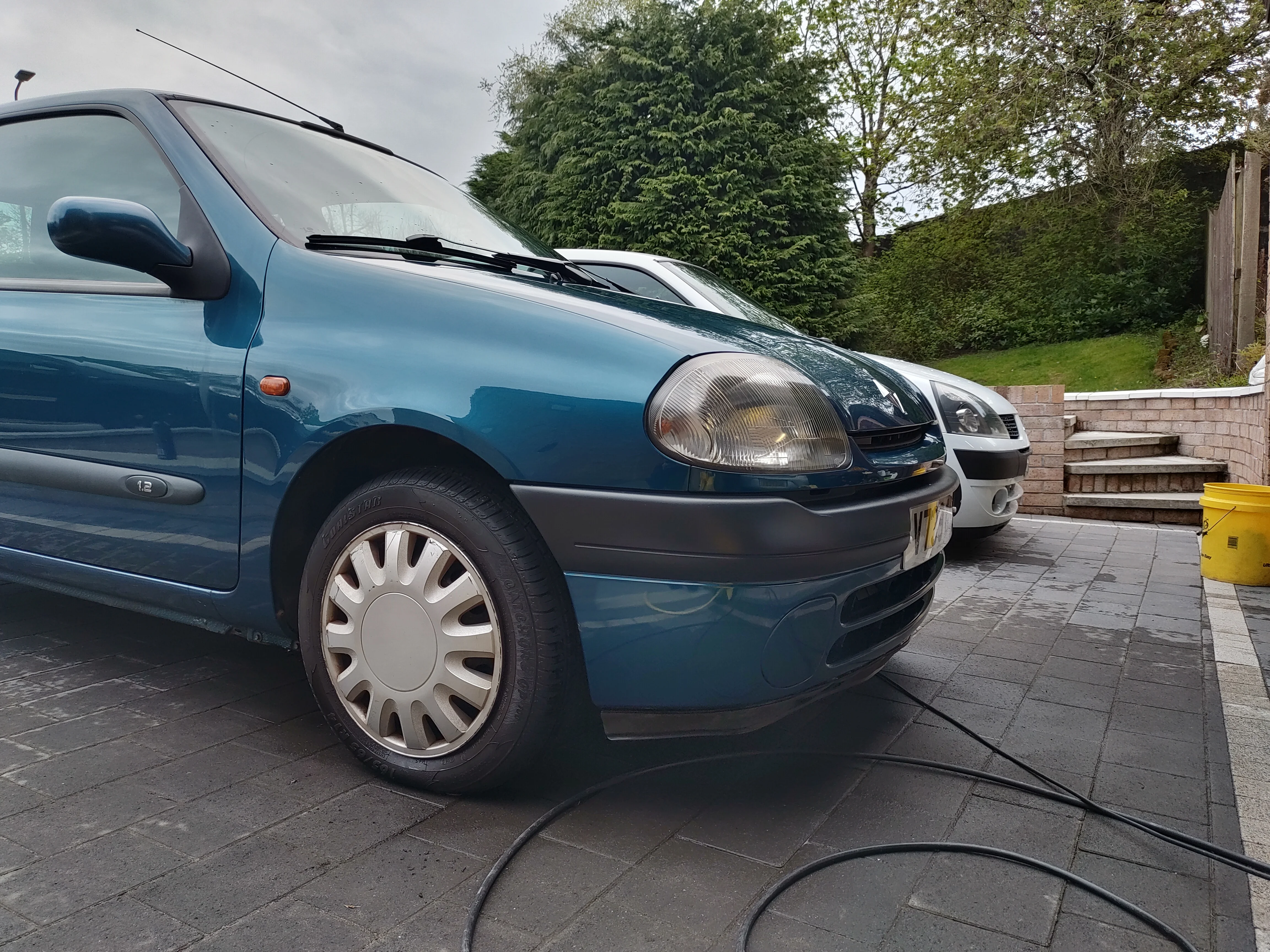

I spent friday night on it since it looks like it hadn't been washed in years. It got the works!
  • a scrub including blasting out any gaps, seals, seams, arches etc
  • Tar removal using AutoSmart tar & glue removal
  • Clay Bar
  • Fallout removal using AutoSmart Red7
  • a blast over with the machine polisher with meguiars ultimate compound
  • a going over with AutoGlym trim restorer
  • Fresh set of number plates
Saturday was time to fit the wheels. They got the tyres removed, a decent scrub then the new tyres fitted with some fresh valves.
It pissed with rain soon after doing the trim dressing on Friday night so it needs re done, but other than that I'm mega pleased with the results!

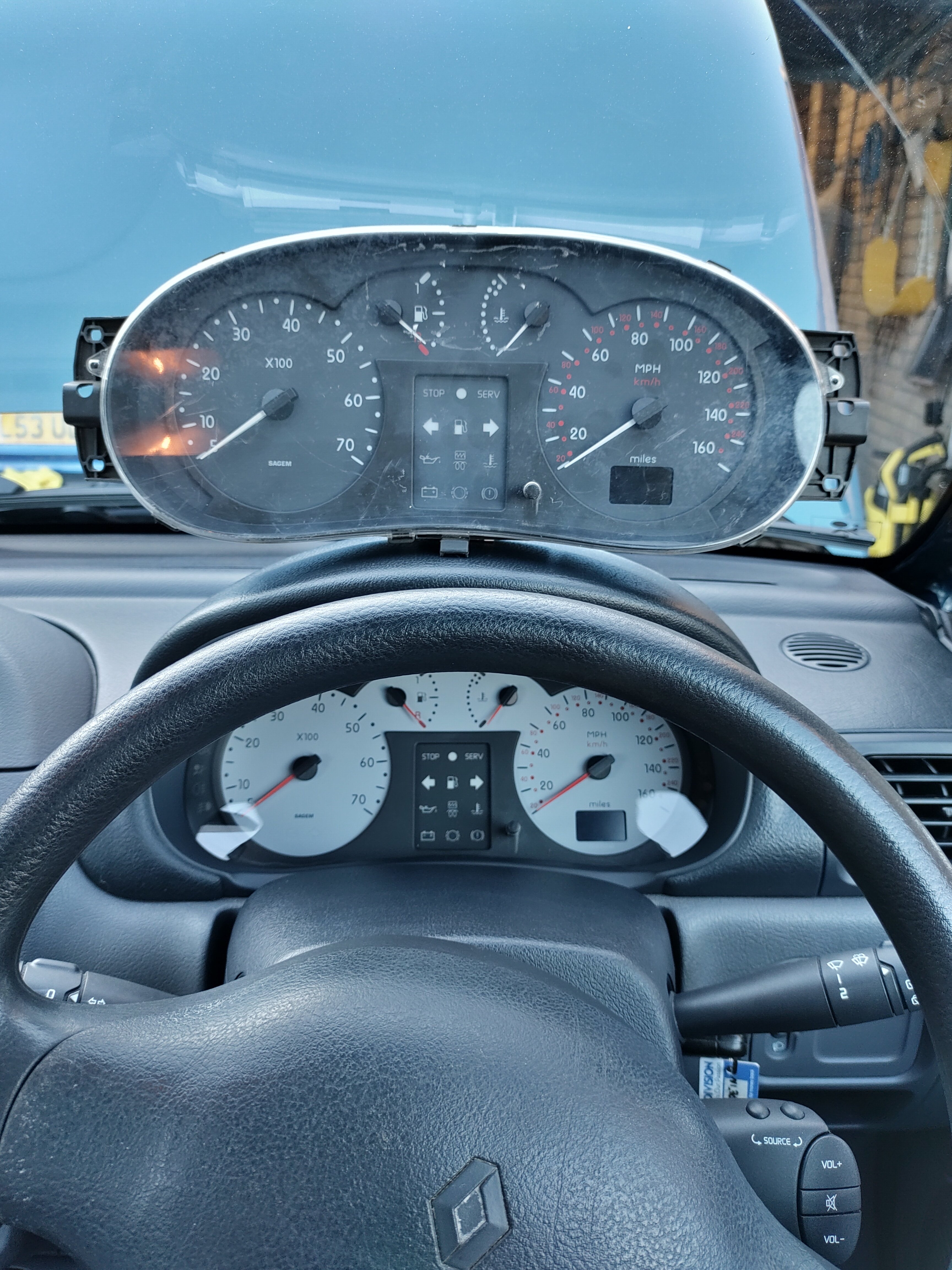

I've still to do the interior but started with a swap over to White dials from some other ph1 non RS. I stripped them all down, swapped the PCB from my dials into the white ones so the mileage stays correct

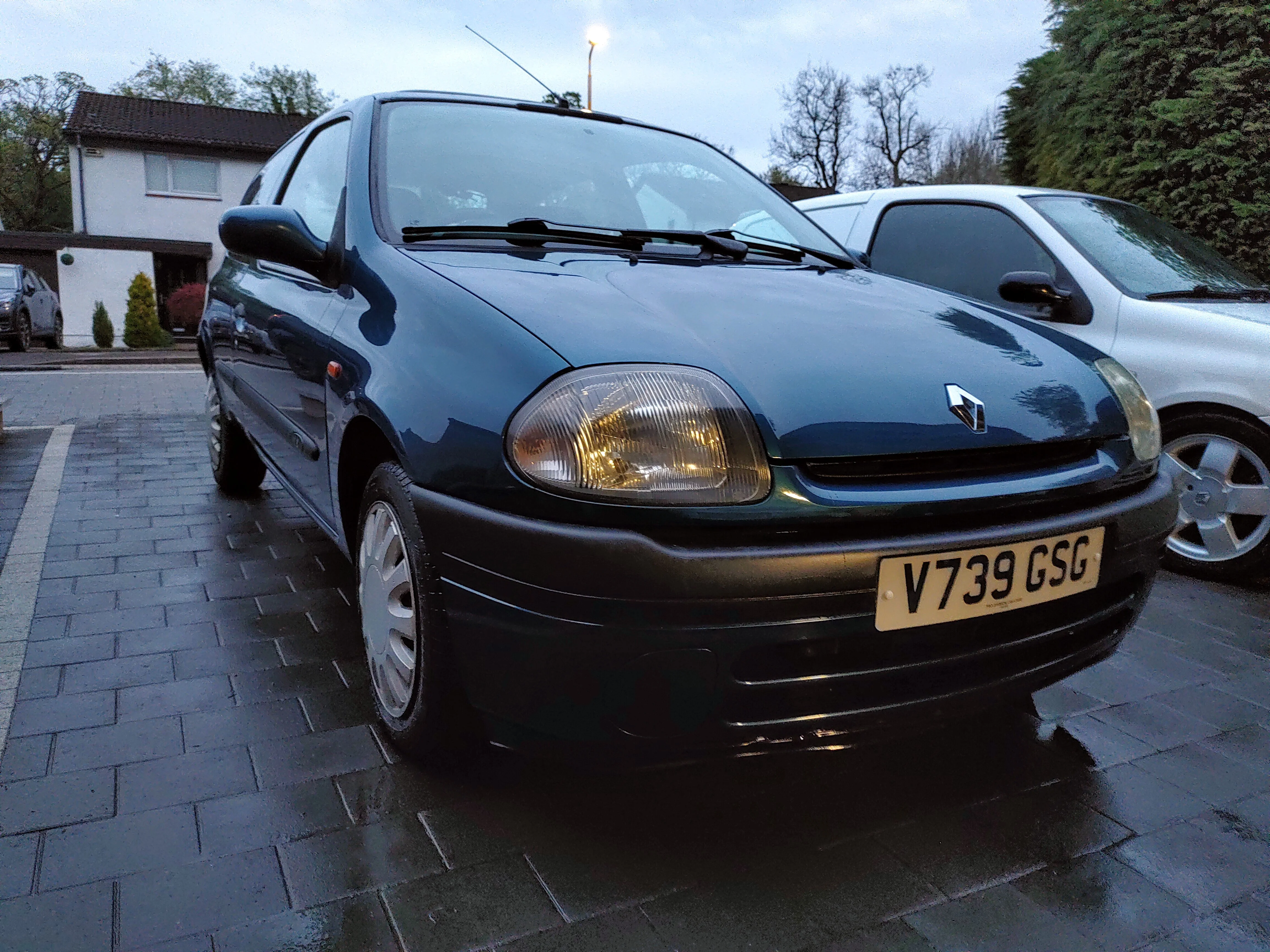

And how she sits tonight after a busy weekend, now with the trim restorer re applied.
Next weekend, onto the interior...

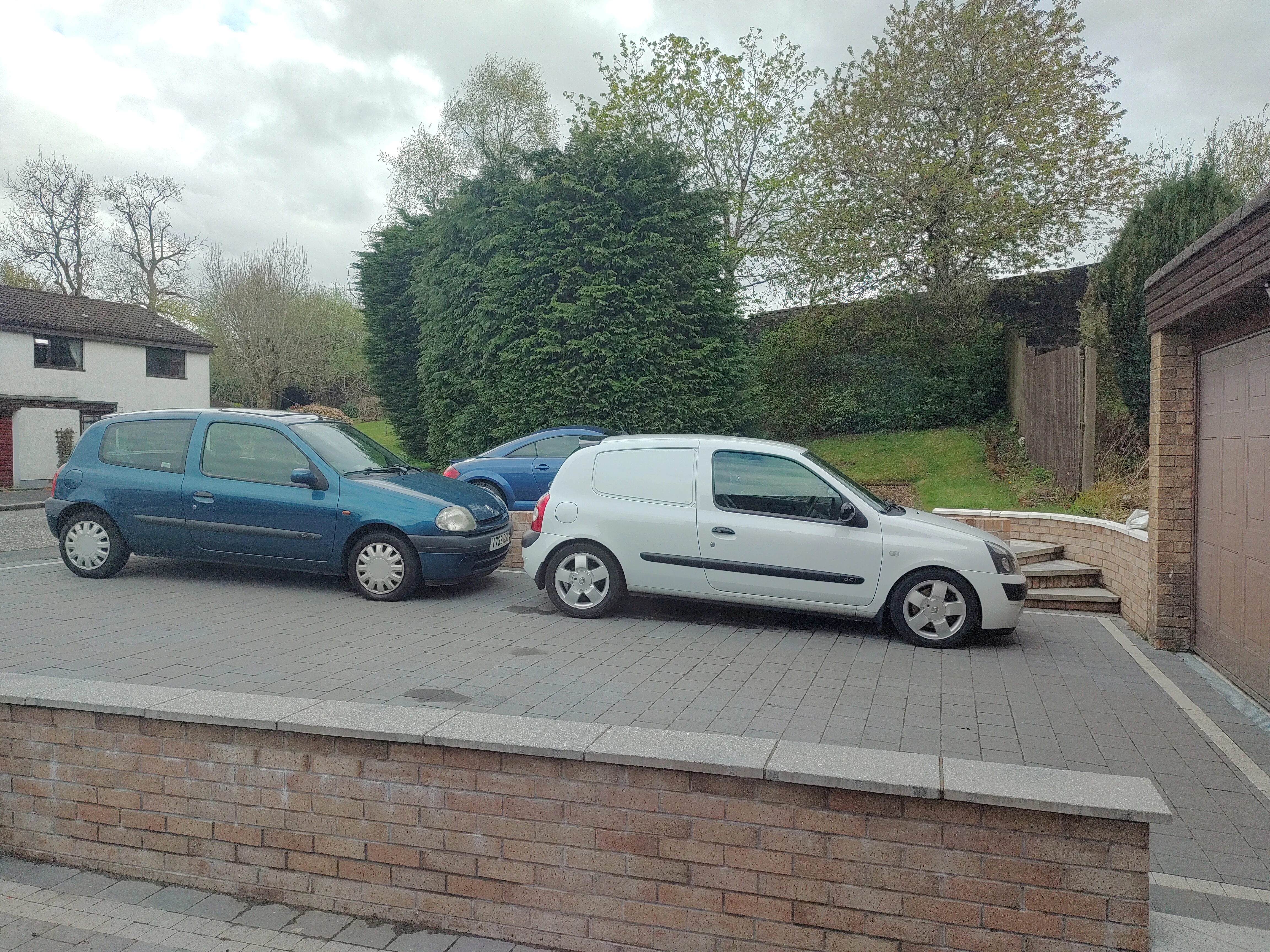

I've just got rid of everything bar the van, so a big empty drive now.
Miss the Ph1 but want to spend more time and money on the van 😁
Reminds me of mine... Dual optics overhaul the front so nicely. Might I suggest a Fabia splitter, clear side repeaters & ph2 rear lights - that'll be it perfect (y)
Your driveway looks like it could be a renualt dealership forecourt :LOL:

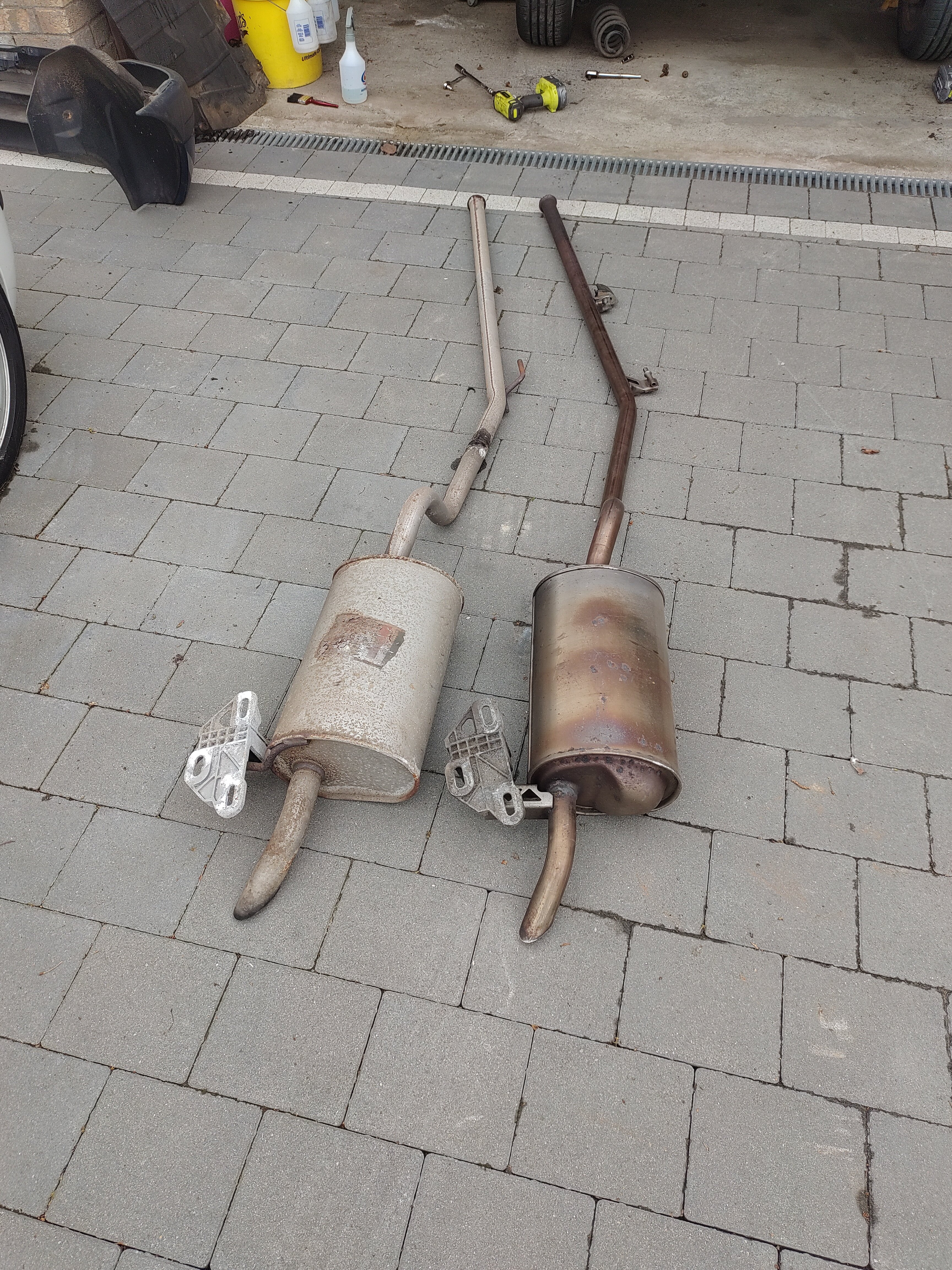

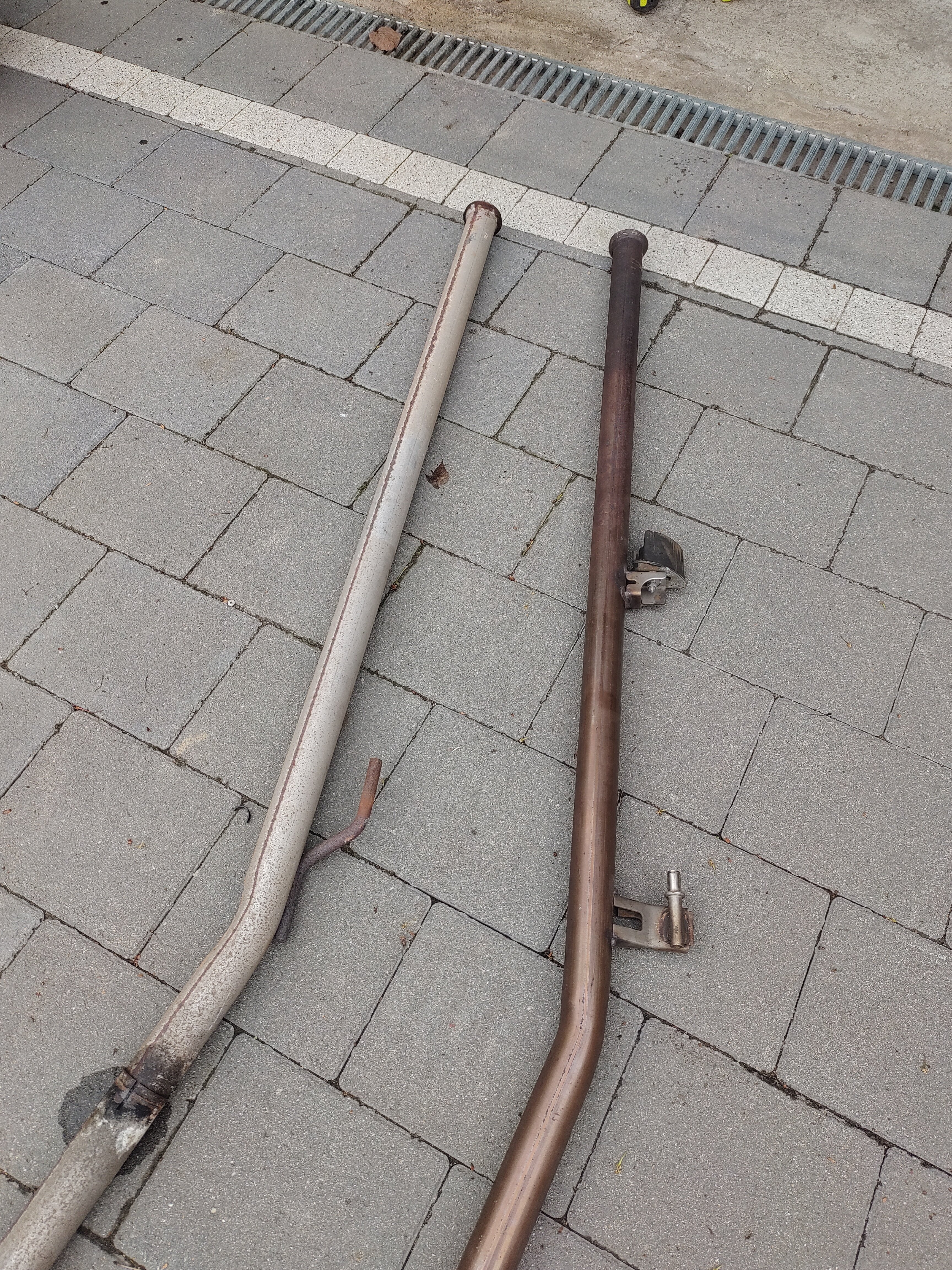

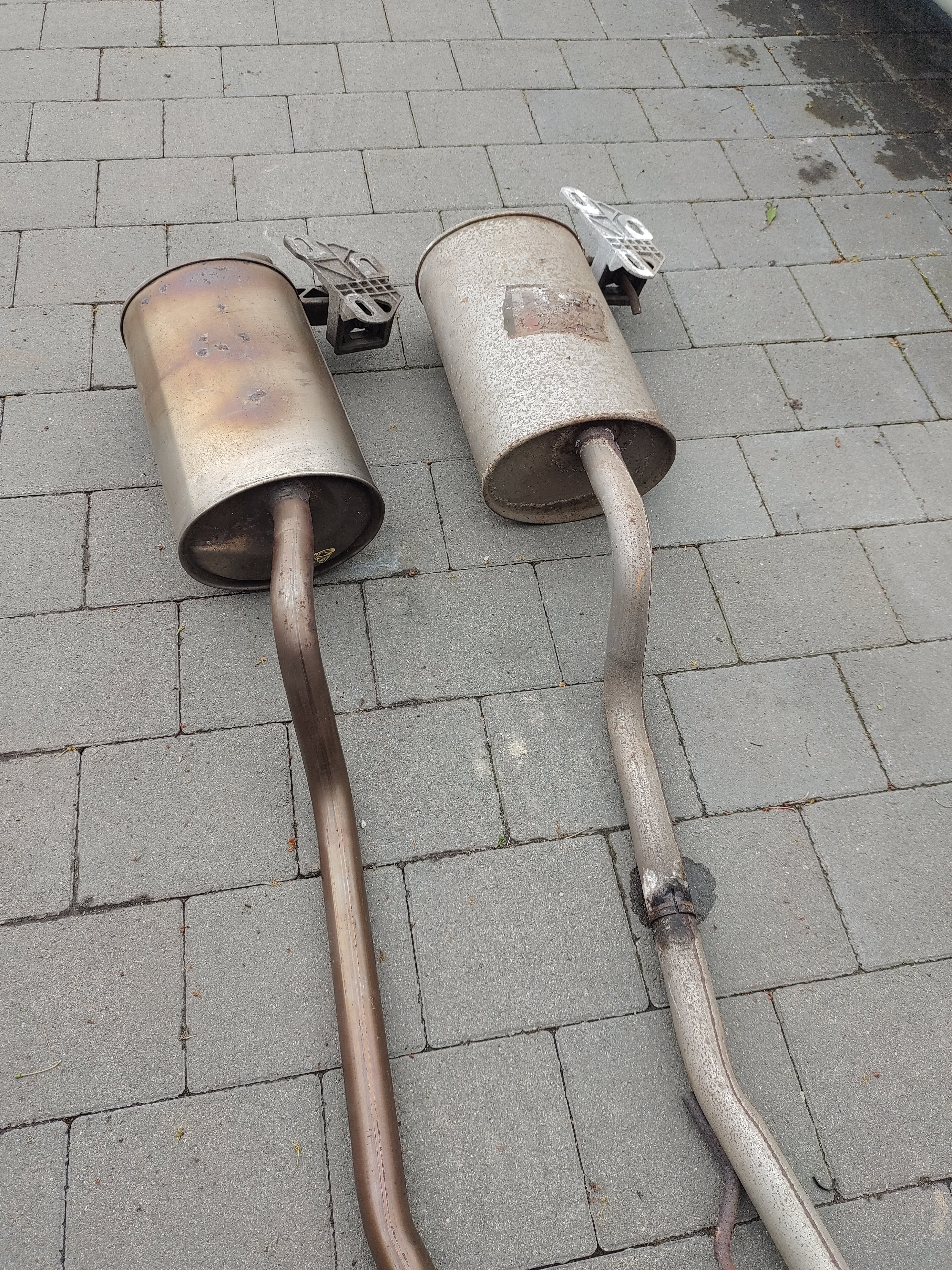

Today I was removing a perfectly good pattern part exhaust (two piece thing - they always blow!) to fit a genuine one piece one from an 08 Campus Sport i pulled off at the scrappy.

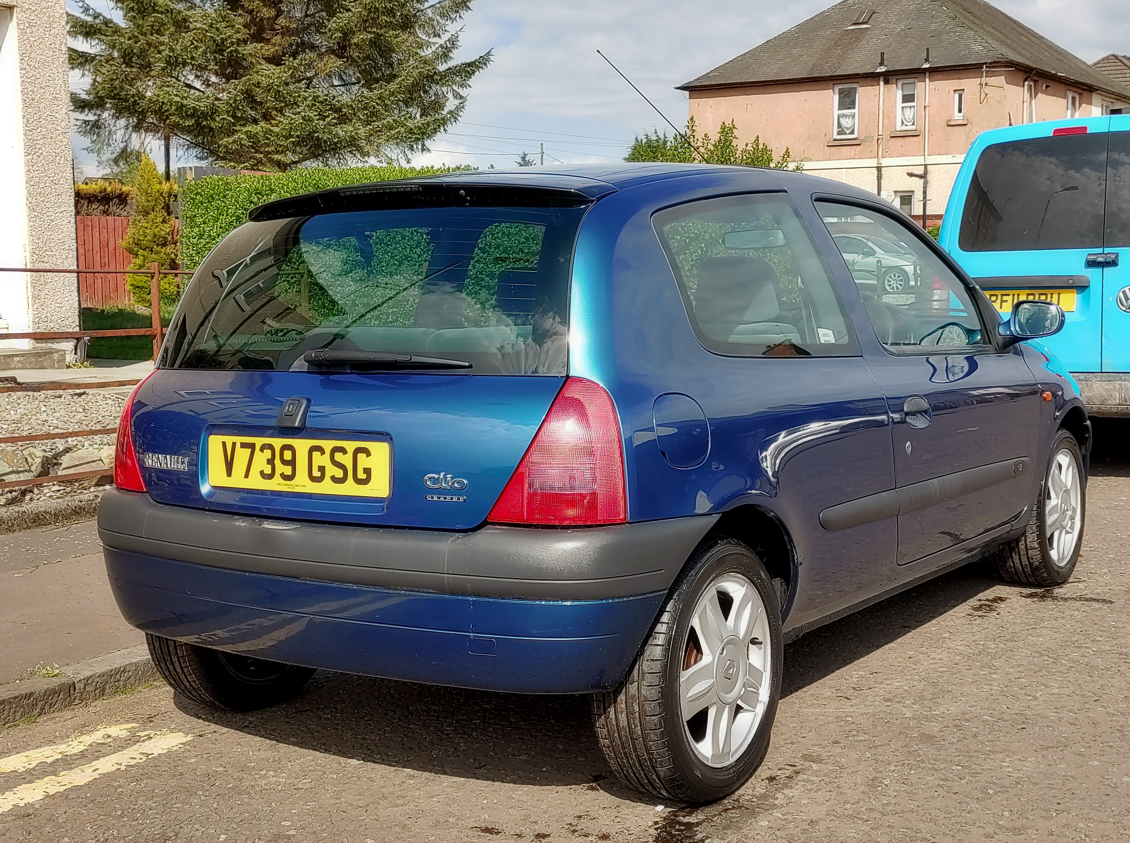

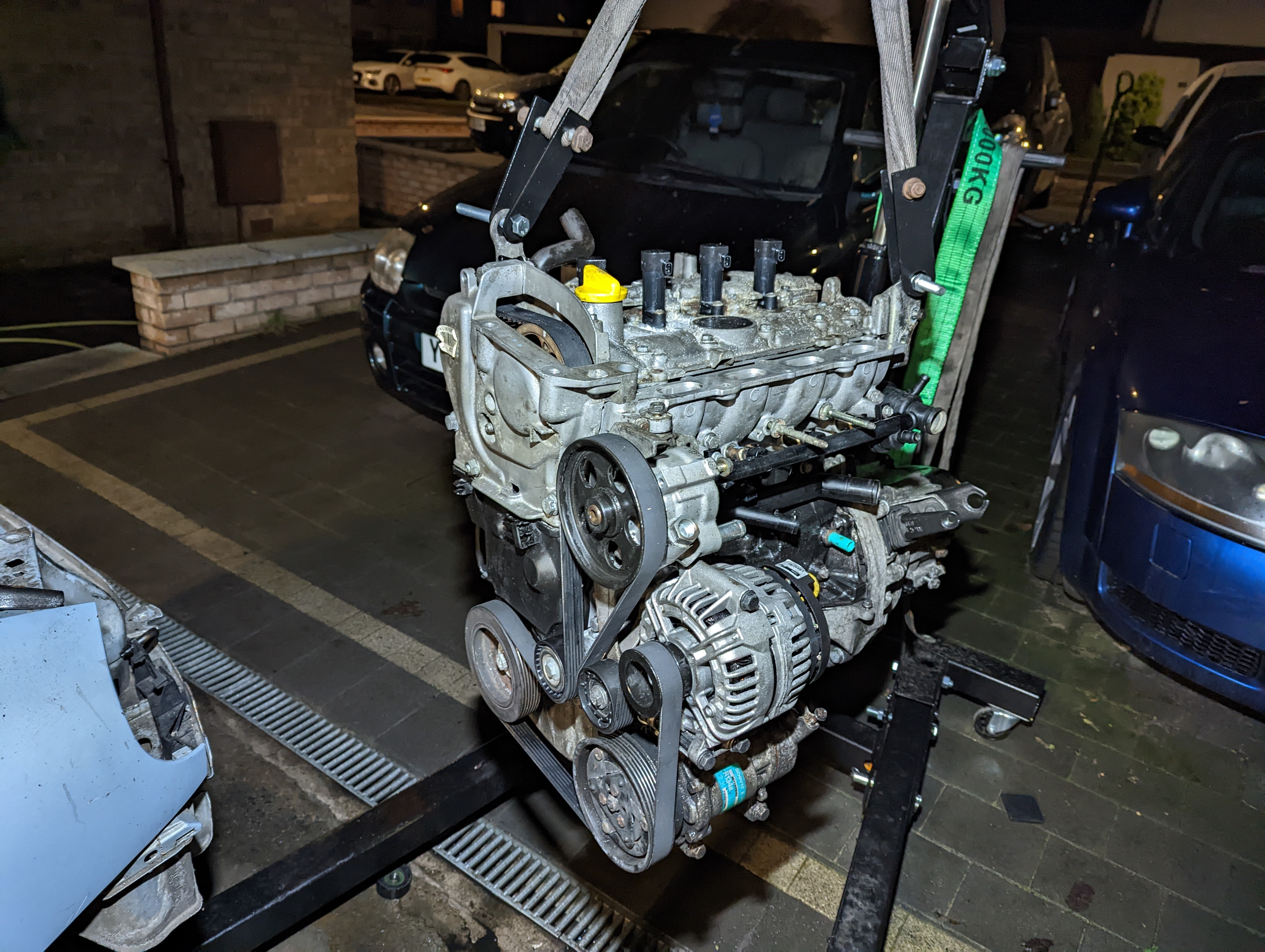

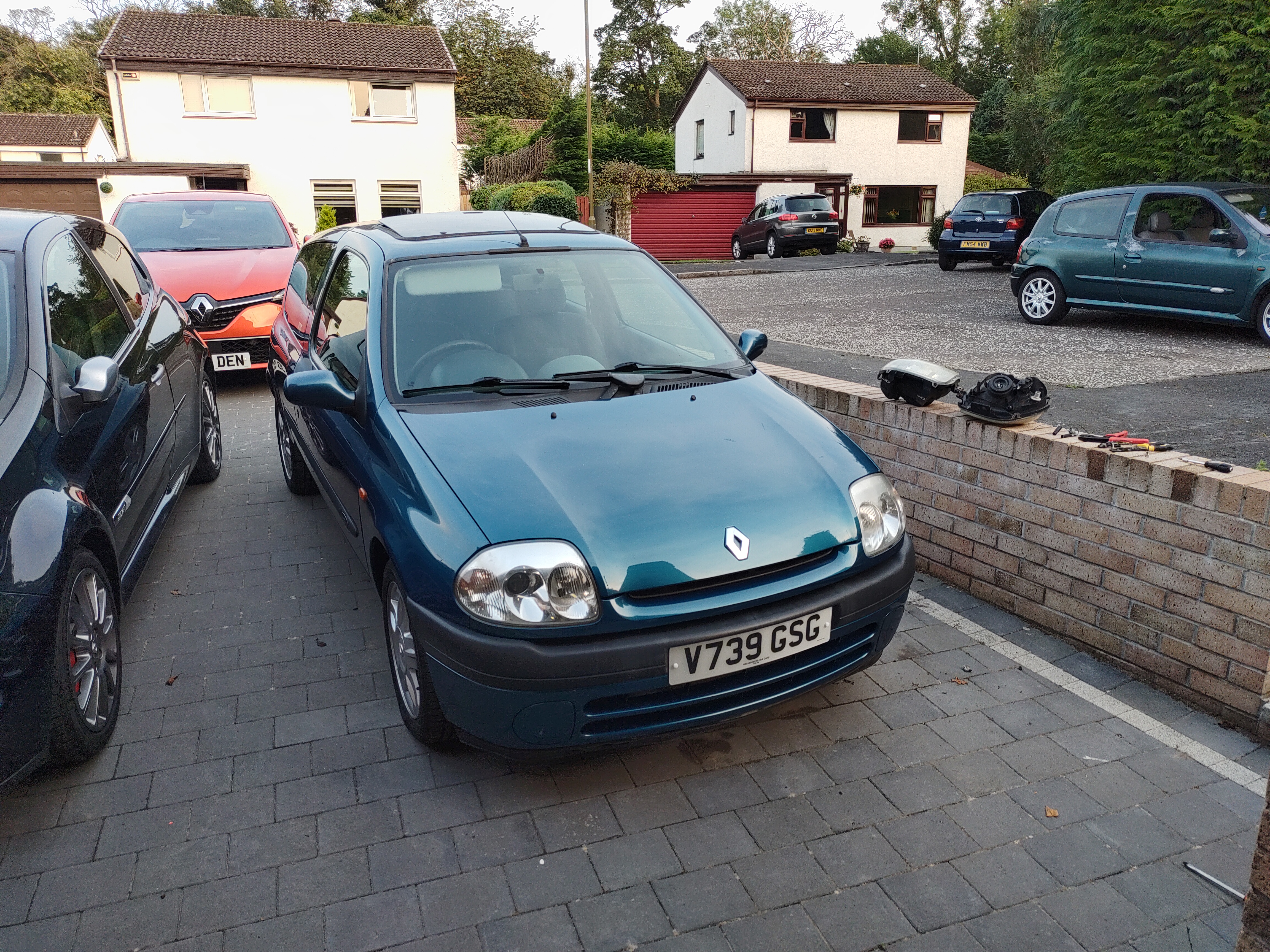

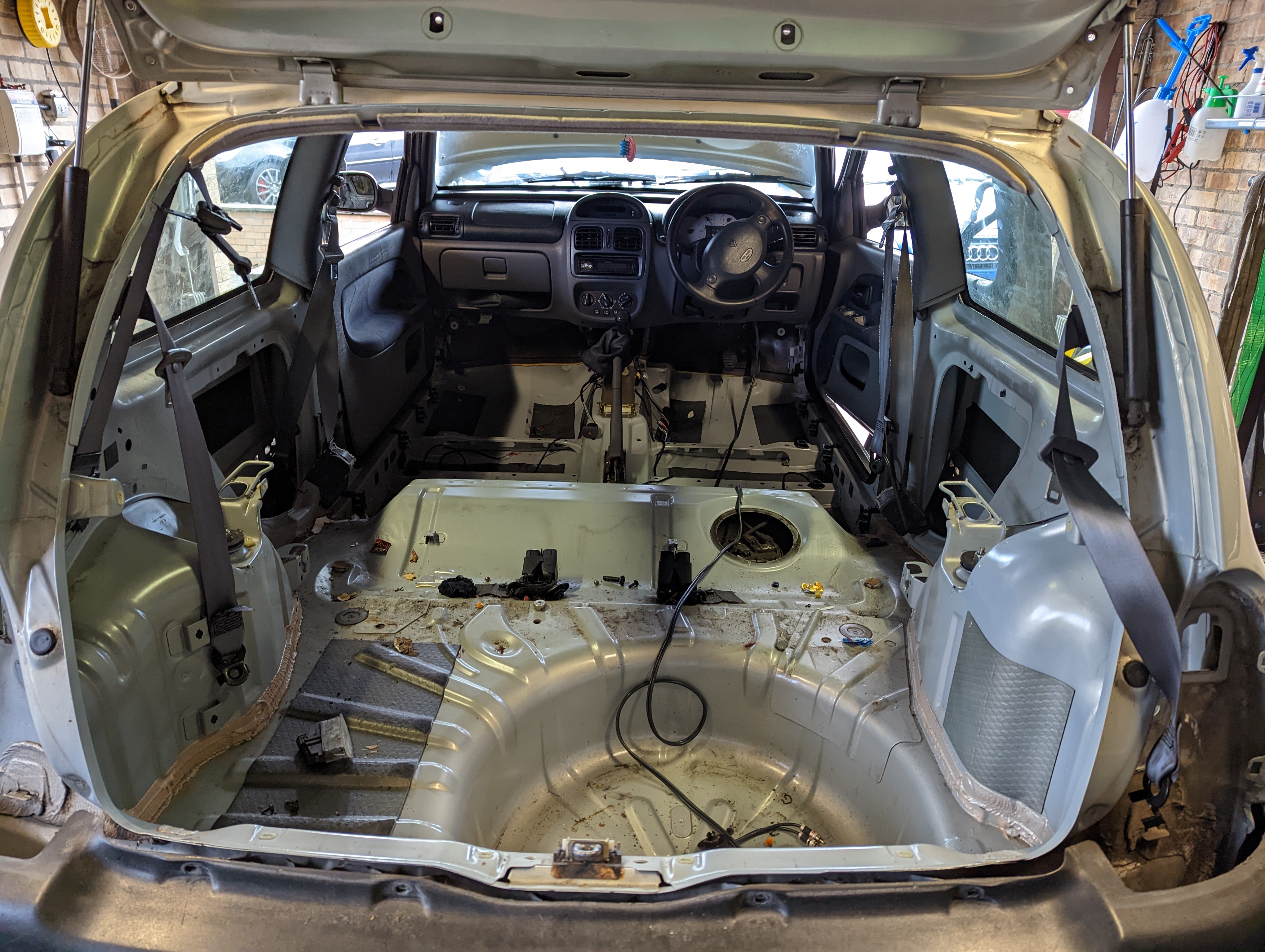

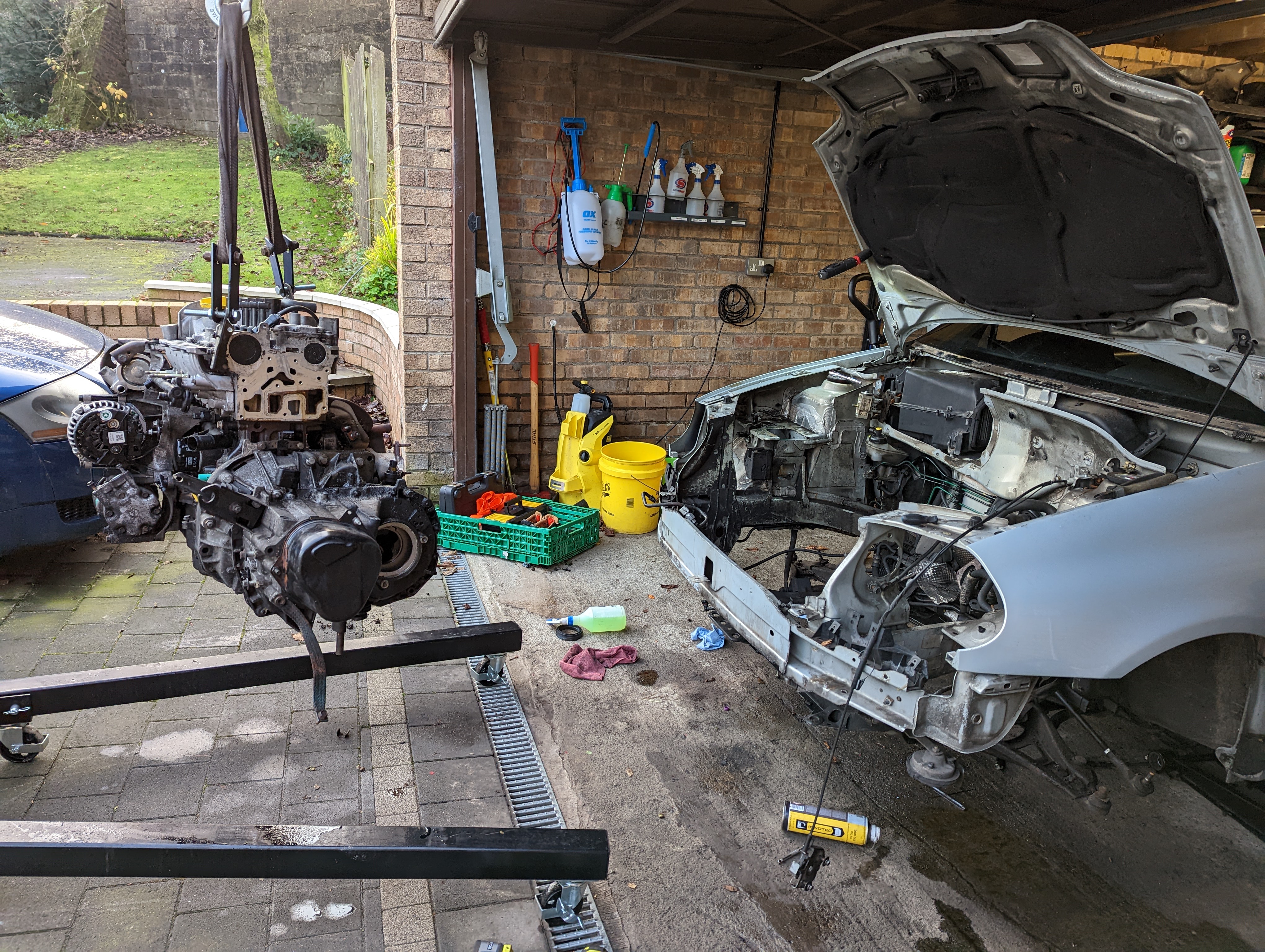

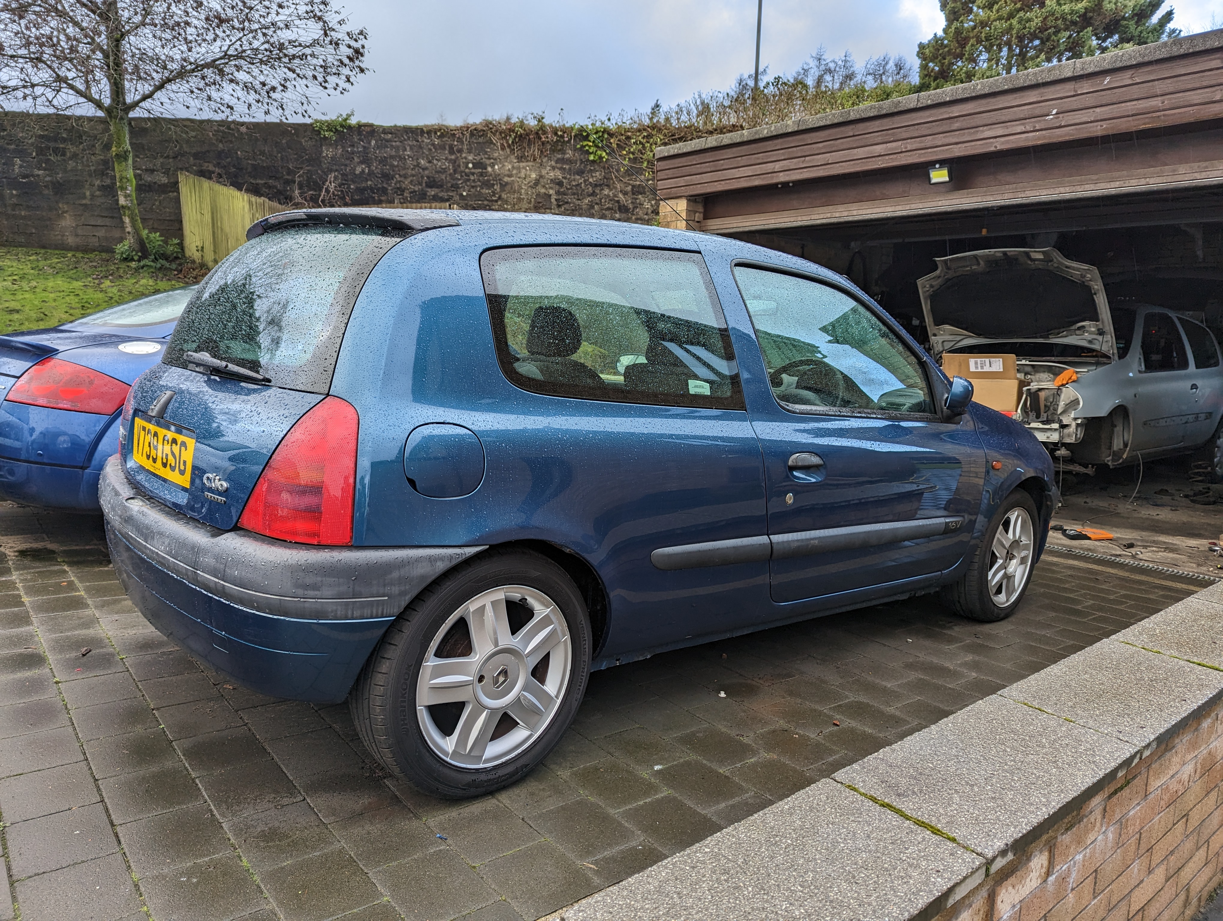

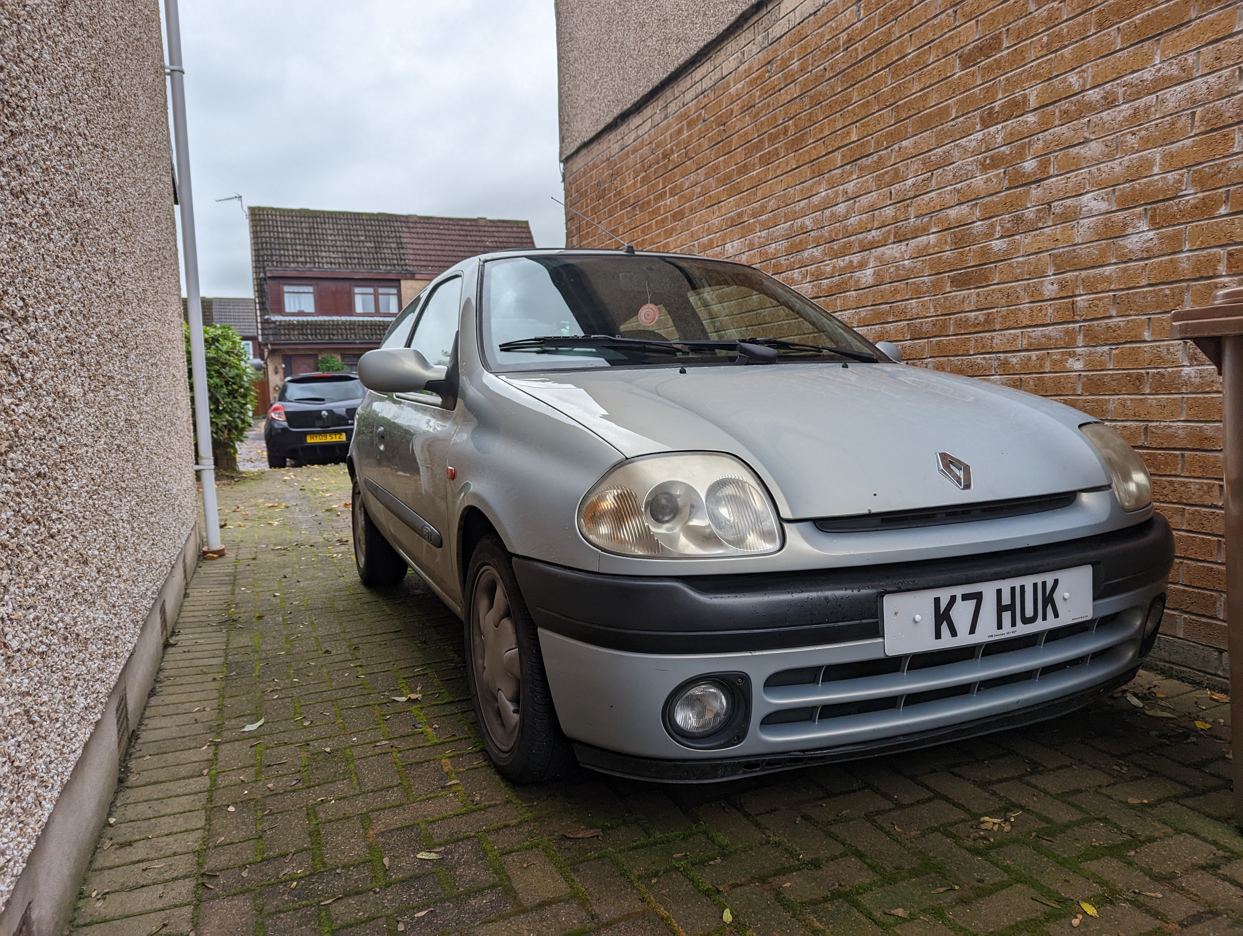

Well this grew arms and legs, picked up a high miles (170k!) Clio RSi cheap local today, shell has seen better days so its getting stripped and the 1600 16v converted over into this shell! - Engine runs sweet as a nut so ill just bore scope it and if all is good, stick it in, if not ill give it a refresh first.
Ooooh I love an RSI. I remember when I first got my 172 and and a guy in an RSI caught me off guard and it took me a good 2 lengths of dual carriageway to catch him. 😂
Have a soft spot for the RSi it's such an underloved version of the clio 2!
Can't say much as i have one myself. Looking forward to watch the "restoration" looks good with the vega wheels!

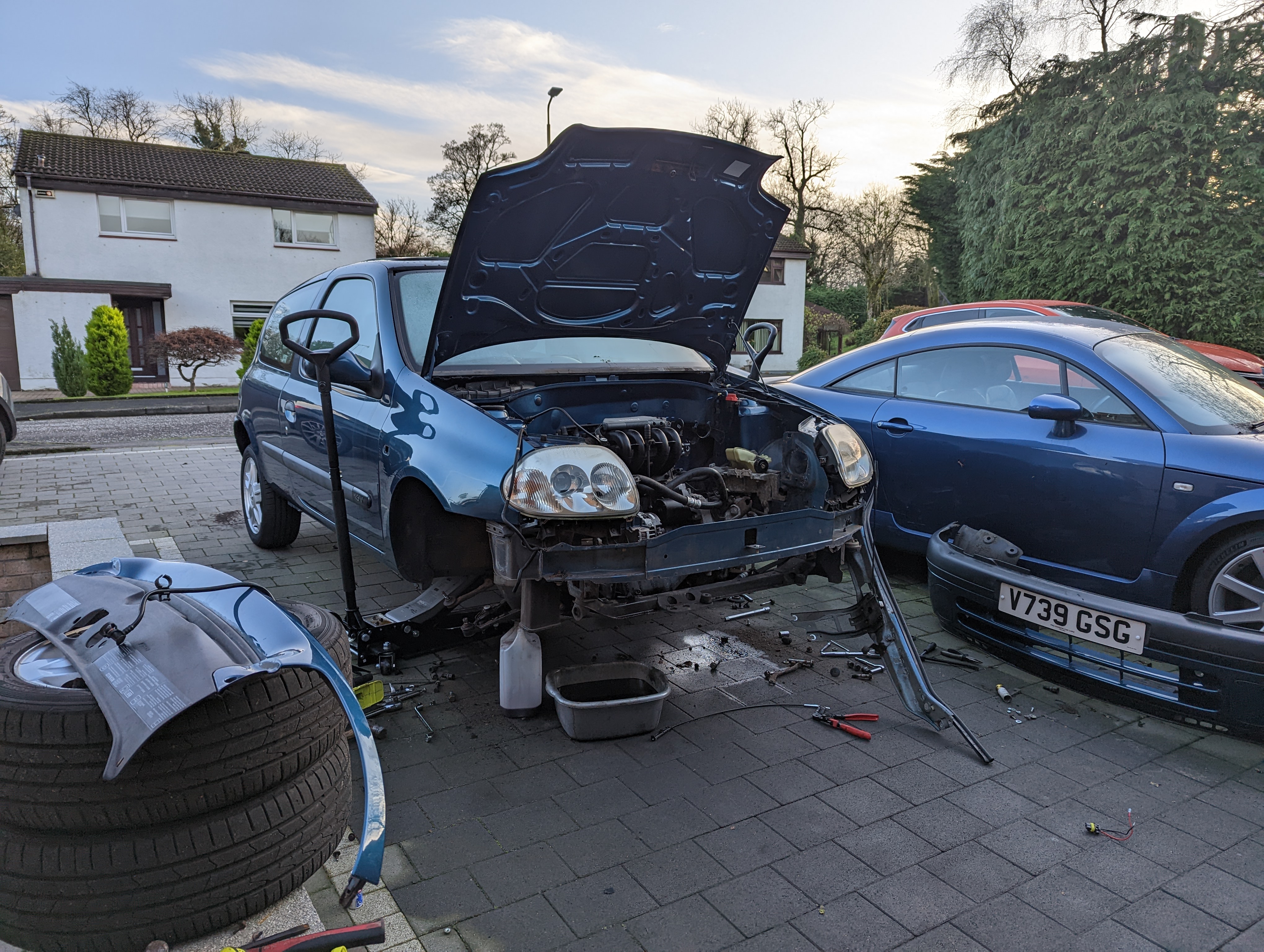

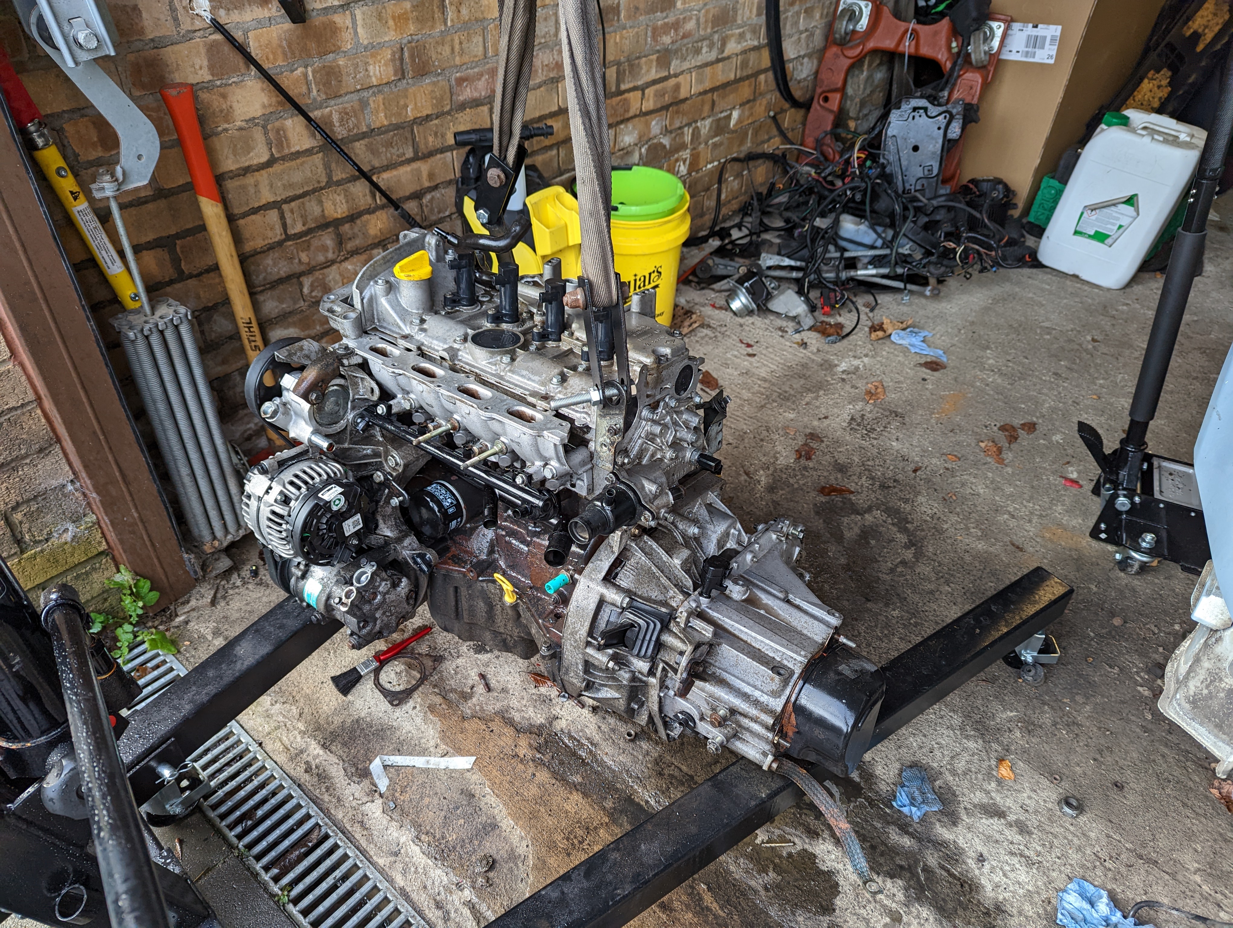

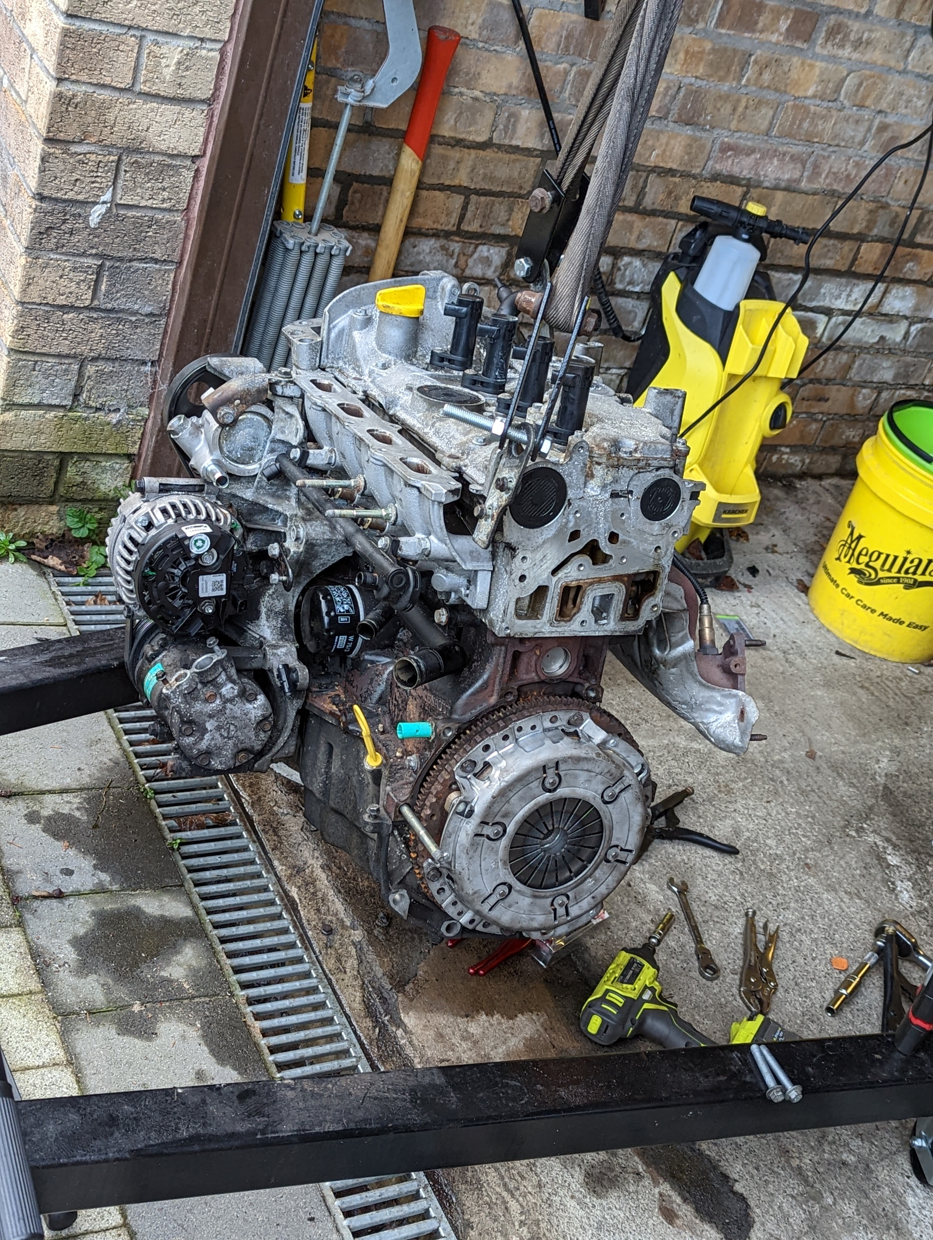

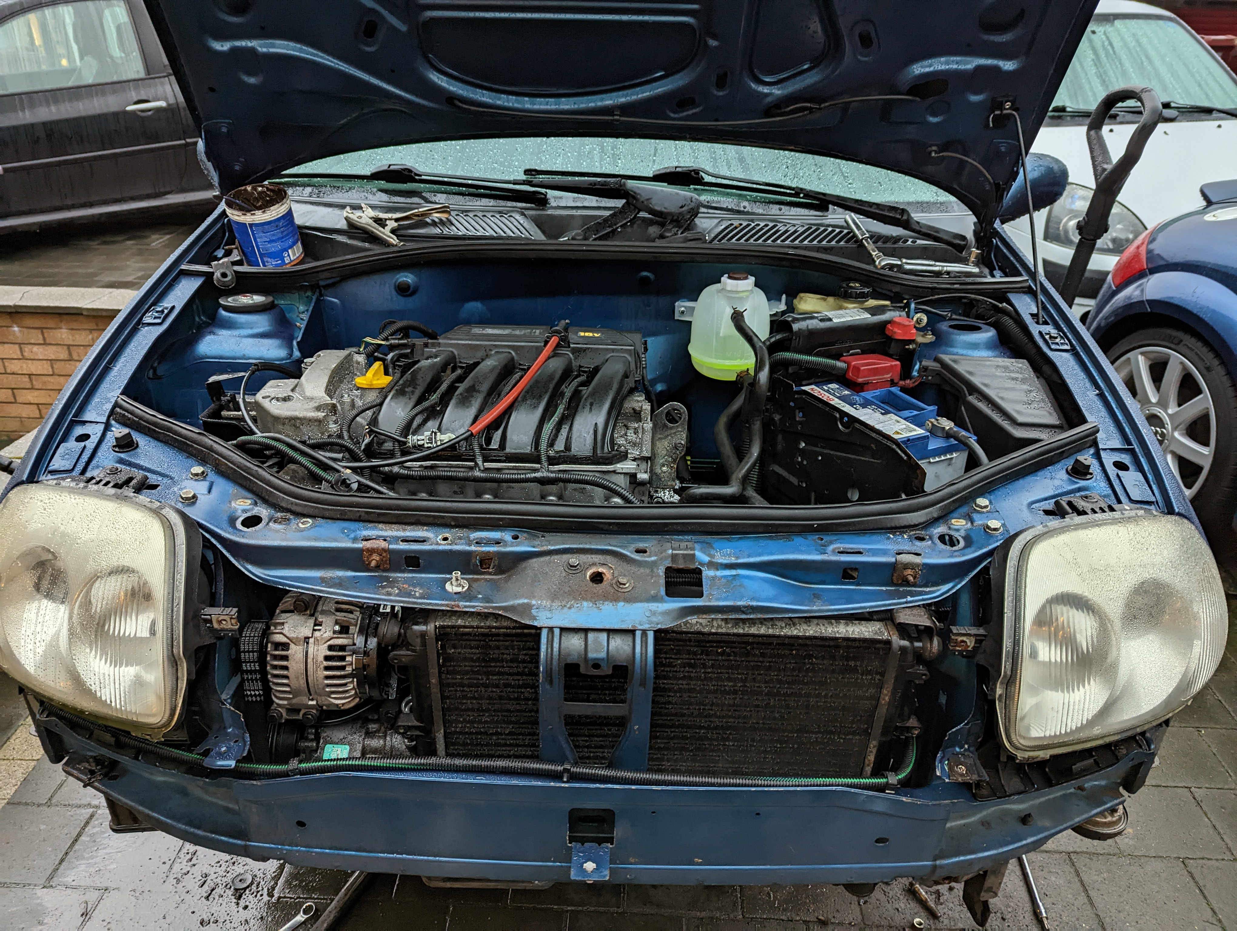

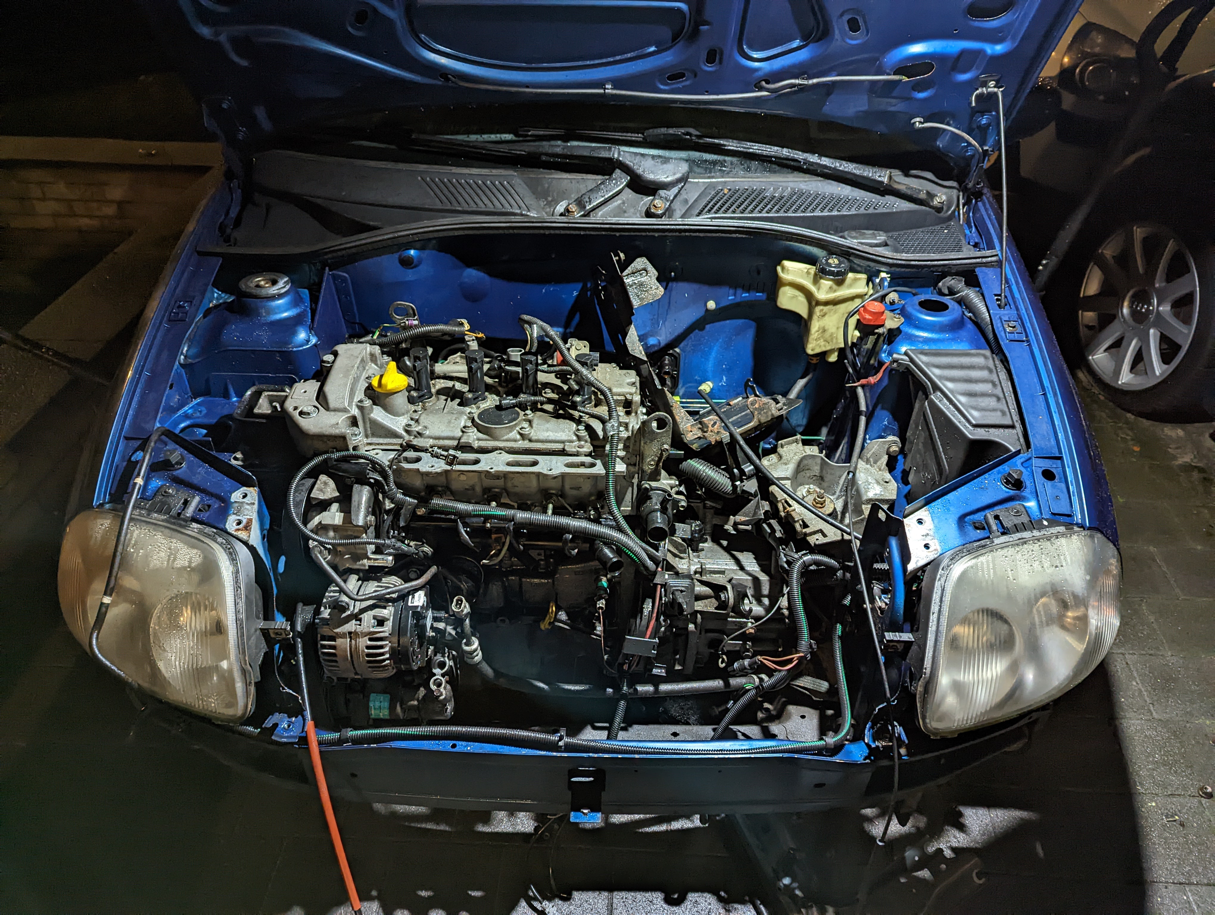

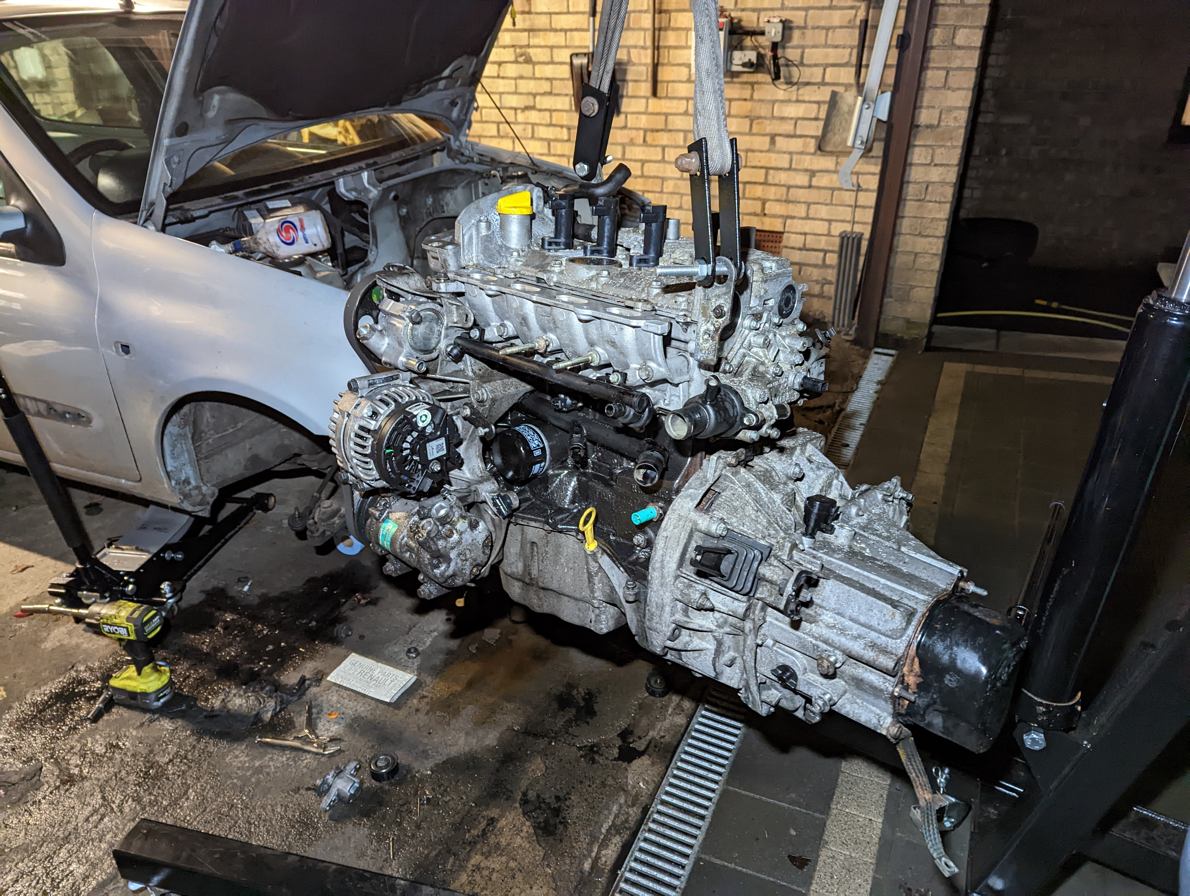

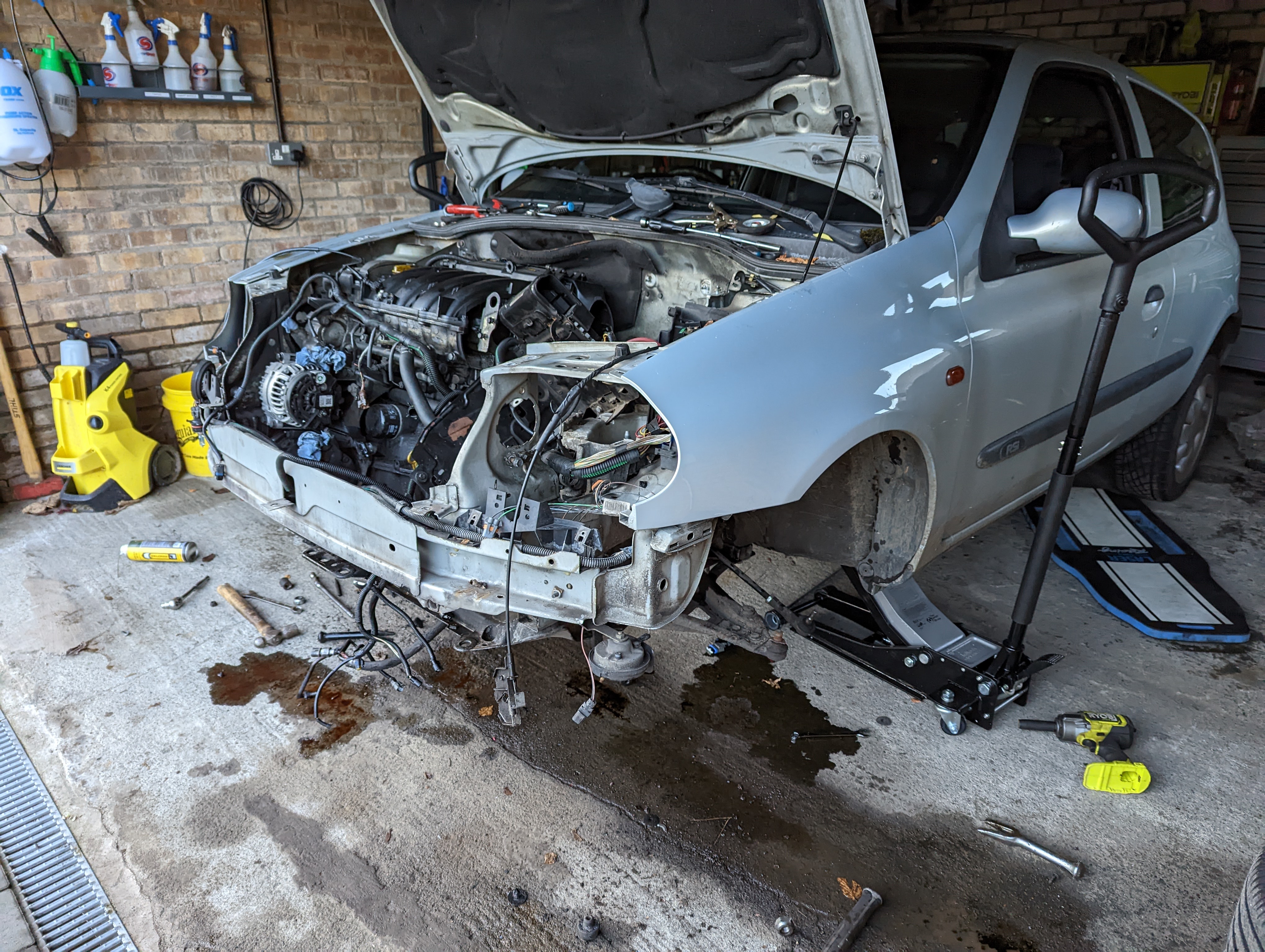

Been plodding away with getting the donor car stripped, as soon as the shell is gone ill get the engine all prepped and then the 1.2 in and stripped!

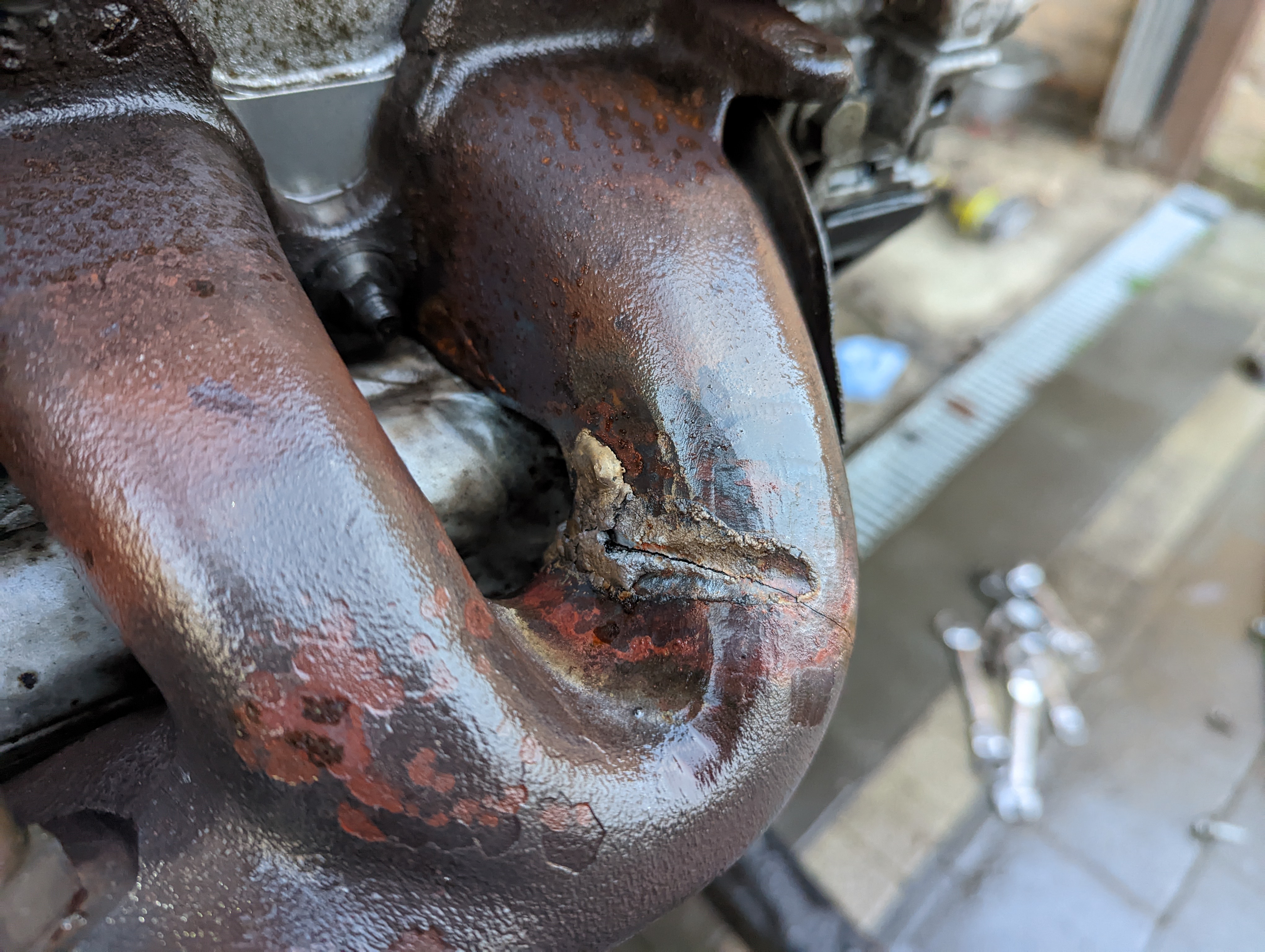

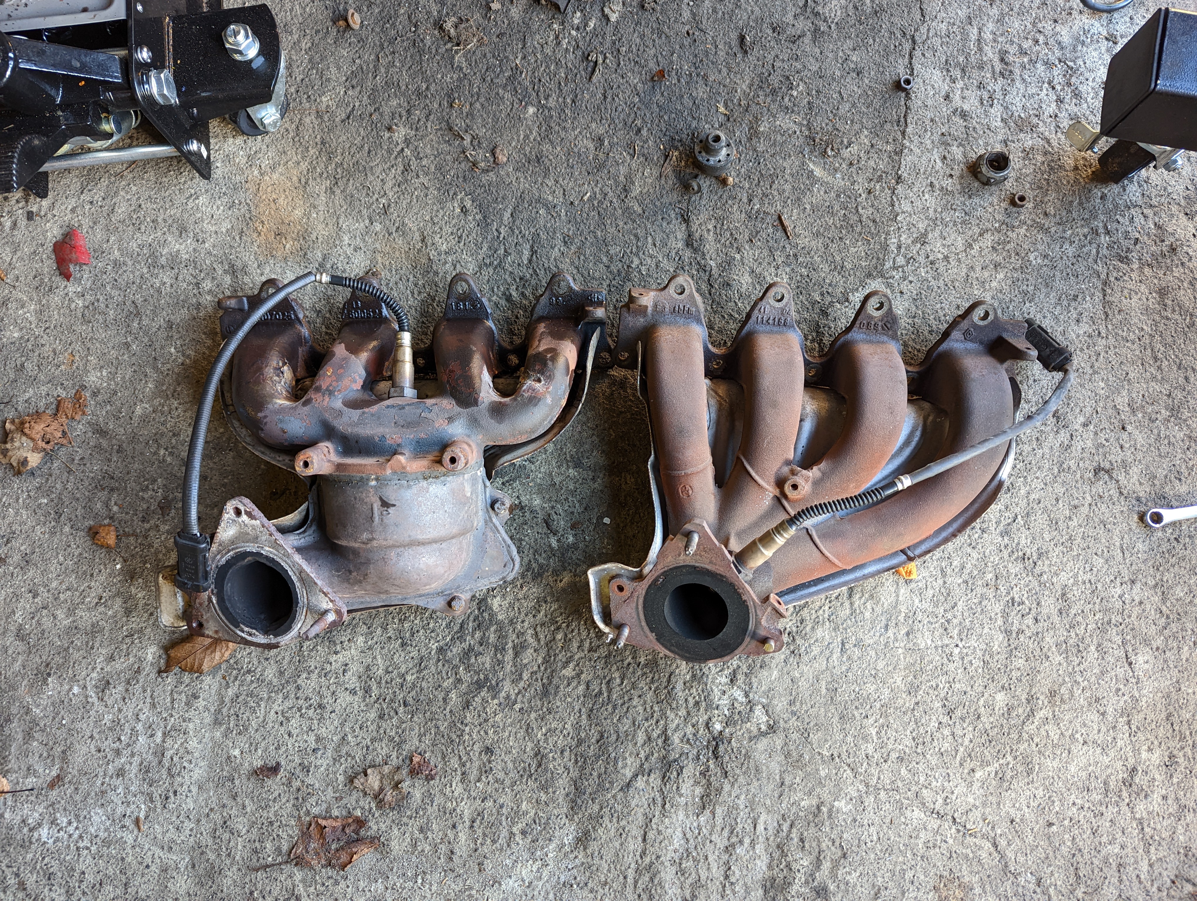

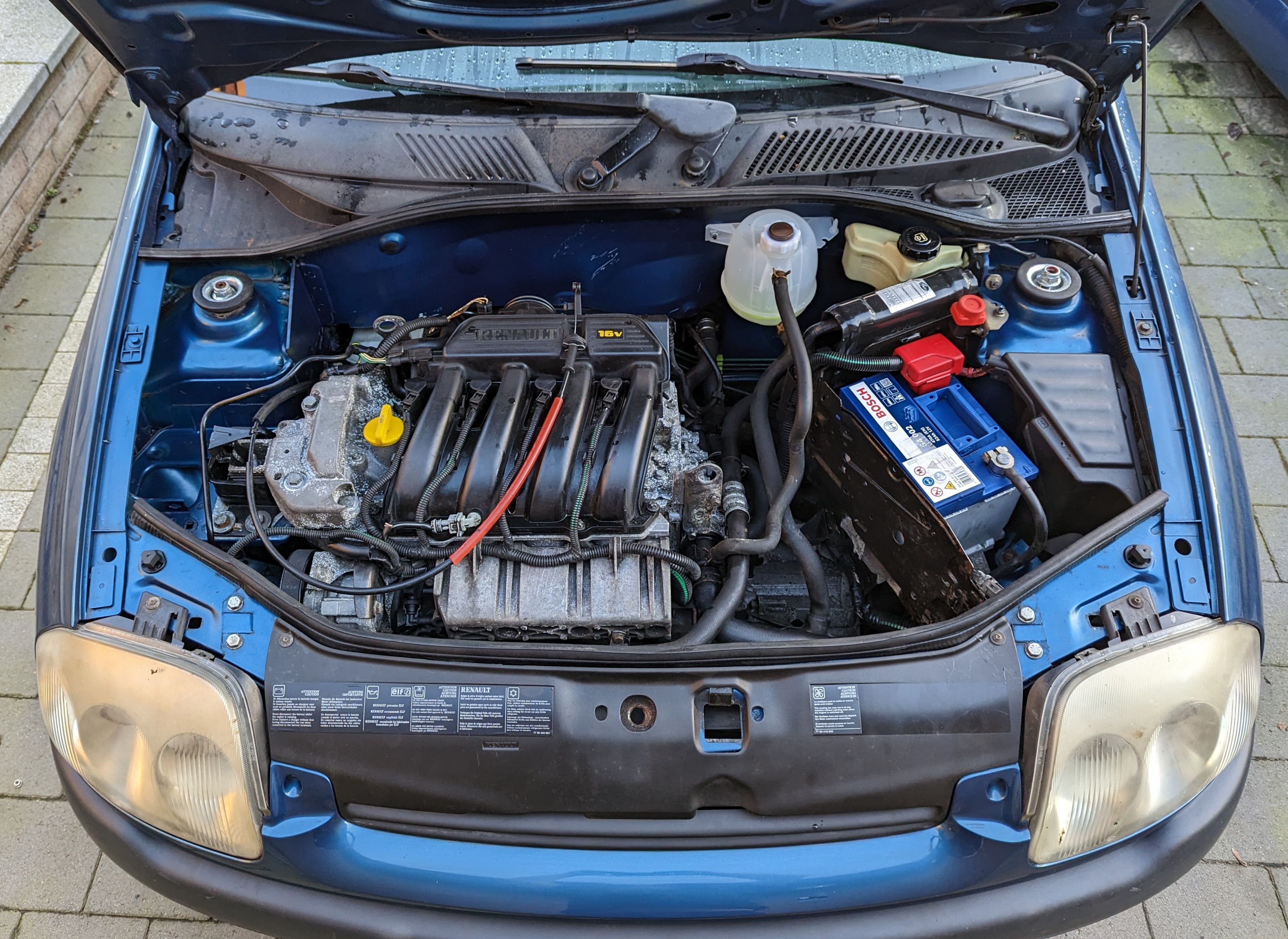

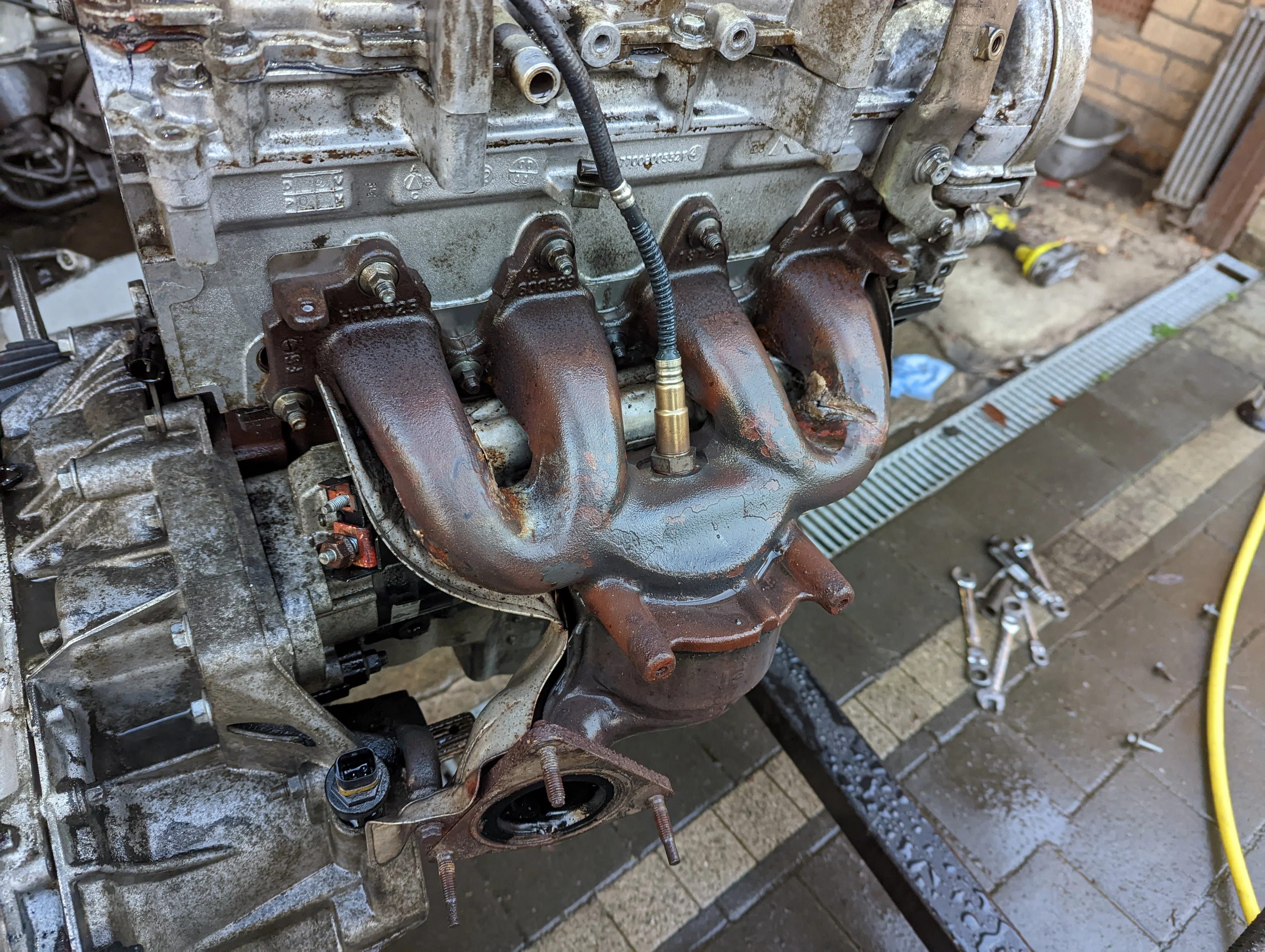

Found the exhaust manifold was cracked, so that will need replaced (i had heard the blow and assumed it would be an exhaust flexi)
Funny enough the manifold has a cat on it, as well as a cat on the down pipe, ive never seen that before on a 1.6 clio, especially at ths age? ive found plenty on ebay for £20 odd that look the same minus the cat so that will be an upgrade for it!

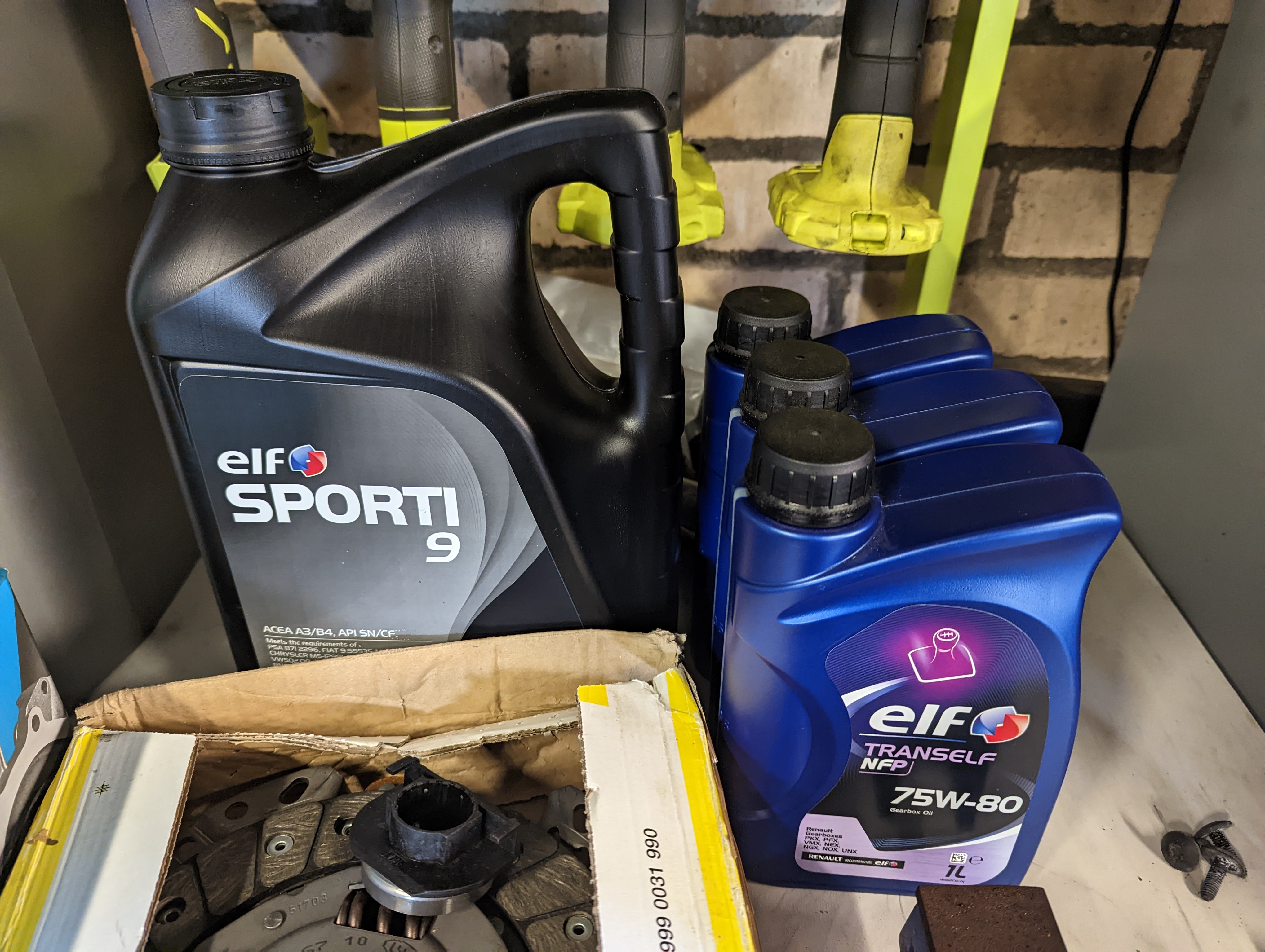

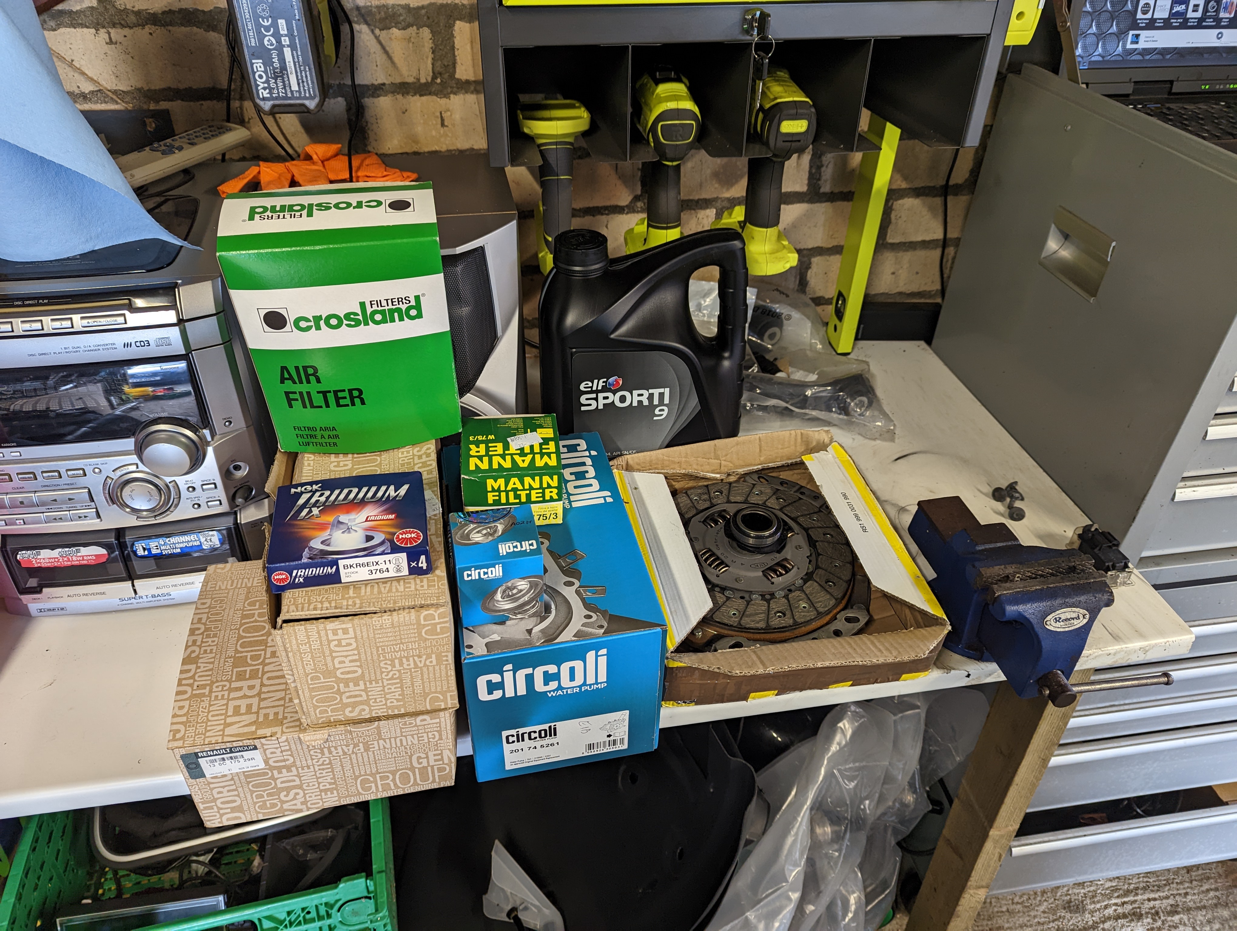

Been on a bargain shopping spree for it, i had priced up all the service bits for it and it was coming in quite expensive, given the low cost of everything for the car so far, but the benefit of a common engine that people are not overly interested in means loads of new old stock on ebay!
got:
genuine timing belt kit for £50 (£100 online)
genuine aux kit £40 (£90 online)

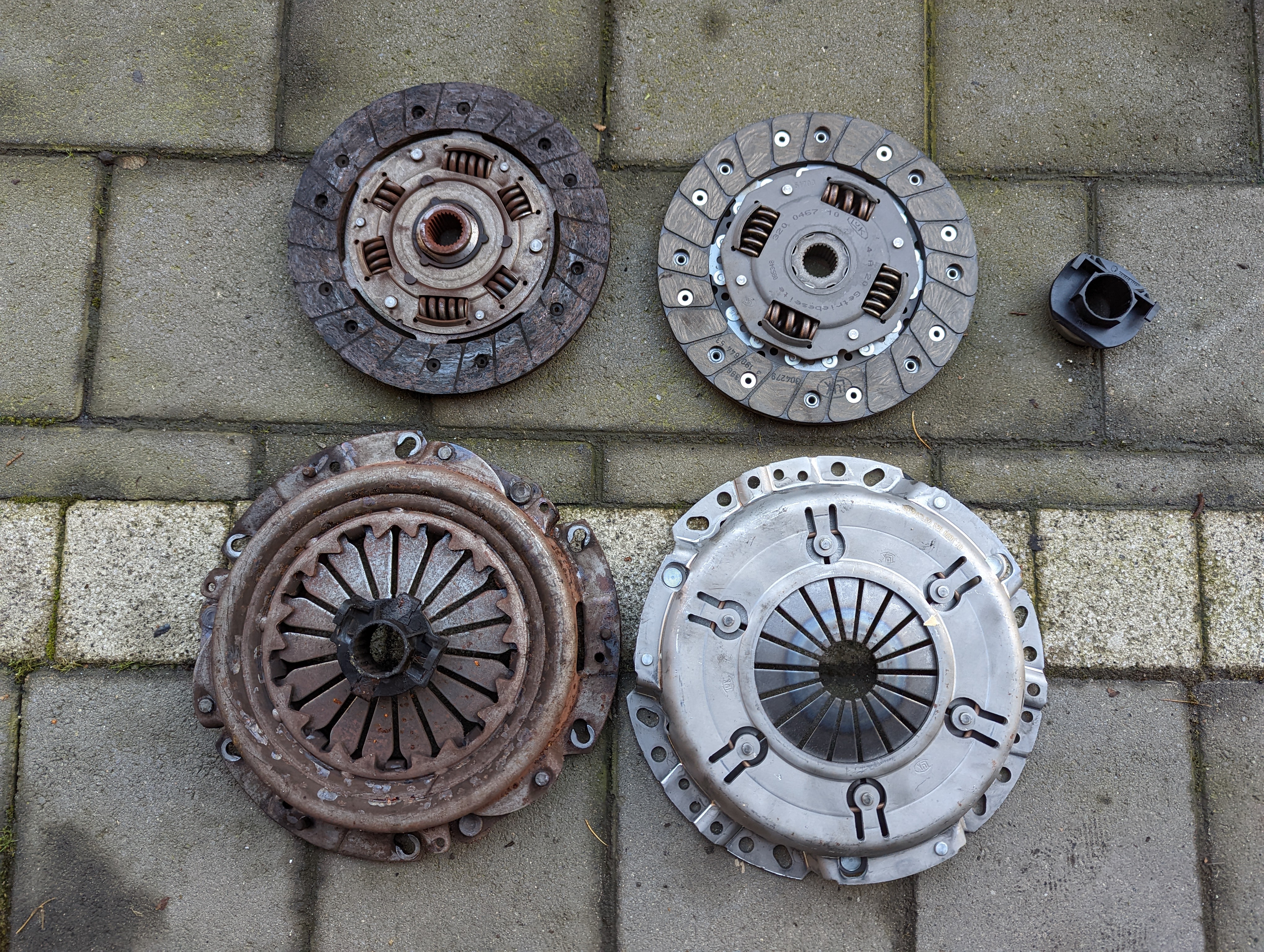

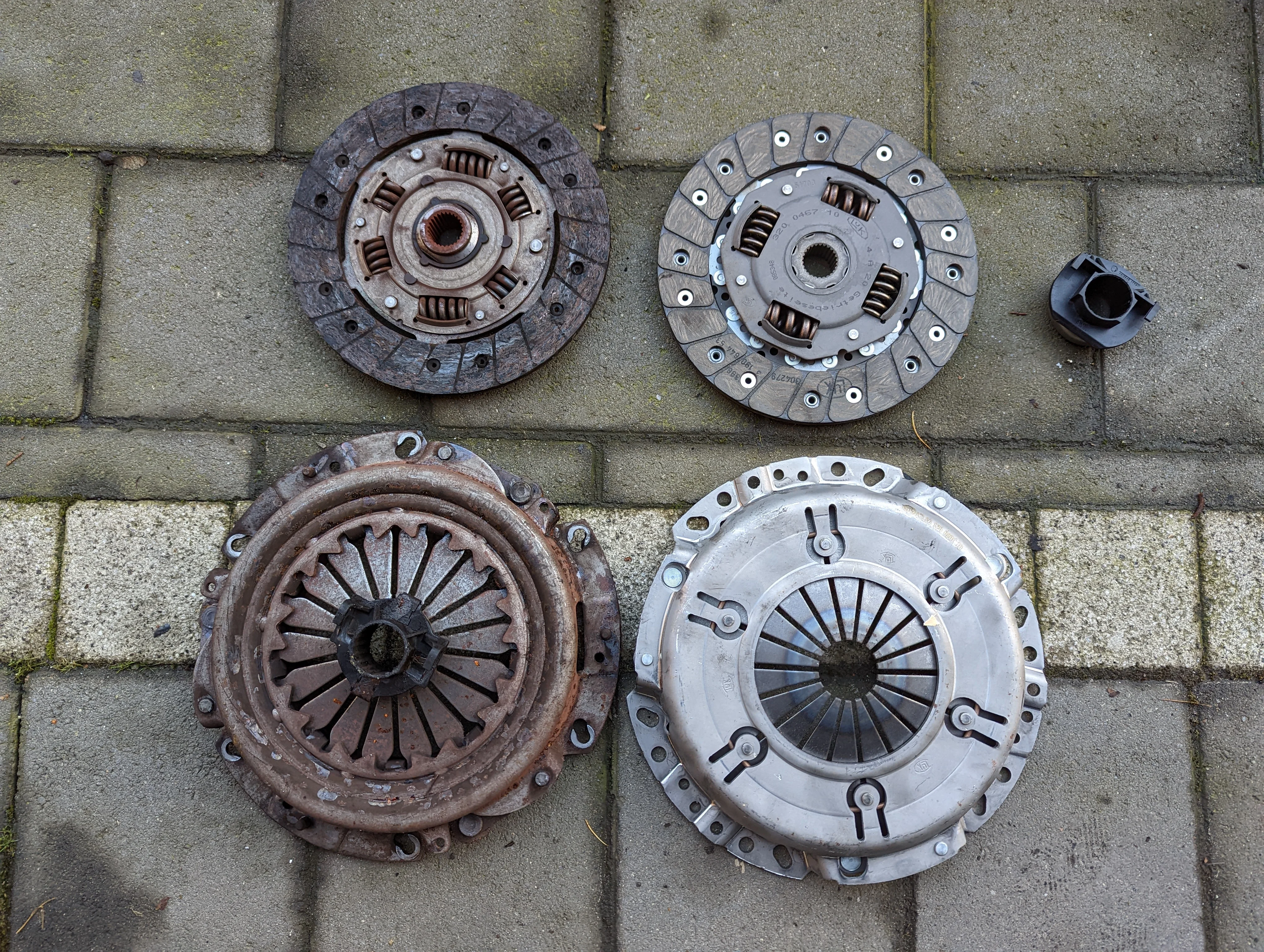

LUK clutch kit £25 (100 online)
All the parts were here so i got some time on this today. New manifold without a cat (or any cracks!!) good upgrade!
Fitted the bargain £25 clutch!
Got the block all cleaned up and painted, cambelt, water pump and aux belt changed, and everything got a good degrease and clean with a wire brush to freshen it up
Hoping to have it running tomorrow afternoon!!!

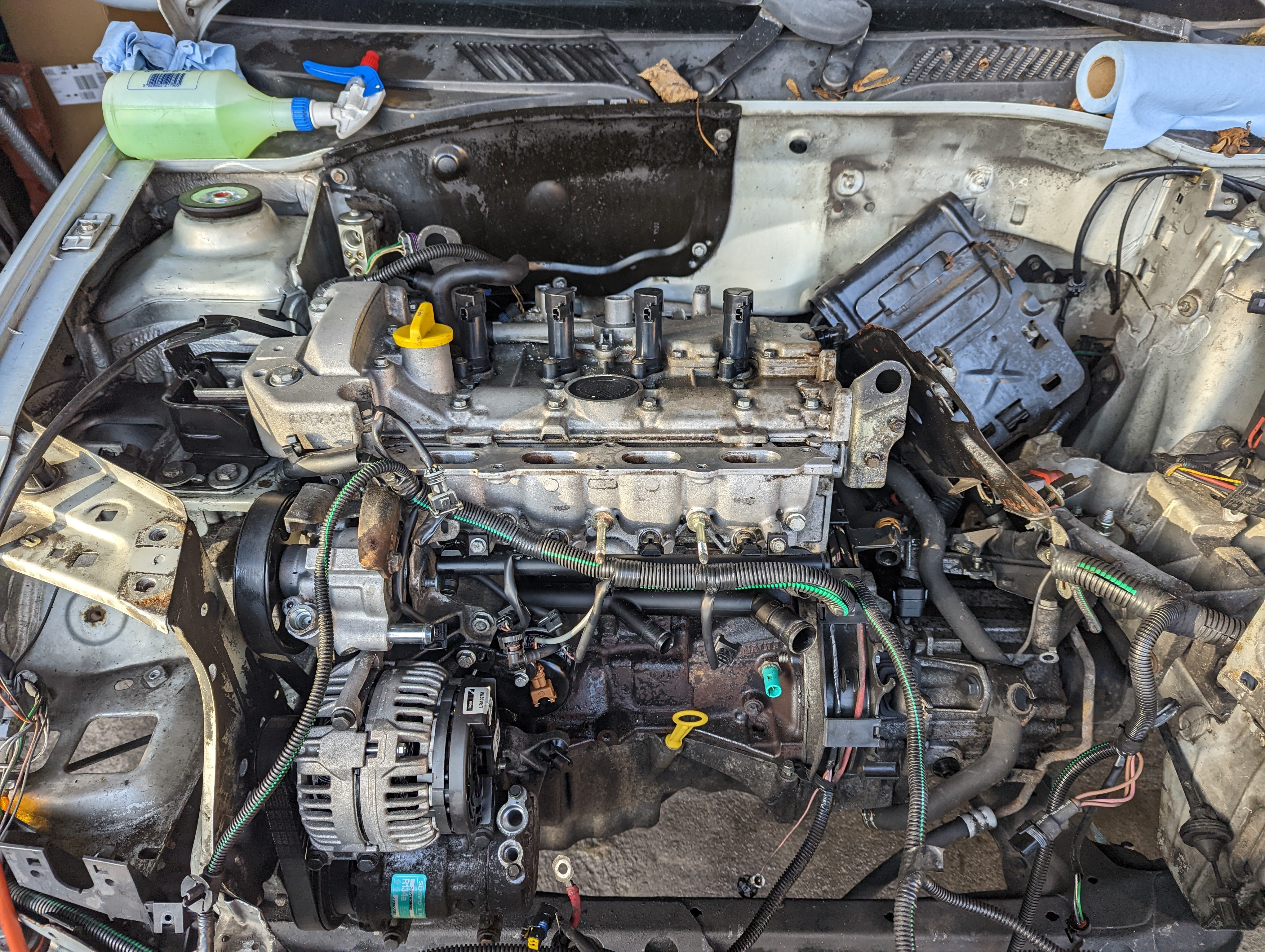

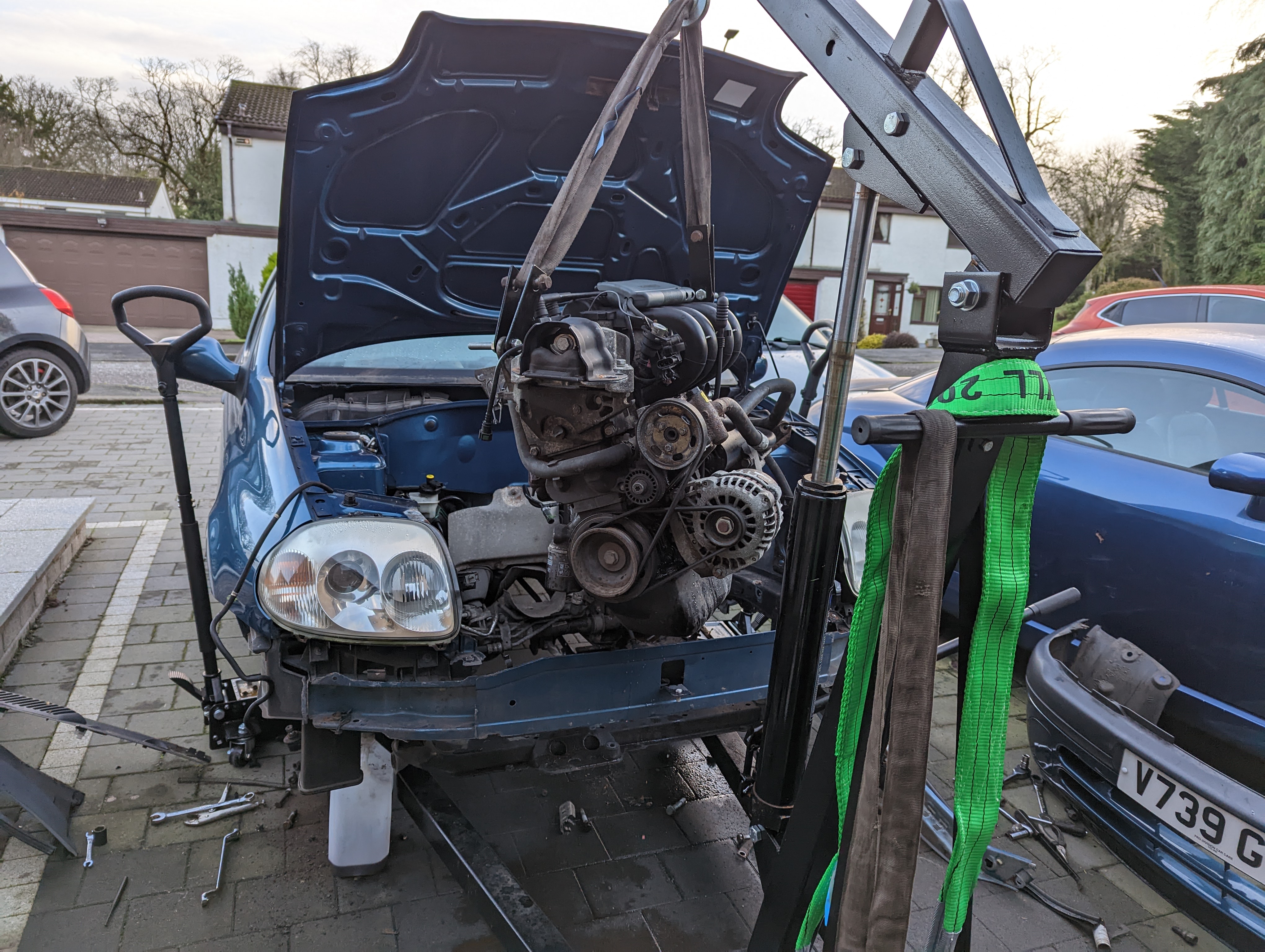

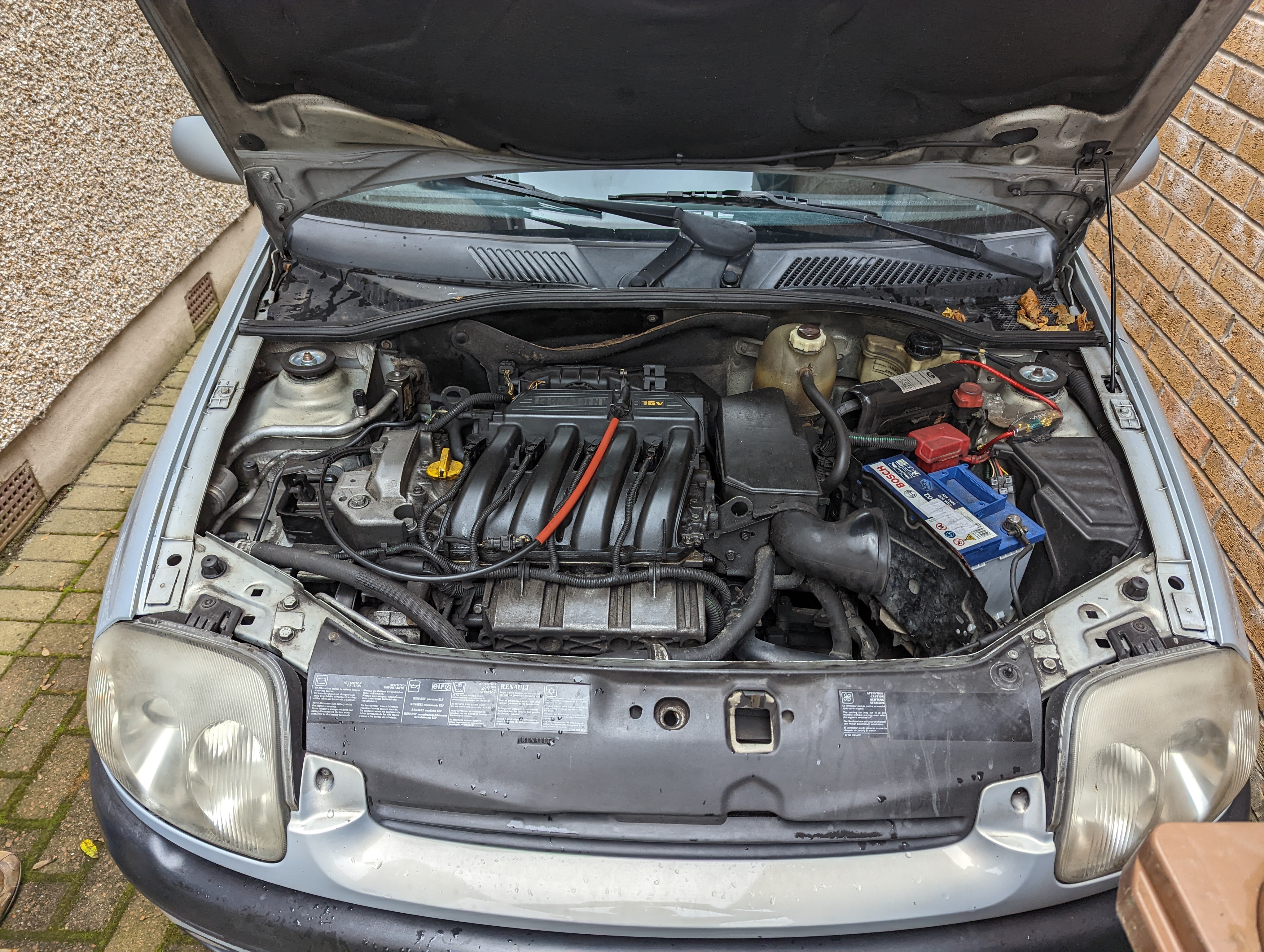

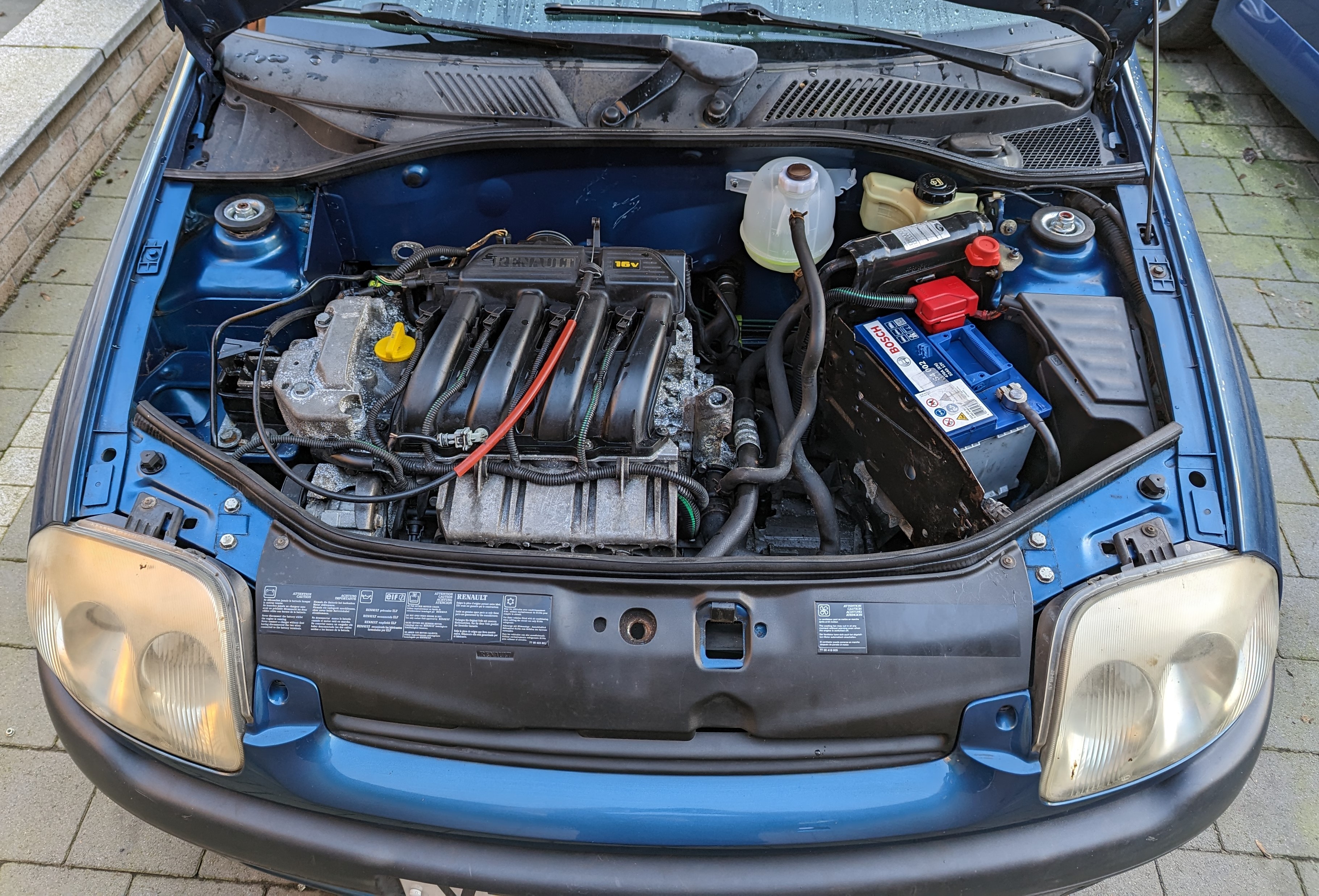

Flat out today, I start a new job tomorrow which is going to write off most of my free time so I set out this morning to get torn into this and get it to a point where I can do an hour here and there when I get time. Not many photos as I was just working away all day but finally the 1.6 is in!!
I ran out of light and energy so called it a day at that. The engine is on its mounts so I just need another couple of hours to get the wiring all routed properly, cooling system on, exhaust on and get the hubs and brakes on so it can go back on its wheels 😎

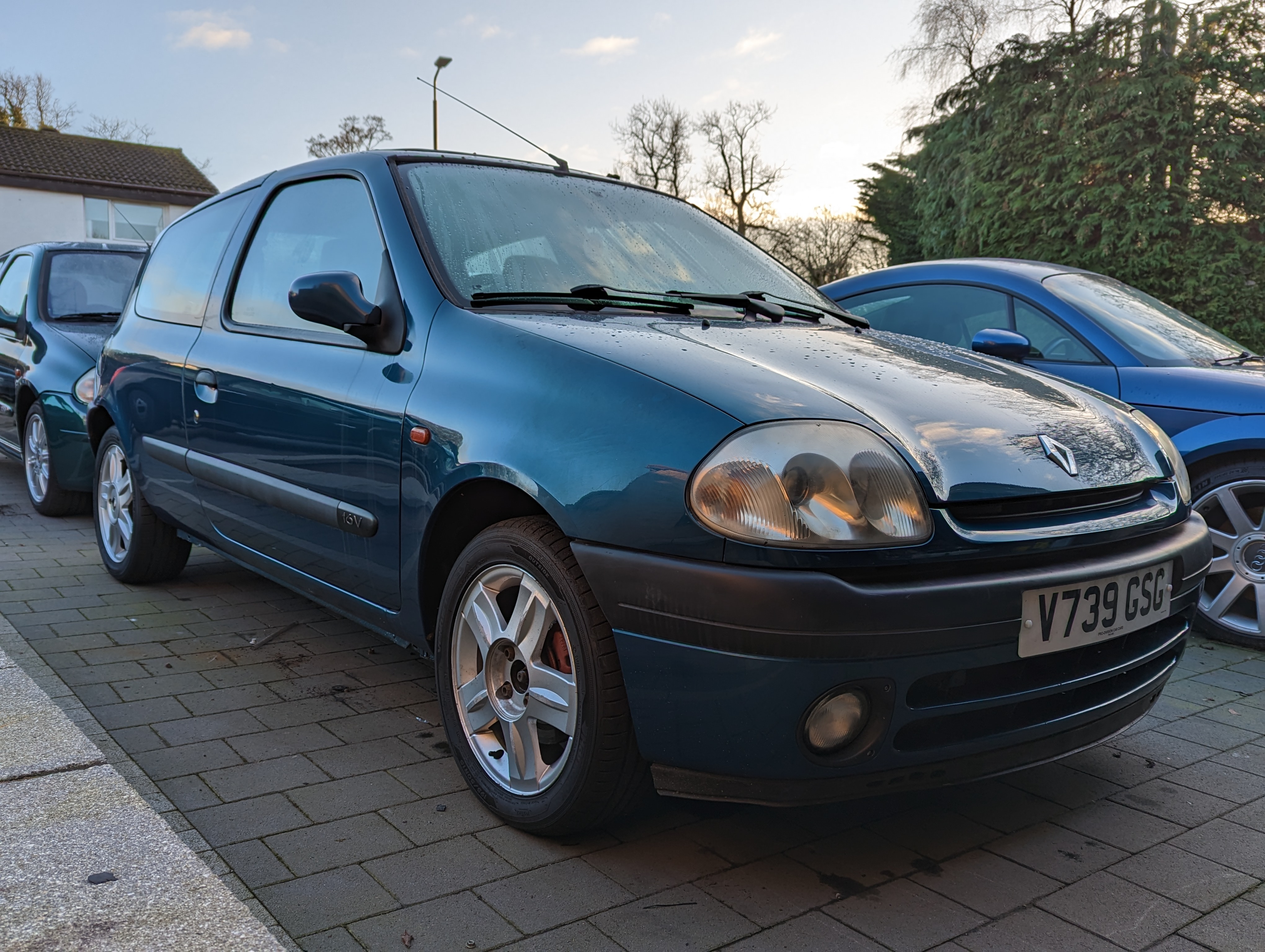

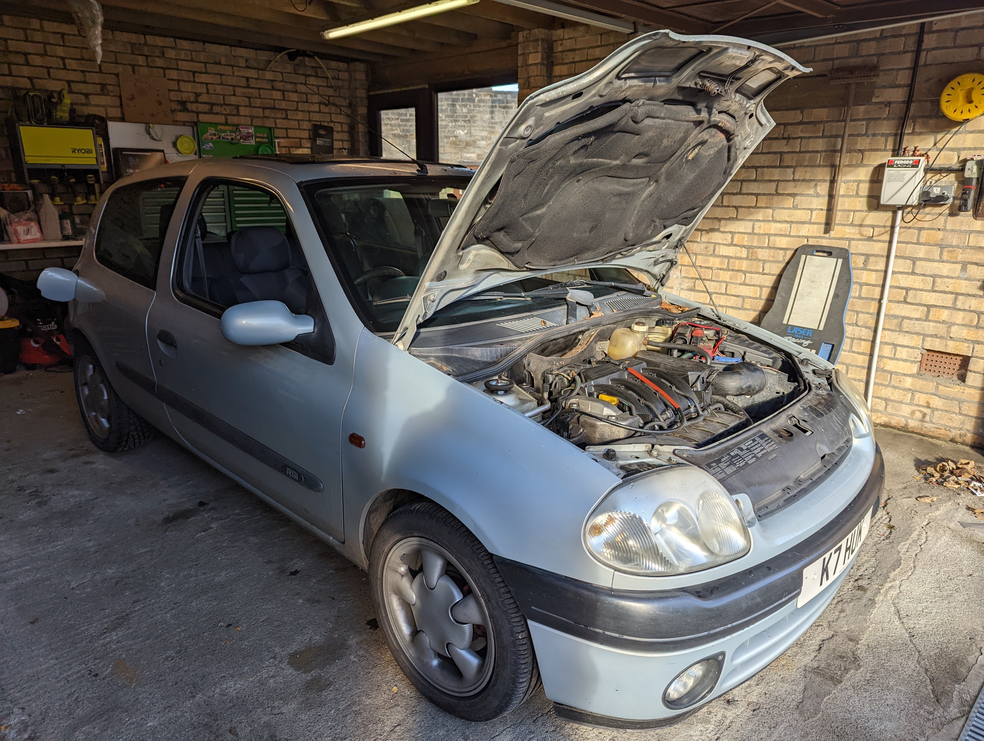

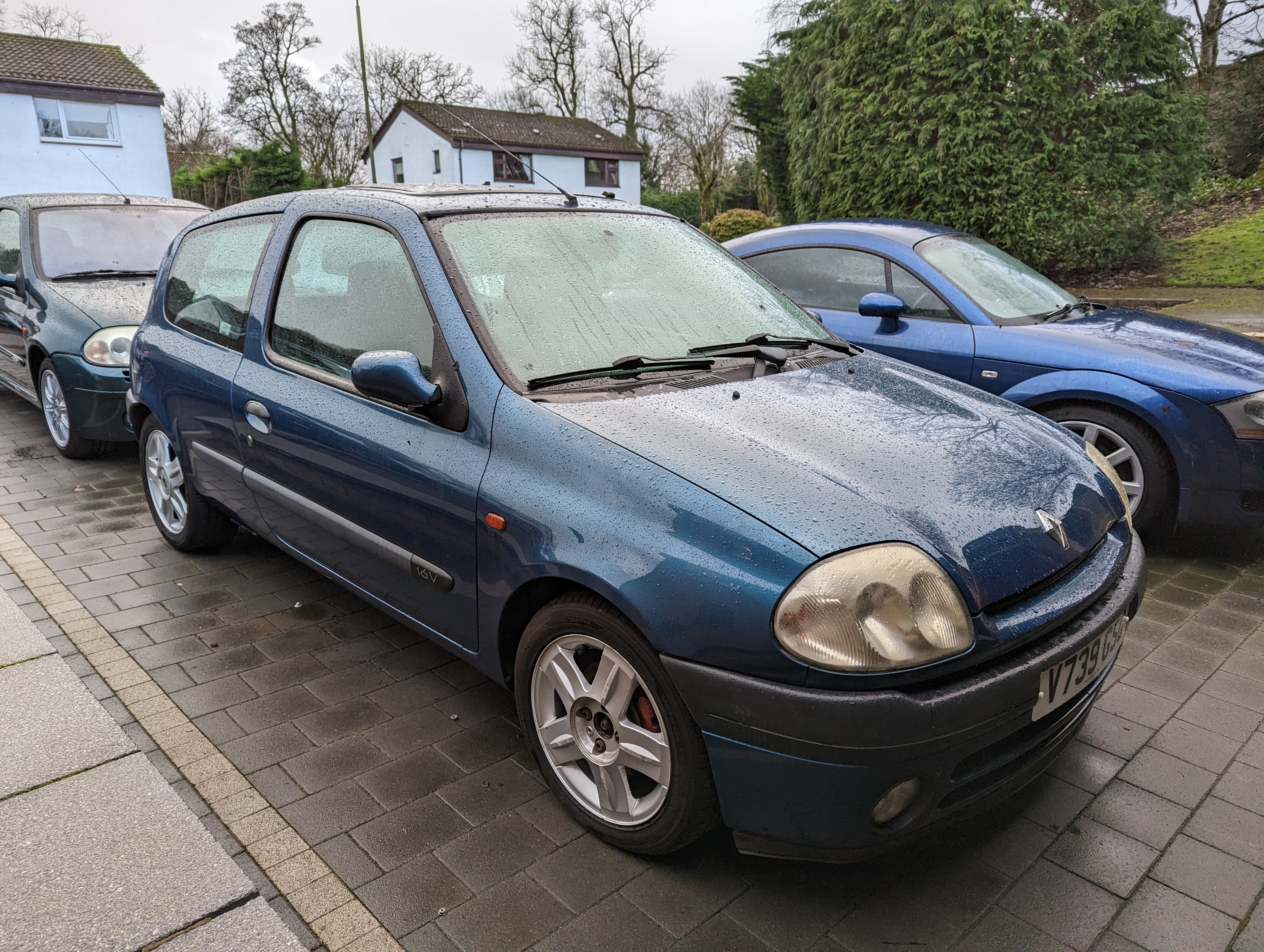

Not been a massive update for the last few weeks, Been plodding away when i get an hour here and there on days off! Its back on its wheels, everything's wired in, just got the fuel lines to swap, exhaust to fit and a final top up of the fluids and it should run!

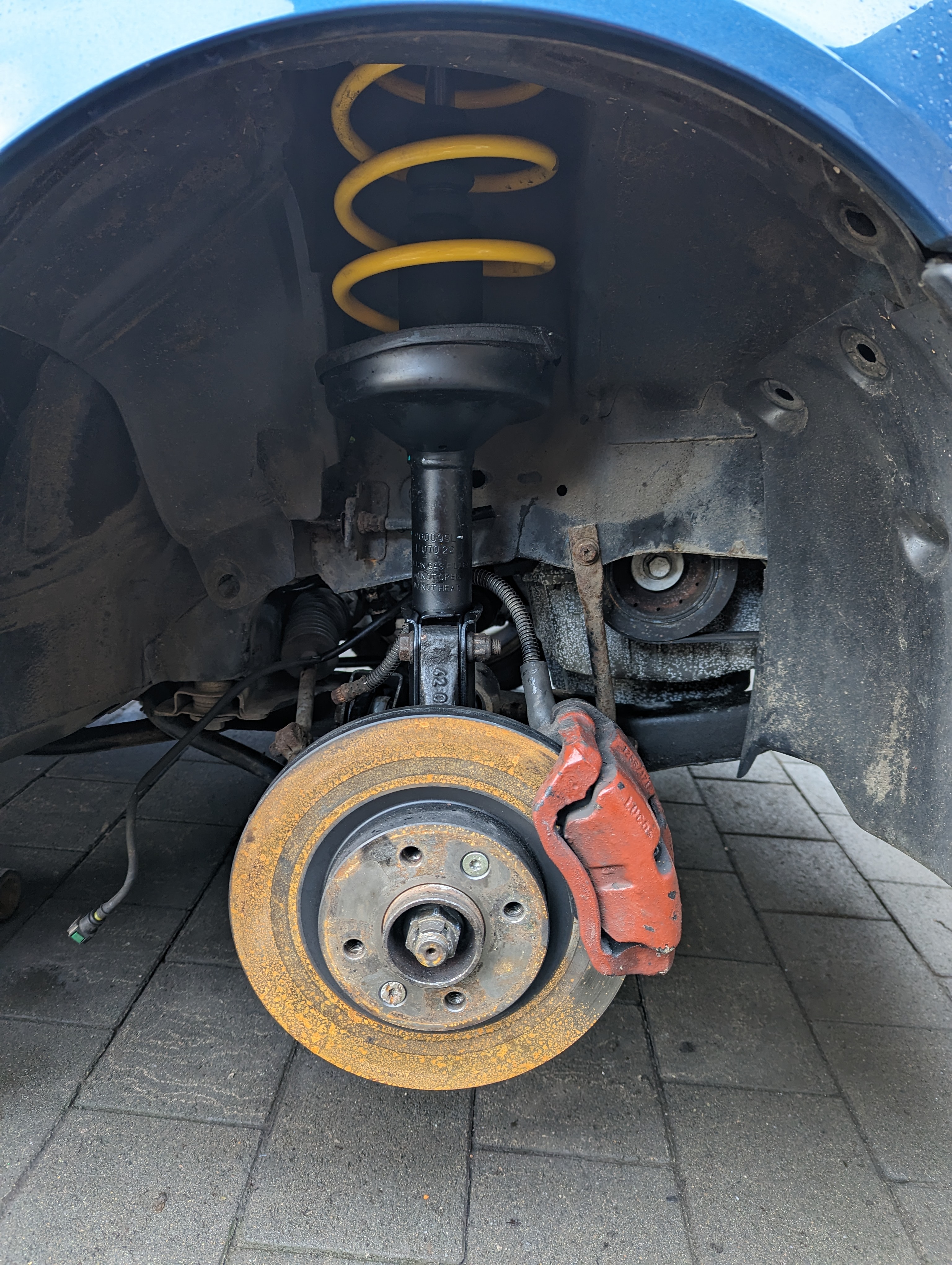

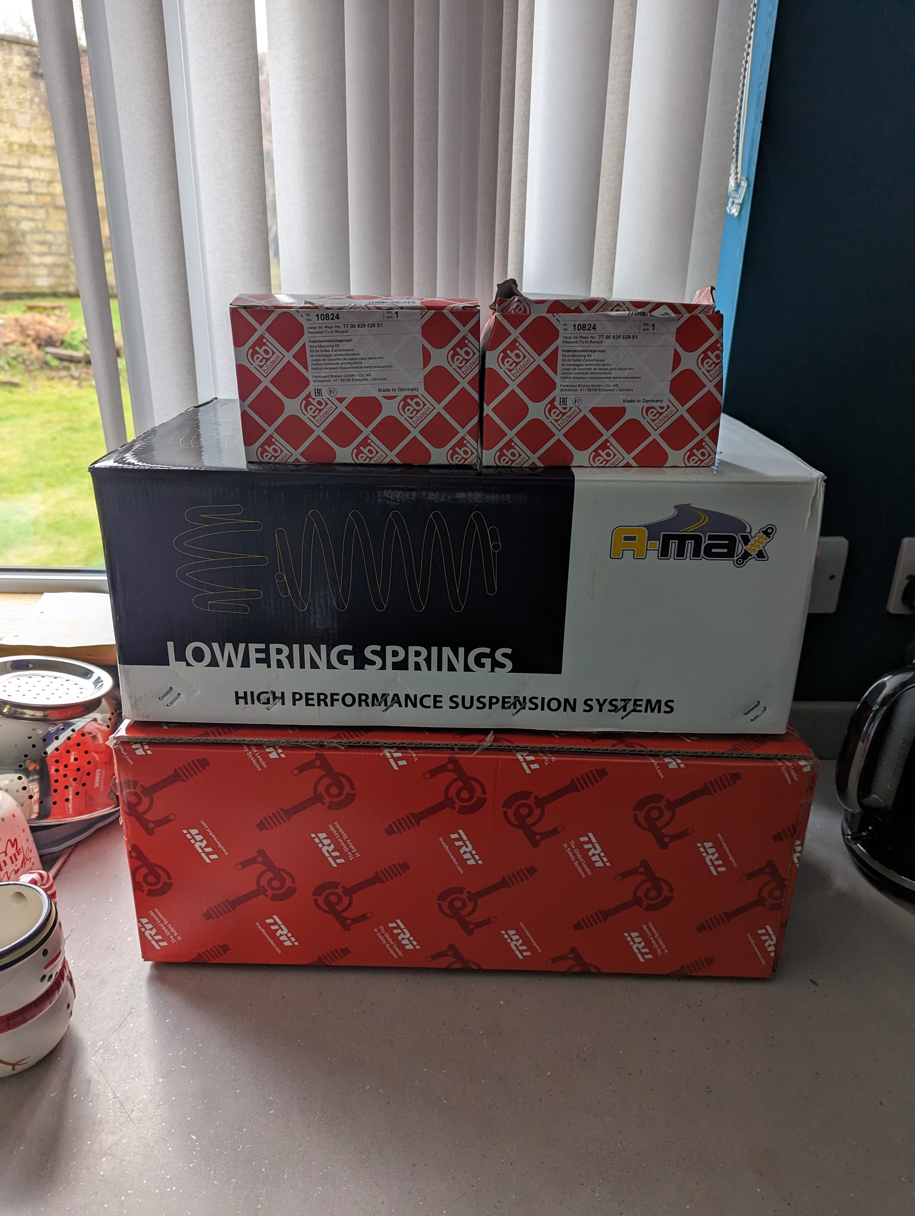

Waiting on an autodoc delivery of some KYB shocks and ive got a cheap set of 40mm springs on route from Venom Motorsport :ROFLMAO:

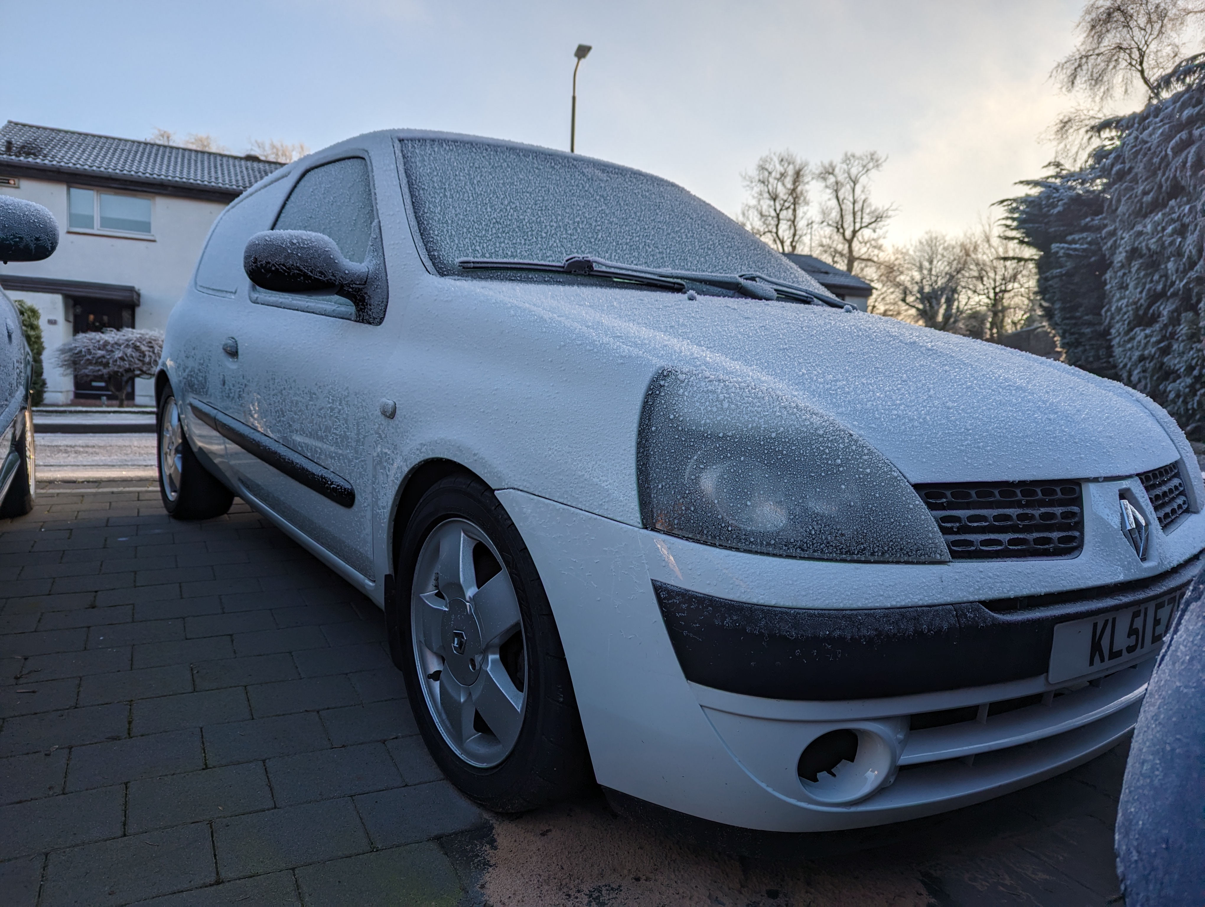

Curious to know if anyone has come across this, as I've not got a lot of PH1 experience... So, on a ph2 if you were doing this, you would swap the running gear, engine loom and then use the new engines ECU, UCH and key chip to get it to run. Currently, I don't have the fuel lines connected but with the 1.2 key and UCH and the 1.6 ECU, the immobiliser light is going out as it should and its turning over freely - and I assume would start if it had fuel! does this sound right? is the imob just in the UCH on a ph1?

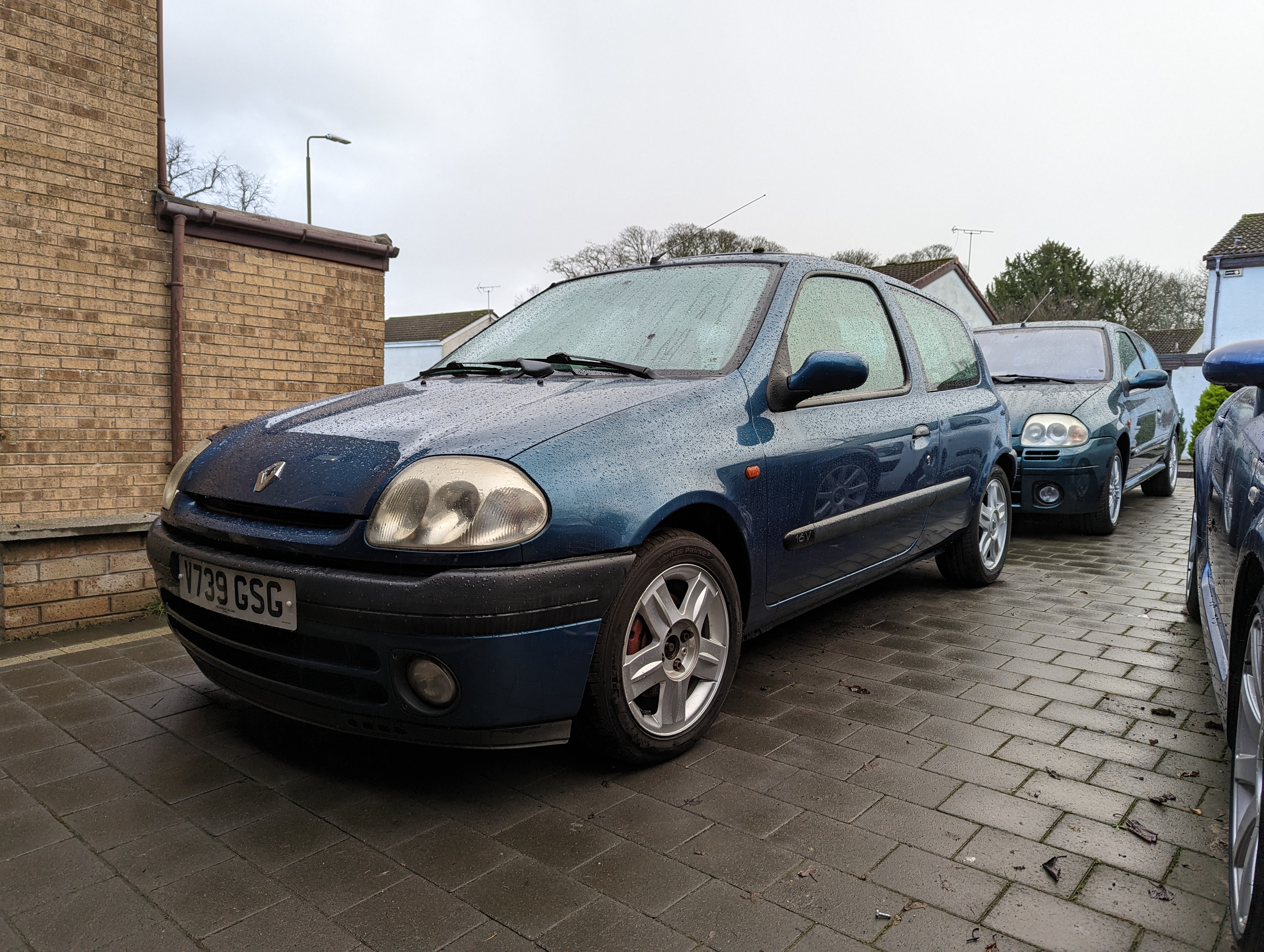

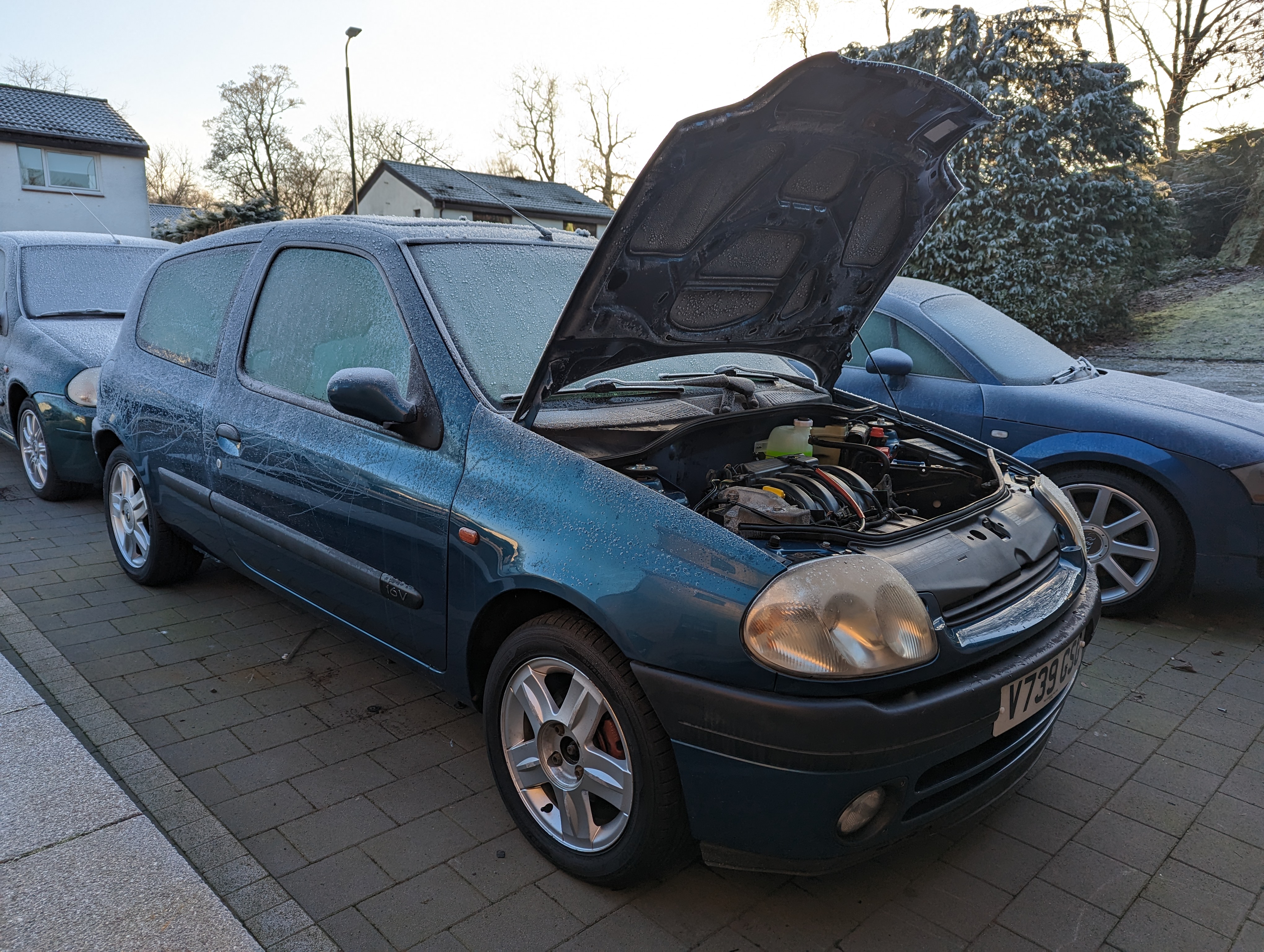

Its been too cold on my days off to work on any of the cars, i did go out the other day to do some work but was met with this and quicky thought, naaaaa
few days later, its a bit milder and a few deliveries had arrived!!!
Sits quite well, hopefully it will settle a little more at the front over the coming weeks.
