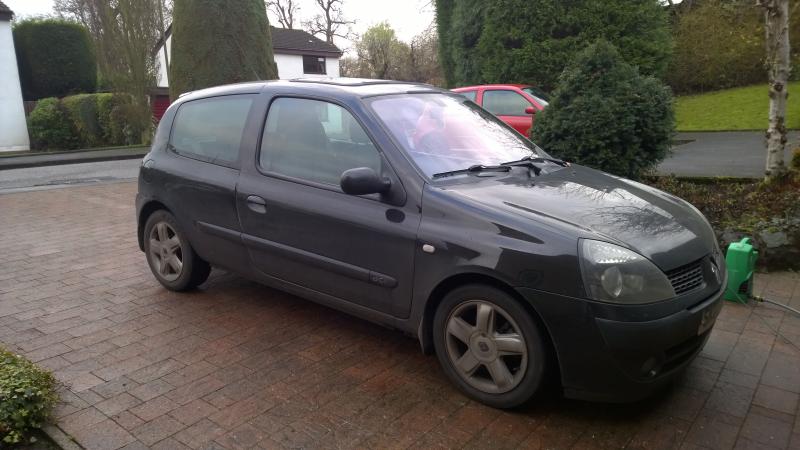

and here was the picture, again not the best picture ive saw to sell a car!!
so I gave the guy a phone and went to see it, upon arrival a closer look at the side badges revealed a nice little blue surprize! it was a DCi80, usual dynamique spec, unfortunately no aircon but it was an 80 so I was happy enough with that!
had a look about it, needed some TLC but it was straight, half a tank of diesel, 12 months MOT and 6 months tax (not that tax is a problem at £20 lol!) it ran rough but was badly in need of a service so took a gamble gave him a grand for it and drove it home!

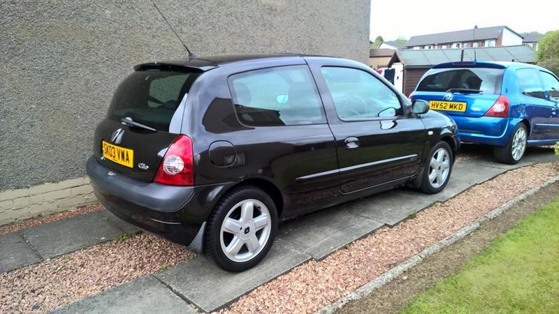

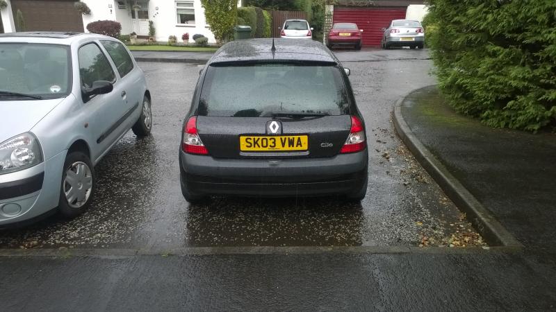

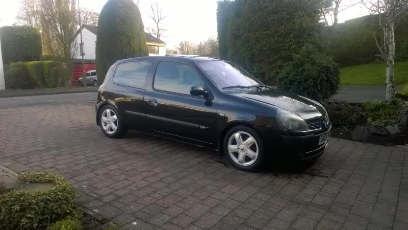

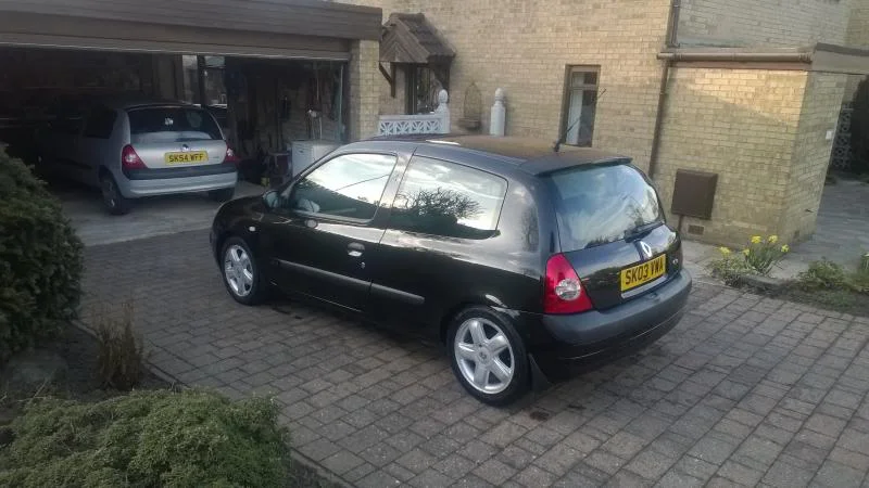

gave it a quick wash to see how it came up...

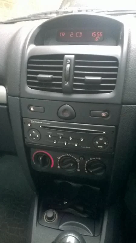

head unit didn't play CD's but luckily I had a spare Laguna Cabasse lying about I had removed from my 172 so in it went

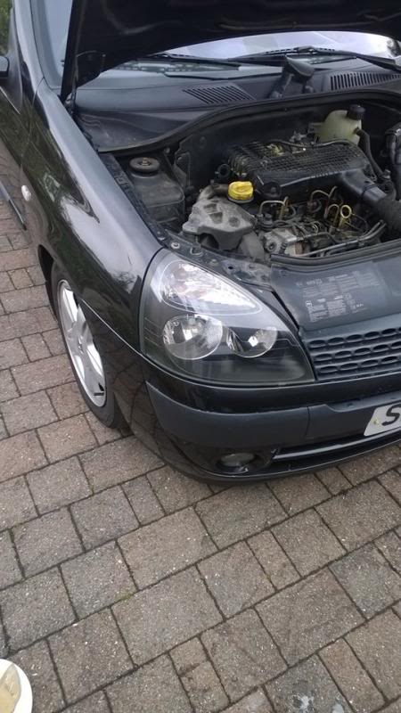

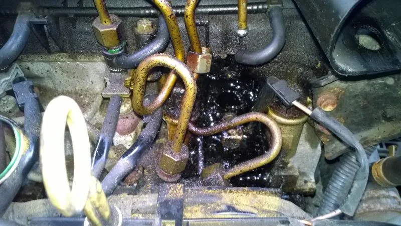

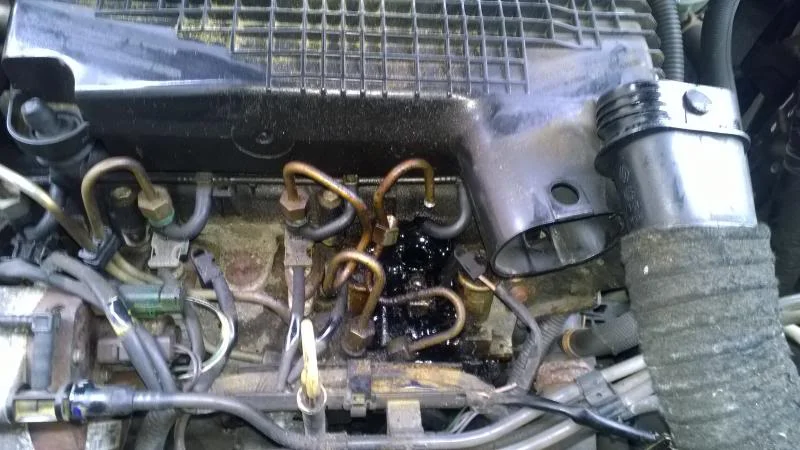

It didnt sound right at idle and felt a bit under powered, I remember people mentioning about leaking injector seals causing them to sound like they were puffing air at idle, popped off the airbox and was greated with a mess around one of the injectors, so ordered up a new injector seal and set about changing that, was a lot easiler than I expected, a doddle actually!
changed it over, put it all back together, brilliant! much quieter at idle now but still felt not quite as quick as I imagined but no leaks anymore so wasn't related to injector seals.

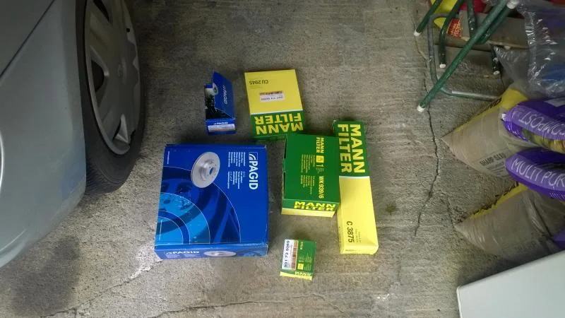

The car had the worse feeling brakes ive ever experienced, completely warped to bits with no pads left! so ordered up a set of OEM pagid discs and pads, Oil Filter, Air filter, fuel filter and cabin filter from Euro car parts and 5 litres of ELF SXR 5w40 from Ebay
car was running brilliant now but still didnt feel quite as quick as I thought it should! after a bit of head scratching it was off with the EGR valve! completely clogged to bits with the usual noncence, gave it all a good clean up and realised the inlet pipe from EGR to engine was clogged to bits too, scooped as much of this out as I could without removing the pipe and put it all back together. Car was now even more under powered as I had obviously disturbed all the crap in the inlet, then while giving it a good full throttle run to try and clear it out the car suddenly choaked up for a second then bang, shot off on a wave of torque! - NORMAL SERVICE HAS RESUMED!

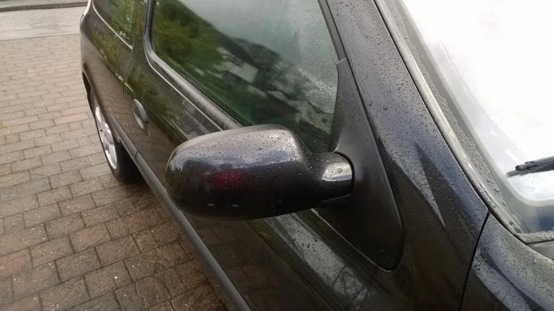

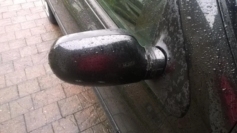

had a broken wing mirror that was cable tied together...
got a good one from a 172 that was being broken on ebay for a tenner...

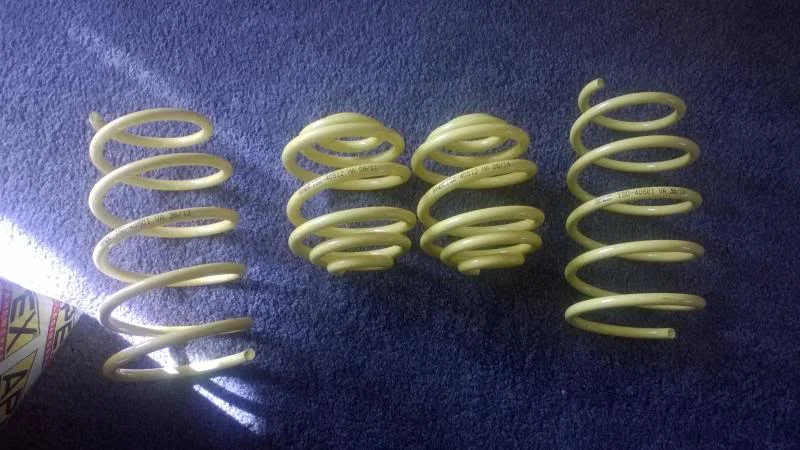

hunting on ebay one night won a pair of these brand new "ex display" with no boxes for £70!! I had doubts about them until they turned up and its clear they have never been fitted to a car :)

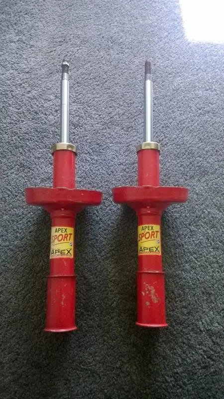

got these to match them, Apex -60mm (rear dampers are also on order!)

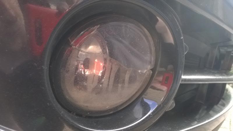

had a cracked fog light
remembered that 5 or 6 years ago I saw a smashed clio at the side of the road on the way to work and on the way home it was gone yet the front bumper was still lying! had a good foglight in it so I removed it lol! now 5 years later its finally became of use!!!

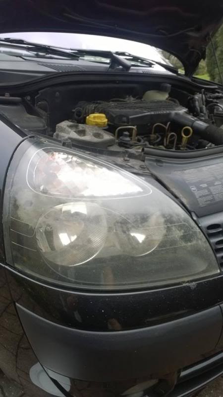

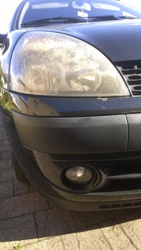

next up they horrid headlights need sorted!

Really enjoyed the bit about the cough, I'll do some scrapy pipe work. Headlights turned out good too.

just wet and dry mate think it was 1200, 1000, 800 from memory with a polish up, no where near the results you get with the 3M kit but this didn't cost me anything so will do!

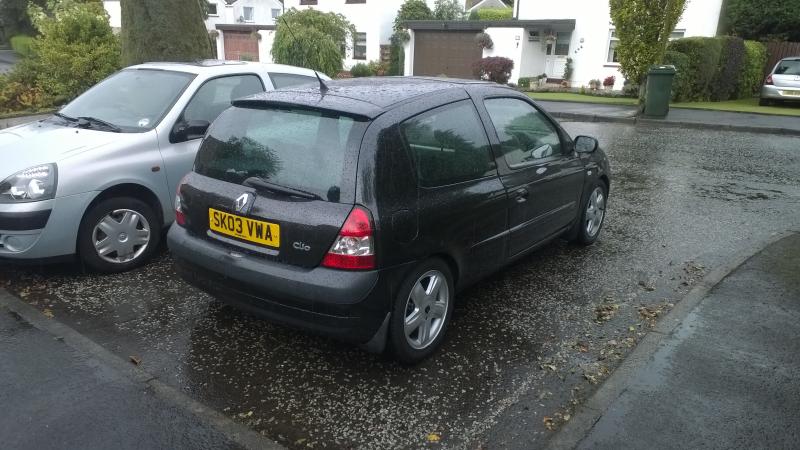

not been washed in over a month, sitting in the ghetto the other day...
runs massive spacers all round now and has 172 colour coded door strips (looking for door handles too now!)
done over 5k in it now since I got it, completely hastle free!! does 70mpg every day back and forward to work.

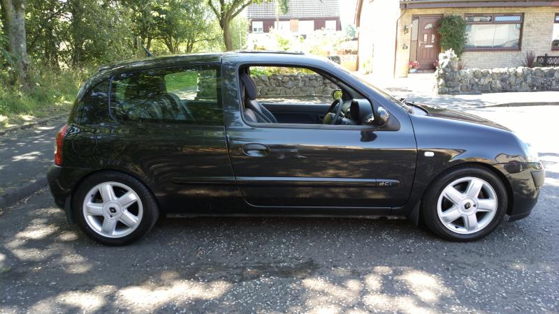

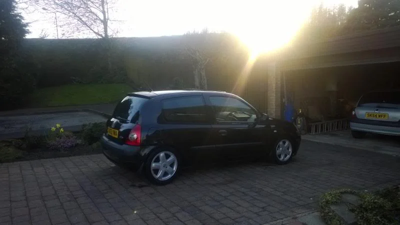

gave the wheels a reburb today in "Halfords metallic silver" done the centre diamonds black just for something a bit different.

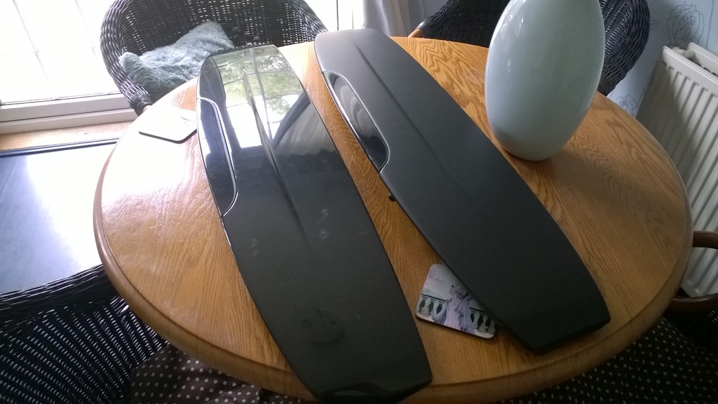

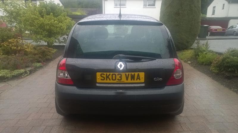

fitted 172 colourcoded spoiler and bump strips, got door handles to do today.

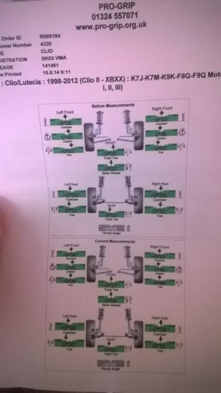

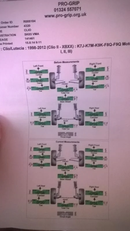

Bit of a running joke with John at Progrip as every time I take a Renault in somthings not quite right with it, my 200 was obviously bent in every area it could be, my flamer had a bent hub, my ph1 had a bent lower arm, my twingo had a bent rear beam (2yrs old, mint with 20k on the clock too!) and my 1.6 16v had a bent hub too!!!
took the 150k rough as a badgers arse DCI in yesterday to have it setup after I replaced the track rods and rod ends and its probably straighter than it left the factory!!!!

the springs are -60mm lower with dampers to match! ive had the springs just on their own on a dci 65 and it was horrible but with matching dampers they are stiff but handles really well

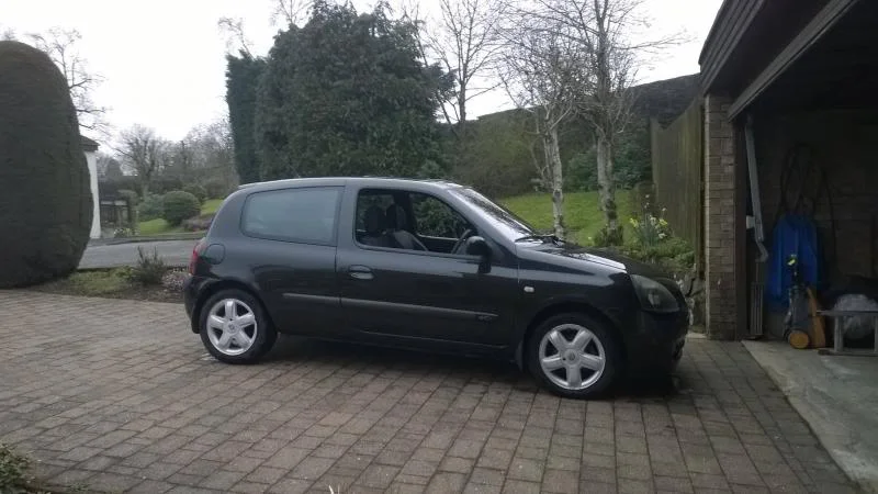

as it sits now at standard ride height with its new Twingo suspension!
