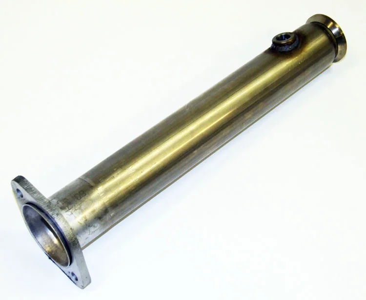

but.. the ebay "demontweeks" picture has the correct fit pipe (coned edge and bracket) the demontweeks website has different fit :-/ (flange/gasket 2 bolts)

That is what the scorpion 192 decat looks like. Taken directly from the rs192 website and I have one sat in the garage.
