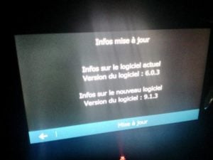

Seen it happen when they develop a fault, check the power as said above to make sure it's not a loose connection. Second hand units are cheap if required.
Could try flashing the latest software onto it and see if it cures it

Thank you, being a total noob can you tell me how id add the latest software?
