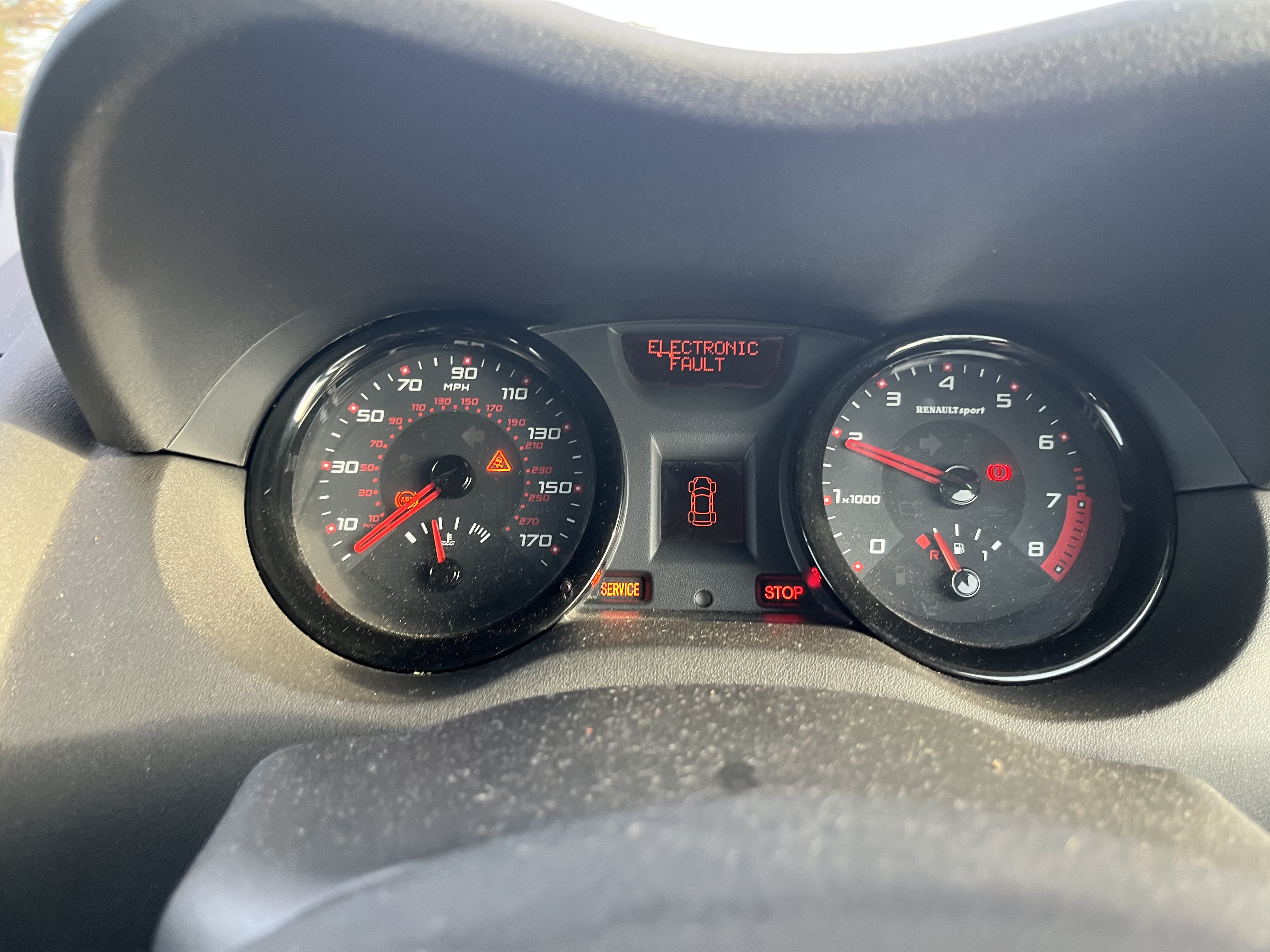

I had the gear linkages and decat fitted the other day to the PH1 Megane 225 and now I have electrical fault on the dash with a lot of lights. (See picture below) I’ve read the codes and it seems to come back to wheel speed sensor but they all seem to be connected however the computer is telling me the car thinks it’s doing 225MPH at one point. When driving the speedo needle doesn’t move either but everything else seems to work.
I’ve tried clearing fault or getting live data to see which speed sensor isn’t working but it seems as though whatever controls it isn’t communicating perhaps?
