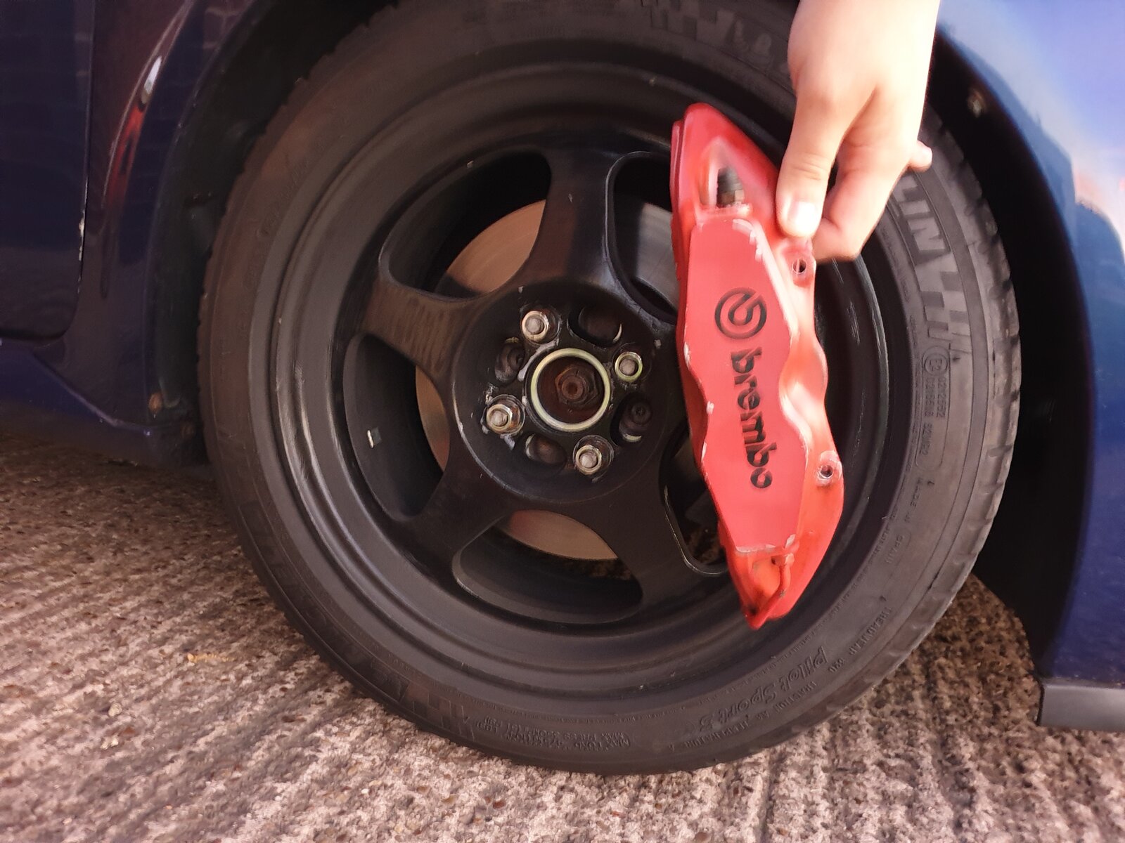

Just for reference, this is a Meg 250 caliper next to a 15" wheel!
They only just fit under a 17" wheel on the Clio 3 with a 312mm disc. f**k knows how or why people would bang these on a 172/182

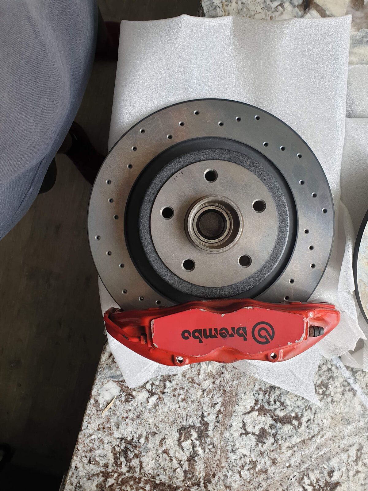

And no, I'm not holding the caliper to obscure the photo either! They're mahoosive
This is one offered up to a 300mm R26 rear disc!
