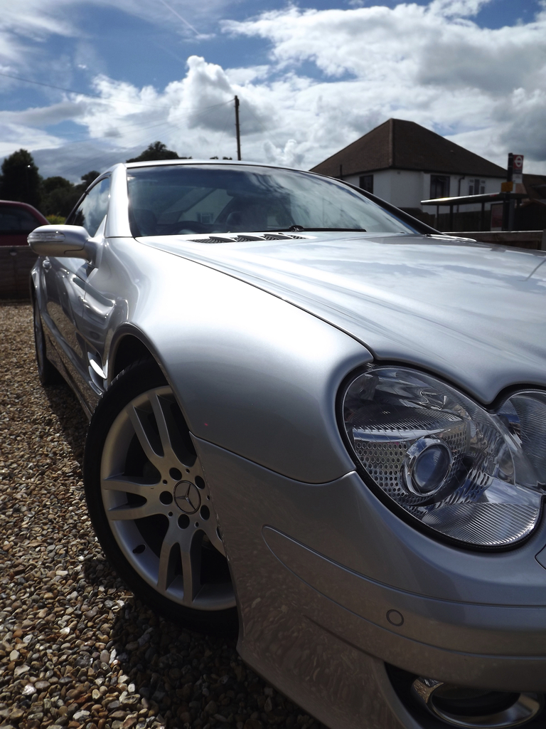

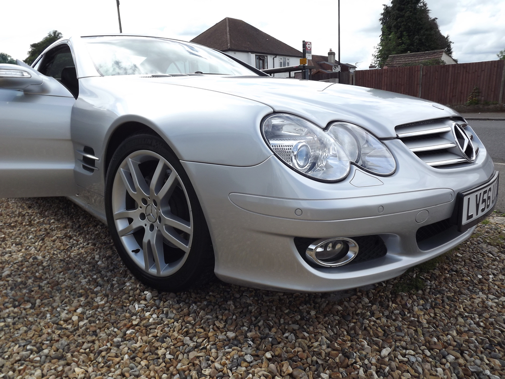

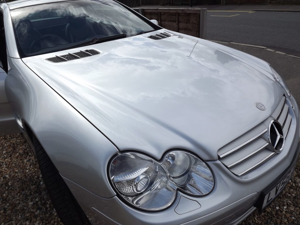

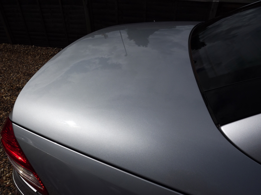

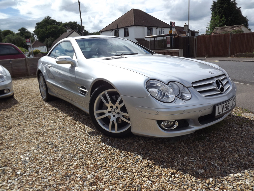

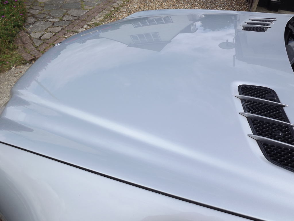

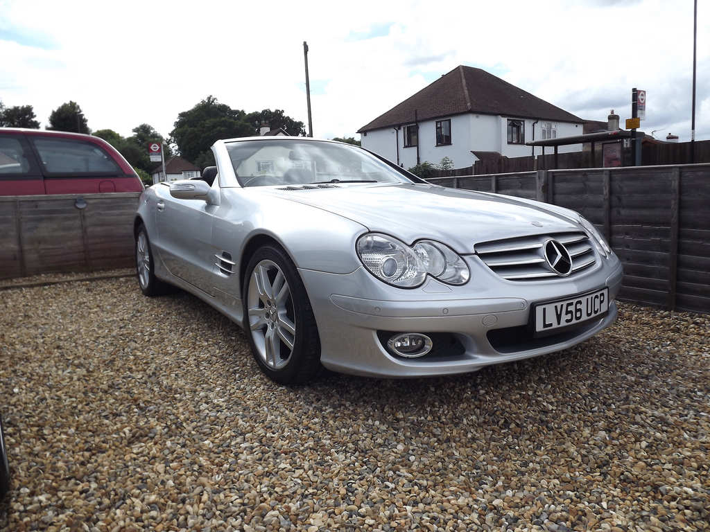

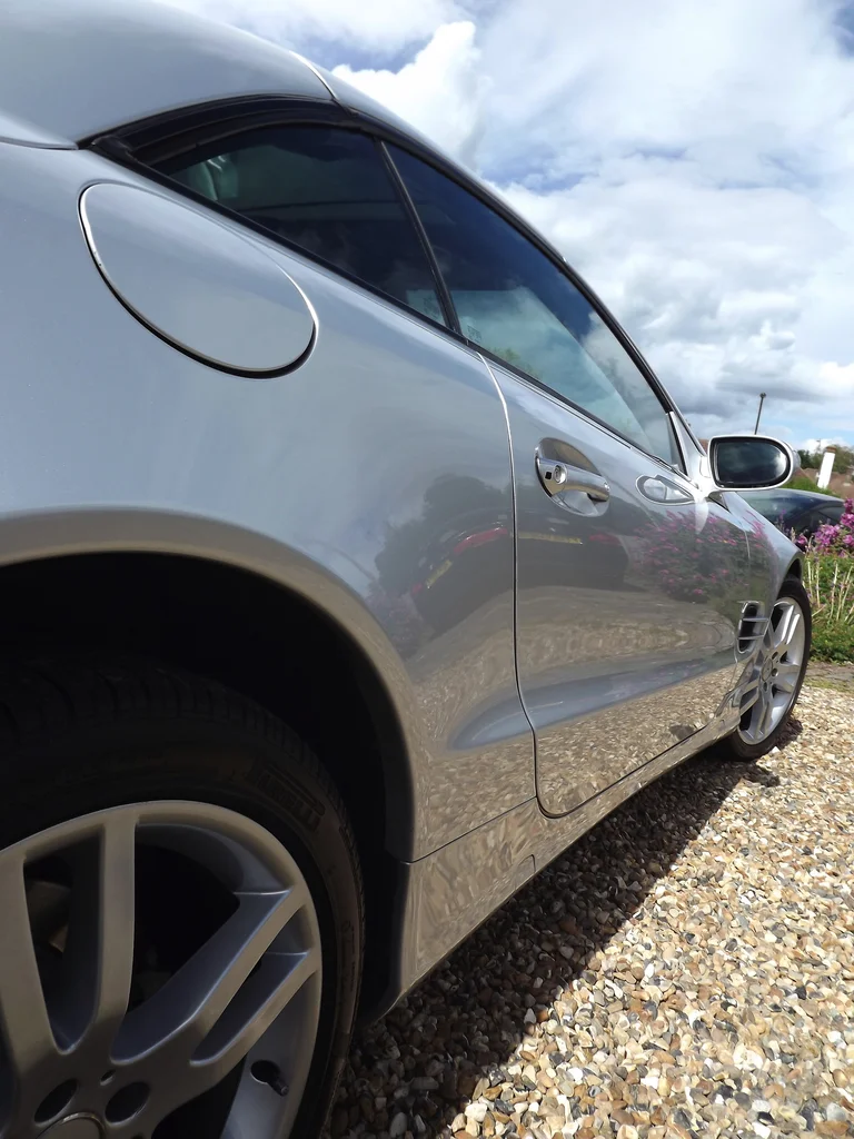

I didn't do any before pics but here's how she's now looking. Very pleased with the results. :thumb:

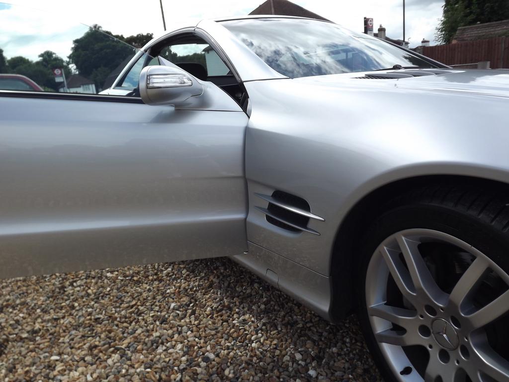

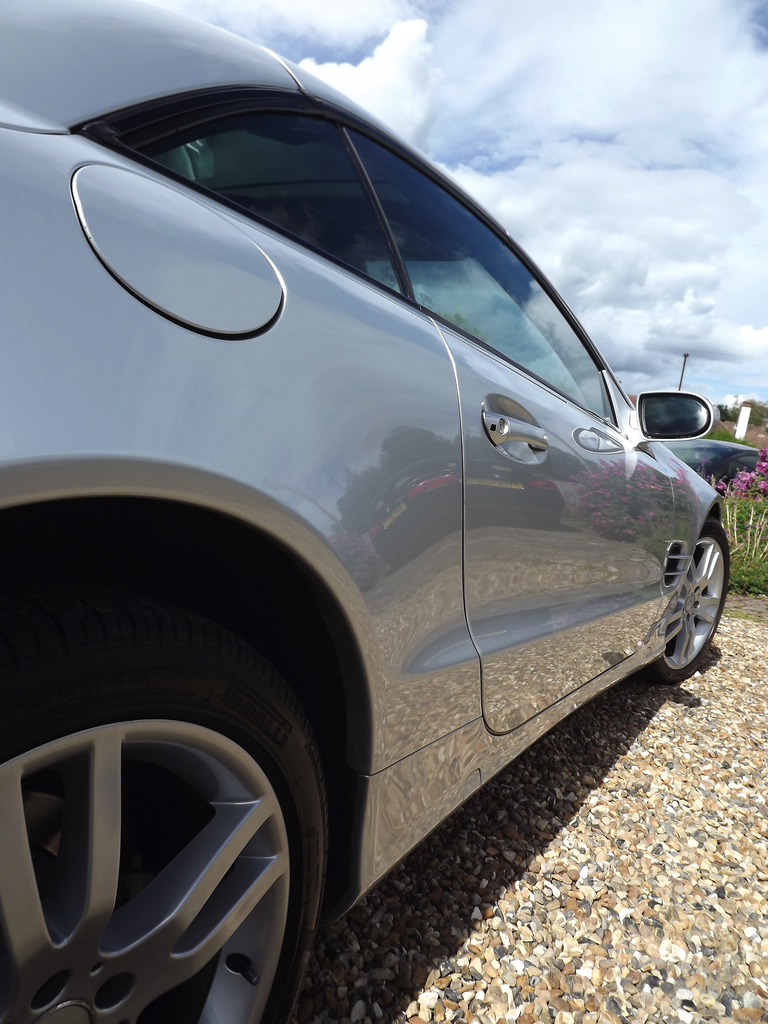

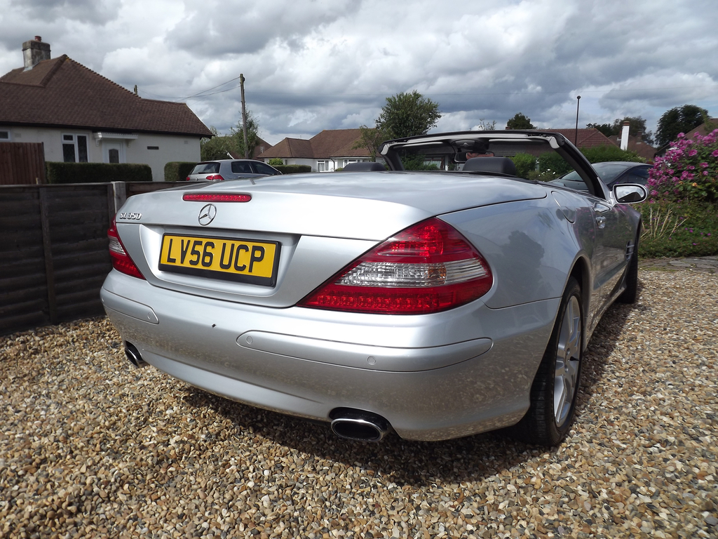

It's a pretty car so only fair to get a few shots with the roof down.

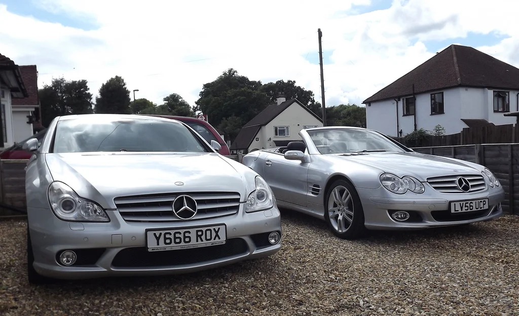

It can now show up the CLS in terms of cleanliness...well not really but looks good.

I do like the sl350 looks mint
It's got a few little blemishes but it's 10 years old so what can you expect. Only had it a week (well the other half has) so plenty to still do and a couple of bits of paint to be done but essentially it's a good'un. Shines up nicely. :)
