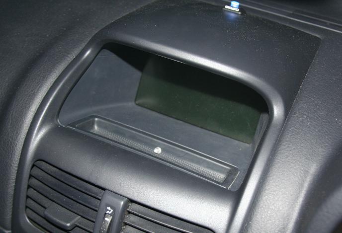

i got mine done (after bothering mike loads for part numbers lol )
but i could not find a screen to match!!
what i eventually did tho was to buy a 5.8" necvox FD-5869 screen
now heres the fun bit!! :D take the screen apart, just the screen cover - you will be left with the 5.8" screen which will fit perfectly into the holder but then you will have problems with turning it on/off
you then have 2 choices!
1. you can extend the buttons from the screen onto a separate PCB and mount the buttons infront of the screen on the holder
2. (what i did) extend the infrared LED and operate the screen by remote!
job's a good one!! :D works and looks perfect!
i didnt do all this myself - luckily i live very close to a very reputable audio and custom shop called Sound In Motion - some mite have heard of them from Max Power Live??
anyways take it to any good shop and they should be able to do this no problem! :D

it was £140 for the screen and a couple of hours work if that
so your looking around £350 at least for the whole lot including dash
needs a clean lol havent got it wired up yet but will hopefully get that sorted within the week! also every one has commented on it greatly over here (northern ireland) its a rare site here
