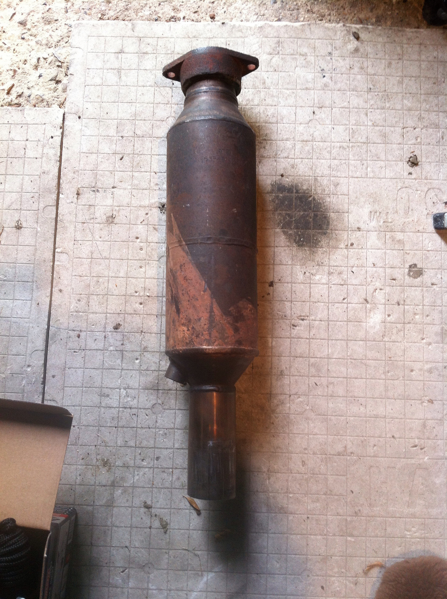

Hi mate,
So I presume you're running a standard cat, with this olive adaptor between your sleeved centre section and the cat?
You will need one of these - https://www.renaultpartsdirect.co.u...ls/renault-clio-172-182-centre-exhaust-clamp/
Good idea to use some HT silicone as they're a nightmare to seal.
You're probably better having the cat sleeved and then itll just slide into the milltek centre section and you can use one of your milltek mikalor clamps. Like this:
Finally these are the mikalor milltek clamps you need - https://www.ebay.co.uk/itm/Golf-Corrado-VR6-GTi-G60-MILLTEK-Sport-Exhaust-Tail-Tip-De-Cat-Pipe-Clamp-Ø66-5/152201002016?ssPageName=STRK:MEBIDX:IT&_trksid=p2057872.m2749.l2649
Presuming a 2.5inch milltek system?
