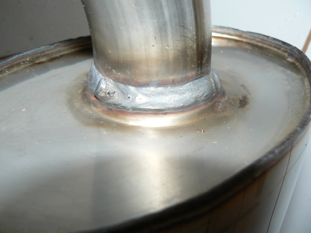

my system arrived and I made some pics of the problematic area
guys who had the snapped welds problem: does these welds look the same as yours?

to be honest they welds look similar to mine when i got it fitted and i thought they looked strong

ok then, there are some guys here who had no problems with their system, PLEASE put some photos with the welds well done, at least we'll know how they were supposed to look like

I,m waiting on my replacement system hopefully be here by Saturday the pic at the start of the thread is the only one i took sorry.

there wasa guy saying he had a milltek for 2 years with no problem at all, maybe some other guys like him will post a pic to see if there is a difference between a good weld and a bad one.
Although my guess is that some exhausts had worn mounts or the stress on the welds in case was bigger than normal, somehow.. looking forward for your pics dolan!
that weld looks perfectly fine but in my opinion it should have been more angled down to the silencer for better strength and welds are prone to crack at the side of a weld due to heat input and composition of the filler wire ;) but if anyone has this trouble and lives near or in leicester and wants it taking off and welding up then thats fine just give me a shout :)
