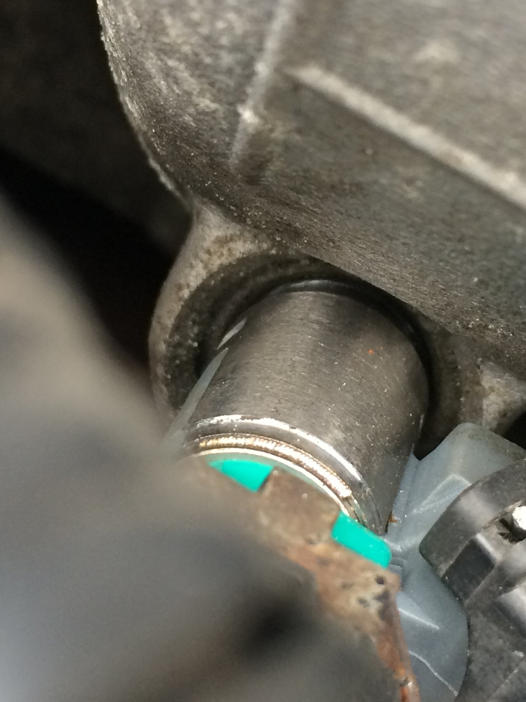

Sorry to revive such an old thread but I’m having the same problem on a 53 172. Replaced No.3 injector and despite it not running as boggy it’s still mis-firing. Sorry for sounding like a tw@t but the injector I replaced doesn’t look like it’s seated properly could this be causing the mis-fire still?

looks in enough to me they can be a pain to seat properly. I certainly wouldnt say thats the reason for a miss fire as both my middle injectors look like that and my car runs fine.
