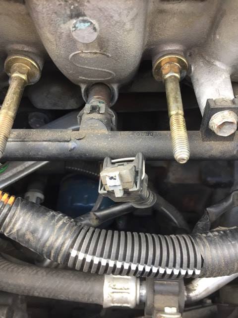

Just need a bit of help with this one please, drove locally this morning, the car drove fine but when I got to the destination I noticed a massive burble, I had no engine check light on at the time so fed up I left it to go out with someone.
I've come back to the car, started although very hesitant, sounds like a tractor, I was thinking coilpack / injector problem at best, managed to limp it home, trying to remember how to check for injector problems, the only injector that didnt make a change in the engine running was second from right. Number 2?
Anyway when trying to click the injector back in the connection from the injector just broke off. So obviously thats fucked anyway. Im just hoping a new / 2nd hand injector will cure it.
ECP do injectors that work ok? going to have a look now. Would ideally like to pick one up tomorrow to have a go.
Any advice? Anyone got a spare injector in the essex / loughton area I can buy / borrow?

Erm well that didnt solve it sadly. Looks like no 3 injector was changed at some point before my ownership as its cleaner, the left and right injectors look original. the injector needed changing anyway as it fell apart.

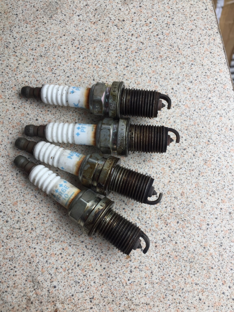

Ill have to check plugs tomorrow, really hope one of them hasnt blown out and ruined the thread etc.
The noise does sound like it could have spat a plug I suppose.
Panicked and checked plugs, there tight, will try new ht leads tomorrow - possibly them ? Could still be an injector. Just because that one fell apart on me I suppose it could be another one.
Alright not a tractor maybe a fucked subaru? ha
Good place to start, and if all plug threads are good, run a compression test, gets that one out the way.

What plugs have you got, how old are they, and what condition?

Plugs correct NGK - possibly 2 years old maybe newer.

I'd pull the plugs out and see how they are looking on each cylinder, and maybe clean them up for good measure too.

I'll also whip each plug out and have a look.

plugs don't look the best, what mileage? have you looked at what the lambda is doing?

Need to look in notepad for mileage on plugs, I reckon they need doing anyway so will.
