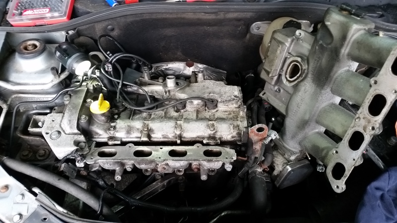

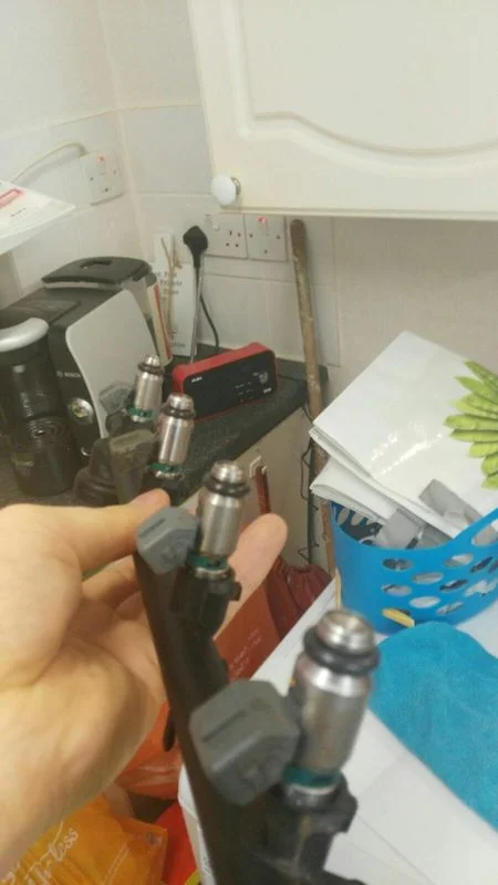

Dropped onto three cylinders, got it recovered home and checked and the fault was Injector 2. so stripped it apart as I decided to replace the leads too.

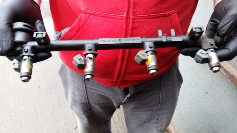

So, rail out, clearly been out before as the injectors have paint marks and there are no injector clips.

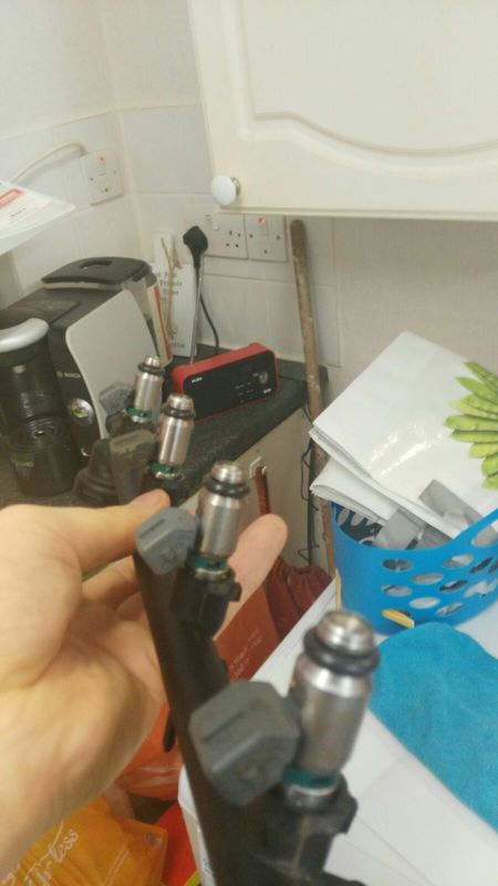

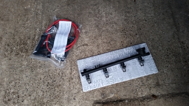

So a friend got the injectors checked and cleaned (2 is defo knackered) so bought a new one, fitted and washed out the rail.
And my new silicone leads arrived from Matt Lewis Racing (MLR).

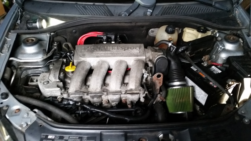

Now all fitted back together and runs a treat! (I need a need airfilter and to tidy the bay up)

All fixed with a new injector - brought leads to but thats for another day
