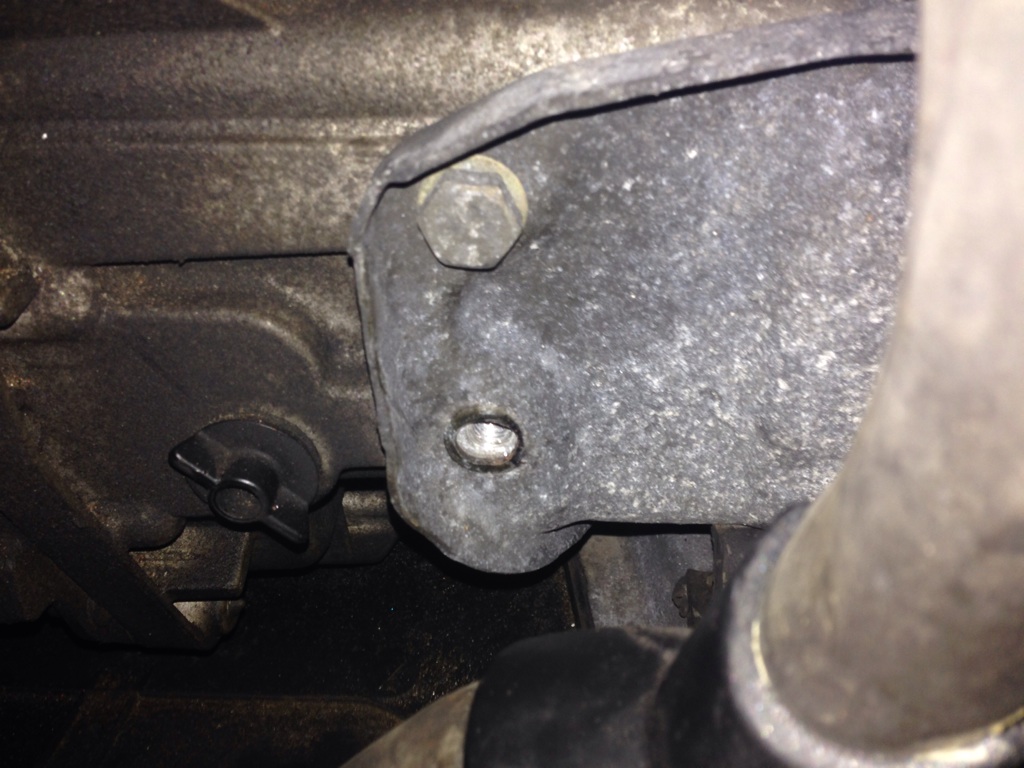

Missing gearbox bolt
Noticed today there seems to be a bolt missing from the front of my gearbox
Threads seem ok and looking at the clean area I'm guessing there is supposed to be a bolt there lol
Must have rattled loose
Anyone know what size/thread it is? or where I can get one?
Ta
That was my first thought - but I definitely didn't I just removed the bolt that goes in to the rubber mount from the bottom.
I've never actually looked at the front of the gearbox before lol
I wonder if it's just vibrated loose because of the solid mounts I run everywhere else
  330i. E30 Touring.
^this.
Without the PAS pipe there just copy the bolt above it,
16mm head. 20-25mm length iirc.
Ahhhhhhhhhhhhhhhhhhhh
Thanks Dan/guys
I'm guessing if I go get the pas pipes out the box in the garage the bolt will probably still be in the bracket haha.
Doh!

Yeah possibly but it has quite a large spacer on it so you can't just whack it in really. As said above try and get one off another car with a bolt the same as the one above.
  330i. E30 Touring.
Or cut the spacer off the pipe.
I'd be finding a bolt that'll work without the spacer though
