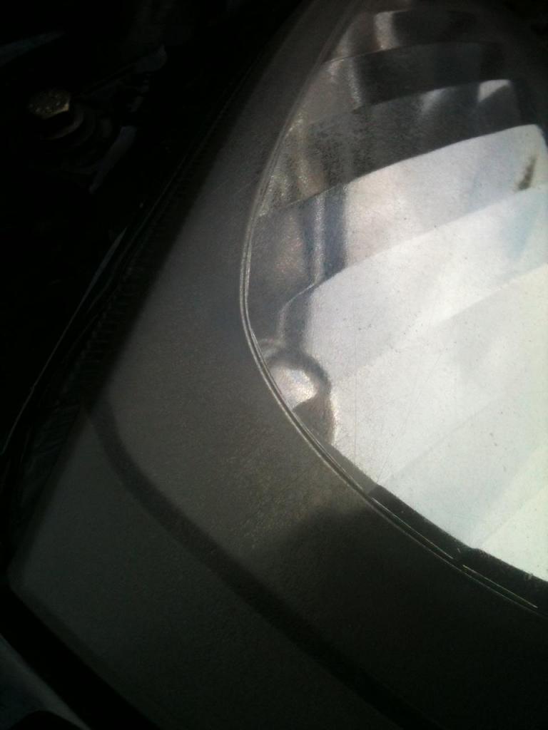

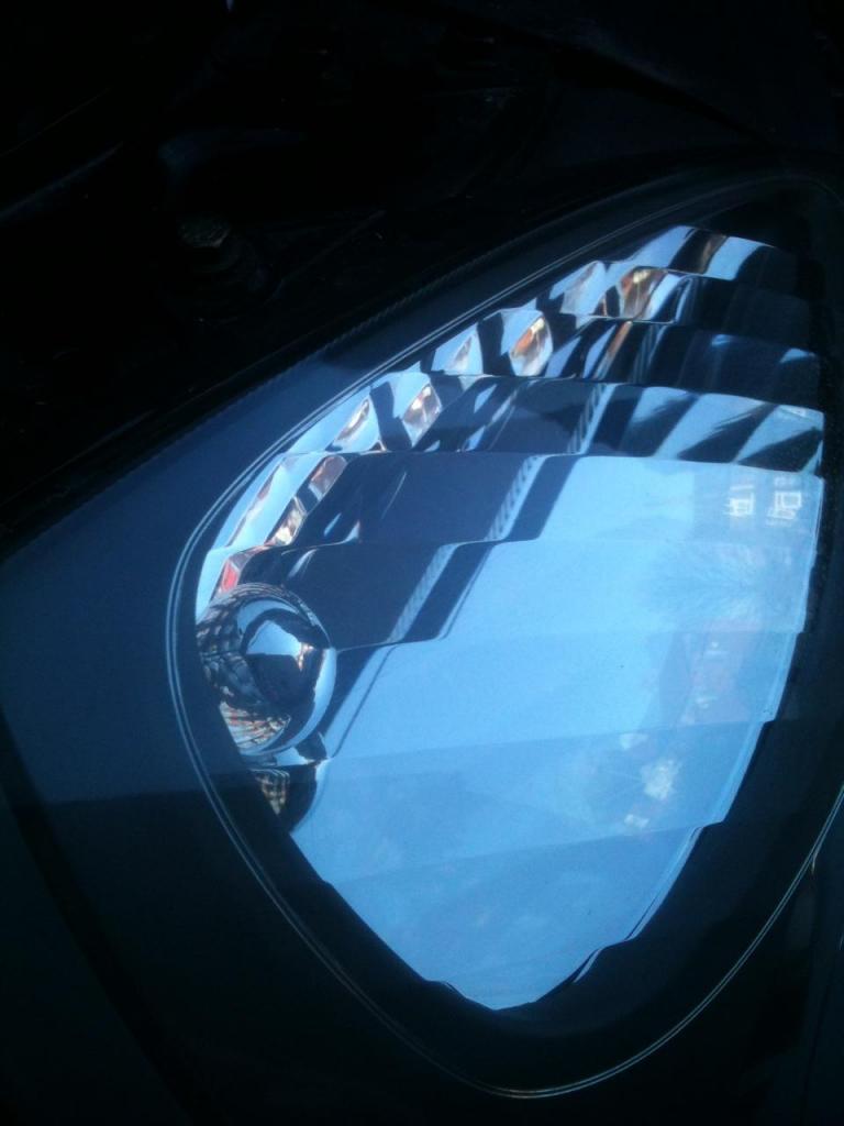

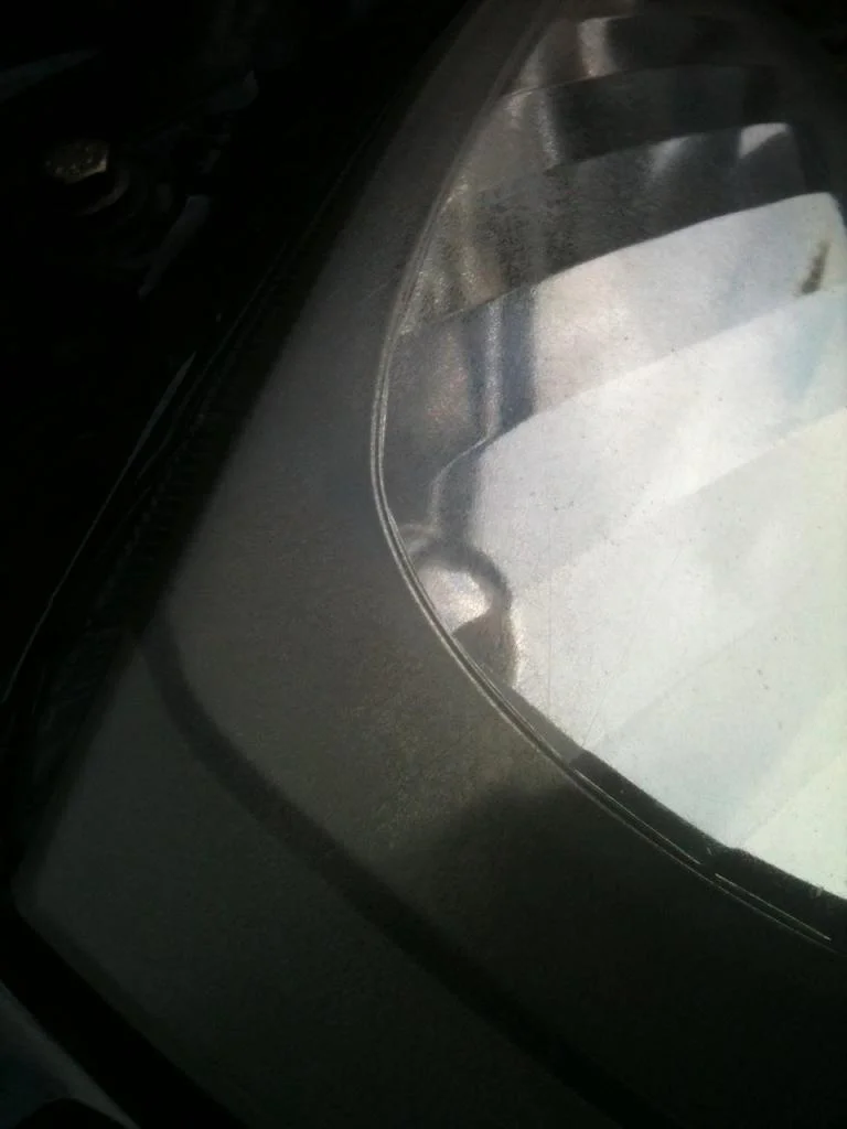

A quick shot of mine before and after (apologies for the low quality - it was going dark quickly!)
